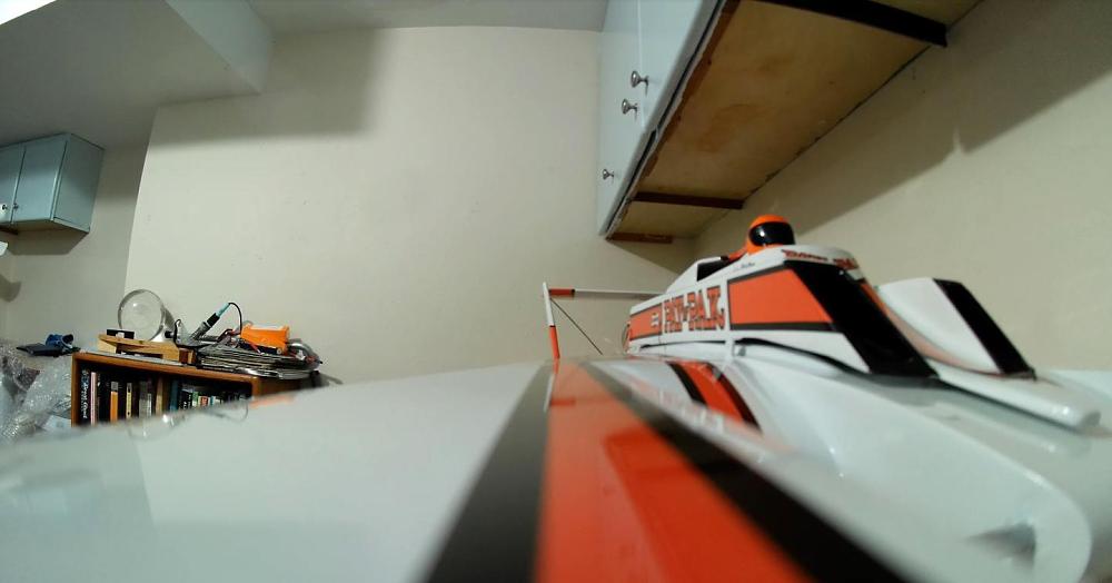

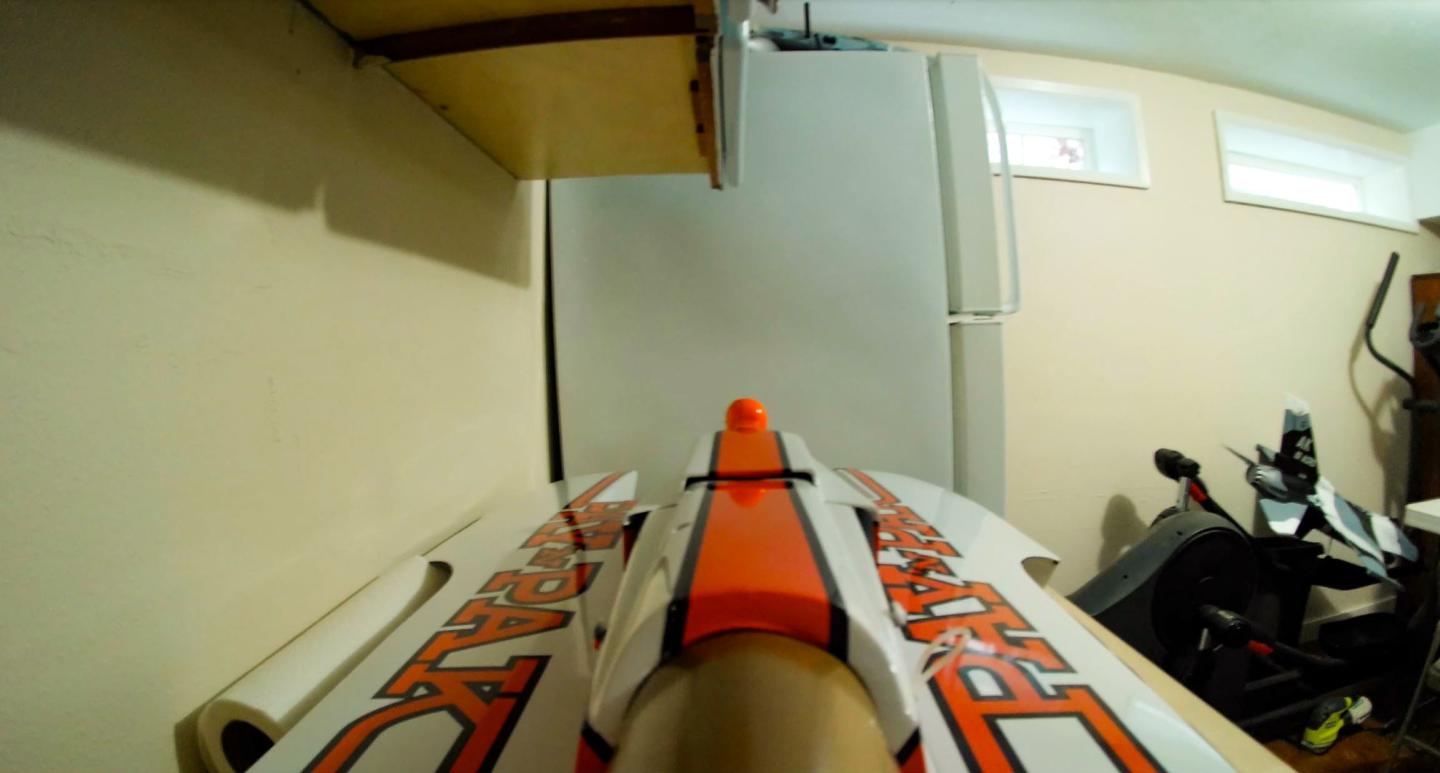

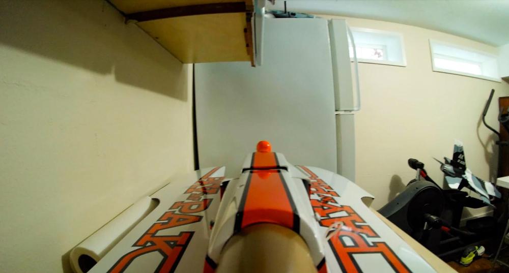

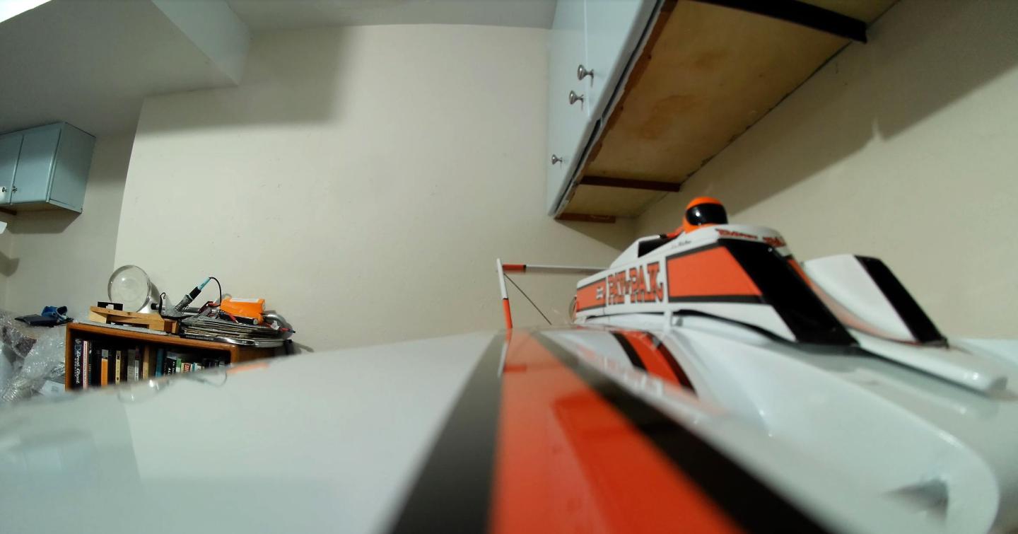

                      Experimenting with the new RunCam 6, I picked up (two)....These are the two best angles I thought for the maiden...
                      Click image for larger version  Name:	Capture1.jpg Views:	0 Size:	72.7 KB ID:	402236
                      Click image for larger version  Name:	Capture2.jpg Views:	0 Size:	65.0 KB ID:	402237

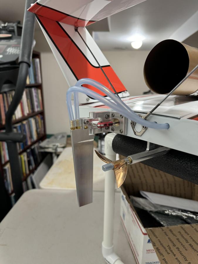

                          Hmm, good question on the ESC telemetry thing...I'll have to dig into that. The prop according the guy that's also helping me said is a ABC cleaver prop with a 58.42 mm nominal diameter. He said the maximum NAMBA allowed prop diameter is 57 mm. A little diameter reduction is easy and that prop should work.

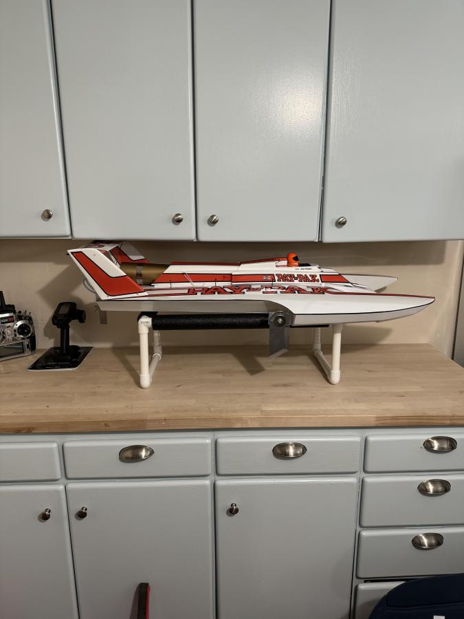

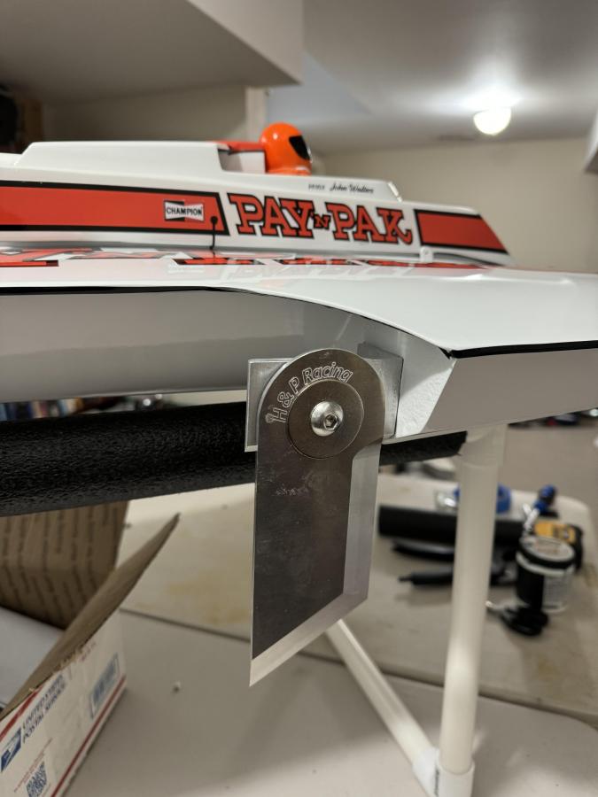

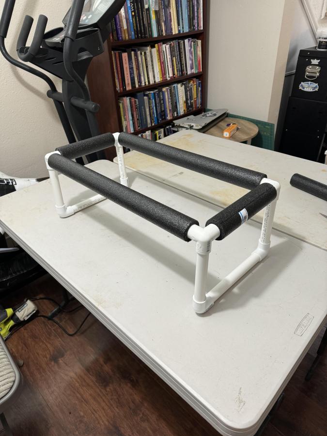

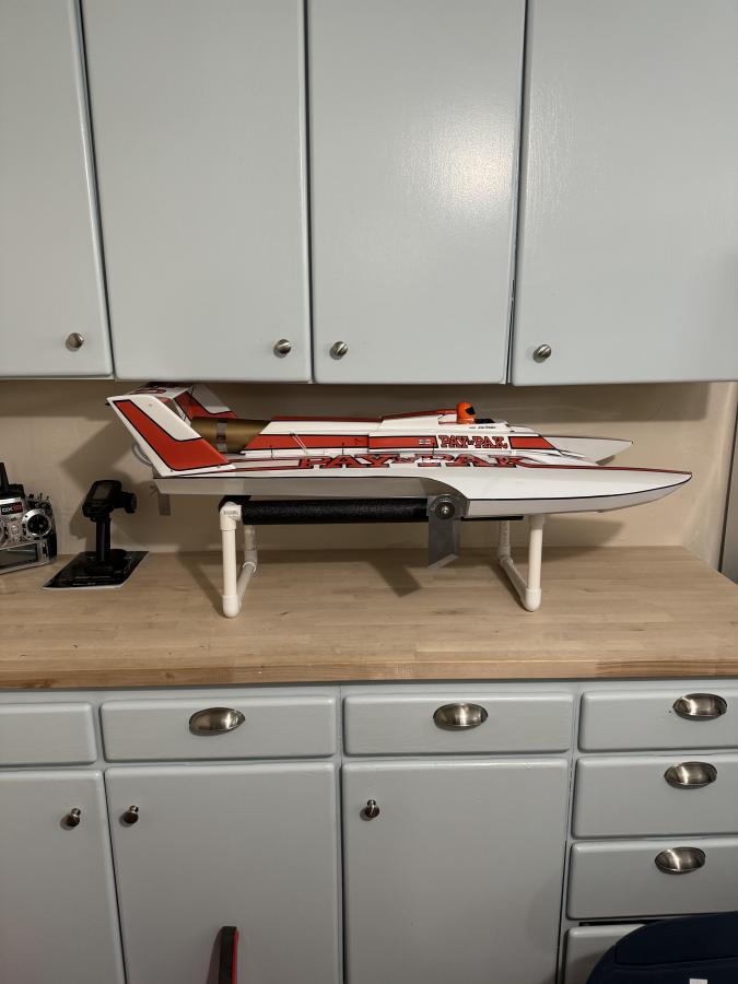

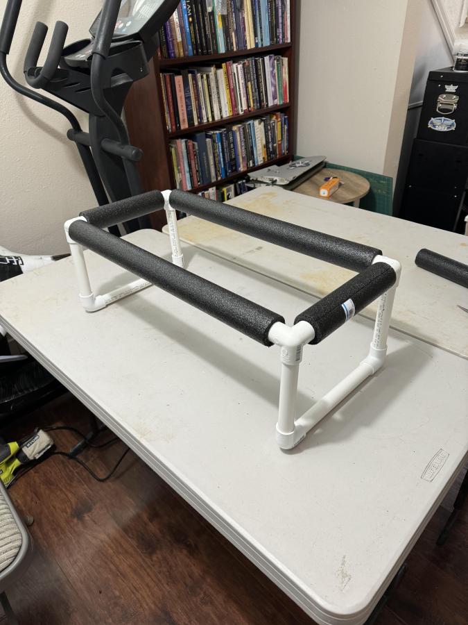

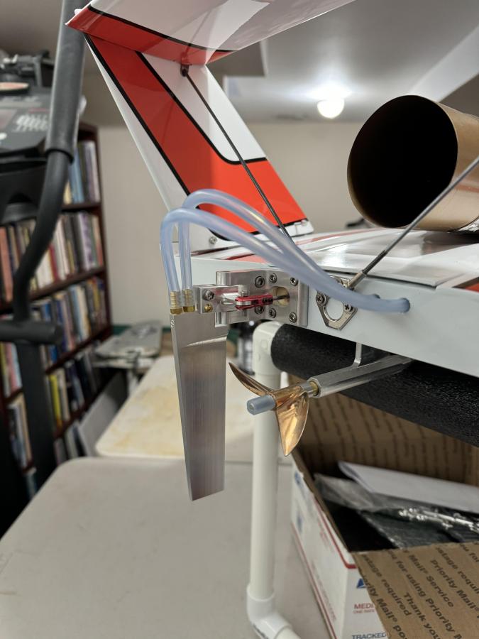

                          So today was a nice turning point. I built a stand for her and added the turn fin and rudder. I may be meeting with him next weekend willing to solder the connectors for me and get her all wrapped up for RTR! Whoo hoo! Getting close!

                            That lookin back camera will get a great shot of that first rooster tail

                              To each his own BUT Im not a fan of go pro at any angle esp 1st person 😮 I like to see the entire boat around the course, not just the side of the boat and water rushing past that's all go pro shows really . Its cool but It won't be any good for accessing the running attitude because you can never see that with go pro in the first person.
                              I see your turn fin there, so i ask have you inquired about "tabling" the boat from one of the club members? or IW
                              Not trying to say your friend is wrong but I'd start with a smaller prop because no one knows that boat really until it runs but 57 mm is alot for 30,000 in a motor that size IMHO maybe im wrong but Id start at an x450. You got alot of rake there on that prop? What's the aspect ratio? x series octuras are 1.4. That props looks like an ABC with a higher AR. What is the number of that prop? You have to consider your amp draws with the props. Too big and you will smoke the ESC
                              If it were me I just would not jump out there with a 57mm on the maiden. The x450 or x452 octura equivalent in ABC would be a 1419 is suppose. That is just a starting point so you can get an idea of the amperage first. The reason the 1.4 is good is it medium lift if you have to much lift which higher ARut bs bring that tail of the boat can hop around and become unstable . We don't know for certain how you boat will respond and what prop it really likes. Use others note for a basis but its advisable to find good prop incrementally. The other thing to think about is the props BAR.
                              The wrong prop can make or break your dreams in a matter of seconds. Ask the person helping you what amps does he expect with a 58 prop at 30,000 rpm. Kinda silly they care about diameter limits because pitch is what makes the speed and you can get smaller props with alot more pitch. The boat will also corner better if you can prep a 3 blade. In the 3 blade try a X646/3 to start.

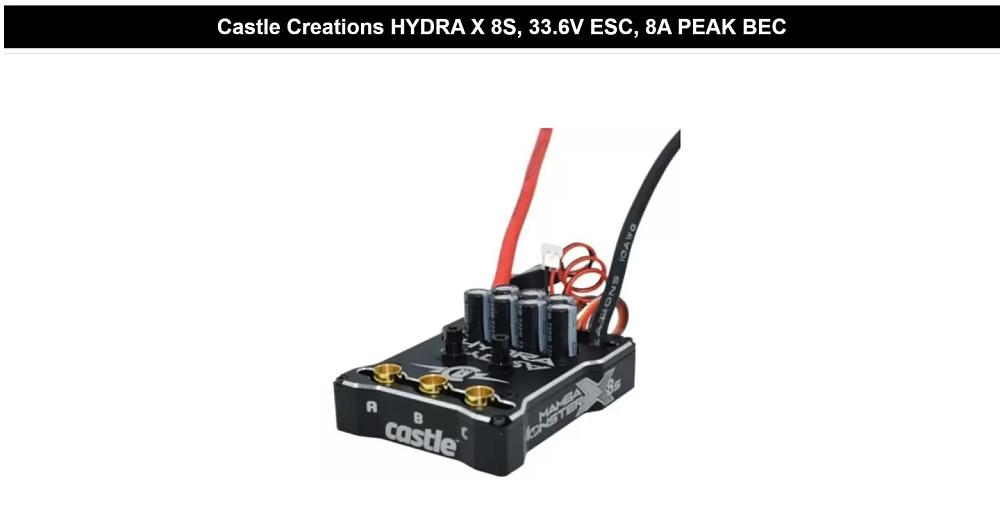

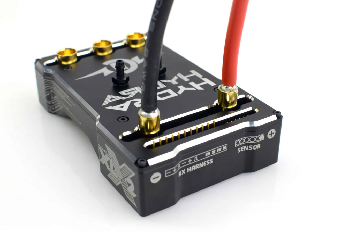

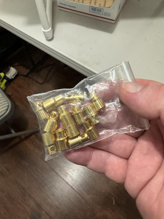

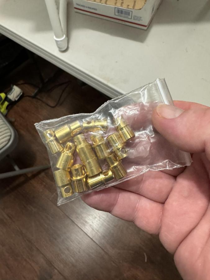

                                      Spent the weekend a couple hours south with a total gentleman who soldered all my connections together and would not accept a dime from me. The only hitch is we could not get the motor to full RPM. We calibrated the throttle with the ESC/Radio and still, just barely spins. Maybe 10% at best. We tried everything we could think of to no avail. The ruddder/servo turns fine. Everything is connected as it should be (8S in series using 8mm bullet connectors) but I'll be damned if we can't get it to full power. We adjusted end points, trim, reversed channel, everything you can think of under the Sun with no luck. One of the pros I have been talking to said ZTW ESCs "suck" and he doesn't use them anymore as 3 of them fried on him.
                                      I was suggested to use Castle so on their suggestion I bought this ESC below which they say is excellent and one of them is going to help me wire it all up. Oh, Clugh, by the way, it's Brian! The APC prop guy! We chatted last night for over two hours. Great guy!!

                                        If you can have Brian Buass do those APC props do it. If your going to get the castle get this version its stronger but you might run 10 s lipo so think about that. The ZTW seal should work. So lets see if we can get it going. Have you done rev channel on the throttle channel?
