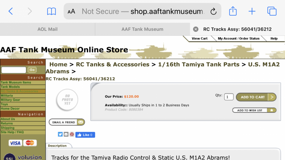

The Mato tracks will work with the metal Heng Long sprockets. Now if you want the absolute BEST tracks look at a set of Tamiya Abrams tracks. They are nylon, metal and rubber padded and 1/4th the weight of Mato or DLKM tracks yet just as strong. The rubber is slightly “harder”and this allows for better ease of handling on surfaces like concrete or asphalt. The Tamiya tracks are also the most accurate in overall looks. They are NOT cheap at $250 a set but you truly get what you are paying for. Yes they work with HL sprockets.

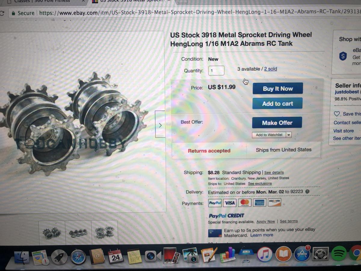

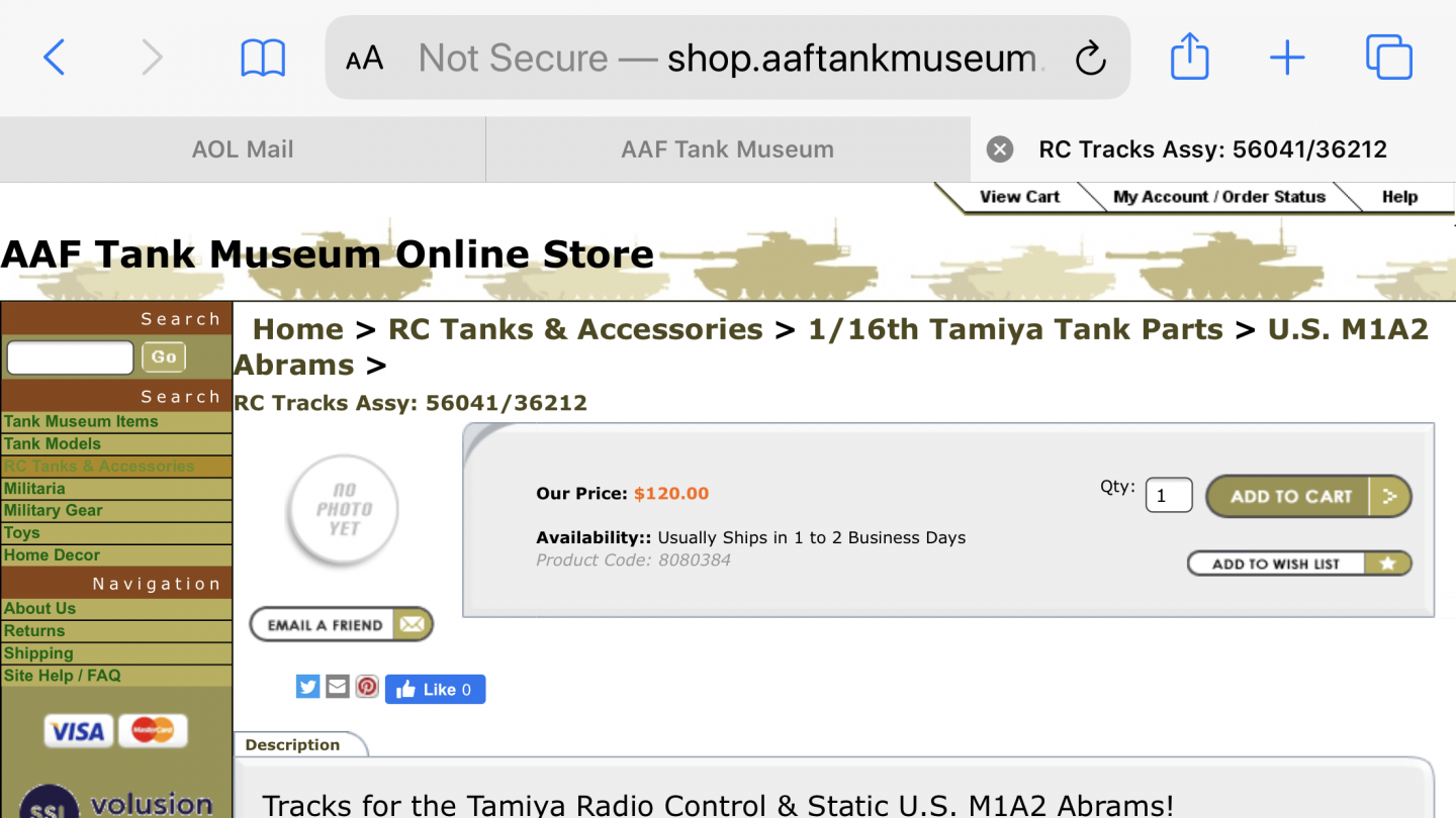

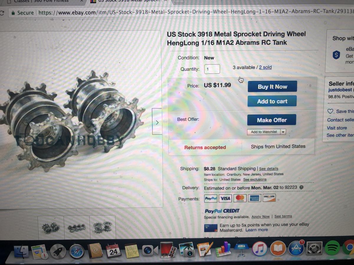

Try also looking on EBay. Just search Heng Long Abrams sprockets and tracks. You should get a fair number of options.
