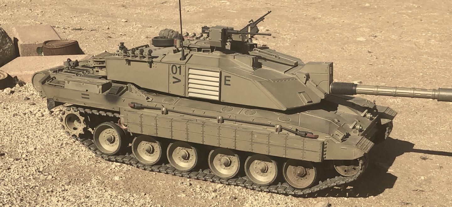

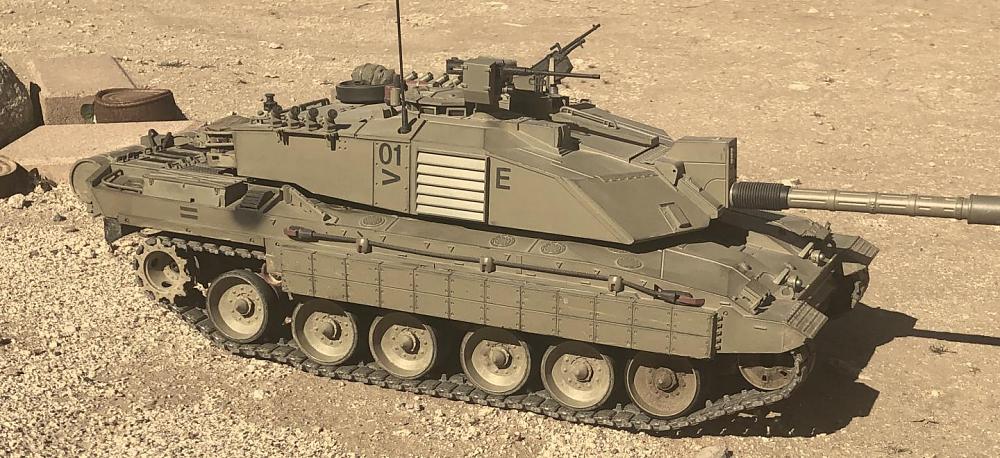

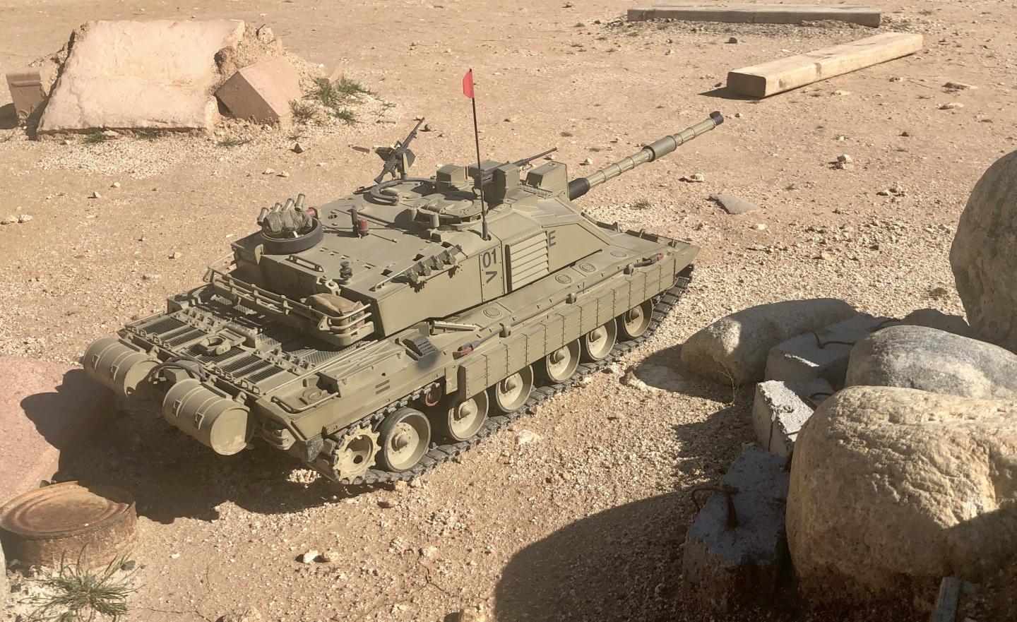

                • Originally posted by karltrek View Post
                  I would love to see some photos. Thanks again for the information.
                  Here are a few that show my Challenger 2 with Abrams metal/rubber padded tracks and Abrams sprockets.

                  • Originally posted by Rubicon99 View Post
                    R9, Great detail and upgrade, I really like the looks of your Challenger 2, Sir. Best, LB
