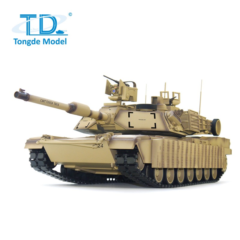

                                  • Shantou Tongde post several 1/16 scale new tanks on their website, including 2 versions of Abrams with torsion bar suspension and several Shermans.
                                    The Abrams have made it to the Toucan Hobby China inventory. I have not seen an online review yet. I hope that Tongde would make the Abrams to scale so that I can use Tamiya tracks on it. Price is very good for a torsion bar suspension MBT.

                                      The TongDE Abrams, from what I've seen from pics, has the worst scale details of any of the Abrams on the market including the Tamiya, the Heng Long, the Hooben, the Trumpeter static kits in 1/16, and even the Hobby Engine. It's your money though.

                                        I am very disappointed to hear your comment. What I am looking for is an inexpensive 1/16 scale Abrams with torsion bar suspension and well fitted suspension arms. I have the Tongde US Patton M60A1 which met the above 2 expectations, but the track is completely off scale. Well, when I go for cheap, I can't have everything. My bottom line question is whether the Tongde RC Abrams looks like an Abrams. The Tongde Patton does not look like a Patton because of the extra wide track. But it is one of the best running tank in my small collection. I am surprised that there is not an aftermarket track/sprocket set that corrects the problem yet.
                                        • If the lower hull with tortion bar suspension is of sufficient quality, perhaps you could mate it with a heng long or trumpeter upper and Turret? Maybe both, even, if you have deep pockets? This is one area where building RC tanks is kind of like building muscle cars. Really nice tanks cost money, how nice do you want yours to be? That doesn't sound as cool as "Speed costs money, how fast you wanna go?", but I think you know what I mean.
