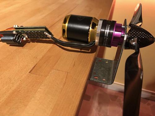

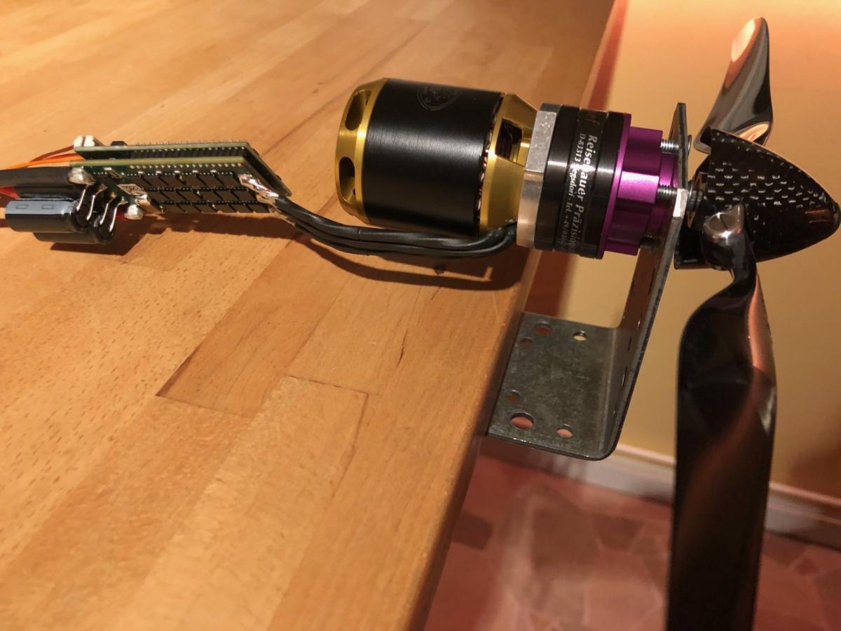

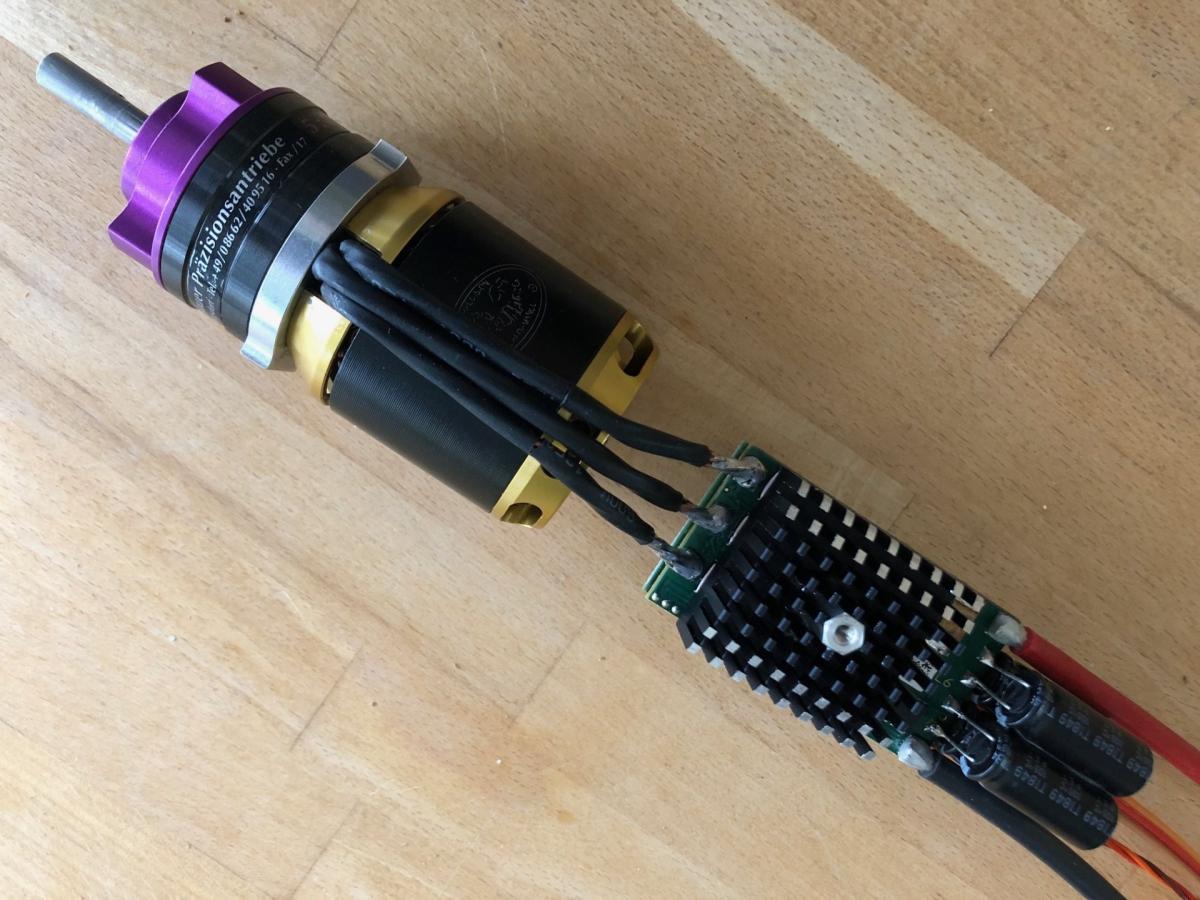

    Hi Dr I did finally fing the weight of a HK 3226 on a superchief 5.1 from the other tuner that actually post his numbers with nothing to hide. Now the boys can surely can ger excited about my little power dwarf in a speedfire2 or similar hotliners or F3S speed planes After reading this data .
    Have a read Squawkers and enjoy the photos.... :stuck_out_tongue_wi
    "Hello Steve,
    you can rejoice, the 3226 with the 5:1 Superchief has even set a new record.
    I decided on the 5:1, because with the gearbox drive, the power comes more from the speed.
    As a 10 poler, it rotates a maximum of 49000U on the YGE, which it does without complaint, which is then 9800U, I don't need more than that accelerated with the GM18x22.
    I wound it with max. filling degree to 1160U/V and operate it on the modified Opto135 with 3x SLS 4s1800 2NOC.
    Click image for larger version  Name:	img_0580-jpg.12082084.jpg Views:	0 Size:	92.4 KB ID:	432757
    The 350g drive turns the GM18x22 with 8800U at 9.9kW 43V 230A on the test bench, and even with 80% efficiency at 88% speed stiffness, all measured with Unilog2, according to the speed calculator at least 12kg thrust.
    After 5x 3sec with a 20sec break, the gearbox has 50°, the motor 70° and the ESC 75, all without cooling air flow on the test bench.
    But the ESC gets a heat sink that is screwed tightly to the top of the fuselage so that the motor cables do not drag on the bell.
    So the 250g motor has an output of 40W/g and thus takes the lonely lead, it had already struck me very positively 8 years ago.
    However, it is already waving the white flag, the synclostprotection in the YGE has already mentioned so that it reduces the PWM to 99%.
    When the voltage drops and the load falls in the air, it quickly goes to 100%, so it's designed just right.
    Amazing that the 2NOC cells last at 48° before heated 125C with 3.5V/cell for 1-2sec, after that the load so the current decreases by 40% anyway.
    The gearbox still seems underchallenged, only the GM spinner is at its torque limit, the shaft flattening is counterproductive.
    If Christian's feet fall asleep, I still have the GM17x26, which is rotated at 9200U and should allow climbing over 100m/s.
    When the 2nd fuselage is there, everything will be installed, hope I can get in the fuselage with the engine cables, I'll get to just under 2kg so 5kW/kg.
    Then it's time to wait for good weather again."
    VG
    Thomas (Schmiddi)

      350 grams for the complete drive is what is stated. I guess that's why Dr Okon would not report it .​ So my drive according to the other tuners calculations does greater than 40W/g. So it doesn't lead US....
      Click image for larger version  Name:	image.png Views:	0 Size:	1.29 MB ID:	432770
      My current 328.1 gram better cooled XNOVA 3226 geared drive complete here with spinner and prop on the scale in fact increases the already better power to weight ratio even if I use the Clugh rewound pyro 600 with the maxon gearbox versus the xnova. The maxon gearbox power handling is just as good as the super chief. The Pyro is the lightest of all three motors.
      Is this is why you are here but remain remotely silent about such things. You and your friends know 328 grams is pretty good if you weigh 350 grams and get thumbs up Ralph. I see your enigma, Thomas the tuner, reported the GM 17 X 26 on the 5:1 super chief can generate 360 km/h. That's interesting
      As well as the fact that his scorpion powered drive is actually 39.6 W/g based of his own data and the Clugh pyro power drive is well over 43.04 W/g.. So ill be dammed if Thomas's or your HK 3226 powered super chief drives are lonely out front. They are in the rear view mirror in America because not only is the motor and Maxon gear box 32 grams lighter with everything mounted, the lighter the pyro its self is 20 grams lighter than the HK and it is more efficient and makes more power. I guess you have to be mad at Thomas for reporting the rainbow drive weight and performance.

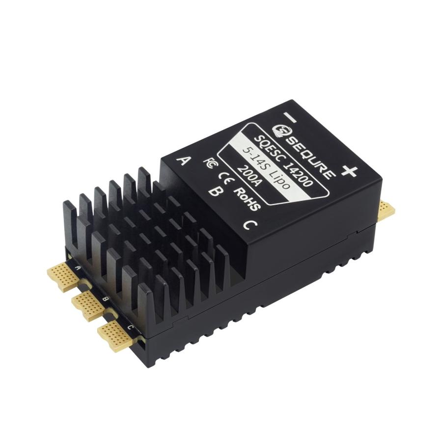

        My 12200 has been with me since yesterday - good, because a few days ago my last YGE "special" quit the service after many years. Btw. Like the 400 again in an idle test....."
        ~powercroco~
        Oh thats tragic :cry:
        And to be clear Dr Okon the 12200 $89.00 sequre will be the next piece of fine china that breaks on your bench. Common sense would have at least purchase the 14200 pro with 350 amperes of burst current and quality BEC for 103.00 dollars. It already has the more effective heatsink....
        it is 293 grams!!!! :hot_face:
        We also gone see how many good years of service you get with Xi'
        Even though I know you are going to get the smoke anyway. Good luck and please get some electrical safety training for higher voltages. I have no idea what the equivalent is there to NFPA 70 here in the united states.
        :fire:

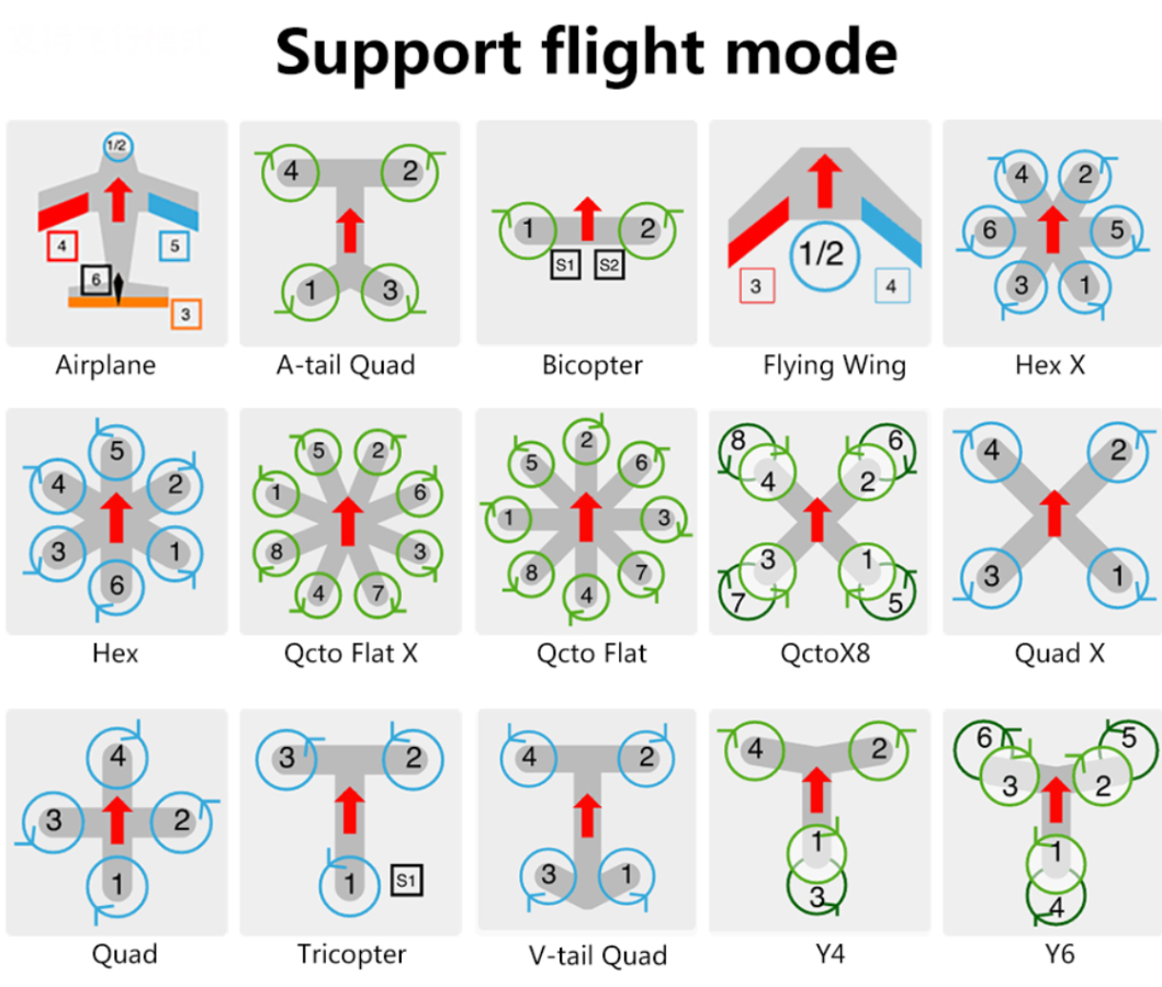

            BTW
            The flight card arrived. It is an OmnibusF4SD F4V3S flight controller
            Click image for larger version  Name:	image.png Views:	0 Size:	1.01 MB ID:	432814
            Click image for larger version  Name:	image.png Views:	0 Size:	986.7 KB ID:	432816

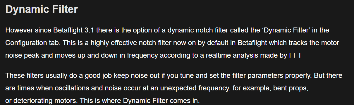

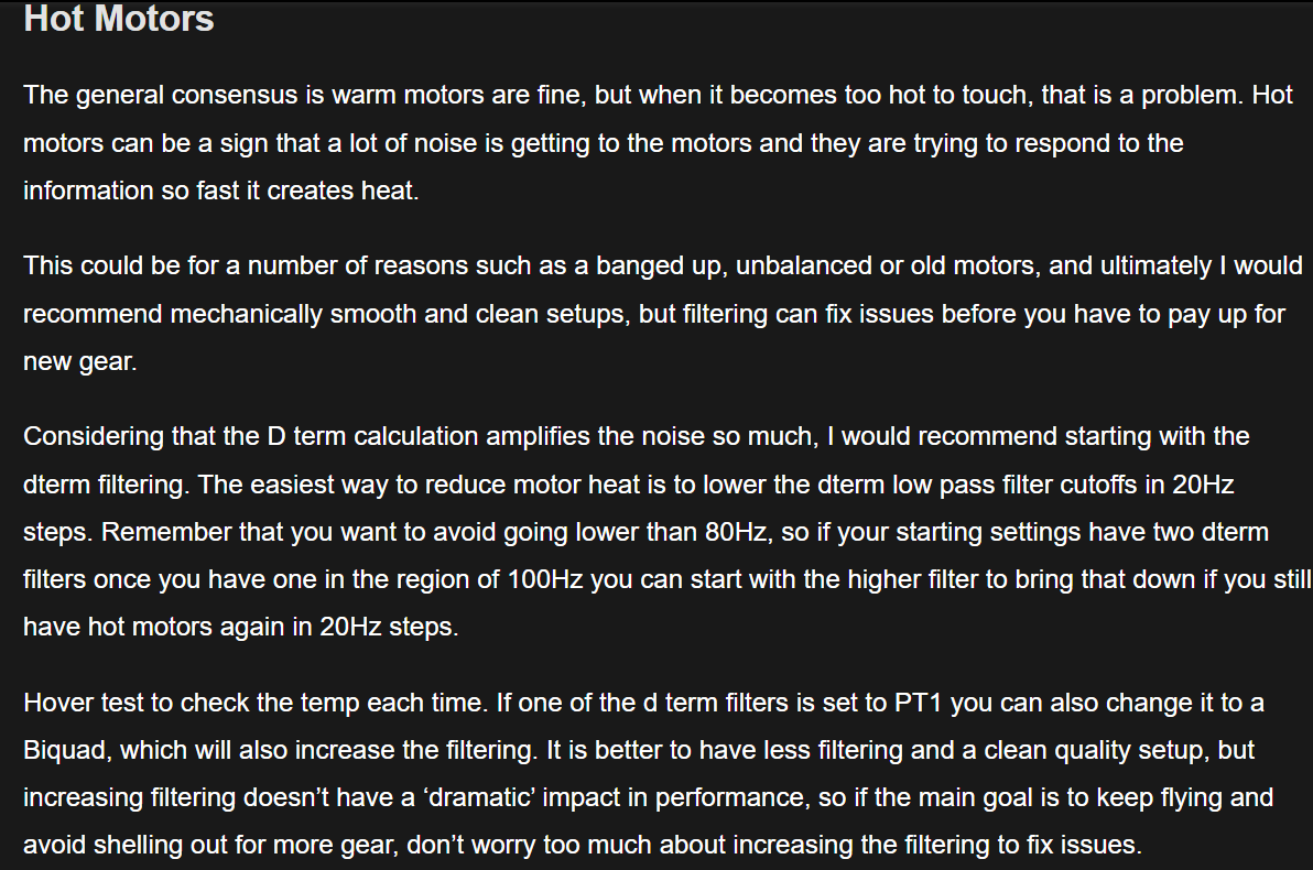

                Betaflight Filtering 101 - Oscar Liang
                What is RPM filter?
                Notchfilter sind hochwirksam bei der Rauschunterdrückung und führen zu einer geringeren Signalverzögerung im Vergleich zu Tiefpassfiltern bei gleichem Dämpfungsgrad. Mehr über Filter erfahren Sie in unserem Betaflight Filter 101-Kurs. Die Herausforderung besteht darin, die Spitzenfrequenz des Rauschens zu erfassen. Dynamische Filter können dies zwar relativ gut, erfassen aber nur eine Frequenz. Da die Motoren einer Drohne mit unterschiedlichen Drehzahlen (Umdrehungen pro Minute) rotieren können, erzeugen sie Rauschen mit unterschiedlichen Frequenzen. Der Drehzahlfilter von Betaflight ist ein leistungsstarkes Tool, mit dem der Flugcontroller Ihrer Drohne die Drehzahlen (U/min) Ihrer Motoren über bidirektionales DShot erfassen und eine Reihe von Notchfiltern genau auf diese Frequenz und deren Oberwellen einstellen kann. Diese Funktion hilft, Vibrationen durch Motoren und Propeller zu eliminieren und so die Flugleistung zu verbessern. Dynamischer Filter Seit Betaflight 3.1 gibt es jedoch die Option eines dynamischen Notchfilters namens „Dynamischer Filter“ im Reiter „Konfiguration“. Dieser hochwirksame Notch-Filter ist jetzt standardmäßig in Betaflight aktiviert. Er verfolgt die Motorgeräuschspitze und variiert die Frequenz entsprechend einer Echtzeit-FFT-Analyse. Diese Filter halten Rauschen in der Regel gut fern, wenn Sie die Filterparameter richtig einstellen. Es kann jedoch vorkommen, dass Schwingungen und Rauschen mit unerwarteter Frequenz auftreten, z. B. bei verbogenen Propellern oder verschleißenden Motoren. Hier kommt der dynamische Filter ins Spiel.
                Hallo Okon,
                Siehst du, wie offensichtlich es ist, dass du und die acht Piloten nicht wissen, was es mit Motorumrichtern und -steuerungen auf sich hat und wie man sie im Speedflying einsetzt? Du solltest mehr lernen, als du schreibst.​​
                Danke
                Hubert

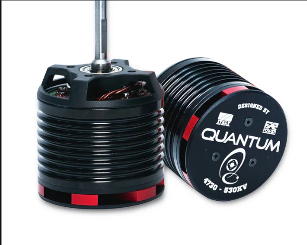

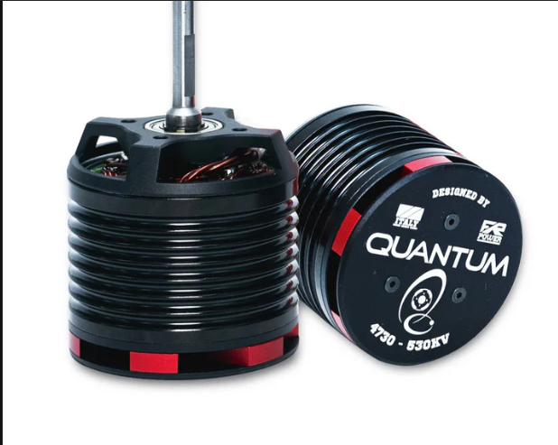

                      BTW Fabrizio Russo of FR power has contacted me about tuning his 4730 motor.
                      FR Power
                      Der rosa Motor ist auch hässlich Ralph. :see_no_evil:

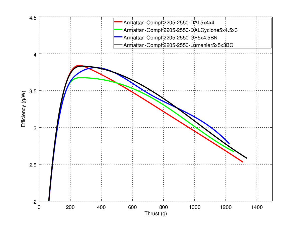

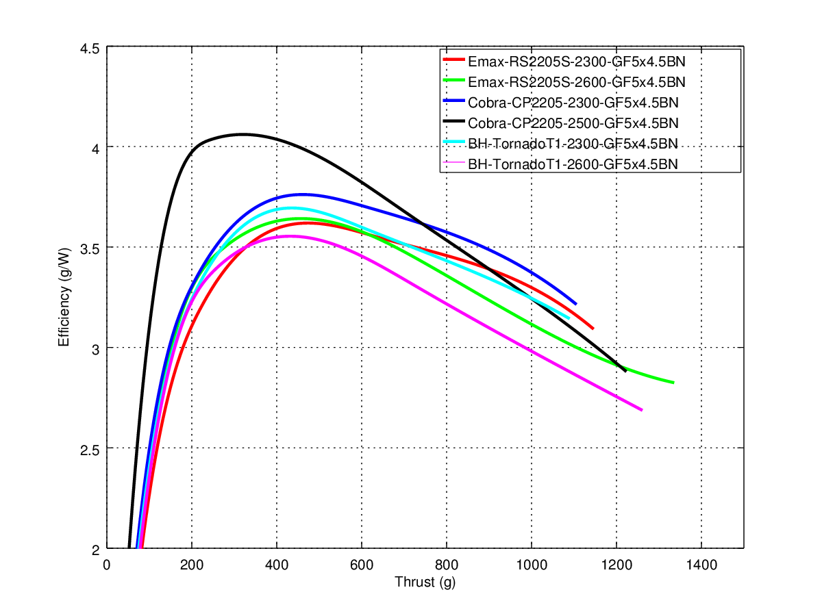

                              "So I thought I should analyses the performance of some other candidate motors with the GF 5×4.5BN prop, to see how they compare to the RS2205S. For purely personal reasons, the motors I chose were the Cobra Champion CP2205 and BrotherHobby Tornado T1 2205. For all motors, including the Emax, I plotted data both for the mid-kV model and for the high-kV model in the range.
                              2205 motors with Gemfan 5×4.5BN prop
                              This was a bit unexpected, and most interesting. The CP2205-2500 beat all other contenders by a fair margin below about 730g thrust, which is about 60% throttle.The efficiency drops off significantly in the upper 40% of the throttle range, where its sibling the CP2205-2300 is the most efficient. It’s quite surprising that the low-kV motor is most efficient at high RPM, while the high-kV motor is most efficient at low RPM! Of course the CP2205-2500 does have a significant advantage in maximum thrust due to its higher kV rating, although this comes at the price of moderately high 27A current draw."
                              ~Midrange Motor Efficiency Analysis | RF Eng FPV~​
                              Its all old news (2017). Do you see where bruder hobby ranks in this test?
                              With that I have no more time today for this nonsense in Germany. I already told you 7 years ago an emaxx will easily out do the bruder hobby.
                              If you think i picked up the EIII emaxx arbitrarily to test beside the AOS you are sadly mistaken. It is already known through AOS's testing that the Emax out does it in total output. The AOS is less than 2 grams lighter. I have the bs here on the scale!!!! I picked the motor up because I already have a very good idea what it is capable of . The fact that emaxx manufactures about 90% of the drones motors produced world wide then there also that to consider. You may be running a "B" grade emaxx anyway....
                              TTYL
                              Hubert

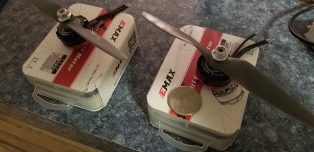

                                It should be interesting to see the results here because off the shelf it is IMO a noisy bi filar winding in the FRpower 4730 and that is probably why they would like to see what I can do with the engine to improve efficiency. Mechanically it looks like a solid roomy foundation to work with.
                                Thanks for your time and patience,
                                Hubert
