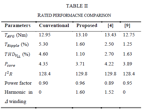

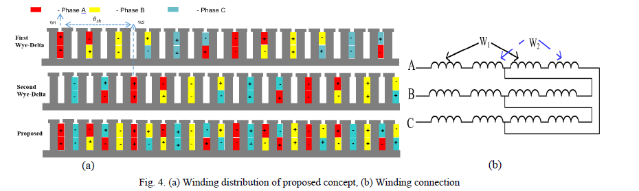

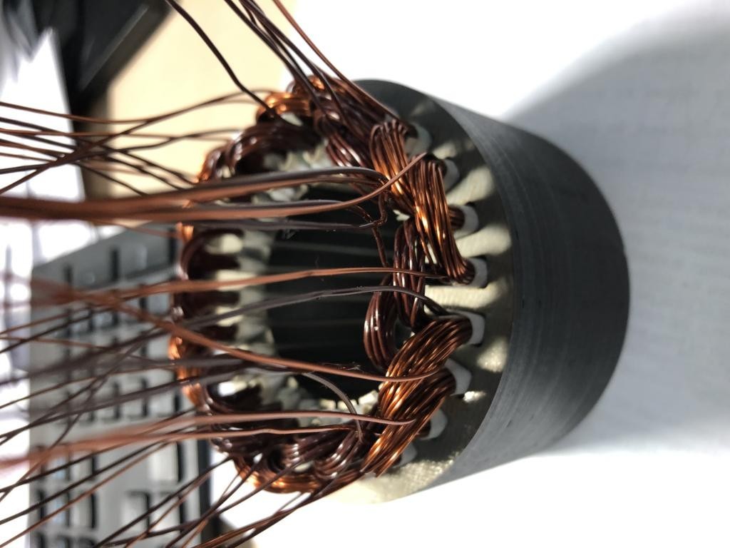

        The NC STATE D.E.E.C.S. Used a special winding as a migration from the 12N10P machine to a 24 slot 10 pole. It is based on 2 sets of wye to delta windings connected in series. This showed a 1.25% increase in average torque. It reduced torque ripple from 5.3% to 1.25%. It also reduced the THD. from 4.6% to 1.1%. The simultaneous reduction of super and sub harmonics increase the power factor of the machine by 7% and the core loss performance by 15 %.. Pretty significant improvement form the DL conventional winds done here as there power factor is .90 and this is.95 . This technique also applies to SRM's, and IM's. Attached Thumbnails
        Type (9) was Dr Gerling and Gurukuq's​ version.

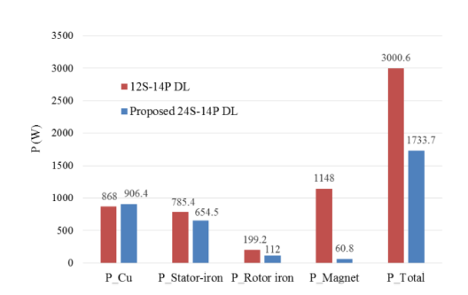

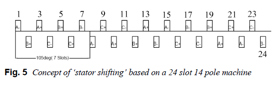

          Who will really tell them that the difference seen here in pm performance of a 24 slot 14 pole hybrid machine is not worthy of a speed plane motor that failed from demagnetization.
          It also incorporates a stagger of 7 slots between the winding sets. The magnet loss was reduced to 60 watts in the hybrid versus 1148 watts in the conventional wye..
          The machine makes more torque and throughput power. running so much cooler with much less electrical noise.

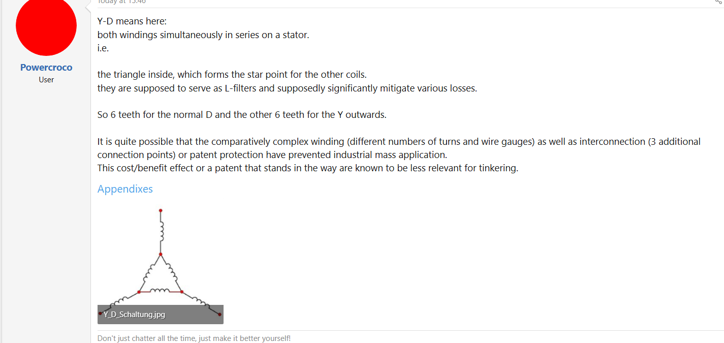

Name:	24N10P y-d winding arrangement with 5 slot shift. (1).png
            Apparently you cannot wind it.

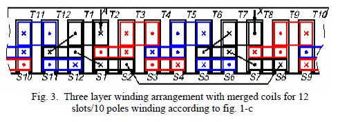

              Click image for larger version  Name:	a1619387-26-3 layer winding.png Views:	0 Size:	17.6 KB ID:	431539
              3 layers 12N10P .:point_up:
              You have never wound it so how do you know what any of it does? I hope its clear now to everyone including your friends in Germany that no you Dr Okon do not have any relevant data.on the subject matter And that you are here looking at mine at 1:45 AM est. USA

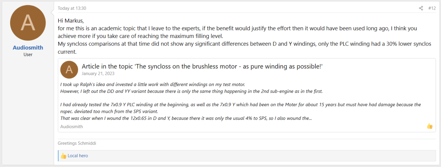

                            Und genau wie Herr Audiomith sagte, weiß er nichts davon und sollte es den Experten überlassen! Er weiß nicht einmal, wie Wechselrichter funktionieren. Oder wie man einen eigenen FOC-Antrieb in Betrieb nimmt. Er „kennt“ Messungen, kann aber seine direkten und Quadraturinduktionen nicht ableiten und sie einfach in die Motormodellparameter des Wechselrichters eingeben. Er kann also keine einfachen Anweisungen befolgen …

                              Weder Ralph noch Thomas haben eine Ahnung, wie hoch die D- und Q-Induktivitäten ihrer konventionellen Motoren mit konventioneller Wicklung sind. Von Hybriden haben sie definitiv keine Ahnung. Sie besitzen nicht einmal die nötigen Messgeräte. Nur ein weiterer Hobbyist, der über etwas schwadroniert, von dem er keine Ahnung hat. Deshalb ist der ganze Thread eine einzige große Frage …
