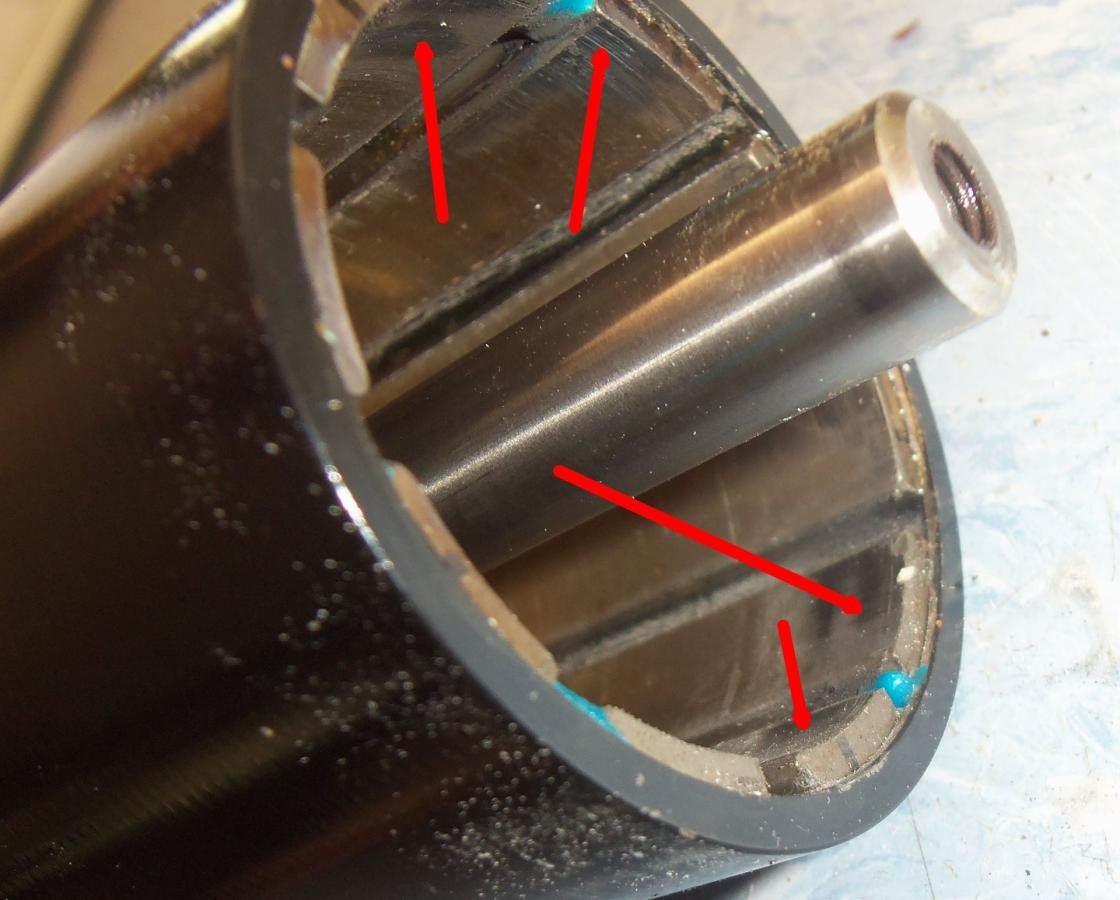

          • And yeah I know powercrocos scorpions with the 2 cheap steel bearings are known for that poor radial support. Here is where his 5050 rubs the bell and stator together and chips the PM. Surely an anomalous inconsistent BEMF wave form preceded it. I have 2 here's on my desk that are the same way except the stator actually shifted and I had to glue it back into place.
            Click image for larger version  Name:	100_3118 (1).jpg Views:	0 Size:	225.0 KB ID:	416591 Click image for larger version  Name:	100_3108A (1).jpg Views:	0 Size:	126.2 KB ID:	416592
            They were also slipping the endbell that connect it to the shaft or scorpion wouldn't have added the bell set screw on the side you see in the IV versions. The A series is a better machine than the HK anyway.

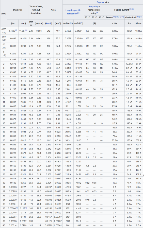

                        • Click image for larger version  Name:	image.png Views:	0 Size:	147.0 KB ID:	416640​Hi Christian,
                          I read your post and would like to say In America for this wind Id chose 25AWG which is .455 mm in diameters. Our sizes are always a hair larger than the wire used in Europe. The values are always slightly different winding AWG. It also mean the fill would be slightly more than what he has done and obviously looking at all the airspace it will fit.
                          There you have half sizes so that is really nice for a winder to have that option. They don't seem to use it much.
                          Thank you
                          Hubert

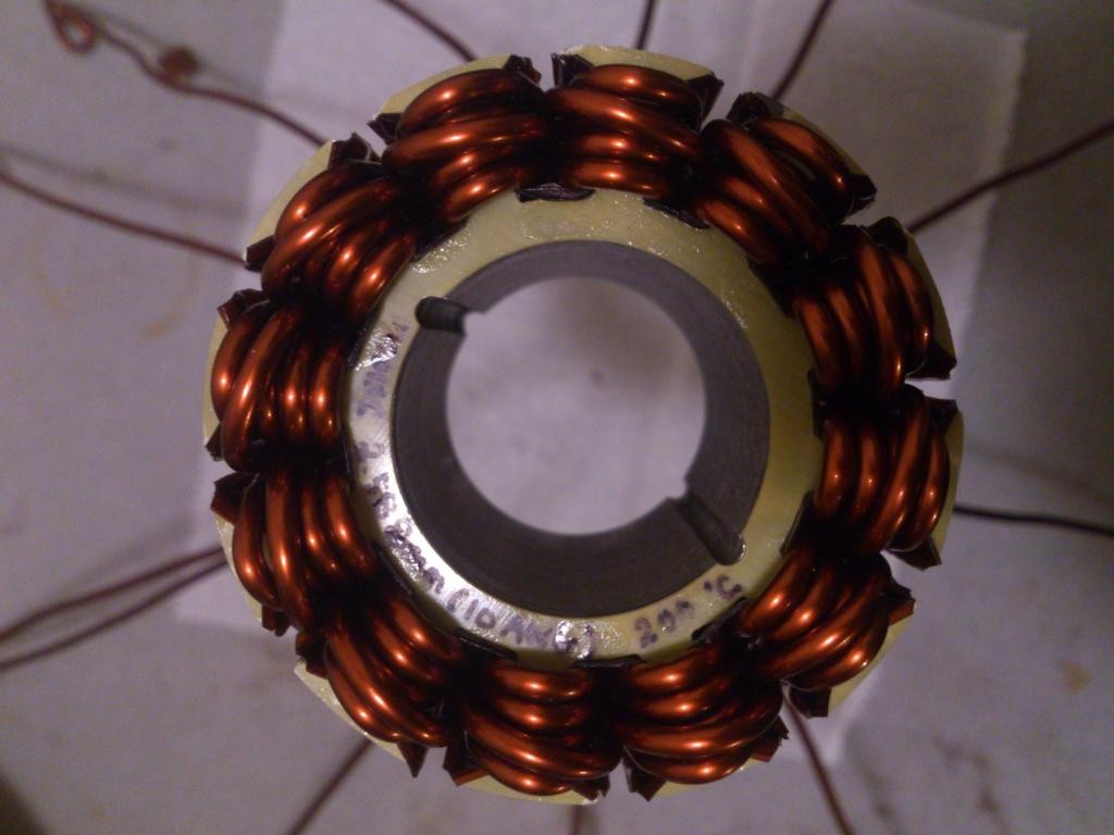

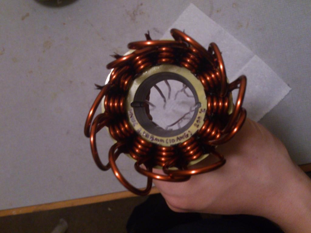

                          • Click image for larger version  Name:	QQ__20141218212009.jpg Views:	0 Size:	109.7 KB ID:	416642In Big wire winding Modisc 7050 wit 10 AWG is still the king as far as I'm am concerned . 2.5mm. is a thick wire to handle. Of course Ralph was jealous and had something negative to say. They trolled him till he just left the forums. He is another EXCELLENT hand winder. Most of their time is spent being jealous of other competent winders. Ralph talks alot about the ability of Chinees peoples. Modisc is in fact Chinese American. If you look at the size he has written it appears the wire has around 40 microns of insulation in his example but the minimum diameter is always is met.
                            They're Big Haterz!
                            • Mr. Ralph was just as jealous as he could be. He couldn't praise it. But I like it much better than his parallel bi filar stranded HK . It truly isnt a bifilar coil where a coil loop is actually wound around the tooth. They describe it wrong technically. According to the AFD from Dresden the Chinese are poor engineers but scorpion is head quartered there. And it also doesn't explain what you see here from the Chinese American Urologist. Which is incredible actually.
                              Of course I congratulated him while Ralph's fans hated as usual. They are the disruptive ones. I would not be surprised if they pushed Bert Dekker quickly to the finish line.
                              I dont like it because Bert does a great job he is not arrogant and a really nice guy from my experience talking to him. Nver had an issue saying " nice wind " . Sometimes room is not left for the less controversial. Bert Dekker is a damn good PERSON then winder they lost Chris.

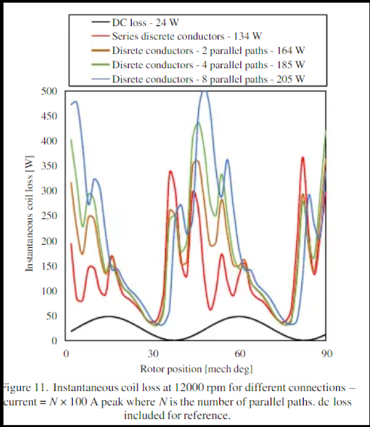

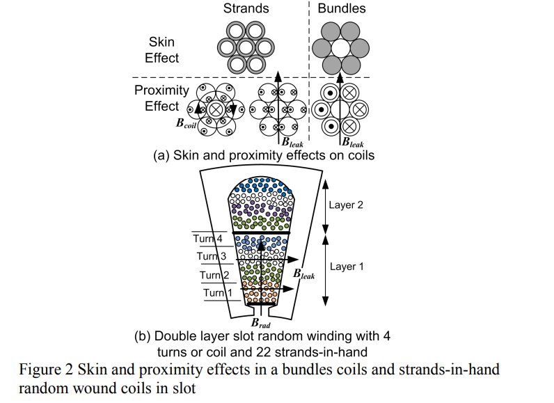

                              • Click image for larger version  Name:	figure 2.png Views:	0 Size:	156.7 KB ID:	416647
                                Because all he ever cared about was the lower DCR I don't think the little boy in Dresden ever compared the efficiency of the single wire system versus the 2 strand that is 4 strands into each motor terminal in a parallel wye. The DD is is even worse bilfilar. Too many parallel strands at 1.32mm running unbalanced current between the two wires at every level in the slot. I don't want it! Too much ac noise at high rpm for me. Youd think he'd care to find out all what really works best at 79%. Irrespective of the dc resistance because the motor doesn't run at extremely low rpms or at DC (Stall). His 70 series idle current data shows him it is a bad idea but the guy needs a manual and is extremely hard headed. His bundles see skin and more prox effect than the single so he may as well wind just the one big wire if he is going to multi strand in 1.5 and 1.32mm untwisted conductor. At low speed and low frequency that would be fine and why it works at 2 s lipo but at high rpm where it makes it's (full power) it is a total wash in better efficiency based on the lower DCR.
                                Oh well.
                                • Click image for larger version  Name:	okon wind.png Views:	0 Size:	299.3 KB ID:	416649
                                  The loud mouth hobbyist in Germany will question others chart reading abilities but it seems to me it is he and his friends that have major difficulty reading and interpreting charts and data from the PHd in the field on electrical engineering. This is Dr David Dorell's work. Look at the RPM and power levels tested.
                                  How many times have I shown this German this chart!!! They cannot see the additive loss of additional stranding or the fact that AC loss is as much 10 times higher than the DC.
                                  The information is right down his alley and you can track the phenomena with his 70 series machine.

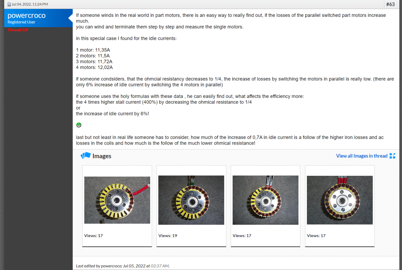

                                    • Click image for larger version  Name:	image.png Views:	0 Size:	594.9 KB ID:	416653​So you see 80% eta is what all the part motors and parallel strands amount to. You pay over 1000 euros for it.
                                      • Motor 1 733.664 watts lost at idle
                                        Motor 2 743.36 watts lost at idle
                                        Motor 3 757.34 watts lost at idle
                                        Motor 4 776.7324 watts lost at idle
                                        But he cant see that additive effect. Or that this is well over a loss of a horse at idle. But you see the same 80% eta....
                                        The motor almost falls directly into Dr Dorells data on the subject matter.
                                        So what did the lower DCR from paralleling all the strands do for Ralph?
