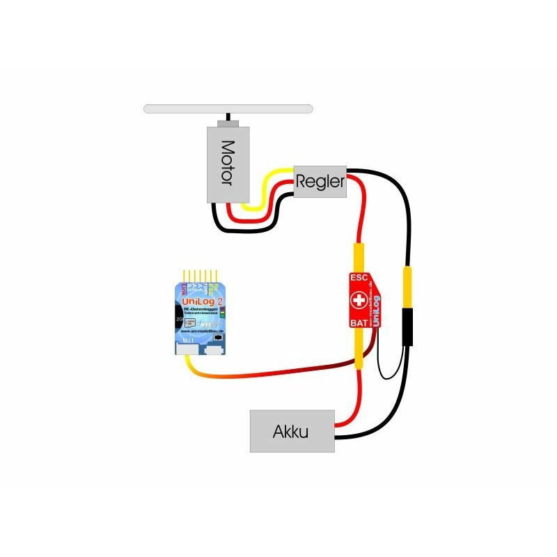

    Ampere Gerd ist überhaupt nicht gültig, da er die tatsächliche Leistung der Klopfer berechnen könnte, nicht den Verbrauch anhand eines Wattmeters. Diese Seite ist ein Witzbold.
    Die Idioten haben vergessen, was eigentlich am Propeller passiert

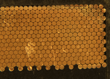

          #2244
          The average industrial wind is around 44% fill the best anyone will do in hand winding is probably 60% fill A slower tedious task but you will never in an orthogonal lay with round wire out fill a square wire in a square slot...
          That's a really dumb idea.
          DUH!

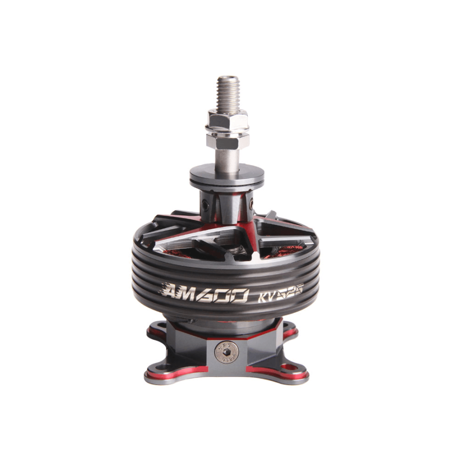

                      Click image for larger version  Name:	B45B5352-308D-425E-9D86-B9DBBF11D685.png Views:	0 Size:	231.7 KB ID:	416233
                      The Lehner outrunner

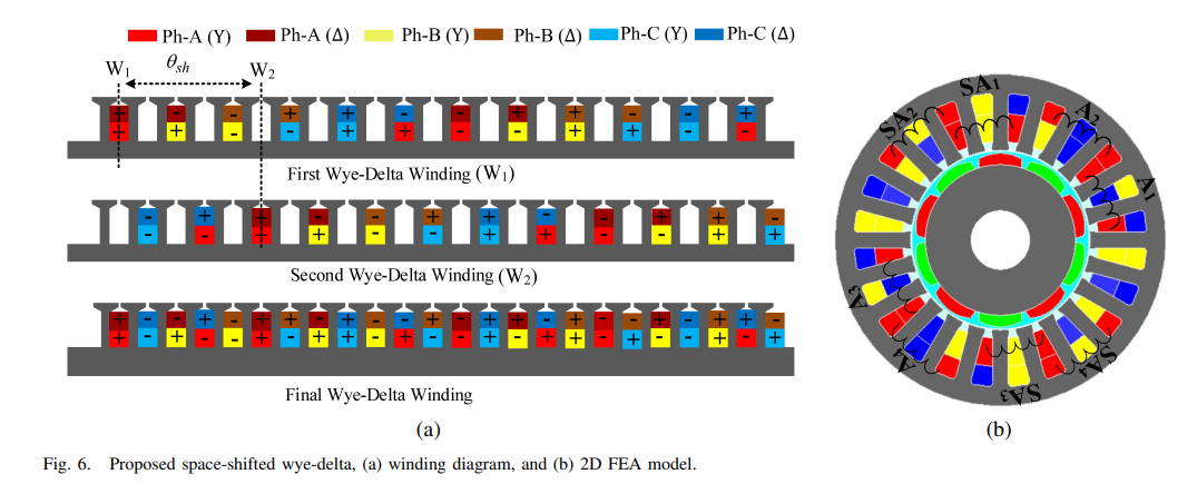

                                  Click image for larger version  Name:	24N10P y-d winding arrangement with 5 slot shift. (1).png Views:	0 Size:	40.8 KB ID:	416267
                                  If they were truly Advanced like the real brains in Germany they would be winding the multilevel hybrids on a two 24N20P 2 pancake machines in a counter rotational coaxial setup and be under 700 grams with the drive. The rotor and PM's are fully shielded by this semi concentrated overlapped winding system from Drs. Dieter Gerling And Dajaku Gurakuq at the University of Bundeswehr in Munich Germany. These are the EE's with the relevant PhD. The efficiency and power factor in such a machine is second to nothing that Powercroco and his friends do @ 79% eta. There is significantly less PM and iron loss with this so it makes better use of the available iron and magnets no matter what machine you wind it into. It would perform exceptionally in a high speed high pole count machine because that's what it is for.
                                  :exploding_head:
                                  Get some rest sucka...😀
                                  Hubert

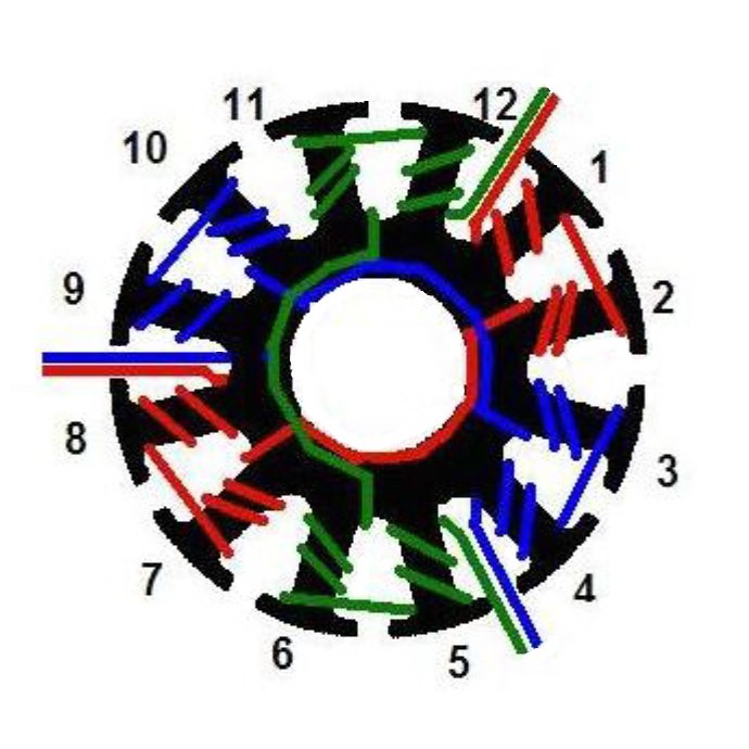

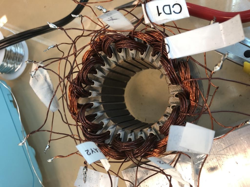

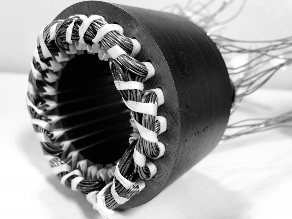

                                    Why do you all think the LEADER is here? But of course it is winding school. From true leaders in the field of study. Let me take you back to the first page of this thread and why Dr Ralph Okon AKA powercroco camps here in my house with his 11kW Knocker at 79% eta. he and his friend rant and rave about. I want you all to look closely at the efficiency map of the TRUE 35kW machine. 79% is no where around. Look at the torque delivery.
                                    Click image for larger version  Name:	fetch?id=386402&d=1694614595.png Views:	0 Size:	289.7 KB ID:	416270
                                    Click image for larger version  Name:	attachment.php_attachmentid=860687&d=1590520160.jpg Views:	0 Size:	165.7 KB ID:	416271
                                    Dr Sariful Islam version he sent me personally pictures of. This is directly ABB's and has been studied by them. The knocker winding is a paperweight winding compared to this. When you talk about industry and cutting edge windings you would be focused on this. Ill just tell you real. That little crap the goof troop does is child's play....
                                    :baby:
                                    Sincerely,
                                    Hubert
