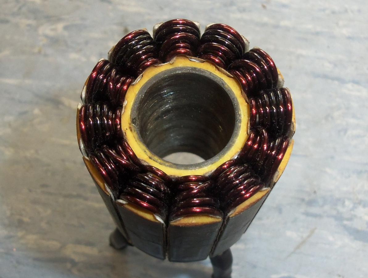

      Click image for larger version  Name:	100_3107-jpg.12761694.jpg Views:	0 Size:	107.5 KB ID:	408322
      Yes Thomas's windings are darkened here Ralph and pilots can run the motors to overload. But that is the same for all of us . The question is how well is your motor getting rid of the heat at those times. As Lord has shown its critical to the seen resistance of the wire.

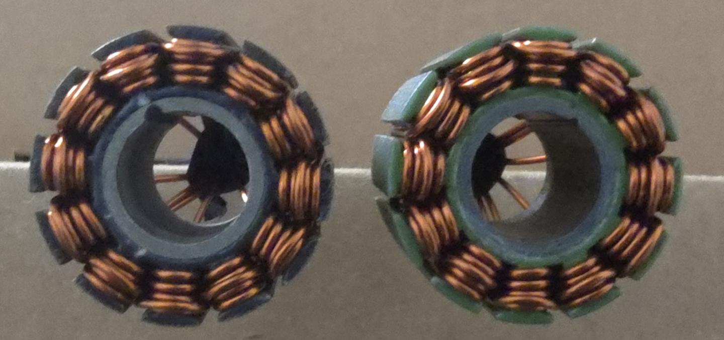

          Click image for larger version  Name:	20240805_031607.jpg Views:	0 Size:	101.4 KB ID:	408381
          2 more 600s down these are Randy B's pair. They go out later today after I pot,terminate and measure them. Then run them idle and with a load on the bench.

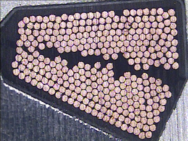

              UserClick image for larger version
              And that this has nothing in common with a real potting.
              It would look like the first picture. ALL spaces in between are completely filled without bubbles.
              this is only possible with vacuum - although even the potting compound must be degassed beforehand if it is to be good.
              Not as in the sketch above, that nothing of the smearing between stator and wire arrives (light green area).
