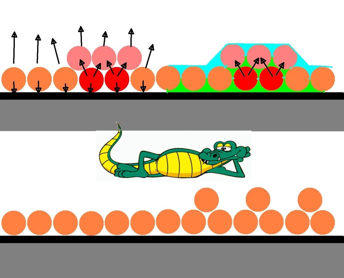

    • das ganze Kupfer ist auf jeder Ebene ein Heizkörper, Idiot. Ich liebe dieses alberne Diagramm, das Sie nirgendwo in von Experten begutachteten akademischen Veröffentlichungen finden werden.
      Amateure versuchen immer, ihre eigenen Regeln und physikalischen Gesetze zu erfinden, die noch niemand zuvor gesehen hat.

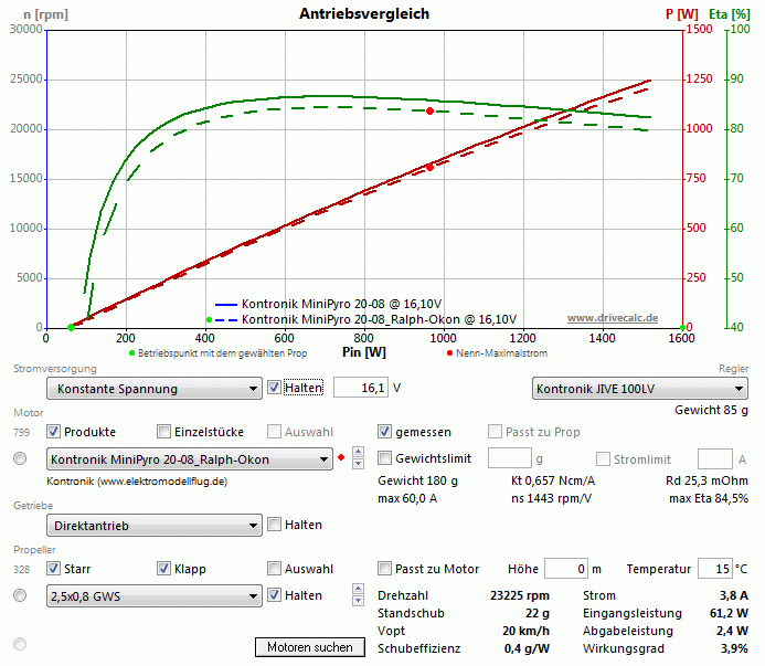

              • Click image for larger version  Name:	mp-ro-1.gif Views:	0 Size:	33.2 KB ID:	408225
                Does Martin have anything to say about it? Do You? Ask Micheal and VP why no thumbs went up there on this?

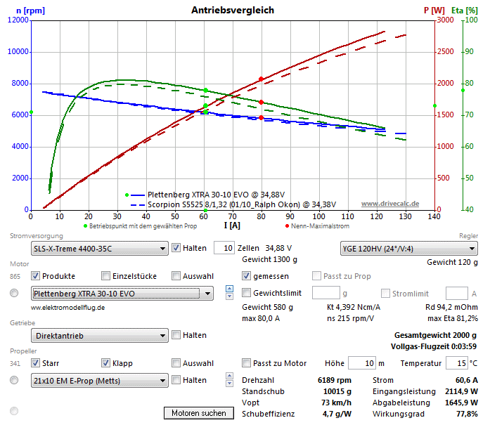

                  • Click image for larger version  Name:	xtra-v1 (2) (1).gif Views:	0 Size:	37.3 KB ID:	408229
                    same thing with the Plettenburg. It actually lost efficiency after you wound it. I hope your fans can see well. 👀

                      • Click image for larger version  Name:	mp-ro-1.gif Views:	0 Size:	33.2 KB ID:	408232
                        Modelers can plainly see from the graphs generated on the German social media that Powercroco is hardly always an improvement. Here are the graphs now ya'll deal with it.
                        That said I have things to do like secure this industrial printer. I dont have time for nonsense from the far east. Lying is the hobby for some of us.
                        That much difference in efficiency equals a difference of throughput power by a factor of 1.5-2 thats very significant to the thermal performance of any machine.
                        When you are more efficient with more copper cross section in the slot you are running cooler by design.

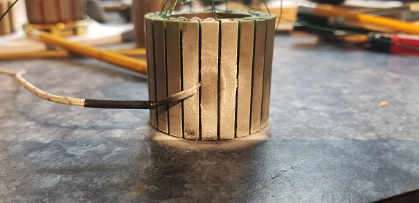

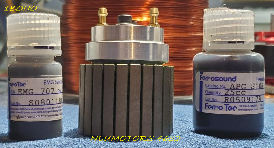

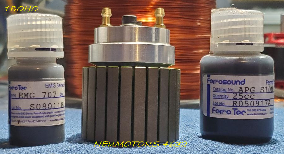

                        • Click image for larger version  Name:	20240628_211542.jpg Views:	7 Size:	140.7 KB ID:	408236
                          This is what you pot the motors in not endfest which could not take the cryogenic shock. I dont and never will have your cooling issues.
                          In America we stay 1 step ahead.

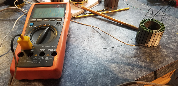

                          No CAD but real photos of extreme cooling
                          Click image for larger version  Name:	20200103_174558.png Views:	3 Size:	427.0 KB ID:	408235
                          Click image for larger version  Name:	20200103_174615 (1).png Views:	3 Size:	333.4 KB ID:	408234
                          Now u do what you want but you wont be more efficient than me with endfest or nothing at all.
                          Good Luck.....

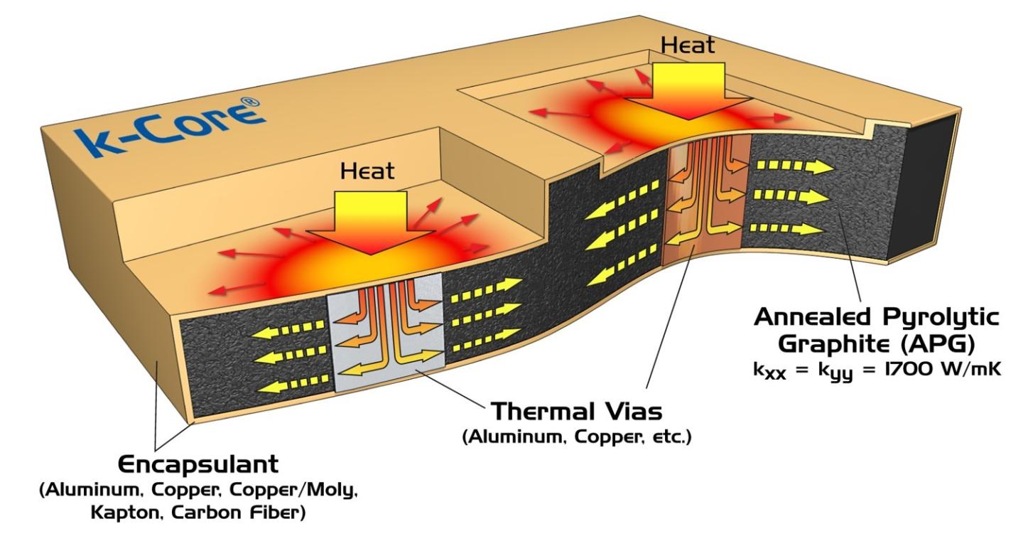

                              • Click image for larger version  Name:	s-l1600.webp Views:	0 Size:	4.8 KB ID:	408249
                                He doesn't know anything about the thermal conductivity of pyrolytic graphite Chris . You are well beyond his element of understanding. You should see the Thermal conductivity of SiC!!!!!
                                And I see why scorpions run under 90% efficiency now with these expert accounts. If what they said had any validity 3 and 4 layers machines wouldn't work and run hot but they do work & very well in vehicles like the E range rover or the Formula one Jag powered by Wolfspeed.
                                • So ein Idiot.
                                  Bei einer verteilten Wicklung sind die Drähte immer in mehreren Lagen gewickelt. Warum sollte dieses alberne Diagramm nicht auch auf sie zutreffen, da wir doch wissen, dass sie das sauberste Signal liefern und am effizientesten sind? Der grüne Gartenzwerg auf Scorpion ergibt überhaupt keinen Sinn, wenn man etwas über Elektromotoren weiß.​

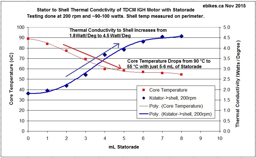

                                    • Click image for larger version  Name:	daa4f92f01_hr (1).png Views:	0 Size:	169.0 KB ID:	408257

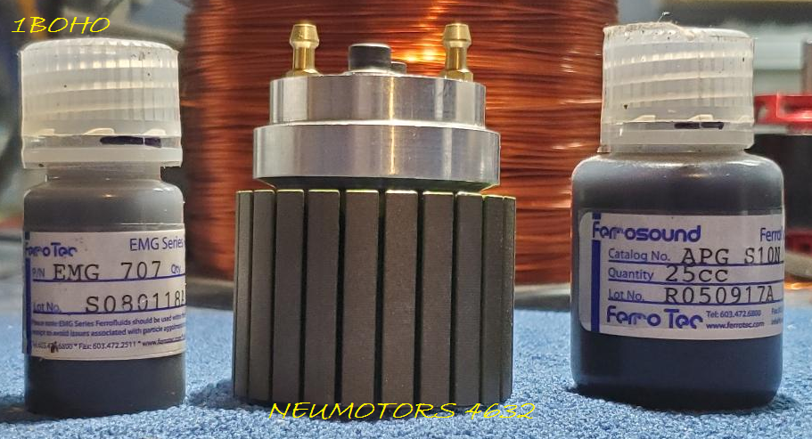

                                      The ferro fluid doenst have to be in the gap either tt can pump cool into the interior of the stator just like the 7455 or Christian 41 series with water cooling and does it passively. i can speed the process by implementing a cryogenically cooled heat sink into the loop
                                      Click image for larger version  Name:	fetch?id=408253.png Views:	0 Size:	313.5 KB ID:	408258
                                      But in the gap Ferrofluid increased thermal conductivity across the gap by 400% and the machines deliver better efficiency extended range and more torque. Just build an external rotor IPM and fill in the stator side to flush hammers with a tc compound. Thats going to work really well in isolating the ferrofluid to the gap with minimal drag.

                                            User At first glance, this is all obvious, but as is so often the case, a second one is worth it.
                                            Let's compare a single-layer and two-layer winding on the P1000.
                                            Two-layer with 9+9 x 1.4 DD with 295U/V, power handling 320A and Ri=6.3mOhm.
                                            Your corresponding single-layer YY winding would be 5+5 x 1.5 YY with 300U/V, power handling 212A and 8.9mOhm.
                                            So that's 41% more internal resistance, so the power dissipation increases from 567W to 801W at 300A.
                                            For our 30sec operation, I prefer the much lower power dissipation, especially since the single-layer winding is only good for 212A.
                                            In continuous operation, the comparison could also be in favor of the air winding, in any case, I have not yet come back charred with any of my maximum windings.
