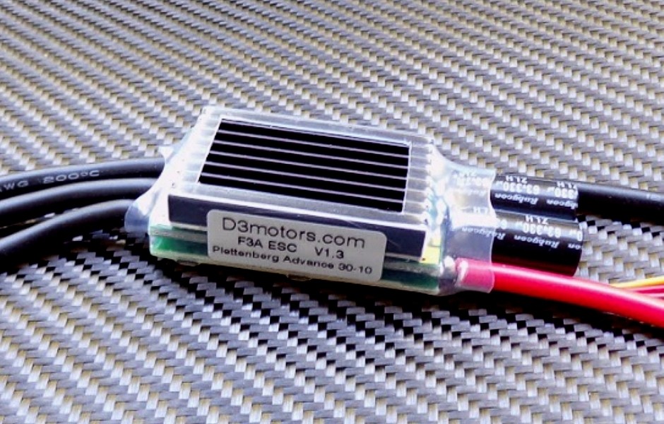

            BTW for F3A pilots that use Adam Lebowski's D3 BlHeli inverter with my rewound pyros in the Brenner contra drive. These setting are recommended in its settings to take full advantage of the custom wound motor.
            "The D3 ESC is the ESC designed by Adam Lebowski. It controls the motor rpm to a fixed rpm based on throttle stick position. If someone is switching from a standard Kontronik, or Gaishin motor, to one of your rewound motors my recommendation is for them to change the maximum prop rpm in the D3 ESC to 4500 rpm.
            I also recommend that they adjust their radio so that maximum throttle results in 123% of output. This will allow the pilot to take full advantage of the extra power available from your motor."
            Brenner Drives...​​

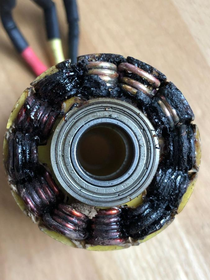

                    Audiosmith
                    UserYour way of expressing "another burned out HK4550" is framing, but that's already standard nowadays.
                    I had already found out that my winding shown by you only has a sunburn and is fully functional, so much for your truth!
                    The last shown iron pig with original winding was actually grilled, for which only 200A is sufficient because it suffers from copper deficiency.
                    Even the great single-layer winding is of no use, because 5+5x 1.5 YY of the Chinese winder is simply not enough.
                    That's why I always treat it to almost 32% more copper with a 9+8x 1.32 DD winding which increases the power handling to 260A, and since the syncloss starts at 255A, the winding protects itself, except for long-term flight records of some experts.
                    And what I'm happy about, you have no idea anyway. Appendixes

                        Powercroco
                        UserThere are 2 engines.
                        One came from Walter and one from Rene.
                        The motor with your winding has 4 dead magnets and apparently a simple stator closure and annealed sheet metal anyway.
                        Probably both by grinding the crooked bell.
                        At 1000V it fails, with low voltage it can still do. But it is no longer really usable....
                        With Rene, the bell is apparently okay, you have seen and photographed the winding yourself.
                        Addendum:
                        Are you also happy about burnt windings in the scorpions?
                        Only then would the jacket have fit you!
                        Addendum 2:
                        Was Rene's engine also with you?
                        The photo of it openly on your table suggests so.
                        VG Ralph
                        __________________________________________________ __________________________________________________ _______________________
                        Never feed a black troll!
                        Audiosmith
                        UserI meant the one from Walter from #589, and he has the sunburn winding.
                        And you wrote that the bell of the sunburn winding is ok, so what now?
                        Rene's was not with me, I never got anything from him.
                        Powercroco
                        Powercroco
                        UserWhere did I write that the bell would be okay?
                        The picture in FMS 800mm Warbirds says it all.
                        And the picture in freewing 3axis flight controller shows Rene's engine.
                        Which engine does the left picture you posted in F-86 video show?
                        Are there 3 engines in the game now?
                        VG Ralph
                        audiosmith
                        User
                        Powercroco wrote:
                        By the way, the bell on your sunburn winding has 314/V, so it is obviously still well within tolerance in terms of magnet condition.
                        (+1.2% N Spec)
                        Ist doch erst einige Stunden her.
                        Ich hatte ja schon einige Grillschweine hier, der in F-86 video ist ein ganz anderer.
                        Powercroco
                        Powercroco
                        UserOkay. War auch wieder missverständlich.
                        Nochmal:
                        Die Glocke von Renes Motor mit verbrannter Wicklung wurde auf Renes Statorträger mit dem Paket mit der Sonnenbrandwicklung bei 4S aus einem kleinen 1600er Akku und mit nem 400A Steller auf n spec getestet.
                        Das Risiko war sehr begrenzt, weil ich ja wusste, dass es nur eine singulären Statorschluss an deiner Wicklung gab. Sowas ist einfach festzustellen, wenn man einfach mal die Anschlussbündel öffnet ( okay, ein weiterere Vorteil von DD).
                        Und das geringe Risiko einzugehen war es mir auf jeden Fall wert, bevor ich den Stator nackigt mache und für die Katz neu wickle.
                        Hat ja auch geklappt.
                        Das Schadensbild an Deinem "Grillschwein" sieht dem von Renes Motor verdammt (verwechselbar) ähnlich.
                        VG
                        Ralph
                        audiosmith
                        UserAlles klar, verstehe ein Mistverständnis, dann weiter machen.
                        Powercroco
                        Powercroco
                        Userdito.

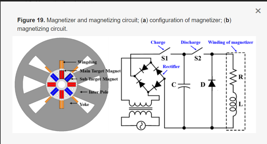

                                        Hi All,
                                        I plan to contact Dr. Dorell for more specifics to the fixture and magnetization direction manipulation. I can build this and I'm pretty sure you can supply the high voltage from a microwave transformer and a high voltage capacitor. A super cap may be even better. You want a cap that has a dielectric not destroyed by the short. The oil based type may be better. For and external rotor I truly believe you only need a stator wrapped with 1 serial coil wound CW/CCW across 180 degrees of the stator and a rotating fixture that can lock the rotor at the right positions for zapping the magnet.
                                        Click image for larger version  Name:	fetch?id=387122&d=1695472566.png Views:	0 Size:	120.5 KB ID:	408848
