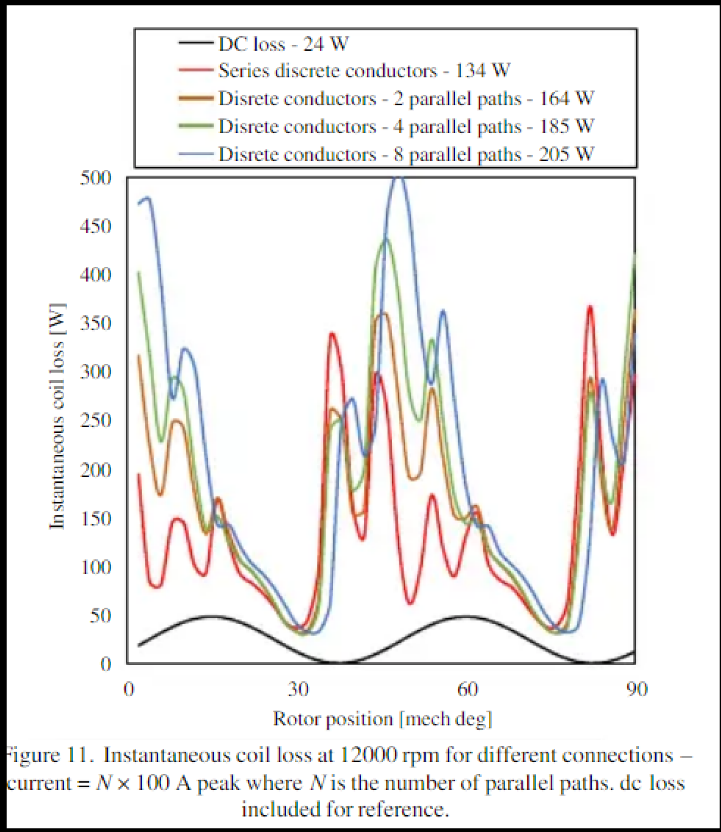

                  U see now instantly the inverter is fine again LOL! but the "Misery" has to be your motor. That was the only thing it was connected to. 🙈🙉🙊 U lie everyday of the week man damn. Its sad and they believe it! without such logs being presented to them🤣 but it will be fudged too. Thast not beyond your scope of dishonesty. Again for the slow.... the inverter has a much higher on resistance so its no where tougher than anything esp APD. U wont post its internal resistance so these are clown azz post to me. You show me all the time that you are definitely not an EE. The stuff you are typing on rc forums about motord is ridiculous. The bifilar motor with low dc resistance failed can you face it? if he didnt exceed the specification why did your motor fail. Care to post that remote response somewhere? Ill find it.
                  Youve been told its ac resistance is 10 times higher u cant accept that. Thats your problem.. I dont mean to be ugly but I'm not going to continue wasting my time with people who act like they are dumm. The motor continue to toast in their intended applications and you say that's acceptable for 1000 euro and I say bull****! Even your own data has shown you the elevated ac losses so something is serious ly wrong with you. You're a Physician so maybe you should consider a wellness check. because the obvious is not sinking in. If they are adequate what do you plan to get from reading these pages anyway I only plan to post more peer reviewed and published data from myself and the true gurus....😀
                  Click image for larger version  Name:	okon wind.png Views:	0 Size:	299.3 KB ID:	392324
                  u have as much as 12 paths with parallel bifilars sir! and it burn as much as a half hp just to idle com on b for real u know that's far from optimal!
                  380 watts loss at idle !

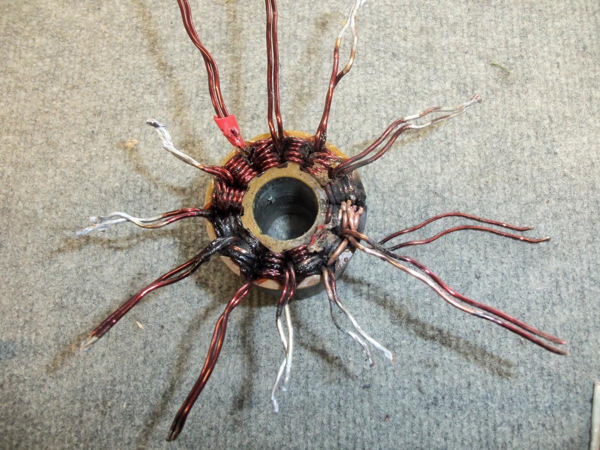

                    #289
                    Youve all the signs of and overloaded motor. Elevated temps. Demag rotors, charred wires, burnt up insulation and fiberglass plates so let me make this clear Dr Ralph Okon. Appeals to pity are just another form of fallacy playa....
                    I would not give a damn about a homeless dog shelter u not going to just burn my money for a bs fuse. And i stand behind that because people will feed a dog and let a human standing at a light or an entire continent of people starve. While they drive Beemer wagons eating bratwurst flying 10000 planes its about time you gave back! Coz in HONG KONG you got a sweat shop of low paid Asian workers winding the things. 130000.00 u took in for just PAW scorpions so the damn dogs are fine! Clearly the motor is above 120 C. You are shown the right material and you argue with that. Thats YOUR problem. There is no solutions to your self inflicted issues because without an iota of formal training and unilog you are smarter than the entire IEEE Ralph. Thats crazy
                    If u have pride in your work u dont collect a 1000 euros for a motor then tell people the toast that can destroy their inverter is okay.
                    Click image for larger version  Name:	100_2198 (2).jpg Views:	0 Size:	220.6 KB ID:	392328
                    I may be nothing but at least i care about someone dealing with me better than that! Id be extremely upset if they brung me back this from its intended application. id probably feel a bit embarrassed. You seem to embrace the repairs and the time they are out of flying behind it. They keep having to make new winding decision but the winds are repeatedly the same old thing.
                    I think Gerben said it best. "If you keep doing the same thing do you expect different results???" You dont want this to happen at the world speed masters do you? or u dont care? people do u no favors not holding you to a higher standard . It makes you weak and lazy and it looks to me like that's already happened! Uve been stroked so much you dont do anything interesting anymore thats why the interest on helifreaks and even the German social media is not there anymore buddy. They know its other things to behold in 2024 and you are living in your past like your friend in Bayern now.

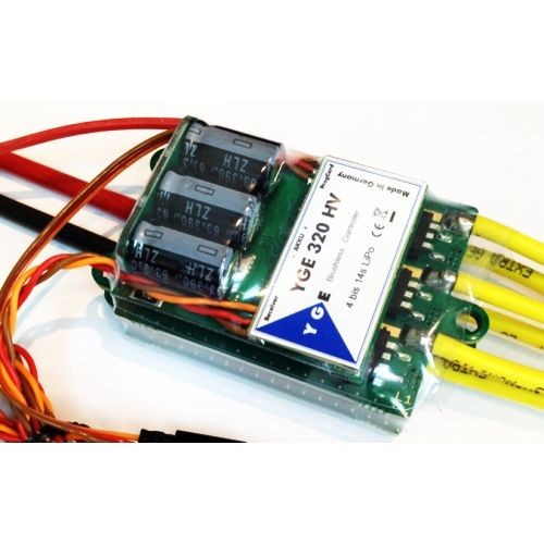

                        Click image for larger version  Name:	yge320hv-500x500.jpg Views:	4 Size:	46.9 KB ID:	392432
                        Have the boys counted the # of parallel field effect transistors on the ENTIRE YGE 320 ? It is a fine inverter but there is no way it carries more current than the APD. The addition of the small buss bars to it for YGE's 400 unobtanium is a long way from full plane utilization of 8 copper layers where just one of the power stages alone could sink that. The entire chassis is also aluminum without the heat insulator wrapped around it. You know the lower resistance has a higher stall current. so please don't listen to people who advertise falsely on remote control groups high performance sections or other hobby forums across the globe. U can pull up the internal resistance of all the inverters in a registered version of Ecalc. They are all in the data bases. It is not even close.

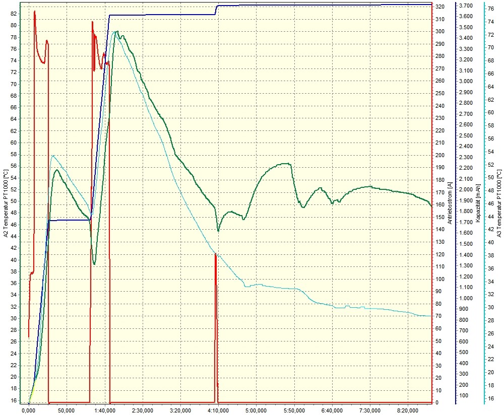

                              "Der 18S Mototr hatte seinen ersten schnellen Flug.
                              Offenbar waren die Veränderungen erfolgreich.
                              Das Log zeigt in rot den Motorstrom, in gelb die Stellertemperatur und in türkis die Motortemperatur.
                              Die entnommene Kapazität ist dunkelblau dargestellt.
                              Trotz Leistungsspitzen von bis zu 20kW und etwa 16-17kW in der Strecke sind alle Temperaturen im grünen Bereich geblieben.
                              Überhitzungsanzeichen sind auch an der Wicklung sind nicht zu sehen.
                              Der Flug war btw. wieder recht schnell. Die zulässigen 463km/h wurden wahrscheinlich knapp erreicht.
                              Da geht ganz sicher noch ein bissel mehr.
                              Vielleicht schon heute, wenn das Wetter so bleibt. Anhänge"
                              Really Ralph?
                              What thermal performance confirmation is seen at 200 kmh slower and 100 less amperes? Why not show the LOW TEMPERATURE log that created this photo of toast where it will actually operate? And why would you choose yellow as a plot color against this background? I know why ....."they" probably don't. 🙈
                              Click image for larger version  Name:	100_2198 (1).jpg Views:	4 Size:	220.6 KB ID:	393185
                              Misleading your consumers isn't impressive to me,. Maybe they are clueless but we know rotor demagnetization and stripped insulation doesn't occur at 70C @ real application the motors are seeing over 200C and have a much higher dcr there too. Here is the EMPIRICAL evidence.... 👀If the motor is only 80% efficient lets say ...4000 watts of the 20000 is waste....so 16kW is all you really have there with a 4000 watt soldering iron.
                              Click image for larger version  Name:	b2.png Views:	0 Size:	52.4 KB ID:	393191

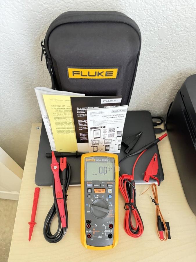

                                Click image for larger version  Name:	fluke.jpg Views:	3 Size:	96.7 KB ID:	393225
                                I also doubt you meg the motors as per NFPA 70E or ANSI which would measure 1 minute then 11 and average that. I never see a quality rating in your insulation test. Do you know "Dr." that there is a grade of passing not just yeah or nay?
                                Fluke 1587 FC Insulation Tester Multimeter | Fluke
                                They have some incredible deals on this gurl that list for 1000.00 USD

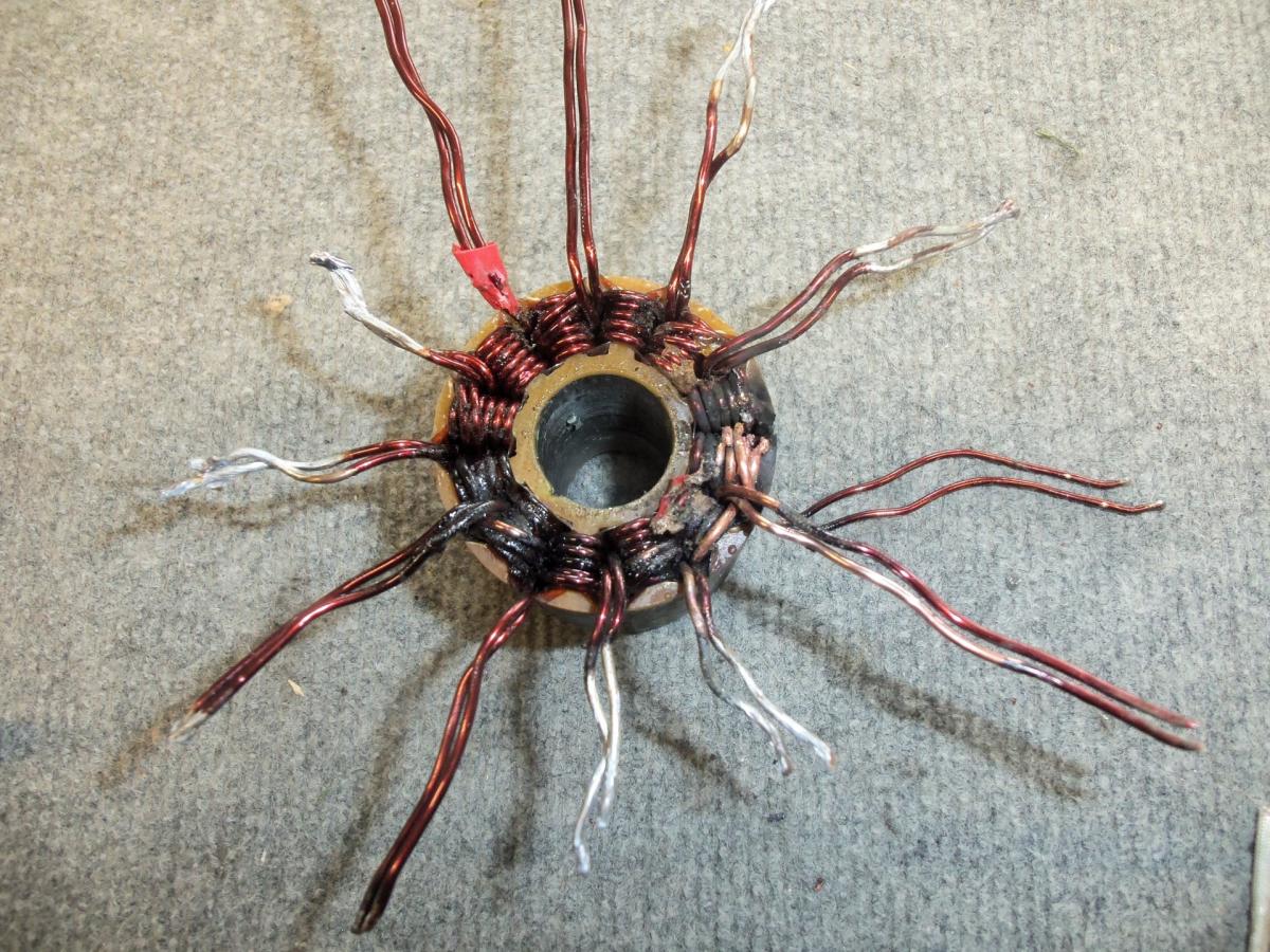

                                    Click image for larger version  Name:	100_2198 (2).jpg Views:	5 Size:	220.6 KB ID:	393217
                                      #298
                                      If you really want to know what the motor can do you have to run it into the failure load points and record the parameters there. Your testing rig is not yet safe enuf to do this and you cant load the 400 amperes with your leather glove on the bell exterior. Thats extremely dangerous. And obviously that will mar any nice finish the bell would have. Christain told me you do that and instead of make fun Ill tell you I would rather you not do that. Seriously! the motors make enuf torque to easily break an arm. You see the power levels....don't be silly . U also need a much larger inverter than 400 for the test bench. You really need to build a full test bridge that is remotely driven and monitored by a PC Gui. If you look at some of the dspic PIC microcontroller evaluation motor board options and their schematics you can reverse engineer one and already have the motor control software freely distributed from them. I can build you the PIC based motor drive for the test rig that will work with the control software terminated correctly for connection to the host pc for a fee but since you are in Germany contact Joerg from JAGS and he can build you an inverter bridge that can sink the amps. The motor control station and shunted bridges can configure and drive all types of motor's and control algorithms from IM's to BLDC's and also synSRM . It can run various forms of field oriented commutation like Direct Torque Control. It already has the interface for a graphic lcd so it could be a stand alone unit that does not need the external PC monitor. If you dont build the custom bridge then you will sacrifice the life of an expensive hobby inverter. You also dont want to use all the cycle life of LiPo u want the lithium car batteries and caps for a DC supply. This is not cheap but will be a super solid supply with very dangerous supply capabilities. A safe rig is a must and you need eye protection an electrical extinguisher and so forth.

                                        Click image for larger version  Name:	fluke 2.jpg Views:	0 Size:	82.8 KB ID:	393228
                                        This is really Nice Santa!
                                          #300
                                          Click image for larger version  Name:	s-l1600 (32).jpg Views:	0 Size:	46.6 KB ID:	393231
                                          This might be handy too santa.... for telling advanced hobbyist and the engineers at YGE and Scorpion the motors quadrature and direct axis inductances to tune the inverters bandwidth ratios. 👀
