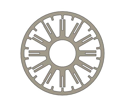

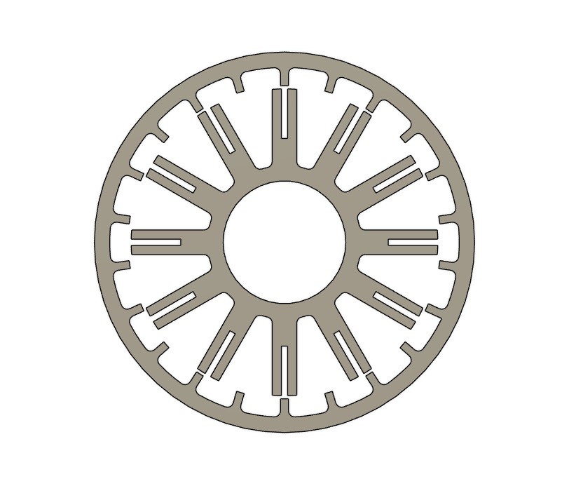

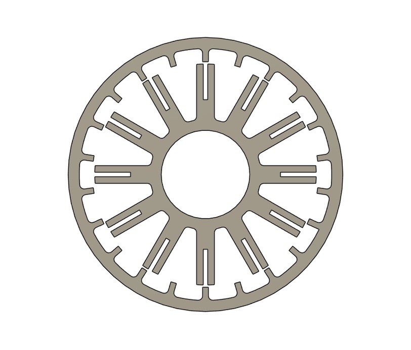

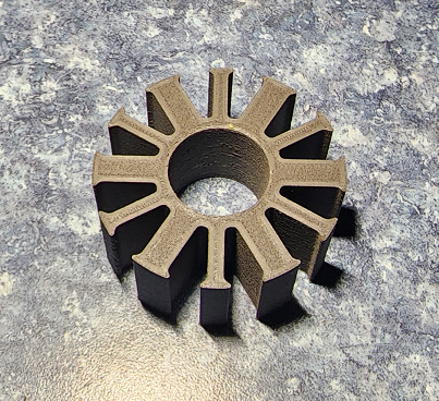

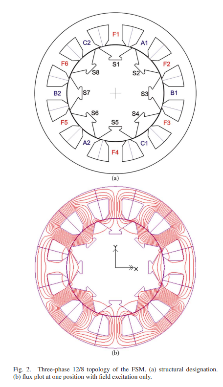

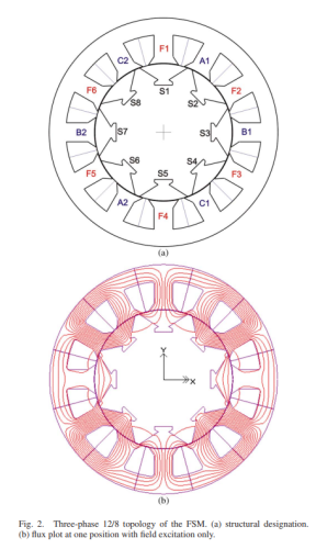

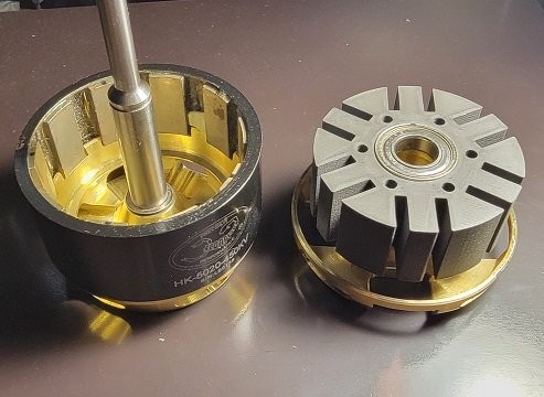

I see I have you on international speed dial bright and early That last post was at 4:07 😀So I know you like this silent one...and especially the dc excited 12N8P machine because all you need to do is design the laminated rotor out of silicon steel. Its very good for highspeed. No magnets.

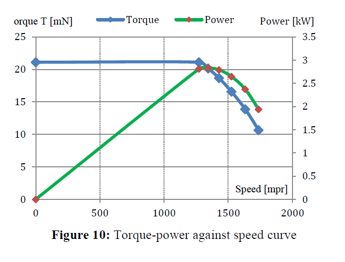

Interesting about the dc excited machine is all the field weakening possibilities.This motor could run really fast if the mechanical integrity is there .
