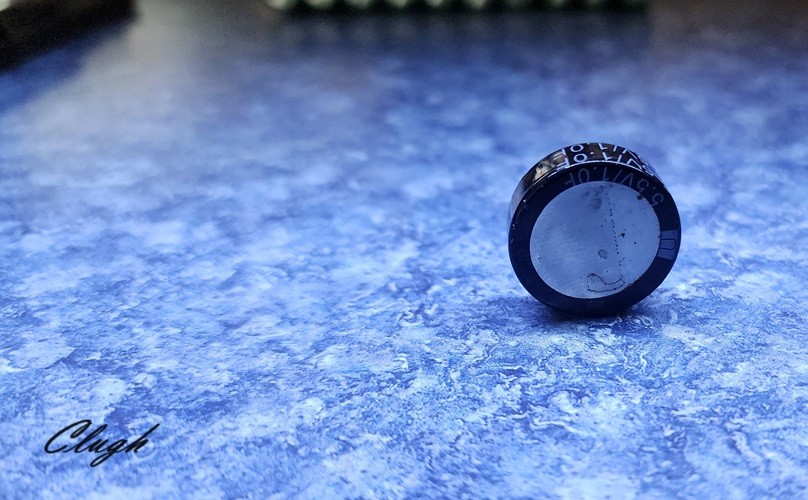

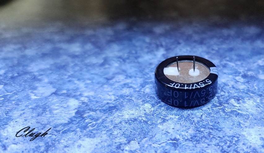

      For now I also have these button 1 Farad 5.5 volts super caps. I was going to strap them directly across true EV cells but that was a while back and you need to use them as they have a shelf life to sit dormant. These will facilitate a heat sink mount like in the attachment.

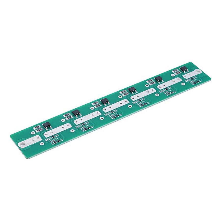

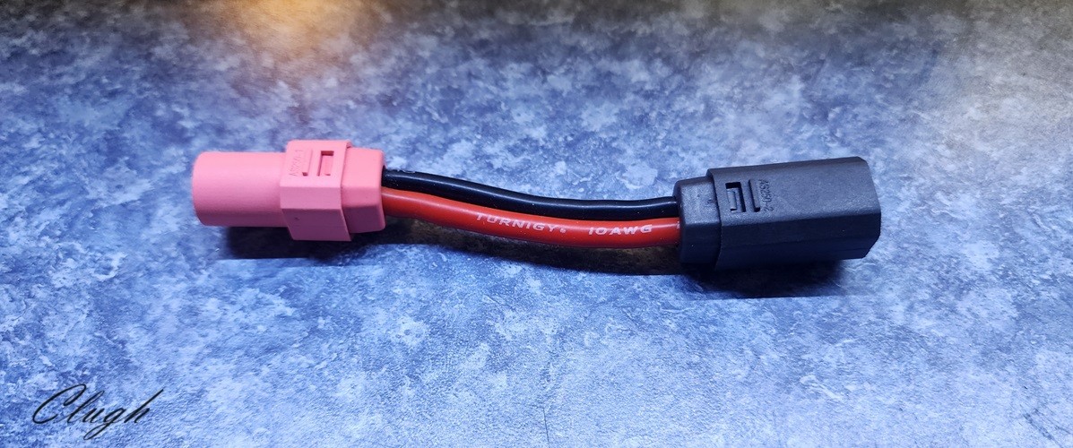

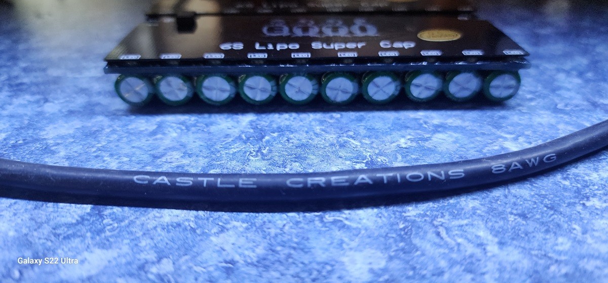

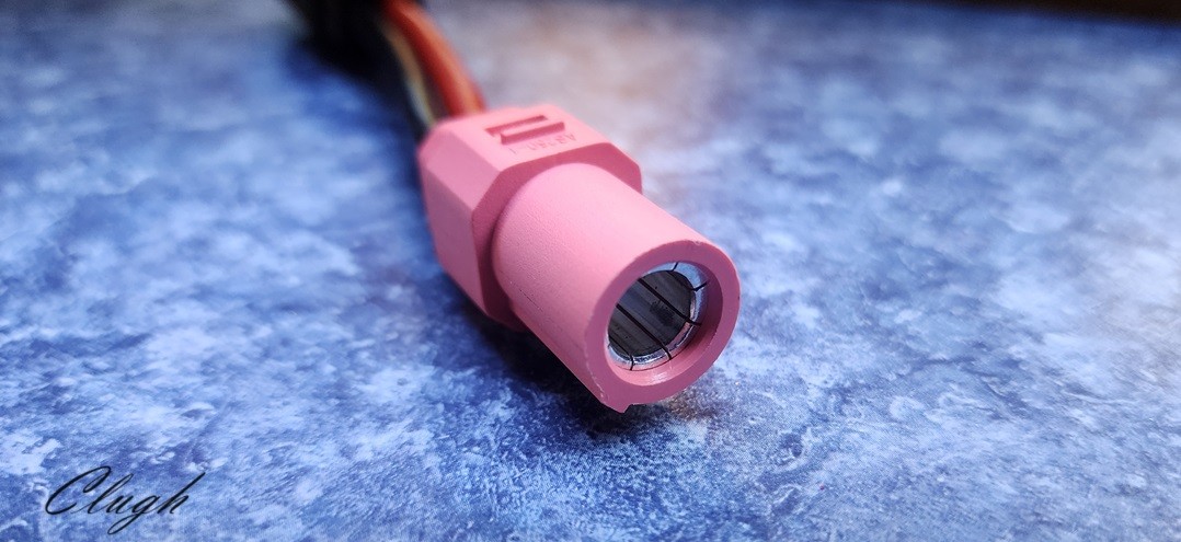

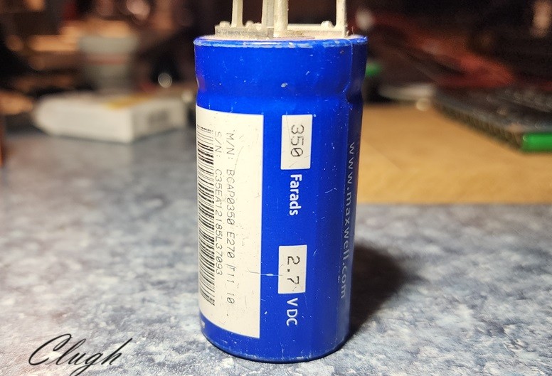

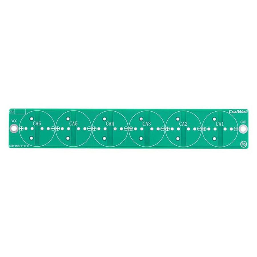

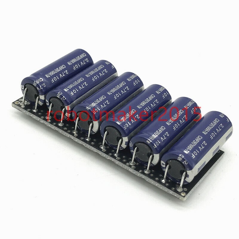

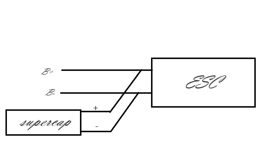

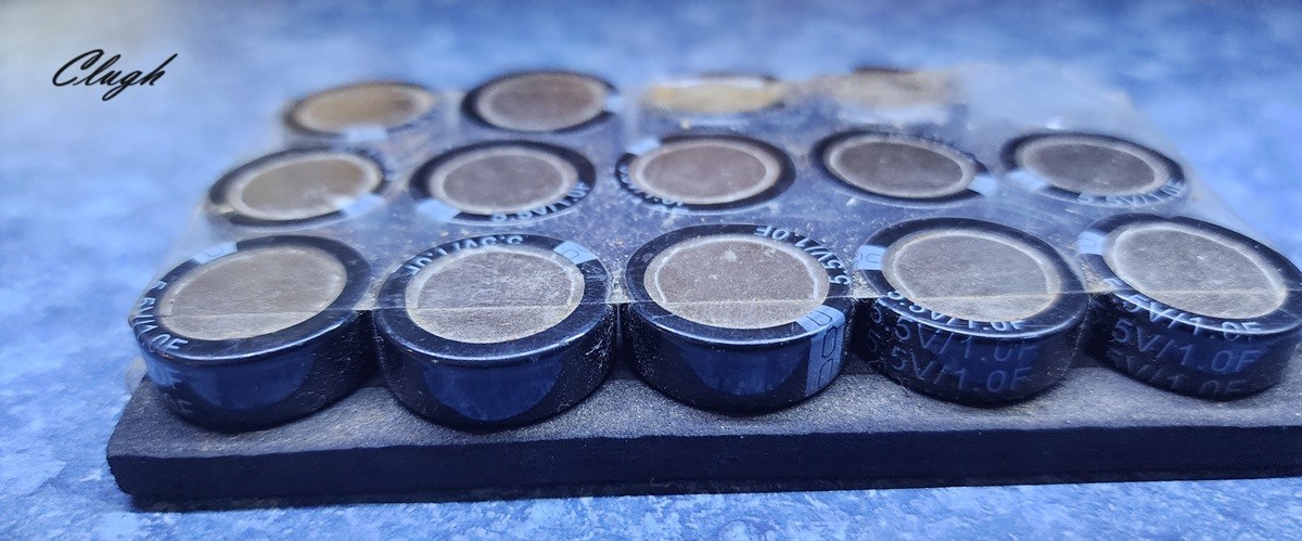

        Anyways photos are worth 1000 words. I'm going to use castle 8 awg for the connections. I use the castle because I know its pure copper not cheap higher resistance cca...
        For the 1 farad buttons im looking for a balance charged array. There's no need to re engineer that as they are all over the place online. I just need to find one size and voltage appropriate. I guess you really could build them on 8 layer pcb's prepared by a board haus.
        You can get them and similar supercap modules like this one which is 1.6 Farads at 16 volts. Not at all expensive either.

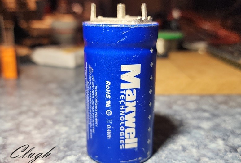

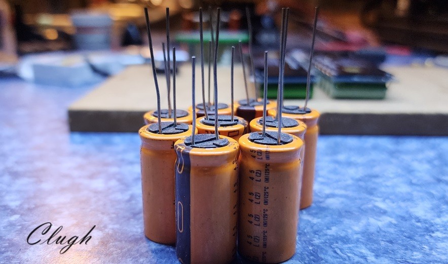

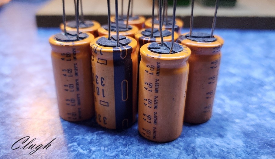

          Here are some traditional low ESR 100 volt 330uf electrolytics 125C* 🙈. I have a bag full of these. And long ago I guess 2012 I was interested in the supercap technology and my instructor at DTCC gave me a maxwell supercap D cell. This girl is 2.7 volts @ 350 farads. You can crank and drive a car with 4 or 5 of them and spot weld with one for a second at 945 amps . Id imagine the implications in power supplies enormous with the technology. Even for a test bench these would be a great addition to the bench power supply
          I suppose someone could also build a rather robust 1-3s inverter with some of this super cap tech and the GaNFET technology available today.
          Well let me stop rambling, start soldering, and see what charging these super caps looks like b4 my monolog of excitement spurs on another inquisition despite my 5000+ peeps and direct address here...
          Let a man have a little fun. Be confused 😟 Life is stressful so sometimes its better that way...😉

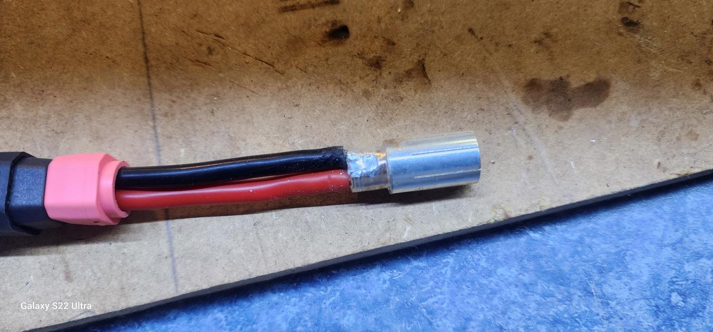

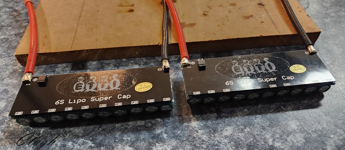

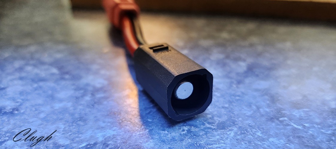

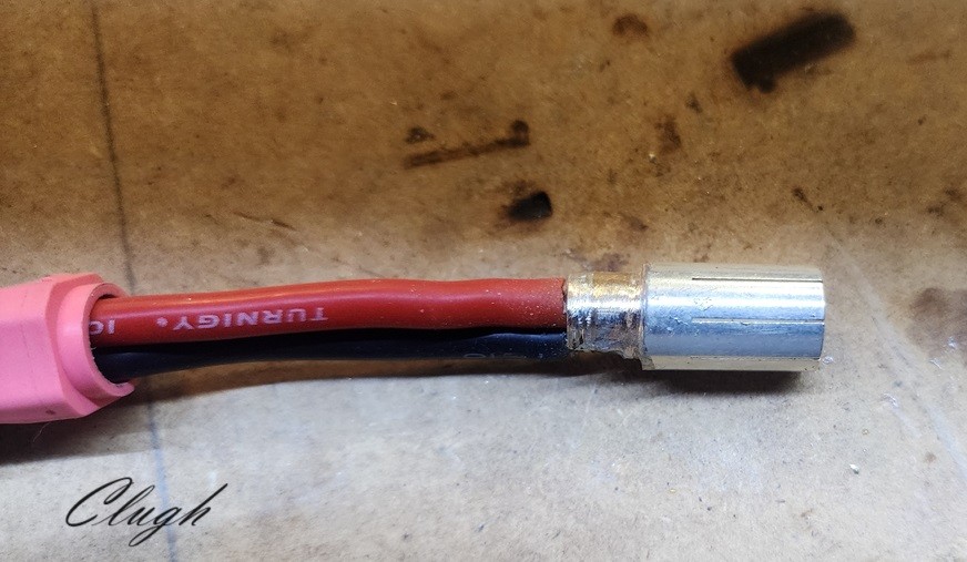

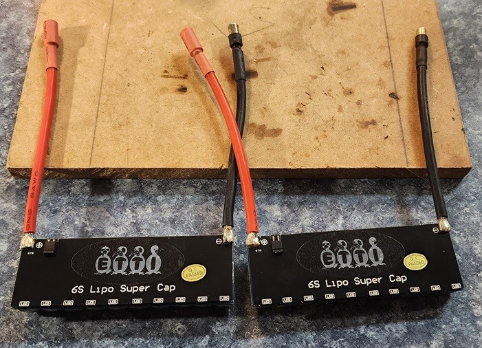

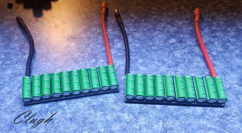

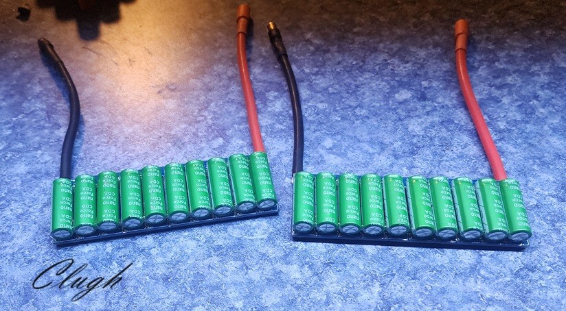

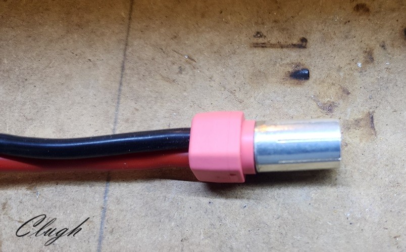

            I put castle 6.5 mm on the 8 AWG leads for ease in different high current or voltage demands. Ill solder in 8 AWG receptacles in parallel with the battery imput leads of the esc because I don't think I can double load 8awg into the AMASS SH8.0 connectors and for the esc I soldered a par to the the esc's to match my delivery connection options of the SMC drag cells. They had the lowest ir. For low resistance connections the AMASS sh8.0 will easily load with 2x 10AWG wires so you could make clean parallel connections under the sheath of the connectors and eliminate heat shrink to hide the spice.
            The jumpers you see on the pcb's are to safely discharge the capsThere are led indicators to let you know the bank is fully spent and also if an individual cap or caps is damaged. If they get damage ETTI request you send it back for repair.

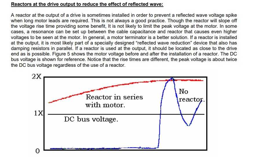

              But just in case a motor winding "guru" does not...

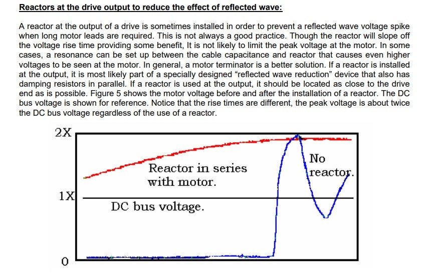

              Click image for larger version  Name:	load reactors.jpg Views:	0 Size:	140.2 KB ID:	401065
              and that's a damn shame if you tune power systems and do not know it about the latest wind proposals in the industry and what benefits they bring....

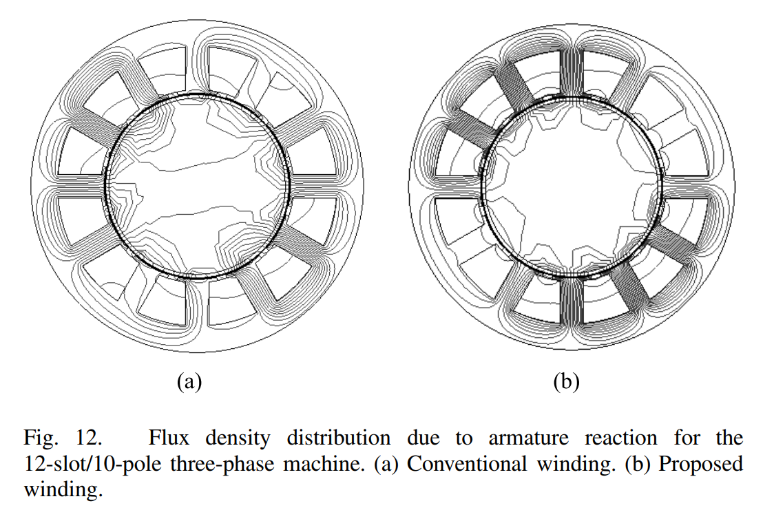

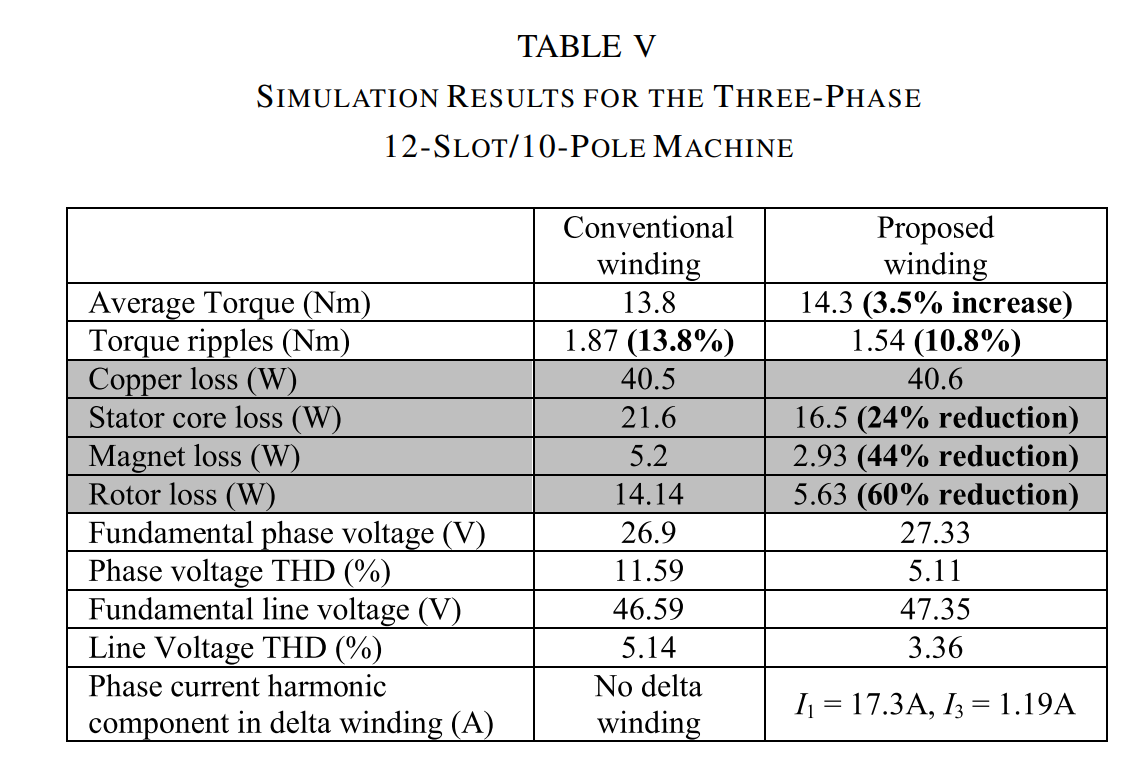

ID:	401071 Click image for larger version
Name:	hybrid results.png

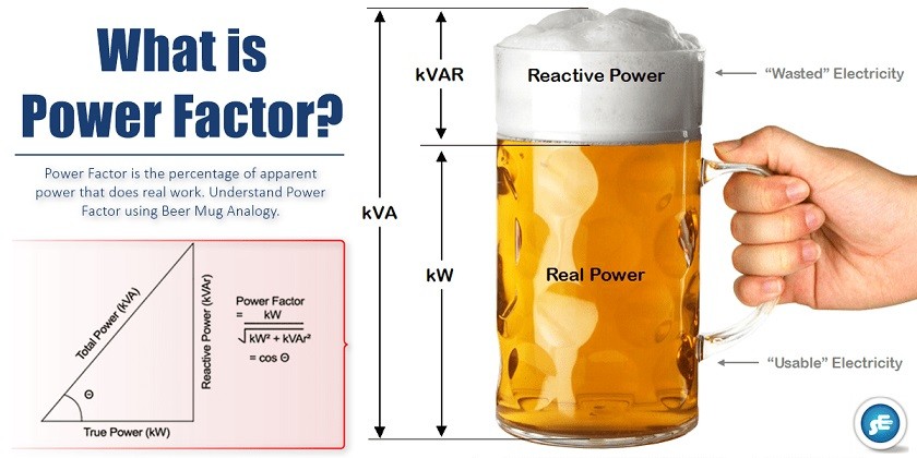

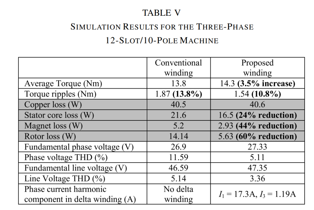

                    And I hope all the winding experts there note in copper loss that despite the benefit in a conventional wye machine that a lower DC resistance is NOT always the winner! Hybrids, interspersed, and >1 coils span semi concentrated windings will in inherently have longer end turns than a FSCW with a coil span of 1 Duh! So what? Measured resistance will be higher. 😱 The "BLDC" motors especially wyes are still working pseudo AC! Right????
                    So in operation wouldn't this mean AC resistance to change of current direction like skin and proximity effect weigh more in efficiency and power factor than the stalled dc?? You in here for a daily lesson...so here you go....😜

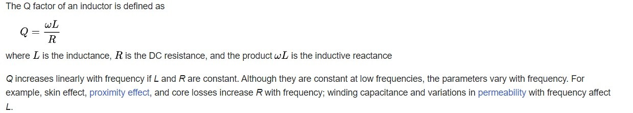

                      If I think of a motor coils in terms of an inductor . Inductors with more turns are higher Q.
                      The Q factor .... the winding resistance in series with the inductor happens to dissipate the REACTIVE ENERGY . the quality factor or Q of an inductor is the ratio of its inductive reactance to its resistance at any given frequency and is a measure of its efficiency. The higher the Q factor inductor approaches the ideal inductor. The higher q inductor also has a narrower resonant bandwidth. Noise wise that should definitely be less to deal with holistically. I don't want to just come out and say it but it all suggest generally speaking that more turns are better for efficiency as a whole anyway.
                      What do and your silent friends here correlate there on Gerds social media in Germany about exclusively the low dc resistance Ralph?

                        (Dr Okon, Borat, Powercroco,BOHO1) 😆
                        Q steigt linear mit der Frequenz, wenn L und R konstant sind. Obwohl sie bei niedrigen Frequenzen konstant sind, variieren die Parameter mit der Frequenz. Beispielsweise erhöhen Skin-Effekt, Proximity-Effekt und Kernverluste R mit der Frequenz; Wicklungskapazität und Schwankungen der Permeabilität mit der Frequenz beeinflussen L.
                        Bei niedrigen Frequenzen und innerhalb bestimmter Grenzen verbessert (oder erhöht) die Erhöhung der Windungszahl N den Q-Wert, da L mit N2 variiert, während R linear mit N variiert. Ebenso verbessert (oder erhöht) die Erhöhung des Radius r eines Induktors den Q-Wert, da L mit r2 variiert, während R linear variiert mit r. Daher haben Luftkerninduktoren mit hohem Q oft große Durchmesser und viele Windungen. Bei beiden Beispielen wird davon ausgegangen, dass der Durchmesser des Drahts gleich bleibt, sodass in beiden Beispielen proportional mehr Draht verwendet wird. Wenn die Gesamtmasse des Drahtes konstant gehalten wird, hätte eine Erhöhung der Windungszahl oder des Windungsradius keinen Vorteil, da der Draht proportional dünner sein müsste.
                        Die Verwendung eines ferromagnetischen Kerns mit hoher Permeabilität kann die Induktivität bei gleicher Kupfermenge erheblich erhöhen, sodass der Kern auch den Q-Wert erhöhen kann. Kerne verursachen jedoch auch Verluste, die mit der Frequenz zunehmen. Das Kernmaterial wird für beste Ergebnisse für das Frequenzband ausgewählt. Induktivitäten mit hohem Q müssen eine Sättigung vermeiden; Eine Möglichkeit ist die Verwendung eines (physikalisch größeren) Luftkerninduktors. Bei VHF oder höheren Frequenzen wird wahrscheinlich ein Luftkern verwendet. Ein gut konstruierter Luftkerninduktor kann einen Q-Wert von mehreren Hundert haben.​
                        ~wiki~
                        Basically you want more copper but in more turns .....

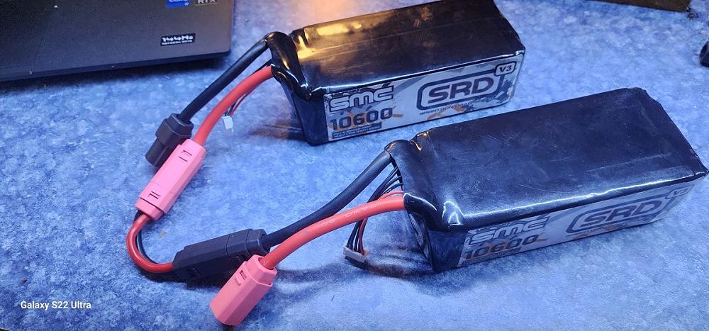

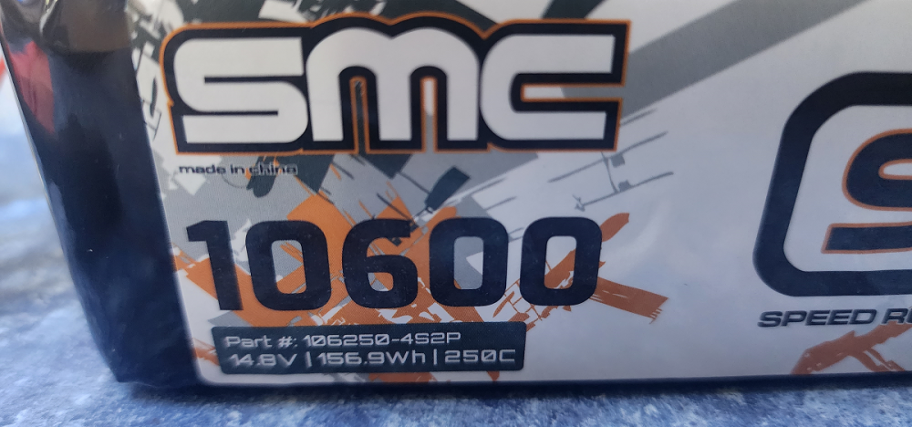

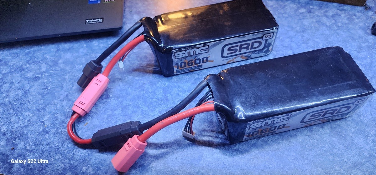

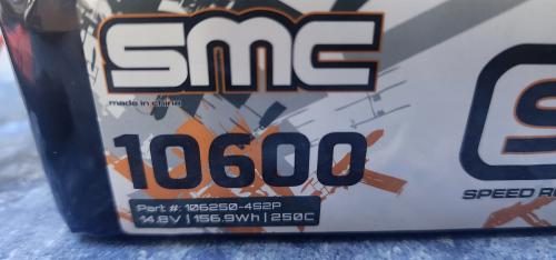

                            Click image for larger version  Name:	20240411_151138.jpg Views:	0 Size:	223.9 KB ID:	401101

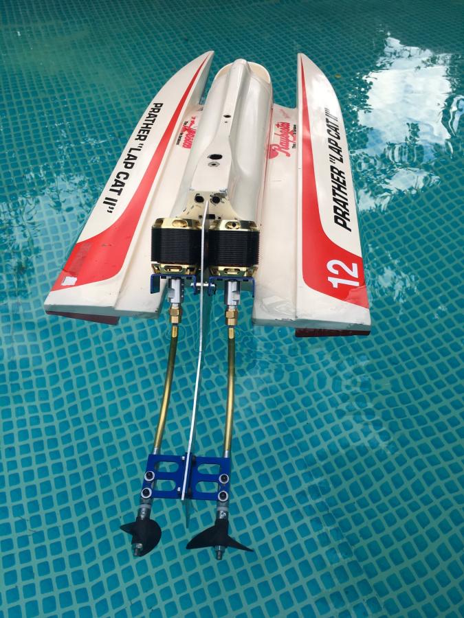

                            I can run 8 s at 10600 mah and 250C no issue but in the end I'm crazy for the power of the the drag cells so for my pleasure ill buy 2 more series them and parallel them together for 8s lipo 21,200 mah @ 250C or 16s lipo10,600 mah @ 250C . JAGS knows that should be enough juice to cook plenty of wunderbar, crocodile, and the monkey in Bayern that rode in on his back.

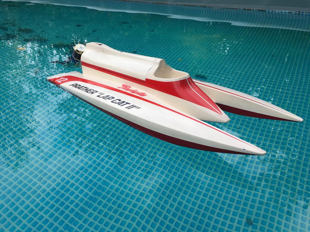

                            We can gather around the pool for the cookout and drink lager off the 80's lap cat with the "visually brutal" "outboards".....

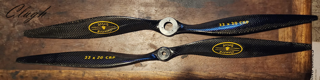

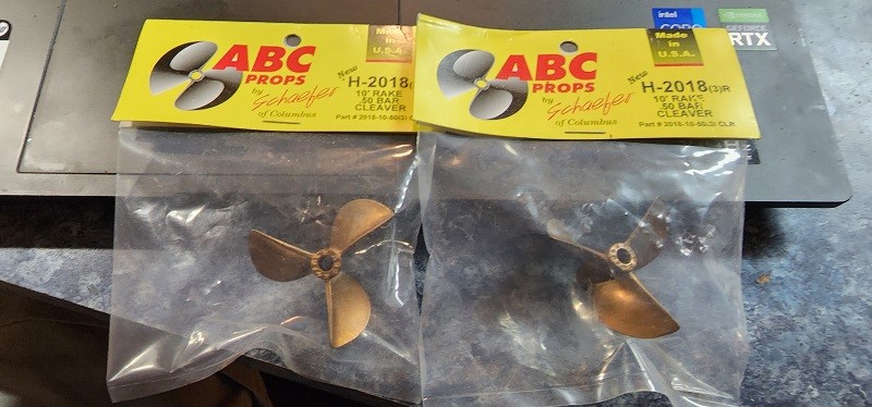

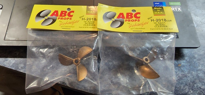

                                You see the 22x20 counter rotational props are here in the Research Triangle Park area North Carolina with me for load testing.

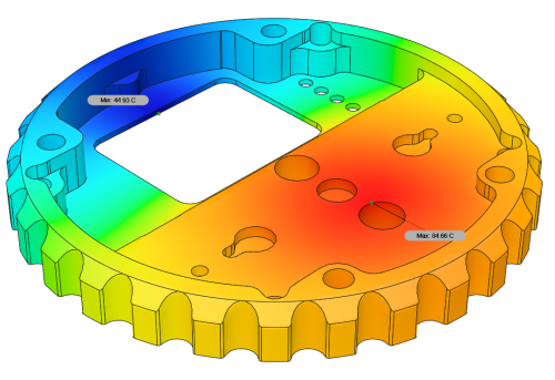

                                  Click image for larger versionName:	thermal_performance.pngViews:	0Size:	300.6 KBID:	401161

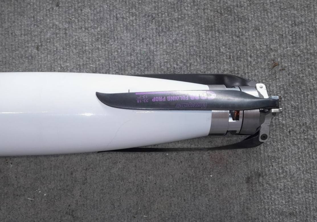

                                        Looks like I may have a few accomplished pilots that are looking for an edge Ralph. What's nice is they can test many ideas for pilots empirically while I stay In the lab.
                                        Wonder if one of them would have interest in flying the speed plane Chris said I could not build. The boys are wonderful at 3d modeling so I can tell them what I want for wing profiles and an airframe and print a plug .....
                                        Like Chris said
                                        The Americans are building...

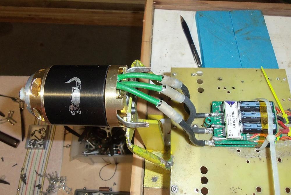

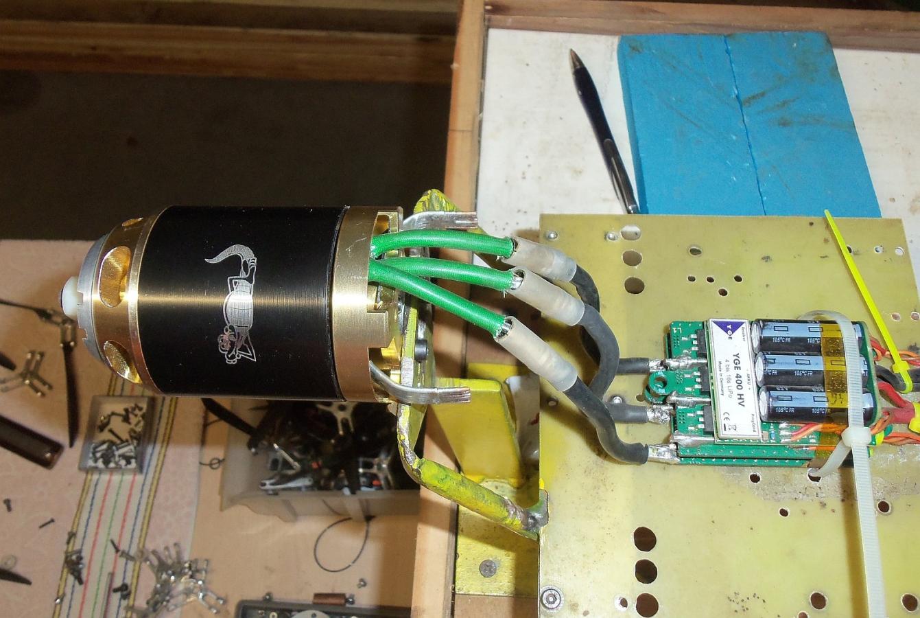

                                          Ill let you know...the spy is sitting one the wall here 247 365 ready to take any good ideas implement them and definitely not give credit. Let me show you an example...
                                          Click image for larger version  Name:	100_1266.jpg Views:	5 Size:	153.9 KB ID:	401273
                                          Do you see these flat wires coming out of the scorpion not connected to the esc? Those are the wye bundle or pigtails for the YY winds that would be normally twisted. Now for his life he has always tucked the pigtails underneath the hood with the phase wires end turns, the hottest part of the windings typically. The only part that would surely be hotter is the pigtails in a wyes bundle as they can see 300% of the phase currents. I suggest years ago to bring them straight out of the motor to radiate heat away from the toque responsible windings and keep the winding temps down which only raise the resistance and lower the efficiency. 😱 Copper and silver solder are going to have excellent thermal conductivity, so in and of themselves they make a great heatsink TWISTED and out in open air. The reason you twist is so equal parts or alll 3 wire see air equally at the most external parts of the bundles. When u do 3 in a line the wire in the middle is hotter than the outsides so a higher resistance there than anything you measure on the milliohm meter at room temperature .🙊 Next thing you know there or here it is incorrectly implemented on the German Social media a marvel no one can touch on taken right out of HUBERT'S tuning books 😲teamed here with the fancy 320 with skinny buss bars added to make it a YGE400. On the forums do you think I get credit from the east coast "gurus" ?
                                          See how much capacitance is on it...
