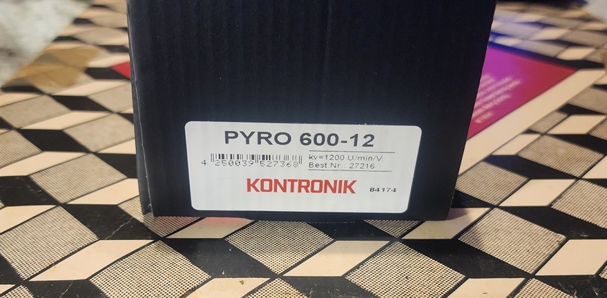

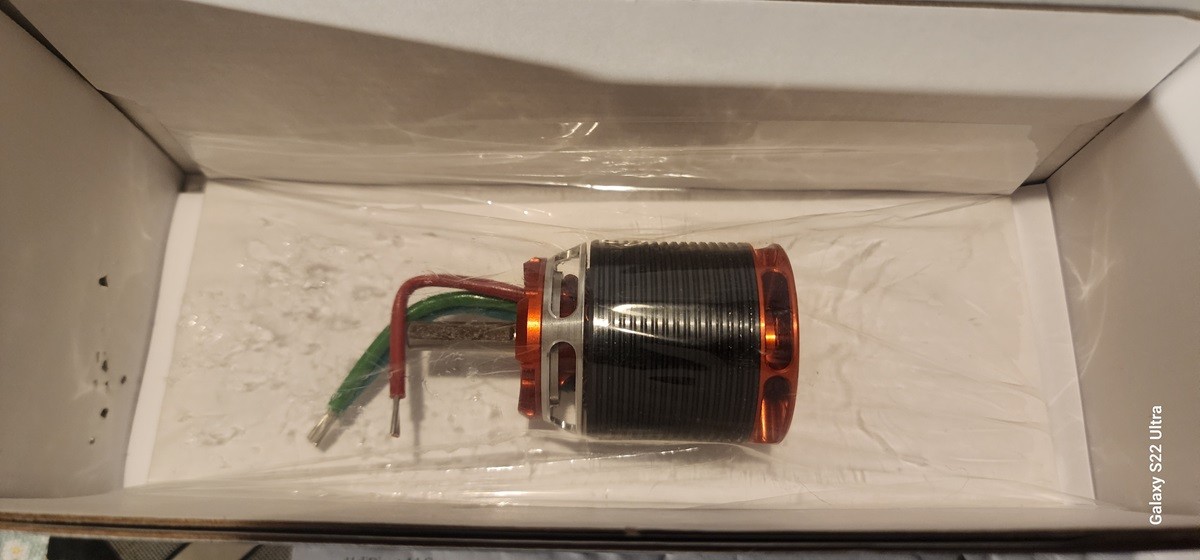

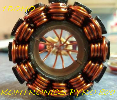

Latest winding work...Pyro 600. Speed dial is on the way....

Don't know about the Scorp, but this is the info & feedback I got for the rewound Pyro 600: It is installed in a Logo550SX for a lightweight setup. Esc: YGE 120LV Blades: 520mm Fying weight a little over 3kg. Feedback (I just translate from dutch): Headspeed is the same. Heli feels more powerful. Motor runs cooler than before and esc a little warmer. YGE seems to be more comfortable, no dips in rpm anymore. Strange thing: when I fly with higher headspeed the esc and motor run cooler. Positive aggression! Setup now invites to fly more aggressively. __________________ Raptor E700: PowerDekker Pyro650, JR DS8925HV & SPG01, 12s, Vortex VX1, Kosmik160, Jeti DS-16 |

Not so strange, yge's partial load isn't as great as they say :rolleyes: __________________ -TT E700 V2-vbar-mks950-980-Kosmik 160HV-Pyro 700 rewound by PD / Voodoo 600 -PD-MX700-470kv--BLS255hv-VBAR 5.3+- Gaui X3+Spirit Pro |

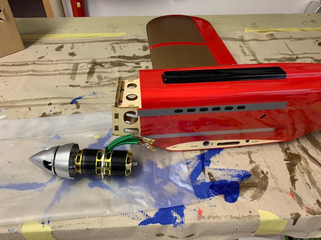

https://www.f3aunlimited.com/contrav4 Attached Thumbnails |
