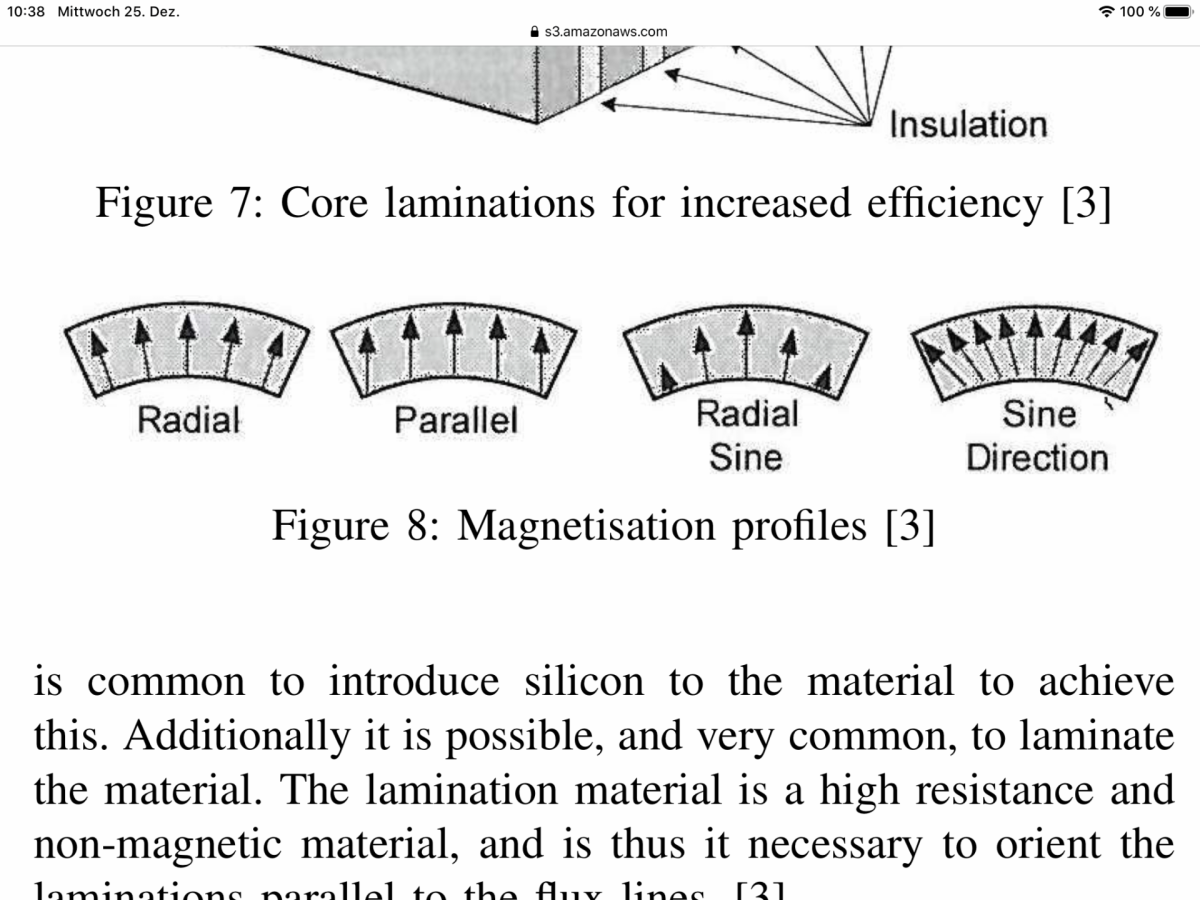

        Hi Ralph
        I see Christian is trying to help you understand the magnets which should be no issue if your motors produce their power at 70C the magnets should never be damaged in the first place.😏.
        The truth is not premium in those assessments and we know that......based on the demagnetization..

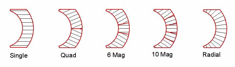

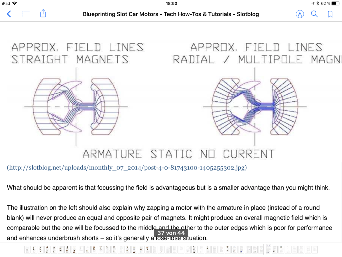

        "Hi, since the magnet still rules the Unknown Being,
        a few notes on this.
        A very simple way to see if all magnets are more or less the same is to apply a winding with thin wire to one of the stator teeth. Then drive the motor at a steady speed, using an oscilloscope to display the stresses that are induced. Okay, you need an oscillator, but when you have access to a thing like this, you can't just look at the voltages and their value. The curve shape also allows some conclusions to be drawn about the type of magnetization.
        The second method is to compare the magnets before they are glued in place and to detect slipping. To do this, you need a compass and a longer wooden top, table ect. . To determine, the compass is placed at one end of the plate. Then you push one of the magnets on the plate, starting with the greatest distance to the compass towards the compass, align the plate with the compass so that the compass needle does not point in the direction of the magunet, but 90 degrees towards it. As soon as the compass needle turns towards the magnet, mark the distance on the board. Repeat this with all the other magnets and you can see if one of the magnets has been pushed much closer to the compass or if the needle has already moved further away. Closer, weaker magnet, farther away, stronger magnet.
        The proposed method with the current clamp , from the Aloys is very suitable. You can also wrap a few turns around one of the clamp bars and set a current that works against the permanent magnetic field, but you need a well-stabilized power supply for comparison measurements.
        Unfortunately, you can't always assume that all of the magnets have been magnetized exactly 90 degrees by the thickness of the magnets. Such angular errors interfere with the induction in the coils. However, you can also use the magnetization direction for the motor. In other words, if the actuator creates a rectangular block commutation, a wider magnetization will be less lossy. This is done by side-by-side magnetic strips at a distance from each other.
        Magnets can be magnetized in such a way that the field lines to the center of a magnetic pole become more concentrated, amplified. This makes sense, as it increases the peak induction voltage. Then it needs fewer turns with then thicker wire, less resistance. In slot racing, we glued the magnetic poles together from several strips in order to concentrate the maximum flow on the respective stator tooth.
        In order to design the field in such a way that a larger air gap is bridged, flux wedges and half-axis magnet arrays are best suited. On the one hand, the magnetic flux is concentrated, amplified = requires fewer turns with thicker wire, but also needs thicker stator teeth to be able to conduct more flow.
        The second effect is that the magnetic losses in the stator plates are reduced. In the case of very small lift gaps, very high-quality sheet metal qualities are also required, with larger air gaps, not quite as high-quality sheet metal qualities have to be used.
        The magnetic inference in the bell improves when the magnetic strips are in grooves. Alternatively, you can also glue iron sheet strips in the bell between the magnetic strips, sheet thickness 1/6 of the magnetic strip thickness.
        Happy Amps Christian"​

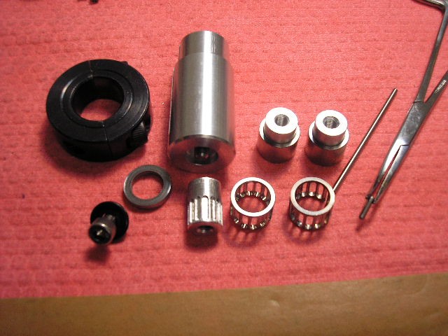

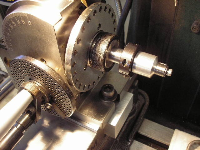

                Now I let myself be persuaded to build the 7465.
                I couldn't resist the prospect of a nice contribution to my charity.
                This time, however, the speed for 16S is said to be significantly lower.
                It should only be about half the speed - which should result in a reduction of the forces deflecting the bell to 25%.
                Probably the 12 wave will not cause any more problems then.
                Nevertheless, I will definitely thicken the bell bottom (this time only a little) - the method has already proven itself in the past with other engines.
                In addition, I am thinking about preventing the shaft
                from bending by means of 3001 bearings. The less than 10€ additional costs don't matter with such a monster anyway.
                3001 2RS (Double-row angular contact ball bearing / old 3001-B-2RS-TVH)
                3001 2RS / 3001-B-2RS-TVH angular contact ball bearing 12x28x12 mm (ball bearing 28x12x12 mm) - Double-row angular contact bearing 3001RS.
                www.kugellager-shop.net
                Perhaps these two measures alone would be enough to make the part fit for jet speed.
                But that's definitely not my job.

                  Hmm I dont get your bearing selection "Dr Ralph". The bell/rotor forces you talk about are radial so what does the angular contact bearing improve .? Their claim to fame is axial thrust support.. What you should be looking at is a full compliment deep groove radial bearing. One with SiC balls would be a bearing advancement in the right direction.. If the bearing you posted on the German social media is only 10 euro more than the standard NMB it isnt much there to get hyped about. A real upgrade in bearing may run upward of 200 dollars USD. A yard for each bearing and you never buy just one or two in the first place.
                  Do you know how to properly disassemble and clean a ball bearing "Dr Ralph"? Old medicine and electric motor mechanics are a totally different beast.
                  Did you and your friends on the German social media know that ferrofluid by its nature helps maintain air gap stability and concentricity in linear motors?. Also the 14 pole motor is a quieter machine and has more balanced modal forces on the stator. So you should make it a 14 pole if you truly are doing your homework.

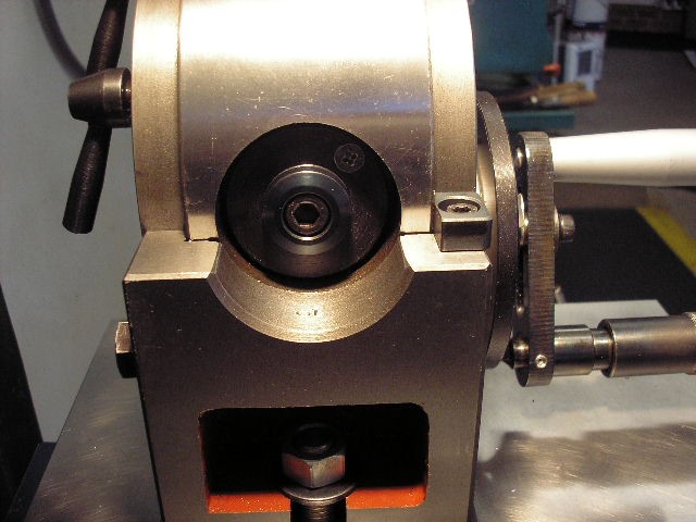

                        since I build motors only for use, my point of view has changed - away from all these based on several theoretic possible improvements.
                        we run our speedplanes full throttle all the time and we have less than 60 sec untill the battery is empty.
                        5% more eff. would mean 3sec more runtime.
                        we have about 3 or max. 4 flights through the meassuerement system into these 60sec.
                        so 5% arn't important for us.
                        important is "only" a thermically stabil drive system, good propeller and very good pilot.

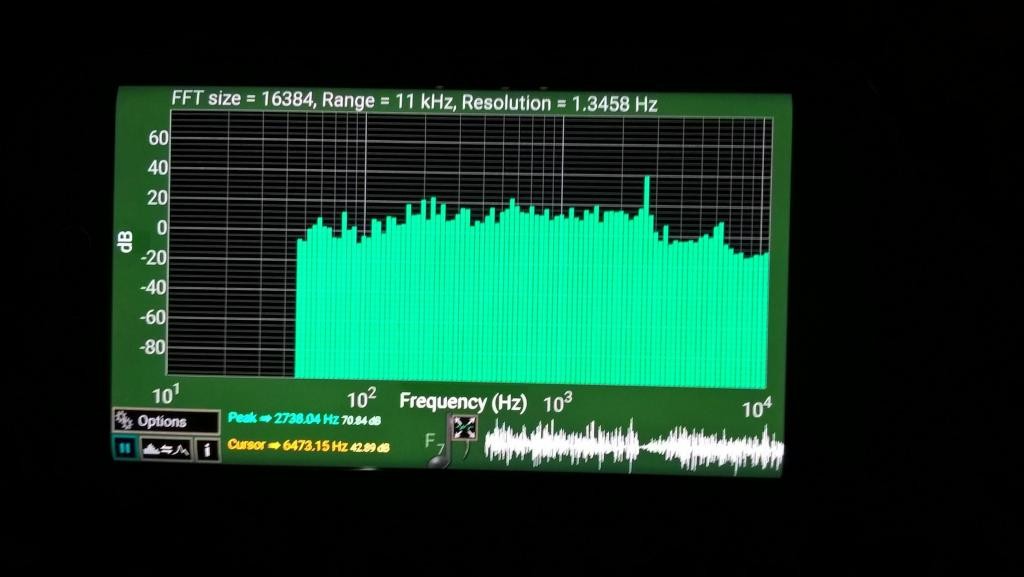

                        in every motor we found an rpm area, where the esc frequency and the motor resonance frequency seem to come together. to use the drive at these rpm, will destroy the motor be throwing away the magnets.
                        this is more important in 14P than in 10P motors.
                        Click image for larger version  Name:	100_2198.jpg Views:	0 Size:	220.6 KB ID:	396578 Or maybe this one proves how cool they run if the damaged magnets dont.. I don't know why you are posting in his thread. Other than you are trying to discredit the better motor. Scorpions are of average construction and elevated cost. They can thank you and the charity dog $helter for that. And 600 dollar 42 mm motors Even though there are new proven winds you have chosen bifilar stranding with no twist Parallel pseudo Bi filar stranding hardly improves the electrical performance of the machine. They dont run at stall! And truly the thumpers is not a 'bifilar winding' anyway. A slight Increased lever arms i dont see any real advantage because it also takes more to start and brake it.. All those percentages of change of dimension is great but worthless as you have made no correlations to performance based of those percentages of geometric change. You dont think a wind improves anything in reality but you think 2.2% increase in diameter does without a single performance measurement to confirm that in the real world. What happened to the great empiricist POWERCROCO that doesn't buy the theories of the IEEE?

                            I cant wait to see idle speed FFT captures on a scope from Louis Fourdan, It may not ever come now since you all are aware I'm here to interpret that data and derive the motors power factor and Thd for the inexperienced hobbyist that dont own or use scopes.

                                    and so the foum can see this is hardly new and youve already been told this in 2016 8 years ago. When I asked what test you ran and what they showed there was no reply. If you are a motor expert as they believe why do you need a lesson on ball bearings over and over again? Ive even told you the proper way to select bearings and how to check them for true roundness
                                    you see the 2.7khz triplen peak right here on a Hk SL5020 at 300 hz fundamental

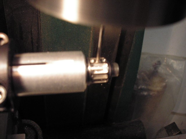

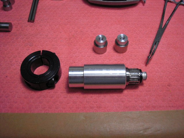

                                        Needle bearings are also no ideal for this type of thing and will only drive efficiency down with their drag as the wouldn't be lubricated as they would be in a crankcase and fuel with oil.in it.
                                        Click image for larger version  Name:	2hfpddw.jpg Views:	3 Size:	64.7 KB ID:	396625
                                        The boys dont know anything about needle bearings or how to make them as well as the proper material selection. I have all those prints to double window roller than can do 30,000 rpm in .90 nitro. Let me see you find a needle bearing anywhere in the world like this... Search all the German social media .or see if you can pull it off with the dirty lathe.

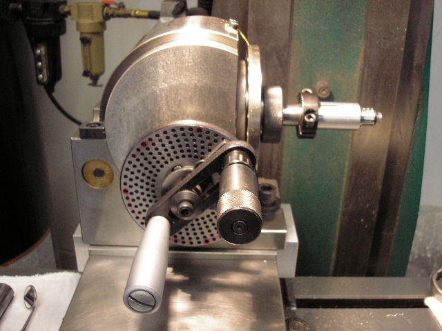

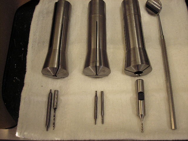

                                        Click image for larger version  Name:	004.jpg Views:	0 Size:	46.0 KB ID:	396628 Click image for larger version  Name:	002 (2).jpg Views:	0 Size:	69.0 KB ID:	396629 Click image for larger version  Name:	001 (2).jpg Views:	0 Size:	74.4 KB ID:	396630
                                        For the last month I have continued to investigate the possibilities of bottom end roller assemblies that would be used in 15 to 30 cc two cycle engines. These assemblies must be able to operate in the 22,000 to 28,000 RPM range, at 7.5 to 9.5 HP, with absolute mechanical reliability.
                                        The tools shown in the first photo, as well as the holding fixture mounted onto the Brown & Sharp's solid tapered center, are required to machine the 14 slots in the retainers .5470" OD. The slots are 25.714* apart. A calculation is made of the width of the retainer's pie shaped piece between each .0787" wide slot, measured at the roller's center line. This dimension is approximately .027". The following calculation is made to determine which dividing plate is needed to give 14 divisions of 360*. Since the dividing head is geared 40 to 1, 40 is divided by 14 which equals 2 12/14 = 2 6/7 = 2 42/49. This means that for the indexing of 14 slots, each 25.714* apart, the dividing head is rotated 2 turns (18*) plus 42 holes (7.714*) on a 49 hole plate. The dividing head is rotated an additional 2 holes to give .001"+ clearance (.0797") for each roller in it's slot. Again the 40 to 1 gear ratio means that one complete rotation must equal 9*. Using a 49 hole plate means that each hole equals 9* divided by 49 or .1836* (11 minutes). Therefore, two holes on the 49 hole plate equals .3672* (22 minutes). This is sufficient to give the necessary .001"+ clearance in each slot.
                                        The dividing head repeats accurately because there is no vernier scale to read. The spring loaded tapered pin must drop in it's hole for indexing amounts. The two photos before the last two show how easy it is to index & open the slot for the .001"+ clearance.
                                        The last two photos show how the machined sleeve is mounted & located precisely for machining. By using a solid aluminum mandrel inside, which is located in the holding fixture, there are no burrs to be removed on the ID of the retainer after machining. Tumbling removes any burrs on the retainer's OD. The sample roller & the gauge pin act as go-no go gauges for slot measurements.
                                        Jim Allen​
