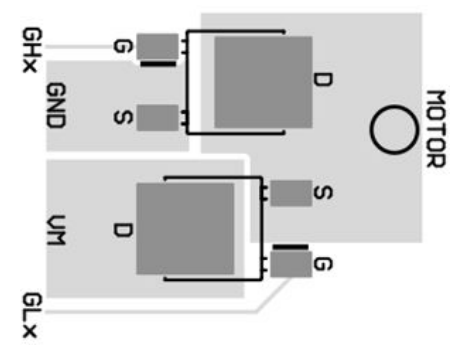

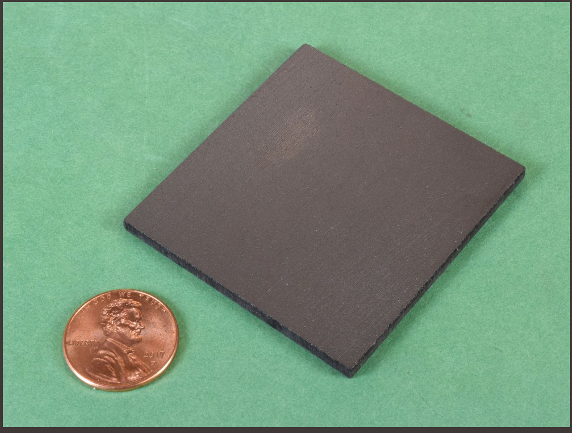

optiMOS is some cool Scheiße Imagine a modular bridge design where you mount this face down on a chiller plates with > -29C coolinmg then tf you use thermal vias in the pure copper or silver buss bars you can also have chiller plates clamped on top of those. You can use pyrolytic graphite plate between the fets and aluminum chiller plates. You drastically cool both sides. of the bridge then it can sink alot of power.

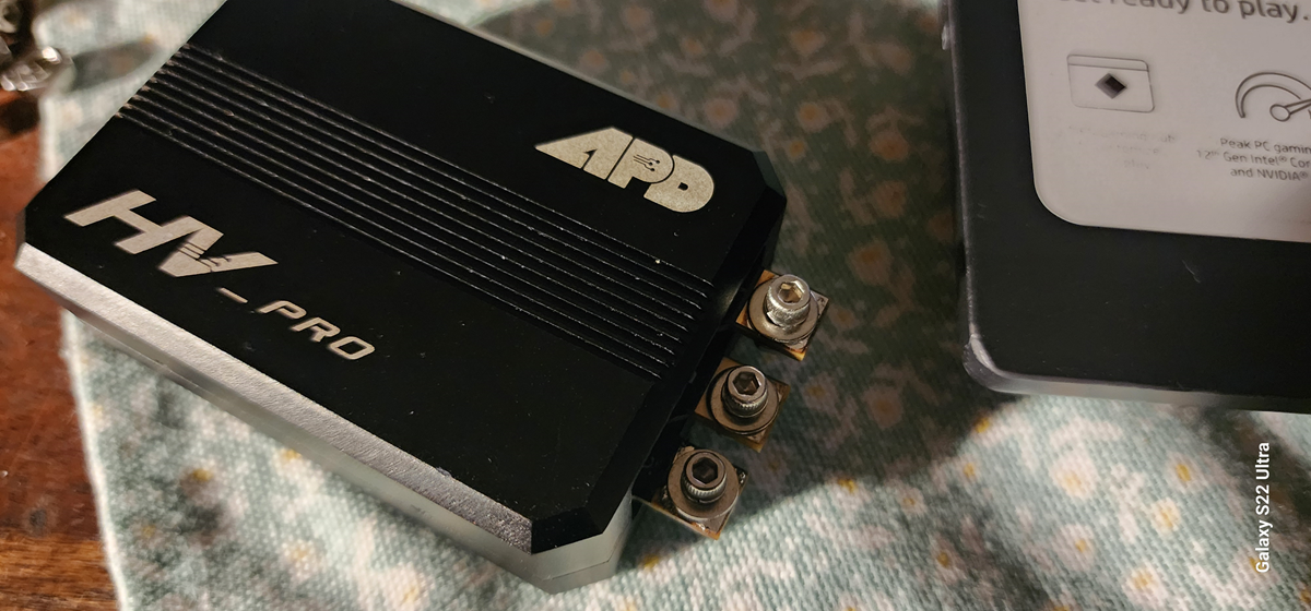

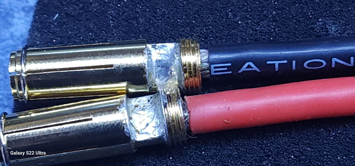

Since you down own an APD ill excuse you talk about thermal management. The entire chassis is aluminum and the power stages are merged thermally plus a breeze can flow straight through the inverter. The inverter with the lowest IR runs coolest at WOT doc . You think a "guru" knows that.. Your post are telling to the right ears....🙈🙉🙊

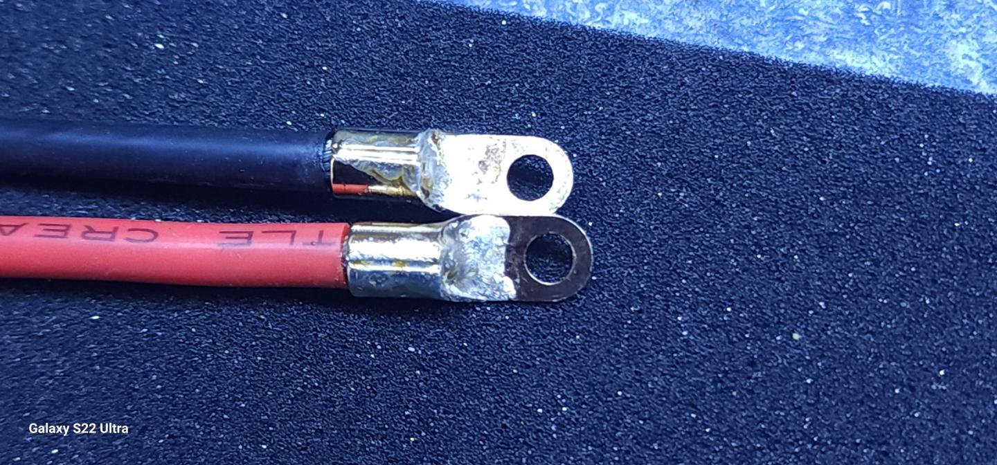

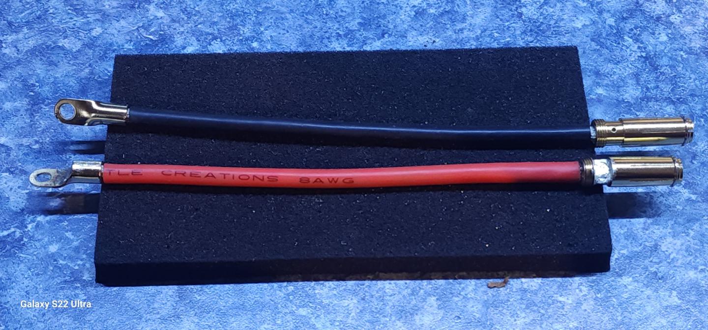

You dont know anything about the inverter obviously. The wire came loose because that is a poor solder job in the first place. Ure not aware that you can see straight thru the inverter snd it power stages the air can go anywhere your eyes do. The yge320 has exactly NO cooling whatsoever.
If the 320 is the answer i suppose u can solder that lil buss wire to it then call it a 400!

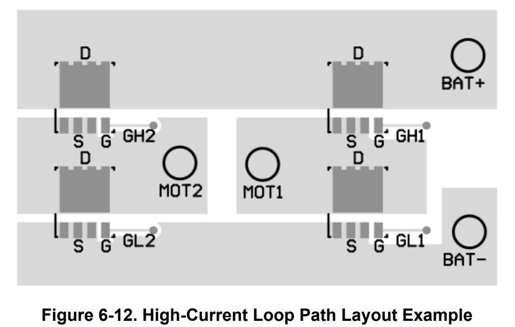

The transistors posted in post 241 are perfect for a modular powerstage stack!. Were waiting for the right inverter designed by you the "guru" it will certainly suit the 25 worldwide pilots....on the social media.

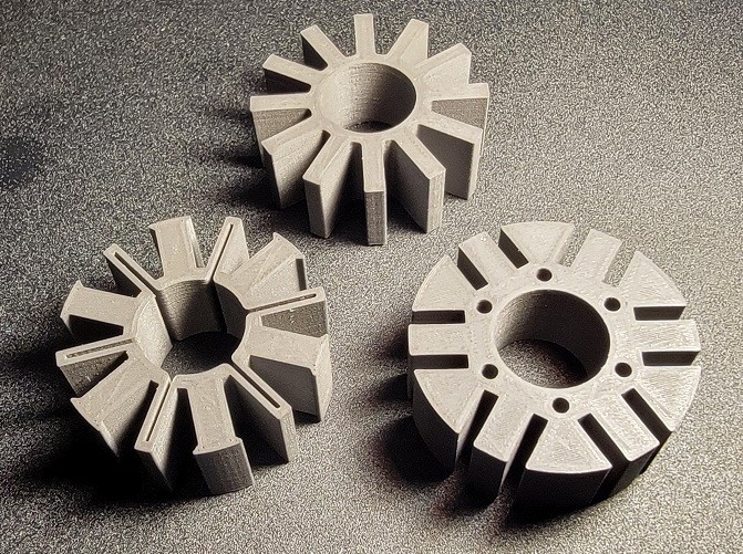

See the timestamp then the date that quite a bit behind? He and you know exactly who told you and showed you. It doesn't exist an any of the academic papers 👀 lets be real youve been . When i did things like print the first ever HK composite stator you were right there guru.
Printed with about the cheapest printer that can be brought tuned by me. I'm sorry but you cannot stand in the same room with me with those conventional DL wye winds
