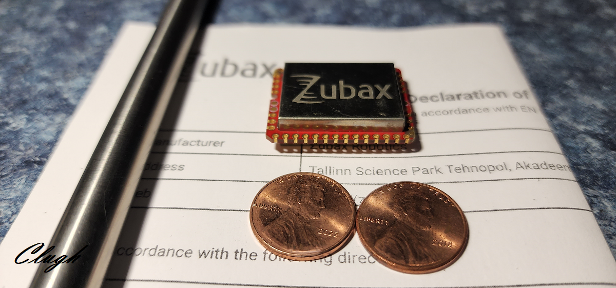

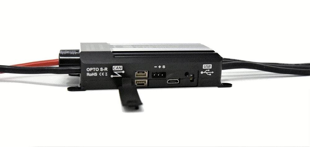

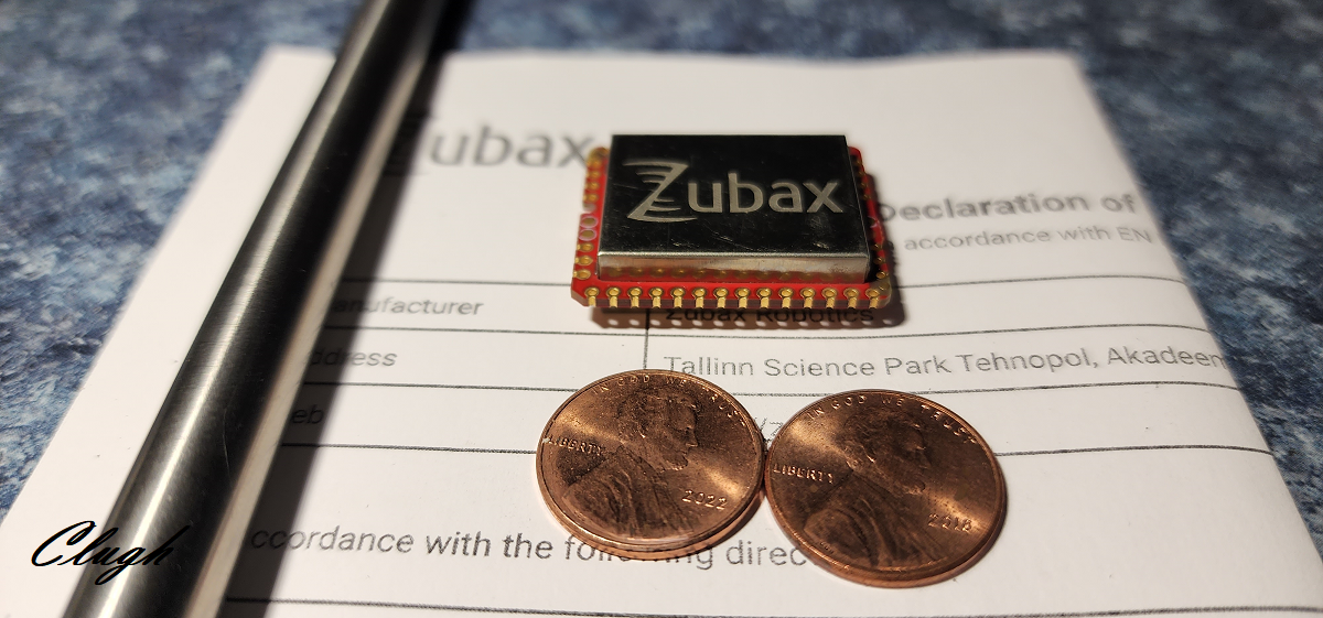

    Ralph you should report on the German F3S social media where YGE is on this?
    Click image for larger version  Name:	kde_uas125uvc_2_2048x2048_e56ed6b89baddee3472779160d0bee58822ba07e.jpg Views:	0 Size:	65.2 KB ID:	390080

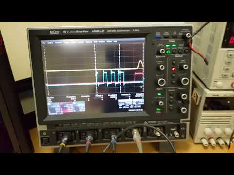

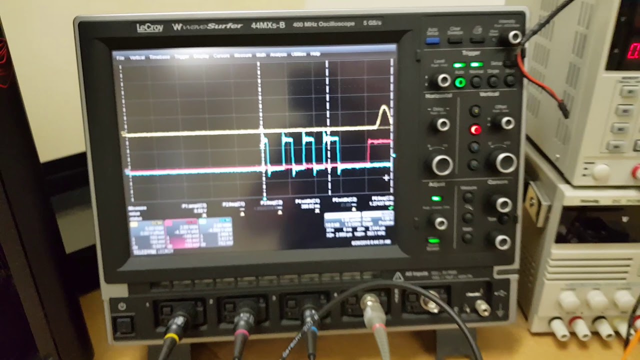

        It will be something when Louis starts to show the generated wave forms of the motors for the reals to examine things like....power factor at load.

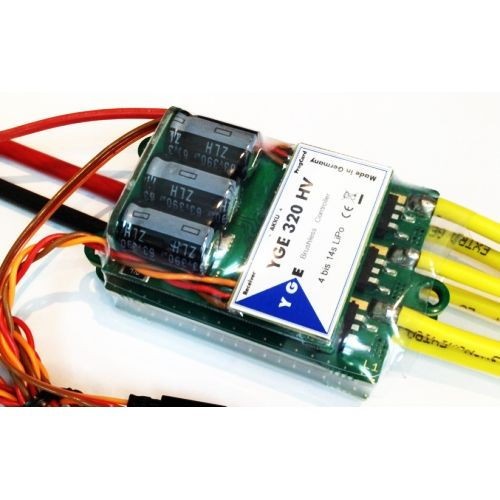

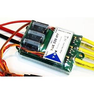

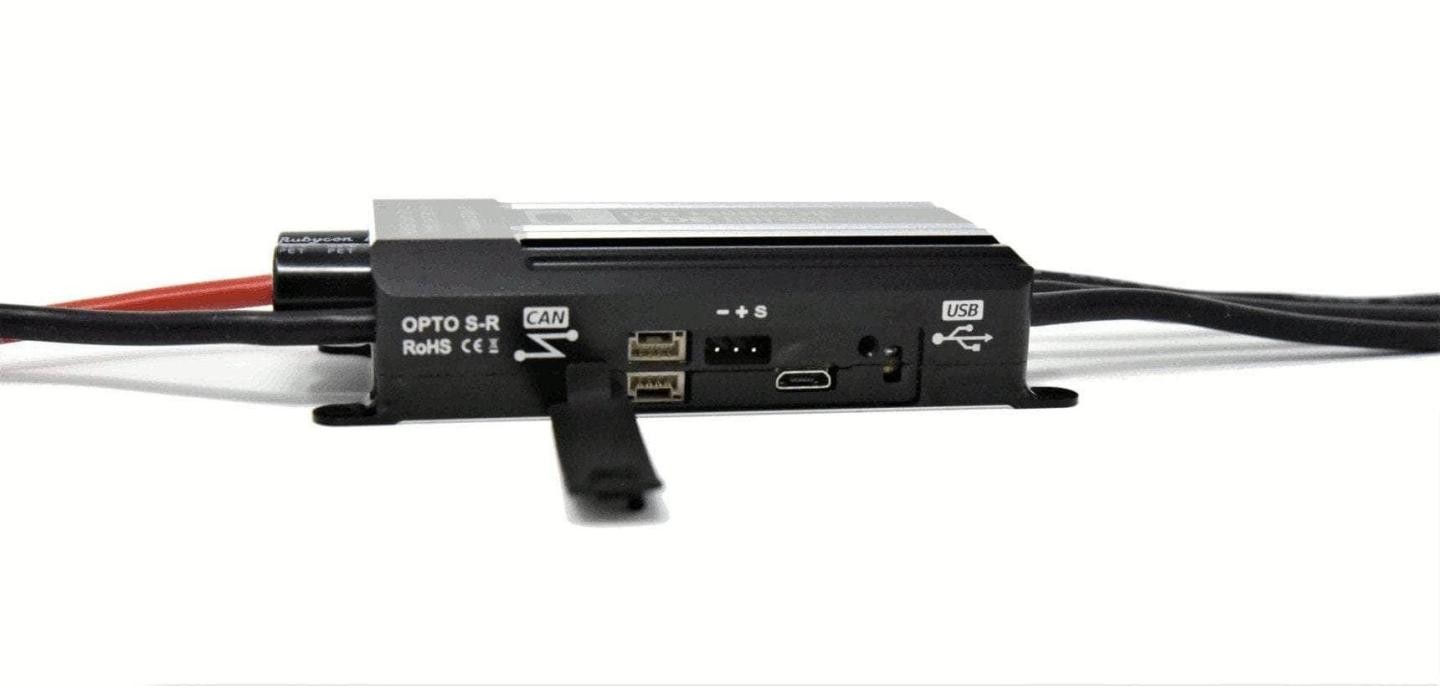

              The YGE 320's processor, driver speeds @ 16khz maximum PWM, driving periphery inverter bridge hardware sporting D2PAK Mosfets is clearly very antiquated in 2023??? Peel the sticker off pimp!Because a real engineer can look at the hardware and spec it at first glance.
              Click image for larger version  Name:	yge320hv_500x500_78a3af3f7d25aaf62a8ce149b7067070556f0954.jpg Views:	0 Size:	46.8 KB ID:	390092

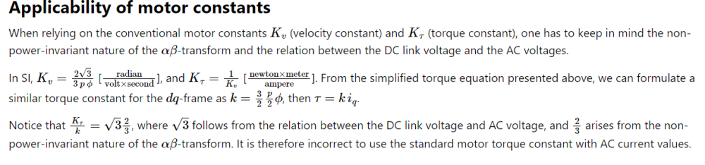

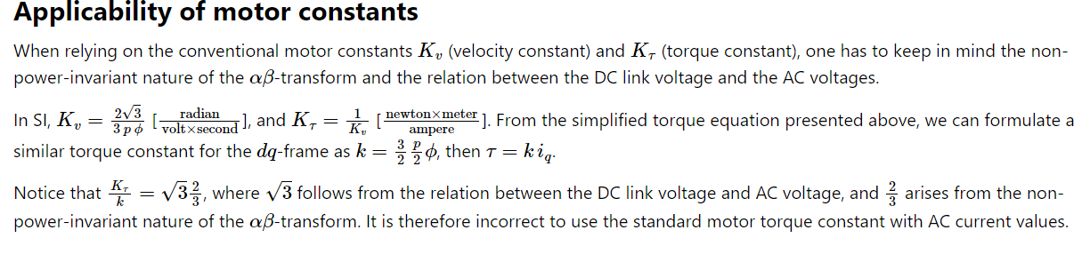

                Click image for larger versionName:	motor_constants_c5d554b8ae1d5910fc19f816b0b71564cff1c47a.pngViews:	0Size:	79.3 KBID:	390094

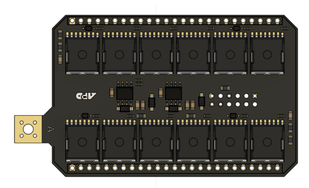

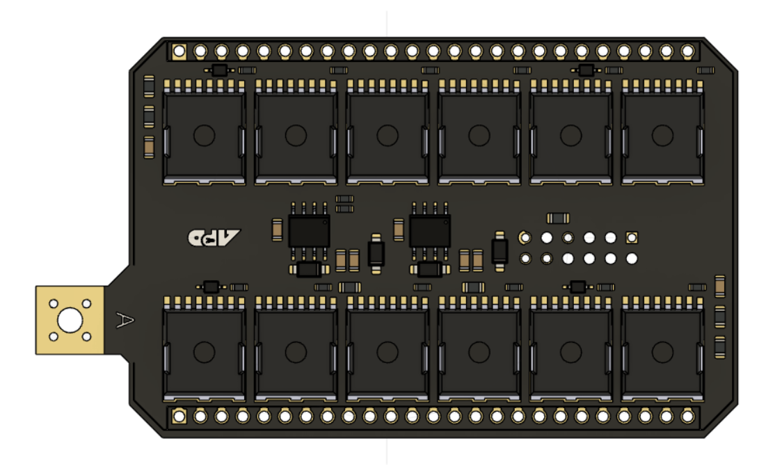

                  Truth be told......

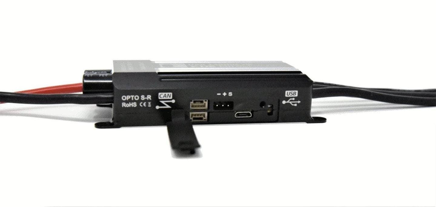

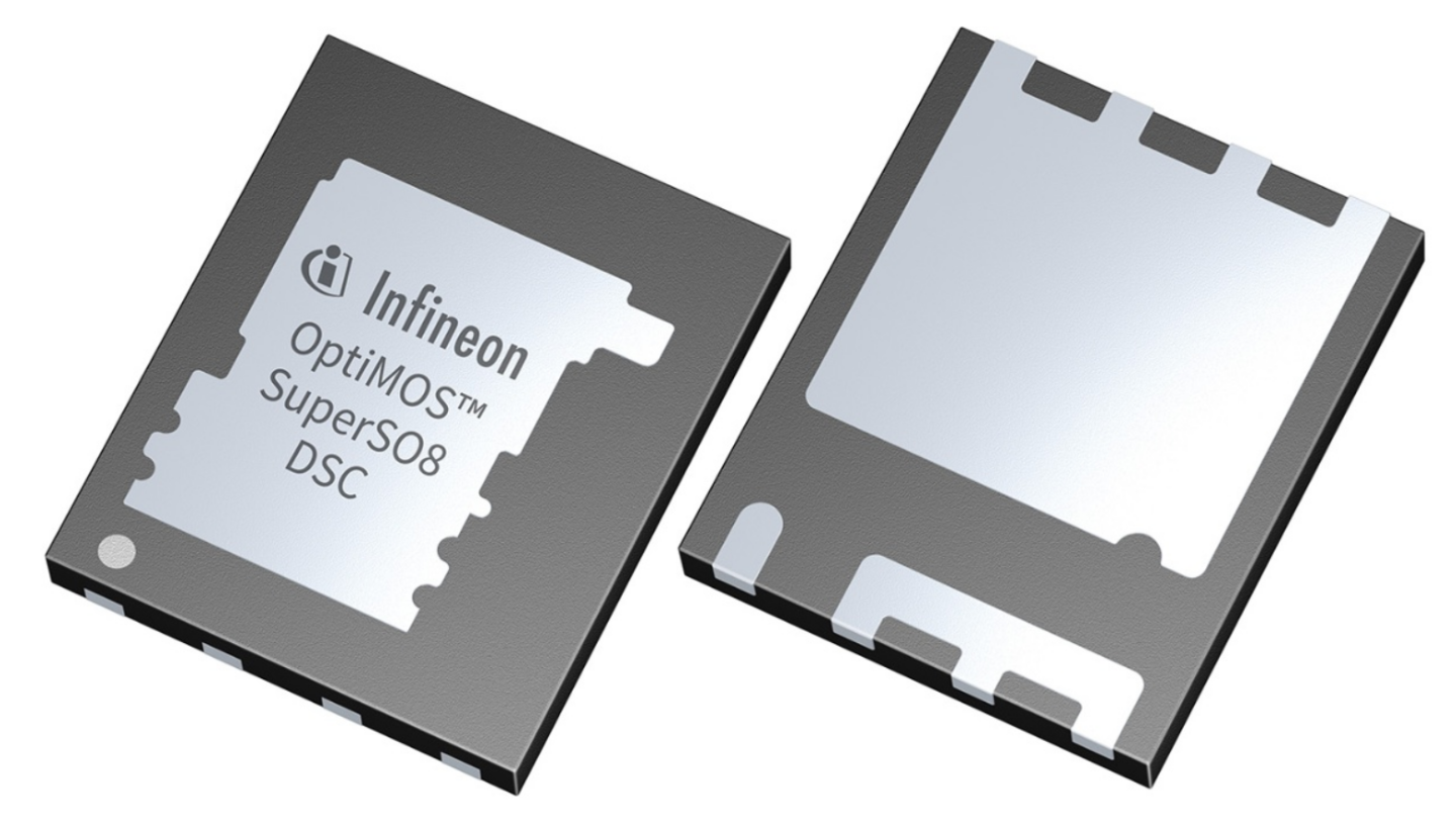

                  When you do not know what your Q & D axis inductances are you really dont know anything about what the motor really does or how to appropriately tune the inverter to it as a complete power package.
                  Common sense would tell any EE at a glance and BOM the difference in an APD HV PRO versus a YGE 320. The differences in current path design at a power stage is also blaringly obvious 👁👁
                  Click image for larger version  Name:	apd_power_stage__afd8be60b8ee1ddd37f6909ce50d43830d90b975.png Views:	0 Size:	319.6 KB ID:	390096

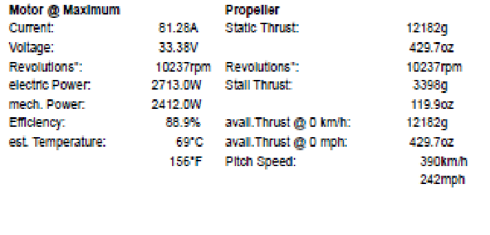

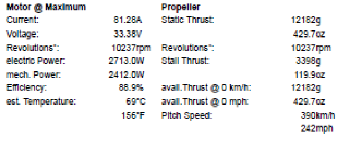

                    Click image for larger version  Name:	4638_289kv_gm_12x25_f9adf38ef52ee52e462779beacc7389471431ced.png Views:	0 Size:	153.1 KB ID:	390098
                    Click image for larger version  Name:	4638_ecalc_7983e2734715cec96b9bbd78039506727c8fe385.png Views:	0 Size:	63.5 KB ID:	390099

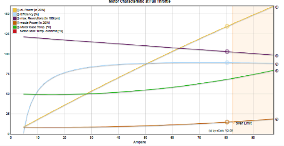

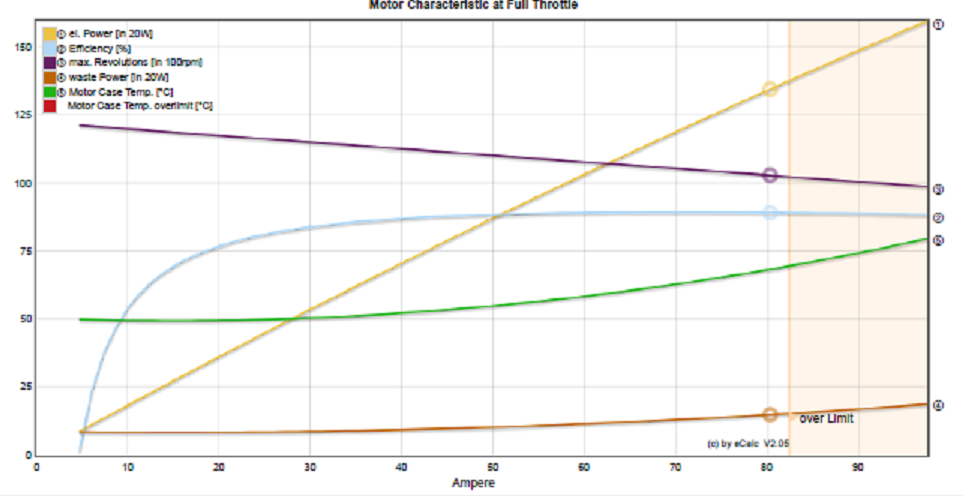

                    A factory wound 4638 Neumotors outrunner on an APD F3 200 and 10 s lipo GM sawblade with 23 inches of pitch. These results at 80 amperes suggest to me your prop, and motor setups are very inefficient!

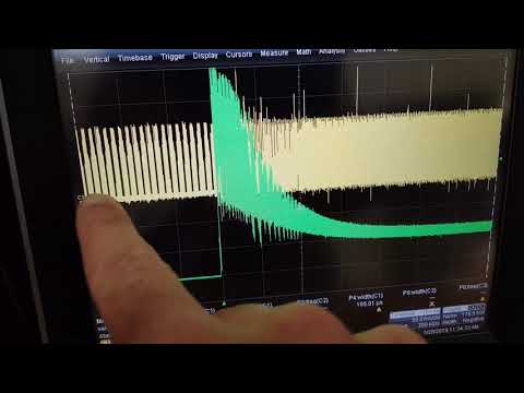

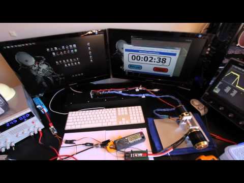

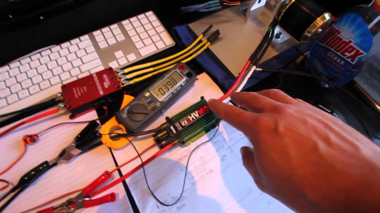

                      Click image for larger version  Name:	fetch?id=390080&d=1699528189.jpg Views:	0 Size:	65.1 KB ID:	390103

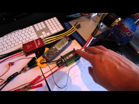

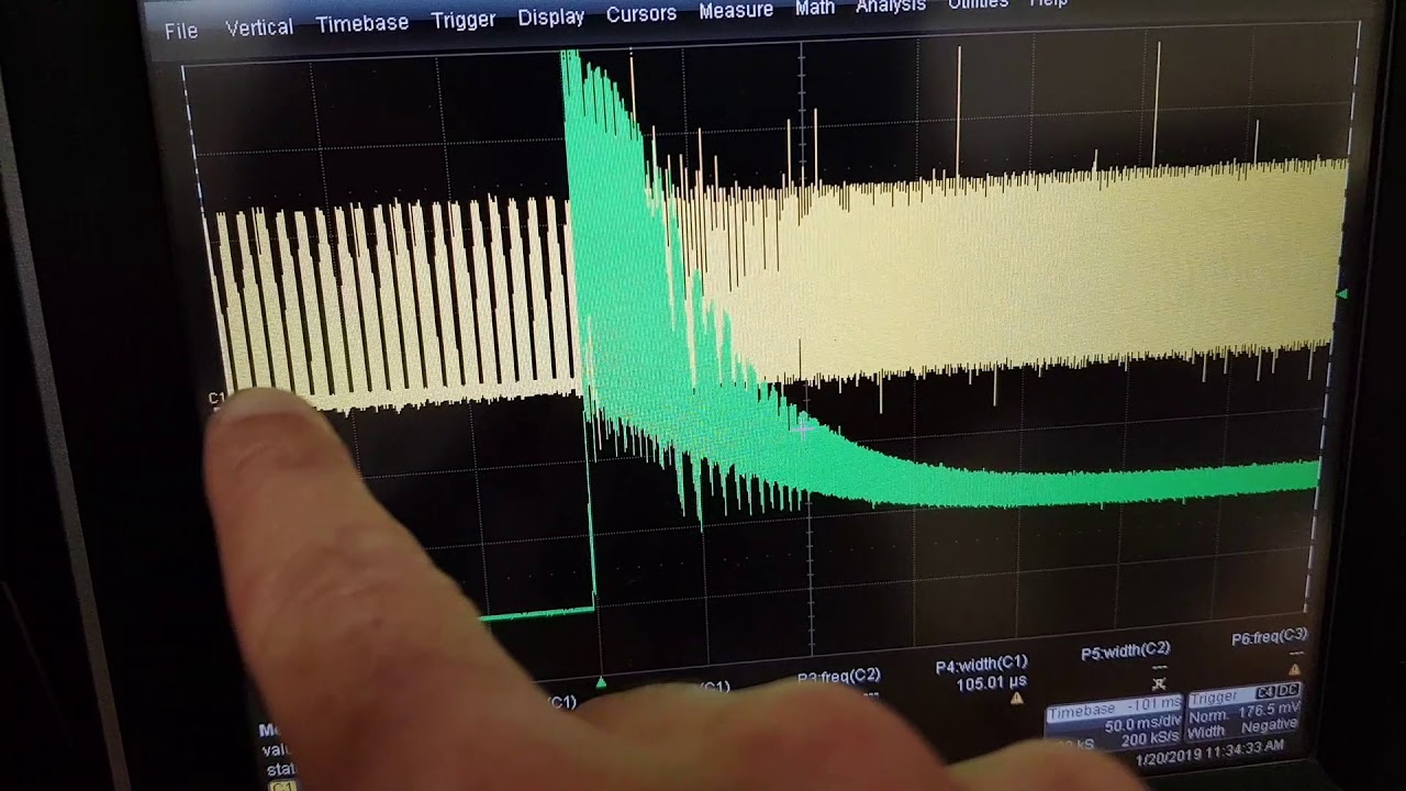

                      And finally where really is the dumb and not so strong (20% higher internal resistance) YGE on teaching itself the optimal setups for the special speed props.
                      Watch it again....🙈
                      I want you to fully understand how antiquated that 15 year old brick its parts and its sinus algorithm is.....
                      If your friends are satisfied with its performance for 600.00 why they spend 1200.00 on us???
                      You made a claim so now there is a Simple solution for DZHAMEL'S Black Box Birds... send him your "dumber and stronger"YGE320 and record the 605km/h for the German social media and your believers on RC groups.... the place is absolutely worthless now for it's lack of accuracy or integrity on the subject matter from people such as yourself in the motor construction and high performance sections of the forum. I'm pretty sure that's why Tony doesn't even waste any more of his time answering the inane inverter questions there and why Louis Fourdan has to create a independent scorpion review page with truthful statistical reporting.

                                      Now I want you to see just the APD F200 peak 350 @ 12s ampere easily....The inverter is 36 grams....
                                      I need you to see how ridiculous the idea is that APD prevents you from flying >600km/h You see here for 72 grams in a dual inverter setup we can deliver 700 amperes to the motor at 12 s lipo without breaking the bank.

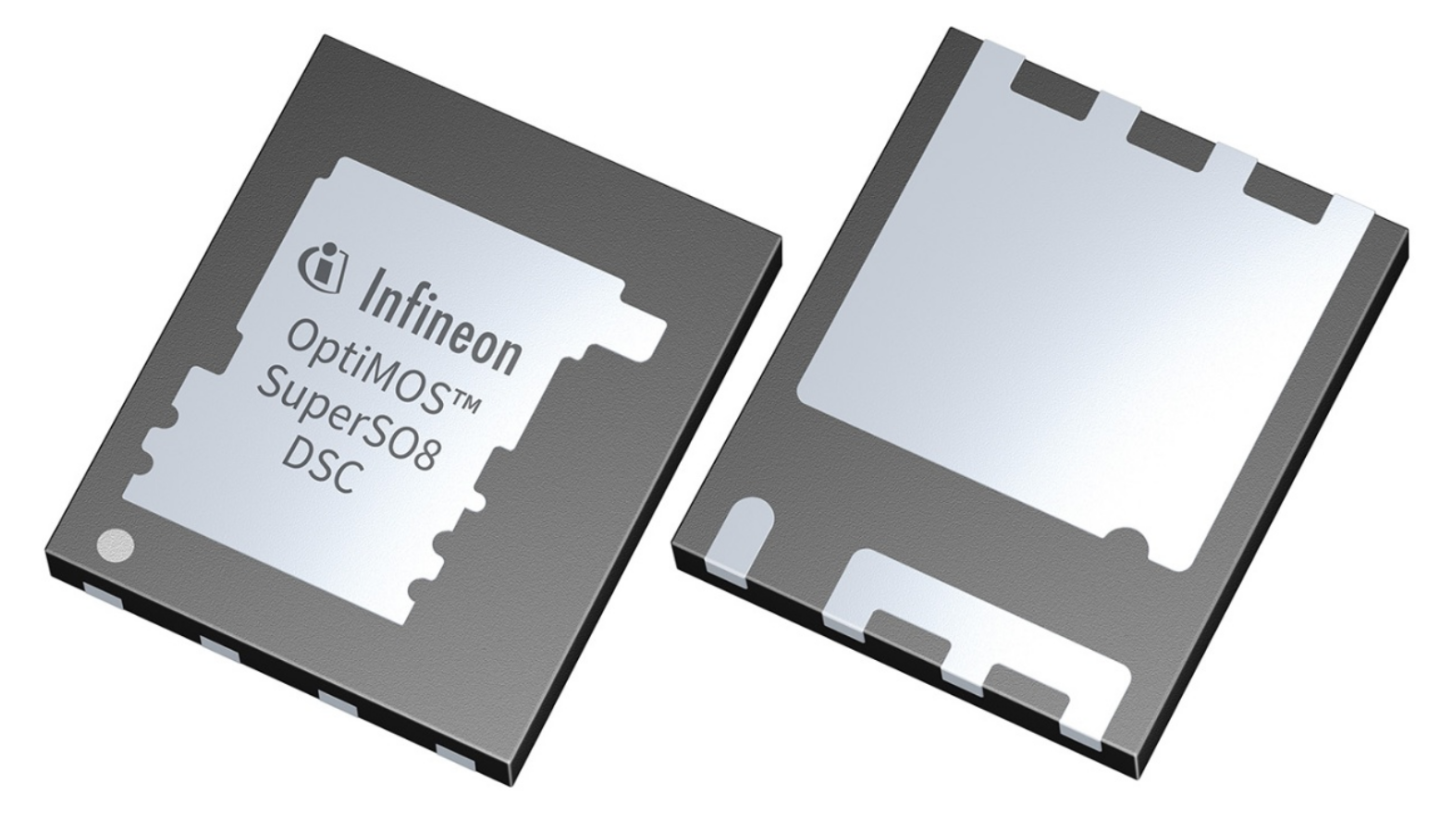

                                          You look at the control the sensor less inverter has You really have to be out of your mind to think the inverters are even in the same ball park.
