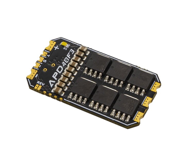

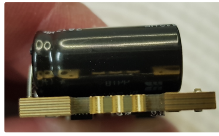

              Click image for larger version  Name:	APD26.jpg Views:	0 Size:	55.5 KB ID:	415367
              Even the little power smurf manages at 75,000 RPM on high poles and can at 64kHz. It is 3/10ths of a gram and peaks 2.25kW @ 6 s lipo for longer than 2 seconds...LOL! Do you have more to post there in Germany?

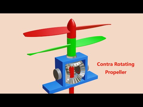

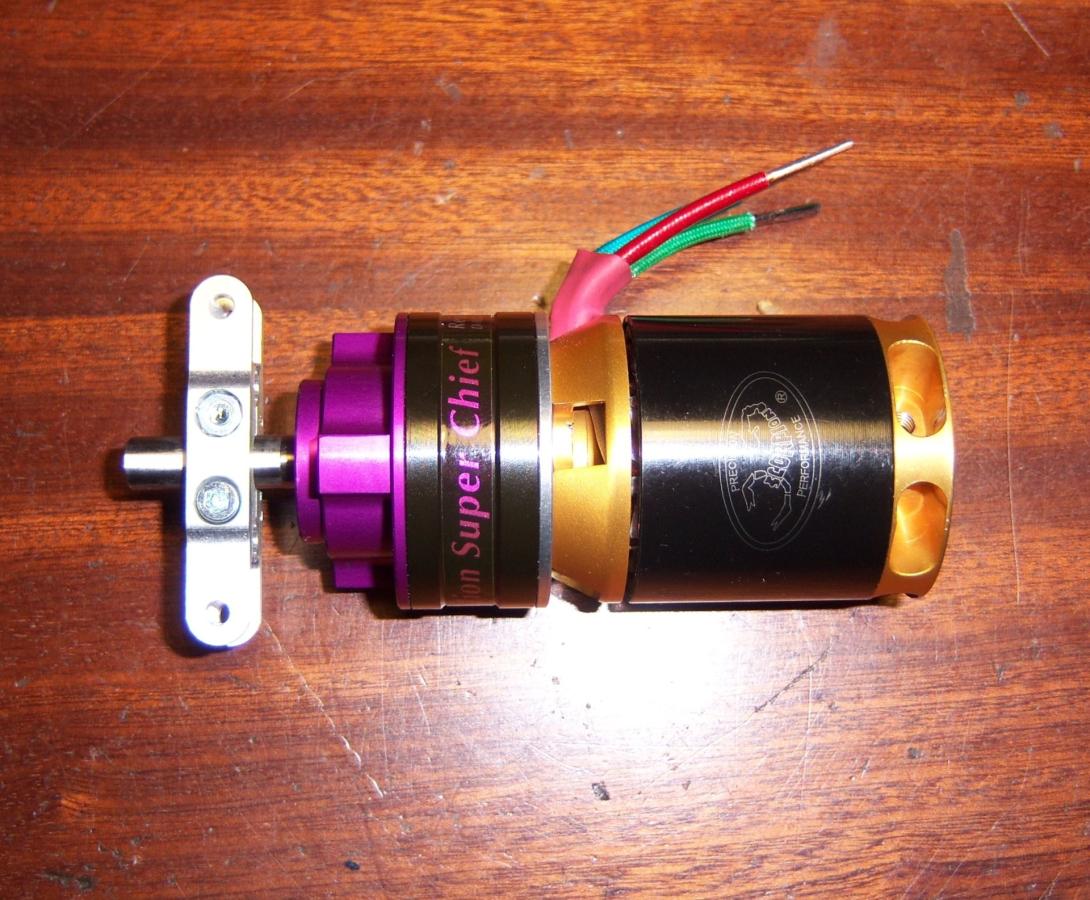

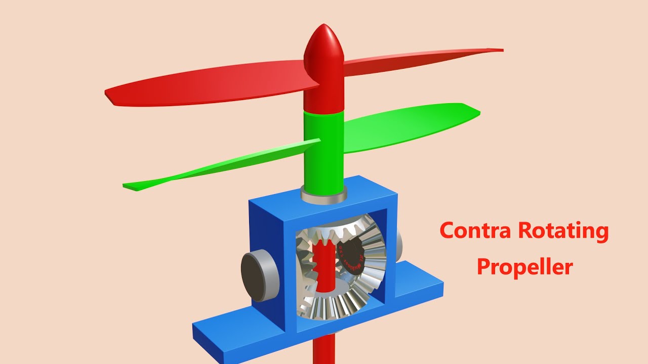

                Here is even more the troop can observe. As is has already been stated we can mount the gearbox in a contra rotational configuration. There it can turn these 2 contras at 6000 rpm on 10s lipo. In direct drive do you think an HK4235 special edition can do it for 80 amperes? at 60*C after flying a 25P flight plan?
                Also take note.... you cant even get a HKII4235 currently from scorpion...

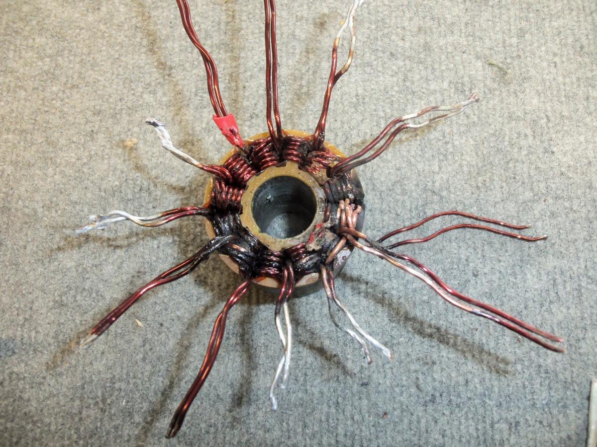

                              After we have had good experiences with the 4:1 Superchief and HK3536 on the PC 11.5x44.5 four-blade in the Elysium with 580kmh at 9kW, the theoretical potential of the transmission drive up to 650kmh is now to be exhausted. The direct speed drives no longer seem to give this leap.
                              A real speeder was needed for this, because the strongly stretched surfaces of the Elysium have their structural limits above 600kmh. Also, the monster has the right size for the Superschief, the Typhoon has 50% more surface area and would need even more power, which would overwhelm the gearbox.
                              In addition, the power had to be increased from 9 to 14kW, since the monster is larger than the Elysium and is supposed to be a lot faster. This meant increasing the diameter to 11.7" and speed to 11000U, as well as from 12s to 16s so that the current for 14kW does not exceed 250A.
                              Since there are unfortunately no 3:1 gearboxes, the adapted HK3536 now had to turn with 44000U, which it did at first. But then he decided to mutate into a magnetic grinding machine after the long bell suddenly started to vibrate despite the 8mm motor shaft.
                              Unfortunately, the Opto 255 without housing could not handle this machine and turned the engine test bench including the kitchen into a shot-up village. Especially in the tabletop he left deep and lasting impressions, amazing what the energy from 16s Lipos can do.
                              In the longer mourning phase I had enough time to remove a good 2mm from the beech wood table top. Then everything didn't look so bad anymore and the project had to be continued with the search for a suitable engine, which succeeded without further losses.
                              The still unnamed motor gets along well with the new Opto 255 at 44000U so 11000U on the prop, and allows itself at 56V 250A so 14kW, even 270A were no problem. Since everything held for 1Ah on the test bench despite poor cooling, it should work safely at 600kmh cooling air.
                              For this purpose, the regulator heat sink was moved to the outside, as there are sauna conditions in the fuselage, and the spinner was transformed into a Swiss cheese. In addition, the gearbox got a heat sink that lies well in the air, I'm really amazed at what the gearbox can do with glued pinion.
                              When the new lighter and more stable surface in core construction comes soon, the bird will land at about 2.6kg, i.e. 90 wing loading, and have a power-to-weight ratio of over 5kW/kg. Hopefully, this should achieve the goal, I will report it...​
                              • Ralph,
                                Did you note his little power system fell apart at 44,000 rpm?One HK3536 motor and YGE255 opto inverter destroyed or does no one the silly German site read clearly? He blew a YGE 255 with the power turd from HK in this stellar setup of his.
                                Looks like he drew more than 270 amperes in reality huh???????? The 255 peaks 400 amperes! and it isn't going to perform that well on 10 poles at 44,000 rpm
                                Replaced by an "UNNAMED" motor...

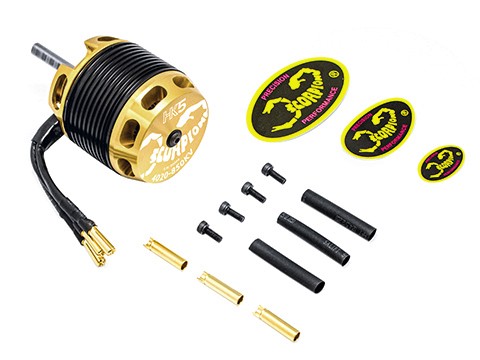

                                      • Certainly Its all funny. For one no hobbyist can purchase a new 3526 scorpion direct. A special order 3536 certainly makes more power than a 3526 but it is longer and it weighs 365 grams and peaks 4100 watts for 2 seconds. The Pyro 600 on a 7 to 1 planetary tops that everyday in 25P programs at 60C when its done.😀
                                        The 3536 weighs more than the entire supernova 3.7 with prop and spinner mounted. You guys compare a lot of apples to oranges but in weight the equivalent direct drive outrunner is 4020 HKIV 329 grams. It peaks at 2.6kW off the shelf. Mechanically verified.
                                        Scorpion HK5-4020-850kv - Scorpion Power System
                                        You and I both know it wont turn a 20 x 23 carbon fiber contra 6000 rpm on 10 s lipo direct drive. No one is interested in trying that with either of the scorpions in direct drive.

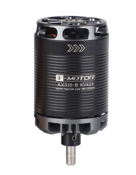

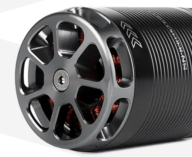

                                        • AX335-B_AX Series_Motors_VTOL/Fixed Wing Power_T-MOTOR Official Store-Multi-rotor UAV,Fixed Wing,VTOL,FPV and Robot Power
                                          Much better construction than the power turd. ​
