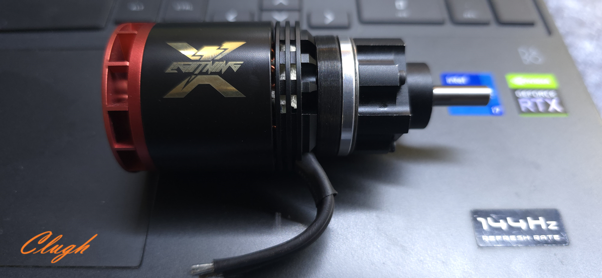

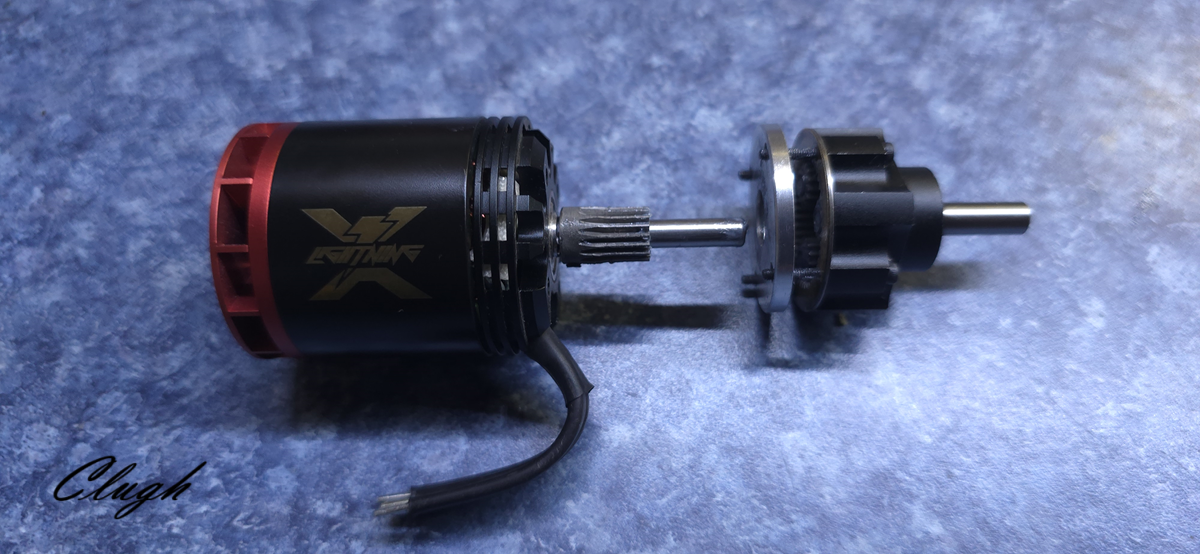

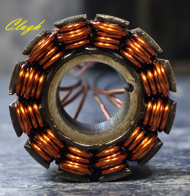

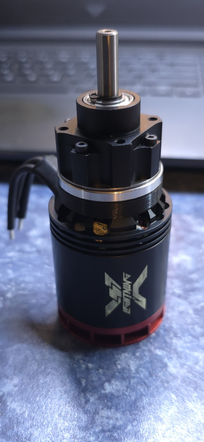

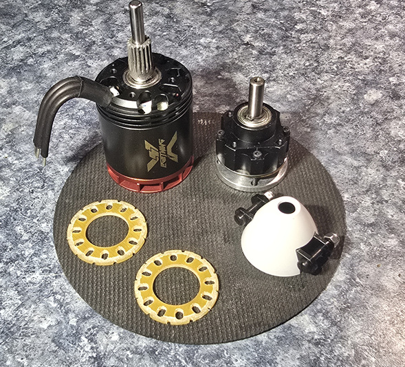

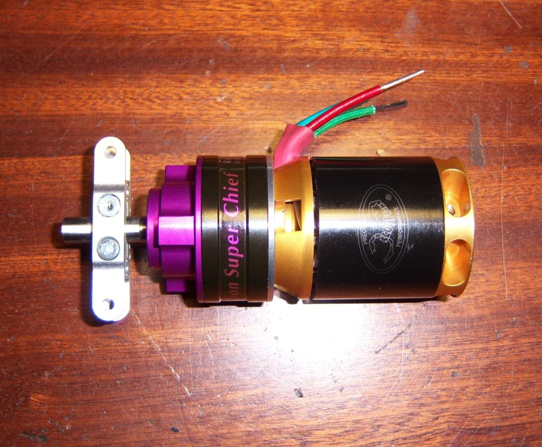

The Maxon P32 from Neutronics Motors is a 3.7 to 1 planetary so I dont have to wind for 44,000 rpm on the 600 sized outrunners. 😀 Its not too bad if this small package can deliver 4kW mechanical. I know in the 7 to 1 the pyro 600 can certainly do that from powering large 2 meter F3A planes and contra coaxial 20 x 23 pitched props.

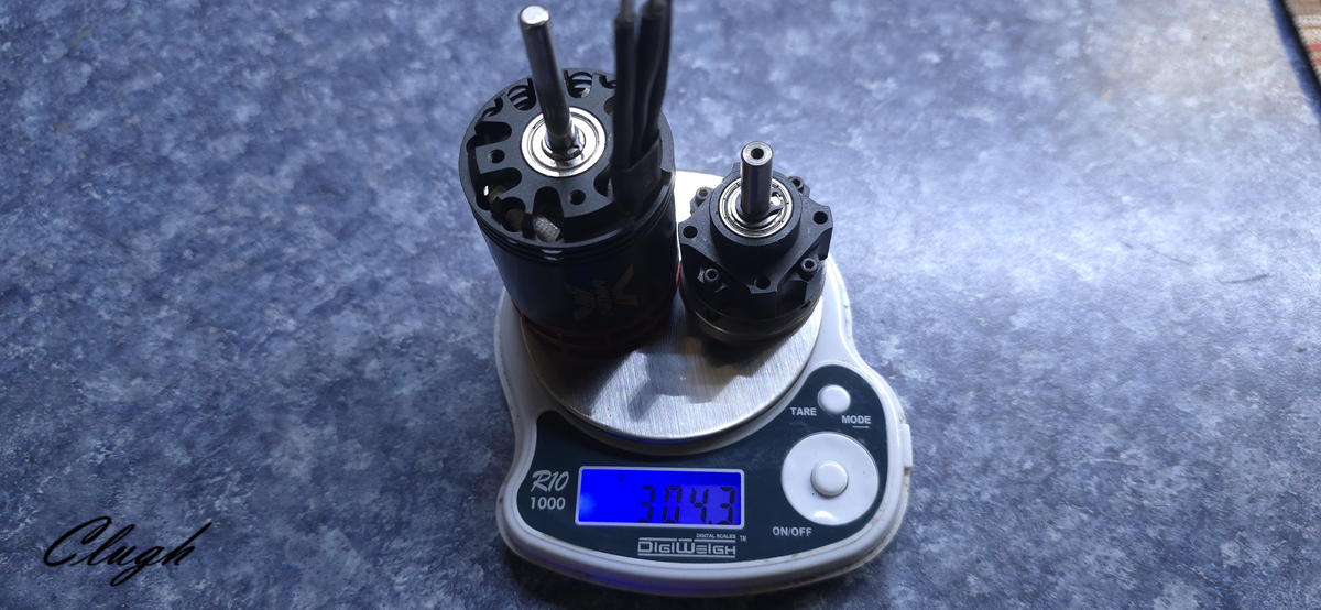

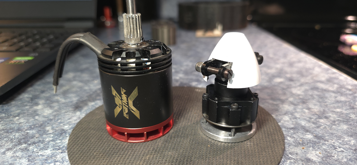

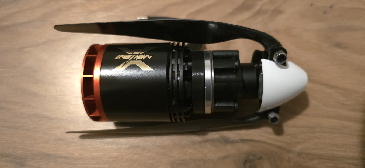

You can see in real life the Xnova 3225 and p32 3.7 planetary flange and pinion weighs 304.3 grams before the shaft was cut here in America
No time for games...

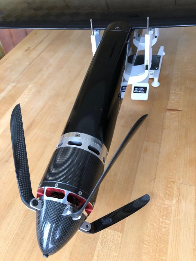

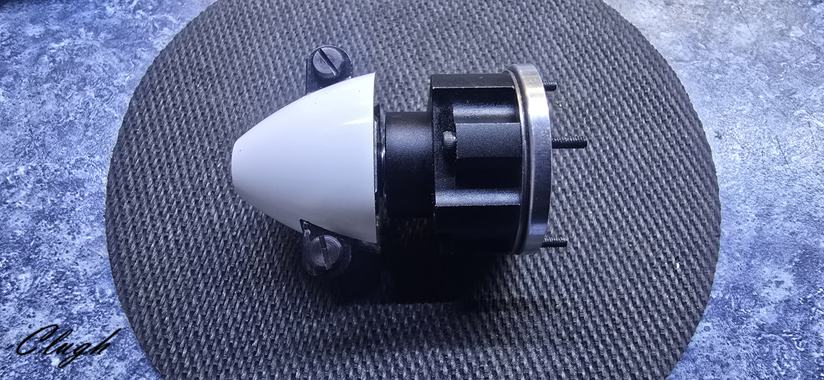

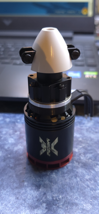

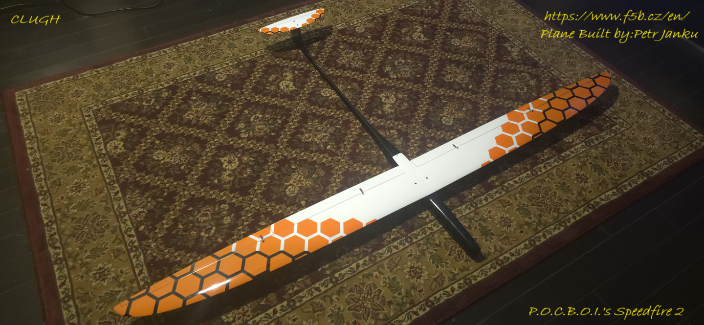

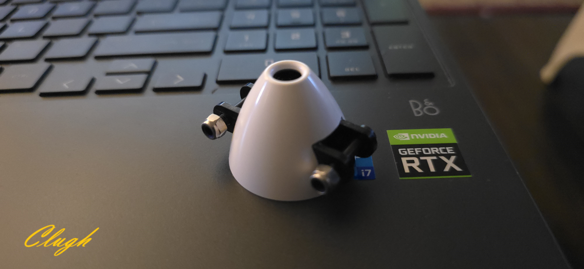

This and the new carbon fiber turbo cool 32mm spinner from Rudi fits my Speedfire2 perfectly. I purchased it from soaring USA. Itz zero camber but have the 6 degree on the way. 🙈🙉🙊
