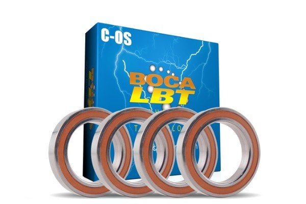

I know some motor winder overseas complained about the bearings I use . its okay. Right now I get them from a USA supplier at 15 dollars a pop. I could buy a lot from China alot cheaper but I'm scared of the quality even though they say they are the same. I really wish I could find a Swiss supplier of hybrid bearings., The Dry lube treatment that is performed means they don't need grease or to be lubricated. They are faster with even less drag that way.

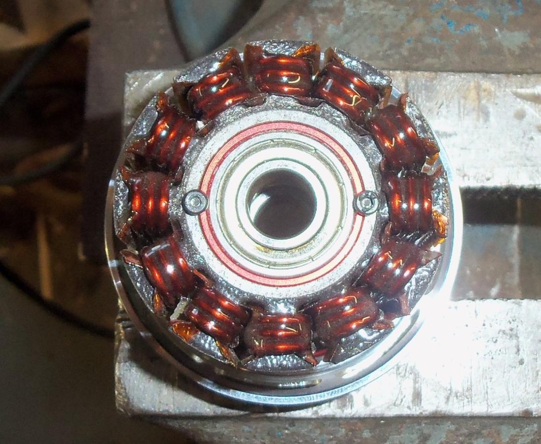

For the fastest bearing you want a full compliment with no cage. So even the orange seal are not the pinnacle but a helluva lot better for highspeed motors than standard steel. The ebay bearings are horrible in the test. Do not buy!Comment

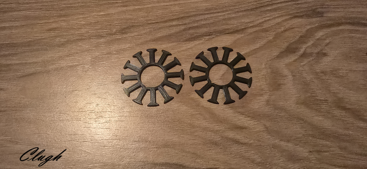

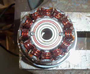

I sit here looking at this Scorpion HK I'm winding with its shifted stator plates i had to realign that haven't a lick of insulation between. They are clean and shiny.... no reason they wouldn't conduct to one another.. I have seen many with the shifted stator plates skewing the slot...

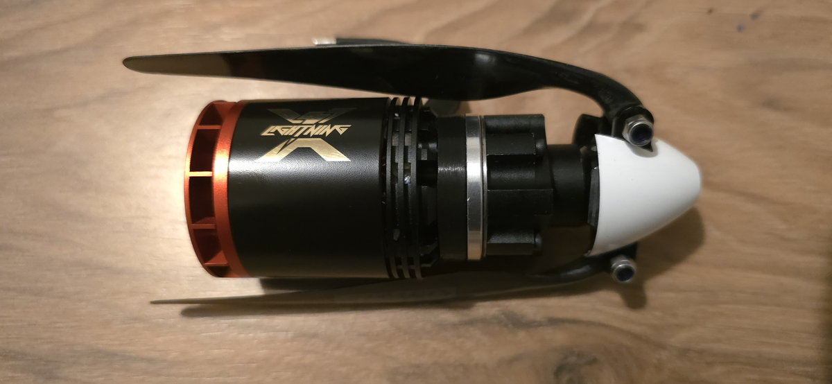

Im writing you in English to day because I don't care if your friends can read it or not all the way in Germany. You talk about engineering so let me ask about yours...

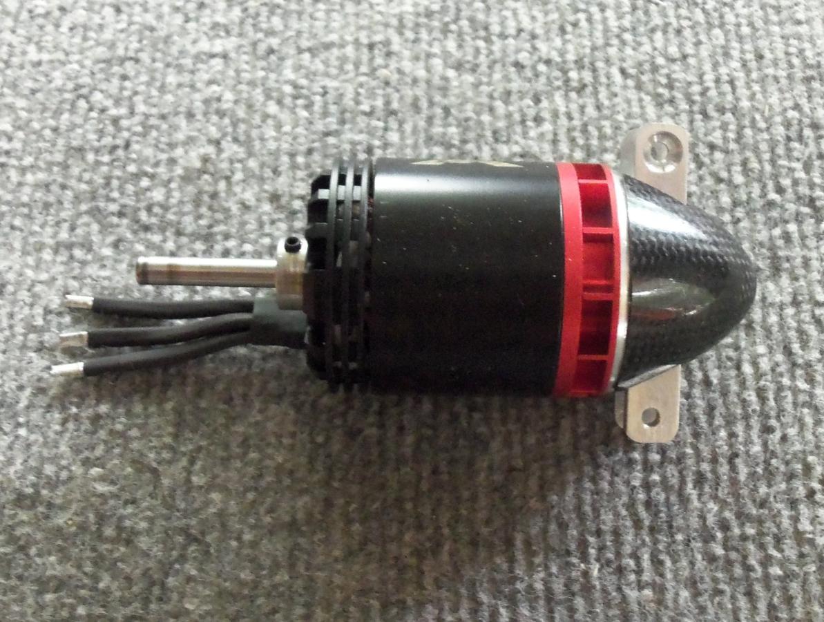

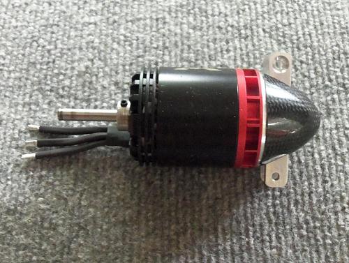

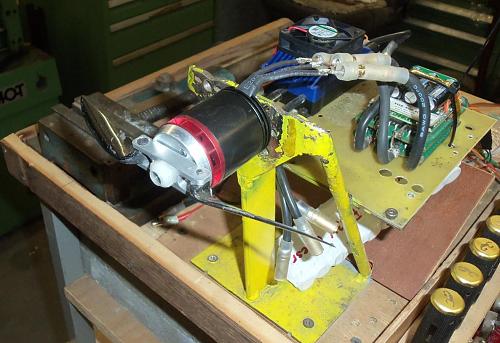

You have the Xnova for direct drive mounting a outside the airframe. You see clearly the axial cooling holes that the radial fan would feed in a helicopter where the rush of air from flight approaches the motor radially not axially. Since you have it mounted at the front on the plane where it approaches the motor axially why did you remount the radial fan behind a closed spinner and a piece of aluminum that you do not need that makes both means of cooling the motor ineffective and the entire drive weigh more?
Now It doesn't make sense for optimal cooling of the motor windings does it? So in the Smiddy calculator make sure to put fair or poor cooling as a parameter in the theories generated in the flight caculator.Comment

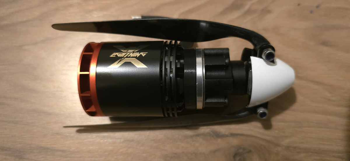

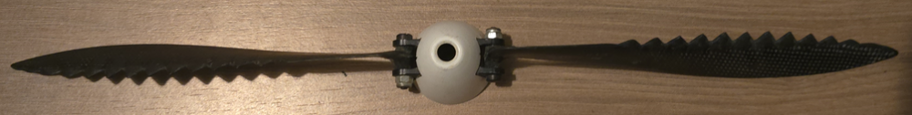

The next question i have is do you think in a direct drive with a 7 X 12 folder from markus beats the supernova? In what plane? . You never posted any numbers from this but id suspect that they couldn't trust them in their intended plane for a direct direct drive 3225 unless they plan to mount a YGE 400 in it like you did....

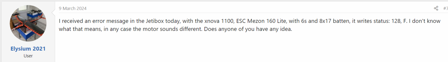

A modeler tried the suggested setup says the motor sounds different now and was left hanging on the subject matter back in march of this year.
When does he geat an answer about the setup thats not working for him. The smart MEZON 160 controller said no!
So how much does the power dwarf draw Ralph?
Or does Jeti not know how their inverter works?

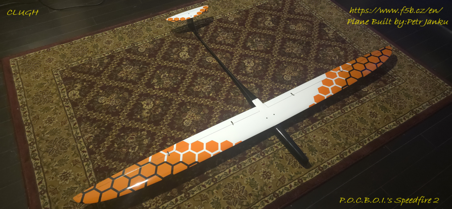

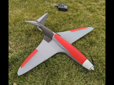

A 200 mph 1500g Speedfire2 with a 1200Kv Pyro 600 on a 3.7 planetary on 10s lipo is going to draw every bit of 160 amps and be right at the limits of the power dwarfs temp which we rate at 100C for any motor calculation. The plane can fit a suitable castle 200 or APD F3 200 inverter quite easily. lighter and more throughput with much lower on resistance. The xnova also still weighs a little more than a Pyro 600 . 😀

Id love to know more about it in direct drive mode on the suggested 7 X 12, 13 and 14 from Bieko composites.

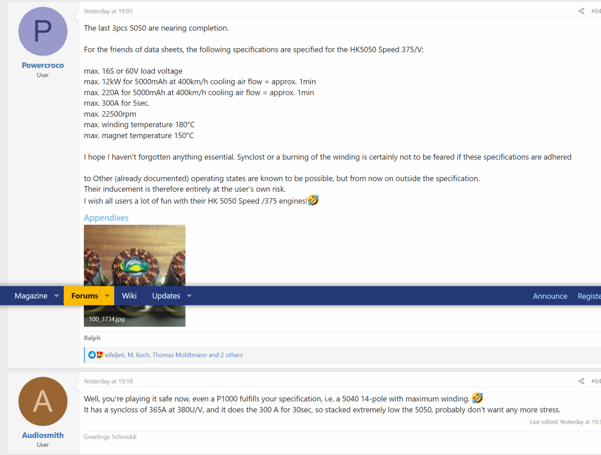

No reports on that direct drive xnova in crocoworld either.
I see Its silent there..... with the Jeti mezon 160 fault status code 128
Xnova 3225vorbereitet für den Speedeinsatz in Vorspantmontage | RC-Network.de
Great to see some truth coming through Ralph. They at their own risk at the "old" promised levels now huh? But I still want the boys to remember this desynchronization level s posted there for pyro 1000 with a YGE 320 😁
Also the scorpion 5050's had been been reported as 24 kW motors for years till today now they 18.....
Hubert.
