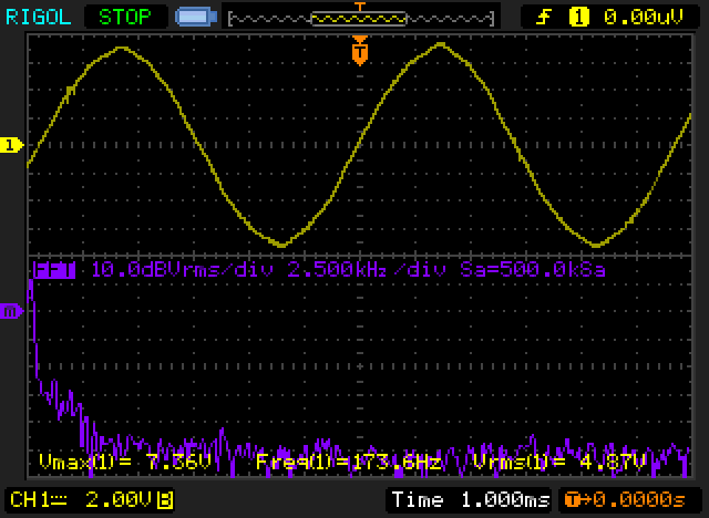

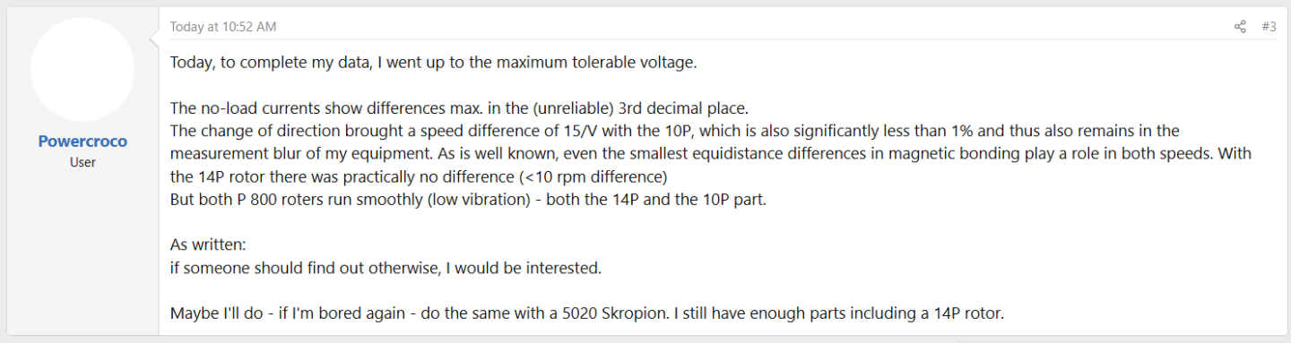

      Click image for larger version  Name:	image.png Views:	0 Size:	154.4 KB ID:	429794​Yeah that's wtf I thought! You still HAVE NOT left a single unit of data. o youre still a full joke to US but figure you better wind ya HK and test it before I leave them the real data. And what measuring equipment you use when you are not testing the right way nor are your reporting the idle currents. You still think your friends in Germany and American are stupid huh? Funny how my post drummed the bs back up again. Silly man hiding his comparative constants on a motor he says he has no use for but he is testing it again and still asking for data. You're so damn bright and weird you cant realize nobody in the world has any data to offer a clown but the English speaking Anglophiles. ..There's a million ways to test its effectiveness that doesn't require a 10,000 Yokogawa PA WHICH the IEEE top test equipment HAS ALREADY SHOWN THE IMPROVEMENTS BTW ! Despite that its very easy test.for a hobbyist it s obvious to everyone but a moron that loss translate theat. If the pm and bell have reduce loss even close to the projected numbers common sense would tell you you can look at the bell temps oif a motoro in operation and you can always turn a freaking prop and look at consumption. You know all that so please continue with the Minstrel show. You rather me expose you step for step. Ok cool go ahead with that. Let US and them understand .You're interested in anyone's data on a motor winding your application has no use for? We're glad you finished your unreported data yet still have interest. You really think the hobbyist are stupid....and cant see the dents in your reptilian armor No one In the world has any data on the external rotor hybrids but POCBOY....That's why you are here in class. Remember? Dr Okon You haven't posted a single thing of any scientific comparative relevance YET! I also see you aint ask ya buddy in Bayern or explain why it wouldn't be suitable for a hobby speed plane LOL!. See how you skew fact and I expose it easily? That always happen with fact versus fiction. Do you expect different results if you keep lying? It is mania, the sudden shift in opinion and emotions, u 2 go through daily. Its like menopause.
      "If someone tests this as well and comes to different results, I would be a bit interested."
      "As written:
      if someone should find out otherwise, I would be interested.​"
      ~Dr Ralph Okon~
      "The no-load currents show differences max. in the (unreliable) 3rd decimal place."
      And I know that's a lie there's no way the idle current is the same... what would you need any more comparative data if the phase resistance was the same with no change in idle current between the two machine that run at the same Kv The hybrid is a slower machine for sure therefore it can also hold larger wire becuase it uses less turns. Thats clear in the P700 data from the "Anglophile" in Cambridge UK!
      This is why real engineers leave data and not social media mania. Its even more simple why he wont leave any constants because that would mean someone could check his falsified recollection of data.
      Where are the recorded comparative motor constants on these 10 and 14 pole motors you supposedly and fairly tested with the control wye wound machine dude? Comparing a 10 pole motor and a 14 pole motor on the hybrid winding isnt a comparative test . The effect will be exactly the same on both engines.
      Click image for larger versionName:	Hybrids1.pngViews:	0Size:	204.5 KBID:	429795
      Where is the control wye wound motor and its constants Dr Okon??????? or you trying to confuse the forum again by comparing things not in question like two different pole rotors on the same wind .

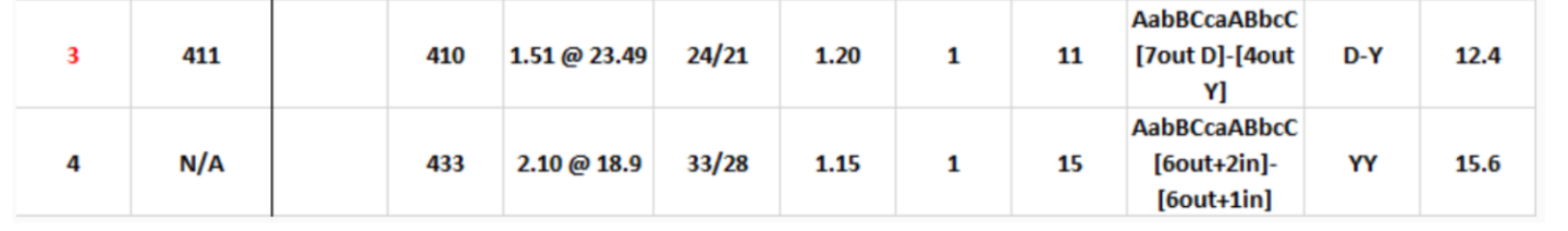

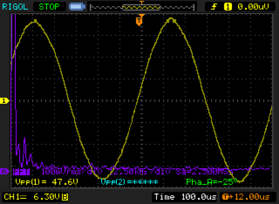

        Click image for larger version  Name:	image.png Views:	0 Size:	73.3 KB ID:	429799​The Hybrid P700 does a lower Kv with 4 less turns than a YY and it ran cooler despite less fill. and at a significantly lower idle current. Less turns in this case made it much lighter than all the other motors in the Cambridge test but with 4 less turns you can run alot larger wire with it. Larger wire with less turns drops the DCR. The mis already wound with a larger wire than the YY 1.15mm to 1.20mm
        The YY's idle current is 2.1 amps at 18.9 volts the hybrid is 1.51 amps at 23.49 volts After 5 min The YY who's idle would be even larger at the same voltage ran at 33 degrees Celsius the hybrid 24 degrees Celsius

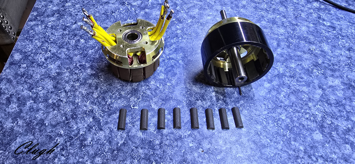

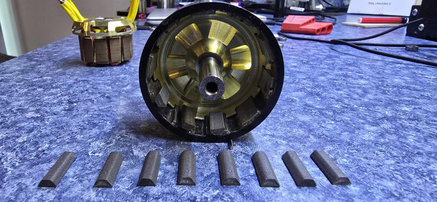

                I'll leave data when its complete with a new winding.

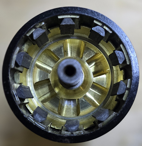

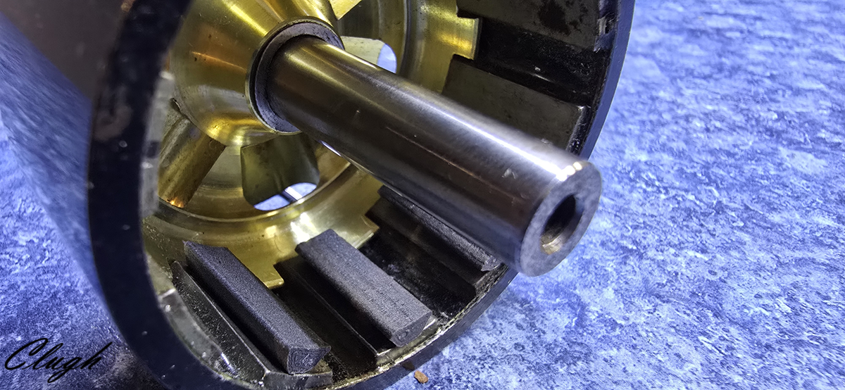

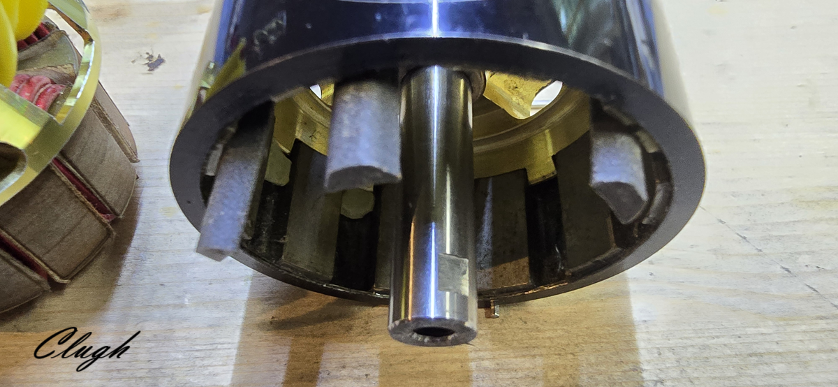

                But check out the 3DP semi magnetic slot wedges I made for a higher efficiency Scorpion HK5020

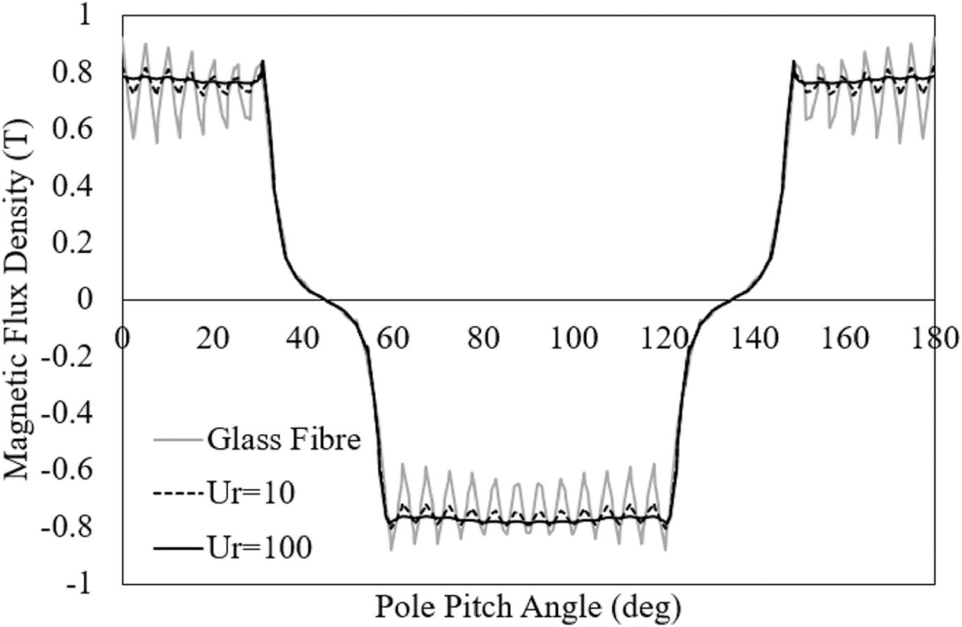

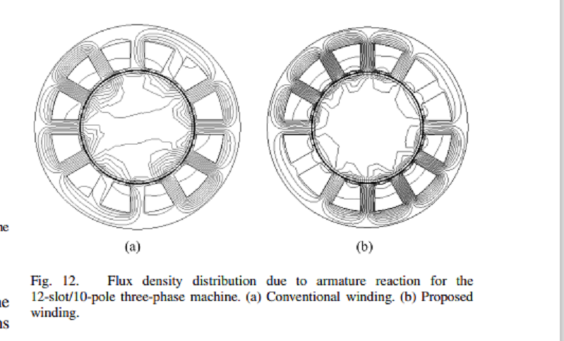

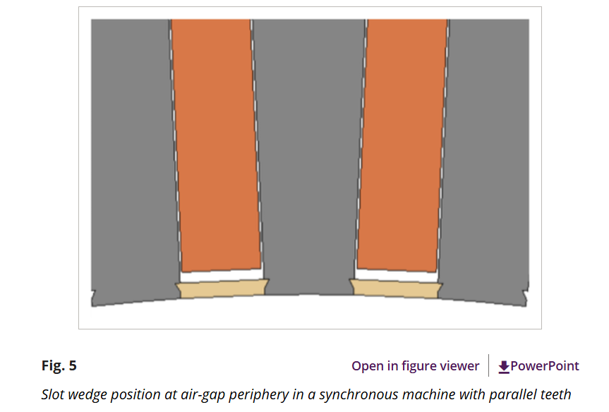

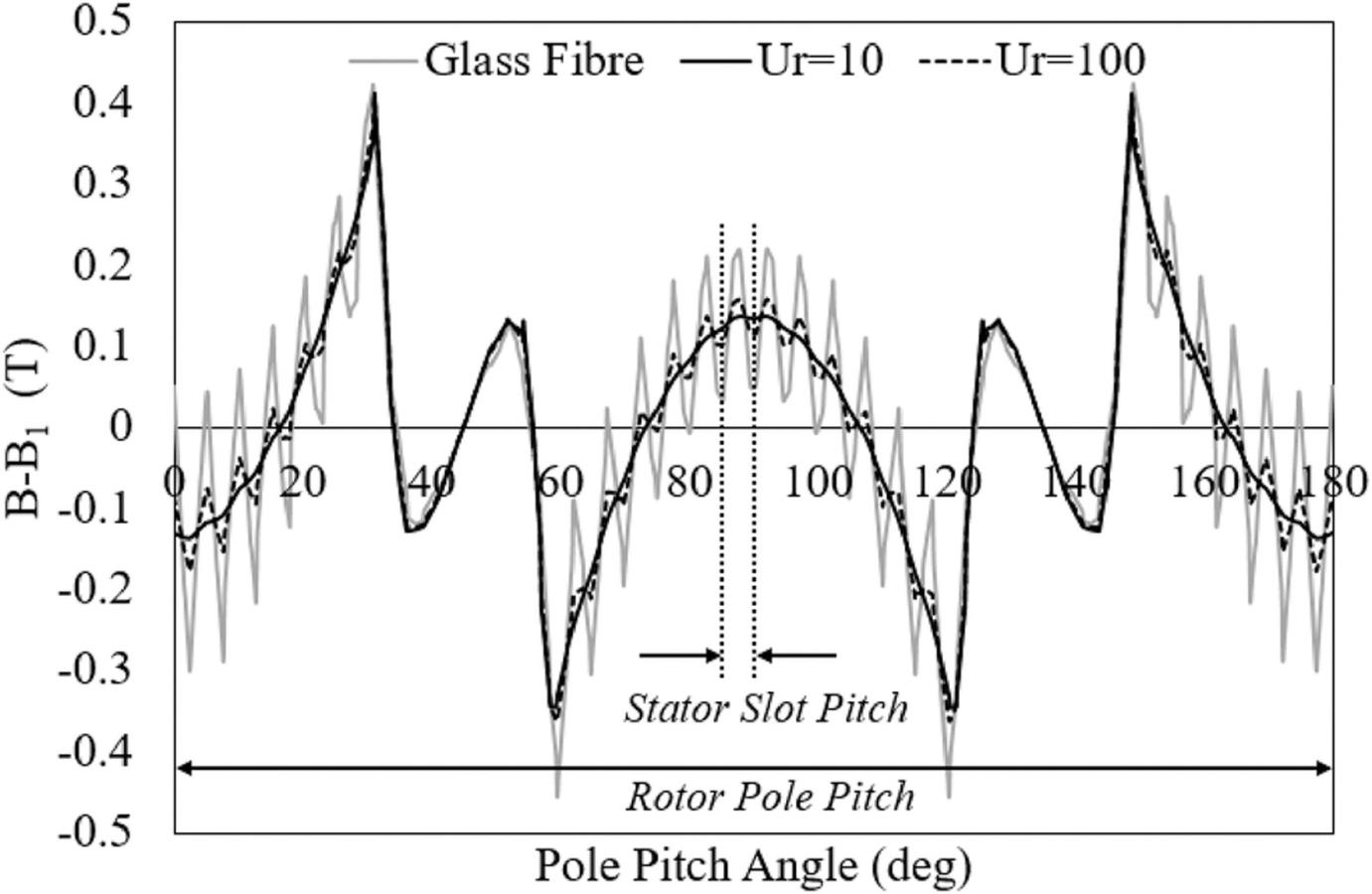

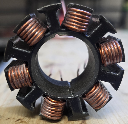

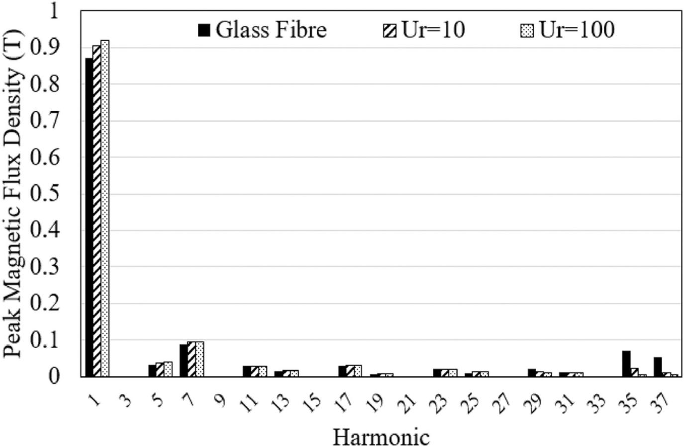

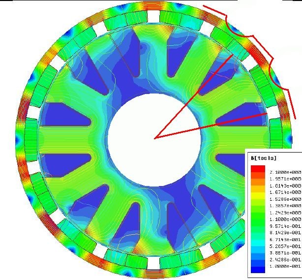

                  The theory.
                  4 Semi-magnetic slot wedges
                  ​The use of fractional conductor windings can modify (fine tune) the winding factors of the synchronous machine. These winding factors feed-forward to the air-gap flux density wave via the armature reaction MMF wave. Altering the winding factors has no effect on the stator slot permeances that have a large influence on the resulting air-gap flux density wave. The stators of large generators are usually designed with open slots and closed with a high temperature plastic or glass-fibre slot wedge to assist with keeping the coils in place. Open slots reduce the output voltage quality of generators and also degree the performance of motors – pole face losses increase significantly due to the increased air-gap harmonic content [6]. Fig. 5 shows the wedge placement in a parallel tooth synchronous machine.
                  There are commercially available semi-magnetic slot wedges [5]. These wedges have >1 relative permeability in the range 2 ≤ μr ≤ 10 and have been shown in single-tooth wound synchronous reluctance motors to reduce the harmonic content in the air gap by modulating the flux density wave via the permeances. It is possible that combination of reduction in pole shoe surface iron losses, reduced voltage THD, reduced field current, and improved efficiency energy conversion efficiency can be achieved by adopting correctly designed semi-magnetic slot wedges​

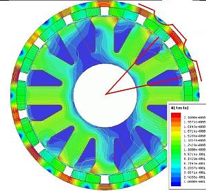

                  Click image for larger version  Name:	experiment3.jpg Views:	0 Size:	112.1 KB ID:	429837
                  ​Finite element studies can be used to determine the radial component of the air-gap flux density. The slot wedges shown in Fig. 5 have their relative permeability modified accordingly; 1 (normal wedge) ≤ μr  ≤ 100 (high permeability wedge). Transient motion analysis is also performed to determine the eddy-current losses in the pole face of the salient rotor poles. Fig. 6 shows the resultant radial air-gap magnetic flux density plots across a single rotor pole pitch in machine with different wedges, Fig. 7 shows the radial flux density harmonic decomposition, Fig. 8 the residual magnetic flux density over a rotor pole pitch and Fig. 9 the eddy-current distribution over half a rotor pole pitch.
                  As is clearly evident from Fig. 6, the stator slotting permeance causes significant variation of the air-gap flux density over the rotor pole face.
                  This leads to harmonic losses in the rotor pole surface and increased armature voltage harmonics, both of which are undesirable. By introducing the semi-magnetic wedges (here we must note that the wedge permeability is much less than the stator lamination steel), there are two observations;
                  • (i) Increased fundamental flux
                  • (ii) Reduction in the high frequency slotting harmonics
                  The increase in the fundamental flux is attributed to the shortening of the effective air gap, the Carter factor for the stator is reduced, and hence the effective air gap is smaller. The Carter factor is usually computed via conformal mapping assuming that the steel has infinite permeability and the stator slot opening has a relative permeability of one, this effectively enlarges the air gap – this effect is reduced with semi-magnetic slot wedges.
                  As a consequence, the fundamental voltage capability for the machine will increase slightly, or the required field current for rated air-gap flux will reduce along with the associated loss and temperature rise. Second, due to the reduction of the discontinuity of permeability in the slot opening, the stator slotting permeance function becomes less pronounced, reducing the high-frequency slotting visible in the air-gap flux density waveform for a machine with conventional wedges

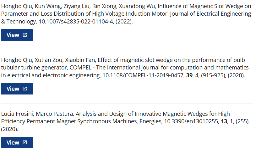

                  Use of fractional-conductor windings and semi-magnetic slot wedges in synchronous machines
                  Christopher Donaghy-Spargo, Anthony Spargo
                  First published: 14 May 2019
                  https://doi.org/10.1049/joe.2018.8205
                  Citations: 3
                  You can always cut the overbearing CL off Docta...and try to make new friends that will not constantly try to force you to build a 41** LMT
                  ​YT,
                  Hubert​

                    From left to right if you look at the 2nd and 4th attachments in the previous post you can see all the slot noise that unwantedly effects flux density. The slot wedges reduce the noise as the permeability of the wedges increase.. They also increase the peak flux density when selected correctly. You can observe that data in the 3rd attachment above..

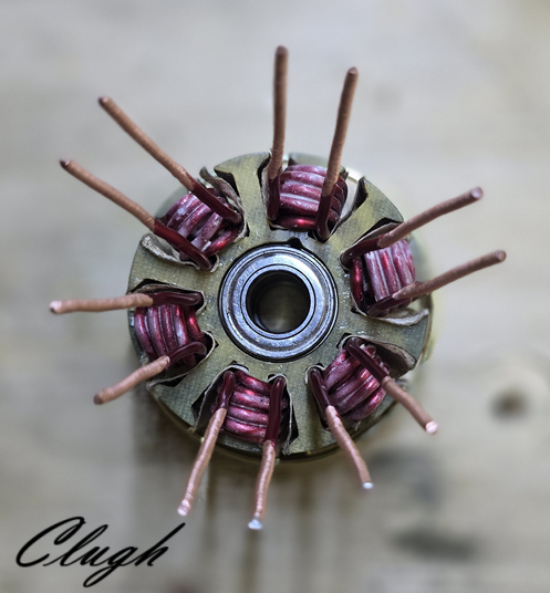

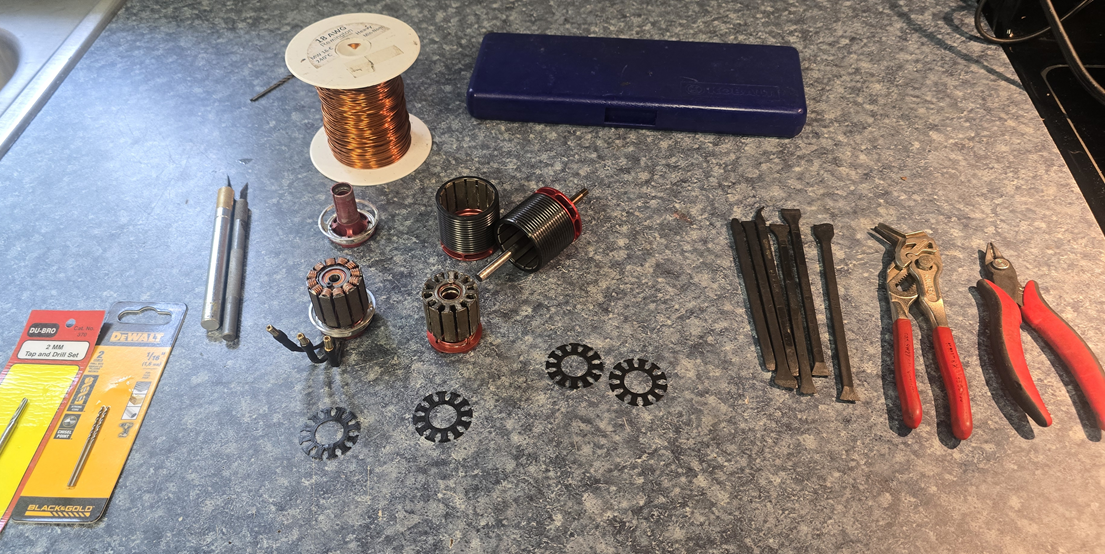

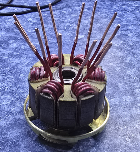

                      Since the HK 5020 is already laced with 9 turns of 13 AWG 1.828mm. I'll wind a 5TY+ 9TΔ. I'm pretty sure I can fit it or get close. A parallel version can get good fill because it is a single coil winding on all 12 teeth before you terminate it. See all 12 slot wedges sticking to the pm. I wont install them at first so I can look at just the hybrid winding effects.
                      Thank you for your time and patience.
                      Huber

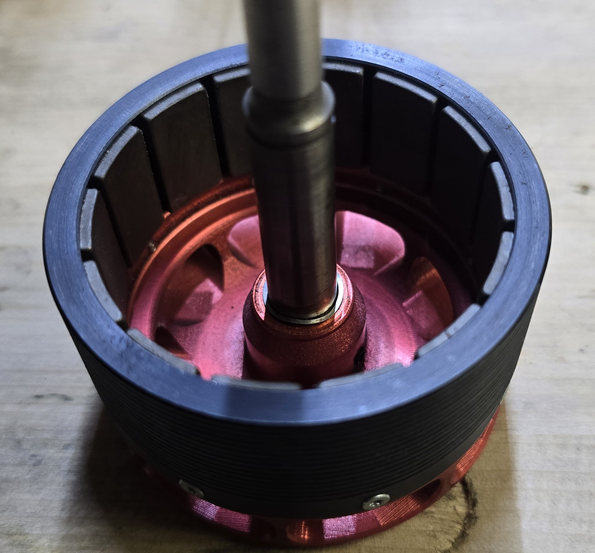

                        The pyro 800 hybrid already had the delta coils secured with the boron nitride infused since I have the room with the securely out the way I'm going to mixed gauges. For the wye coils I plan to use 15 AWG. Both machines are ready for the open wye coils to be wrapped.
                        My rotor bell is super clean and the PM is nice with uniform spacing around the can.. :stuck_out_tongue:
                        Thanks for you time and patience.

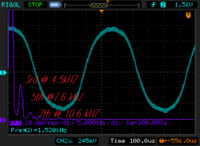

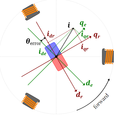

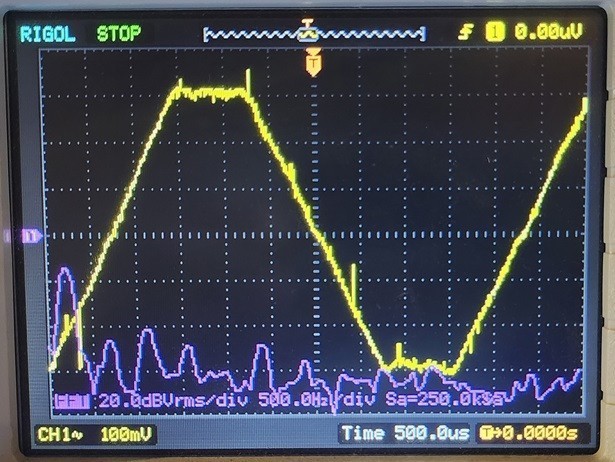

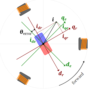

                                    Don't be confused Dr! This is the opposite end of the spectrum with BLAC commutation and a sinus machine. I think is that that your application has no use for because most of the action occurs at wide open throttle. Its BLDC there with most drives so what I offer you is this kind of thing is for better dynamic BLAC performance in an EV like e bikes. In our case we don't want to attenuate the 5th or 7th in the BLDC 10 or 14 pole machine. So the feed forward concept is not for you. unless you want to highlight or make better the pseudo sinus character with multi-layer 10 and 14 pole machines in 2,3, or 4 layers or maybe more. A conventional wye dual layer 10 pole motor has a more sinus character than the single layer delta which exhibits more BLDC character.
                                    An adventurous one test it all to find out what actually works best for their application. You always look for improvement anywhere you can have it but this is my theory based on what I have been exposed too on what best for the 10 and 14 pole machine with six step drives at WOT.
                                    Be mindful that those higher multi layers machines for clean sinus operation have slightly lower winding factors than the conventional wye wound machine. But because its so clean maybe its still a win with SVC FOC which always commutes 90 degrees perpendicular to the rotor.
                                    Talega can do it and the low pass filtering as it is a SVC DSP based Motor control IC.:stuck_out_tongue_cl
                                    Click image for larger version  Name:	svc.png Views:	0 Size:	36.8 KB ID:	429931
                                    :point_up:
                                    See the "Q" axis???
                                    Theoretically its MTPA there. Thats on the inverter and commutation side of things. if you truly want to run SINUS you need a fully dedicated sinus drive and then you wind for sure those higher layer numbers. But one could still finalize it to an inner delta.
