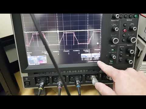

Look what the slot wedge does at 3mu in the IEEE test. It is also notable how much broader the efficiency is at 30 mu wedges. You lose some torque there for that gain in broadness across the power range. Can you read this correctly Dr. Can you interpret and make sense of the obvious results? I guess a carbonyl wedge or varying thickness might get you there. Its amazing you keep trying to stuff copper when a thin wedge made from carbon fiber may improve things significantly across the power band. You see it right here 🙈. No one cares about the speed planes. This is e motor tech and the results from the discrete labs with the $10,000 - $15,000 PA's. What does the common hobbyist have? Not even a scope.

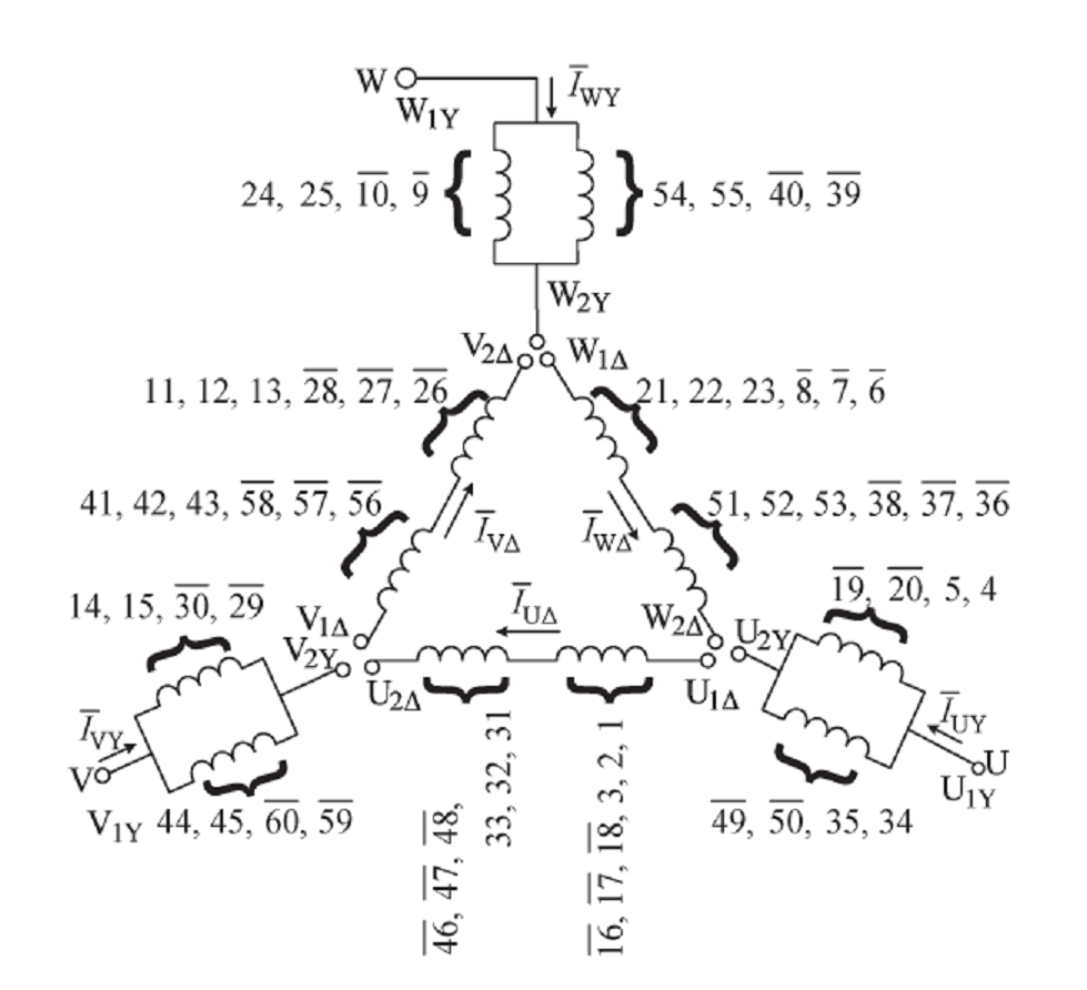

But I don't fully believe the rewound Superrnova report In Germany. I've looked at that motor tell Thomas to show you a log where it took 189 amperes and didn't get hot .
Its a 3220 stator so I'd like to see a video of that pull.....
189 amperes running it through it constantly with any regularity is real bs. Its the same old low resistance wind from 15 years ago. A conventional delta marginally performing in the ac with circulating current. The parallel single layer wye align works at 3o plus amperes less to produce over 6kw its 424 grams and turns the 1918 ABC prop with an AR of 1.9 approximately 30,000 rpm.
Its a decent motor I guess as it claims to out perform the XNOVA 3220. Aesthetically its also more attractive and facilitates axial coil cooling in a direct drive mounting like most drone motors..
If you said 100 amps was rms power which is typical for a 3220 block like this. The motor can probably do 141 amperes towards it limits. You cant get but so much copper into the small geometry with larger stranding which always leaves wasted space.
There's also truly not alot of love here in America or Canada with 14 poles contras and the F3A inverters they are using with their premium brake settings. ItZ critical with them. How that translates to other forms of e flight I cannot say. But their F3A D3 6 step inverters like a 10 pole better.
It would probably be cleaner electrically if it had smaller stranding and utilized more turns and possibly better fill.
The bottom line is the single layer wind generates the most torque and should work better with a six step inverter.
Do we need to start over and reexamine multi layers being in the denominator of the Torque function? There is no way if it is utilized correctly a conventional dual layer wind make smore torque. To utilize it you have to quiet the slots or you can make it slot less.

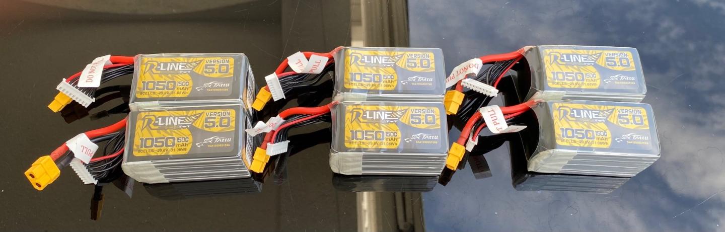

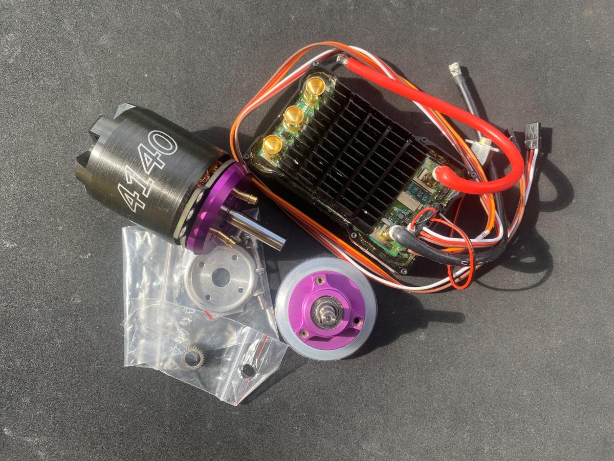

Hallo Ralph, wundert es dich, dass der Kollege aus Bayern fast zwei Monate dort war und mit nichts Neuem außer dem gleichen maschinengewickelten Motor zurückkam? Er hat von dir gesprochen, aber wo ist der 14-polige Halbach-Wunderrotor? Wir haben schon drei Outrunner mit einem 4:1-Thomas gesehen, deinen und den von Pocboys. Der Mann ist verrückt, die Akkus, die er gepostet hat, sind nicht von Gen Ace, sondern von Tatu, wenn er sein eigenes Foto lesen kann. Sag ihm, er soll das Antriebssystem laufen lassen, denn die maximale Drehzahl des 4140 liegt bei 35.000 U/min, und ein 8-Sekunden-LiPo würde ihn auf über 41.000 U/min bringen.
Ein 4-Turn 4140 hat eine kV unter Last von 1416
Das Besondere daran: Ein Pyro 900 wiegt 5 Gramm weniger und kann seine Leistung problemlos abrufen.
Warum verbaut er keinen deutschen Sinus-Wechselrichter, sondern einen amerikanischen Sechsstufen-Antrieb aus Kansas?

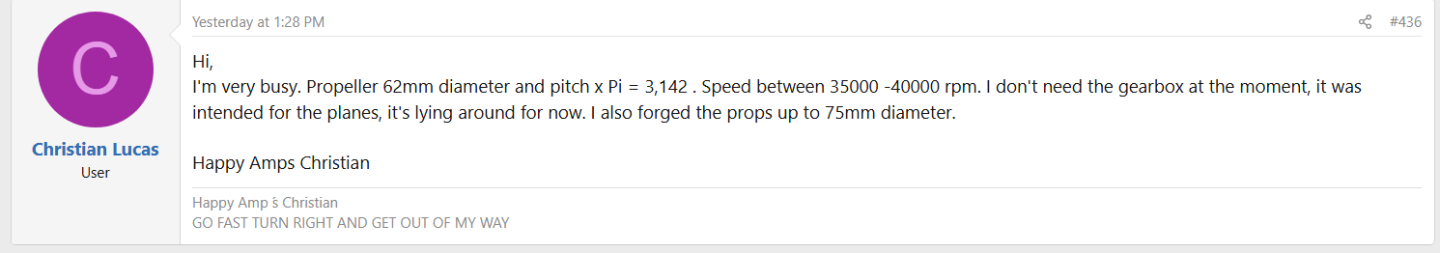

Definitely ba out of Bayern firstly on a 4 to 1 gearbox you wont get 30-40 krpm at the prop and the motor is definitely not turning a 65 mm prop with a pi aspect ratio anywhere near there without the smoke...direct
