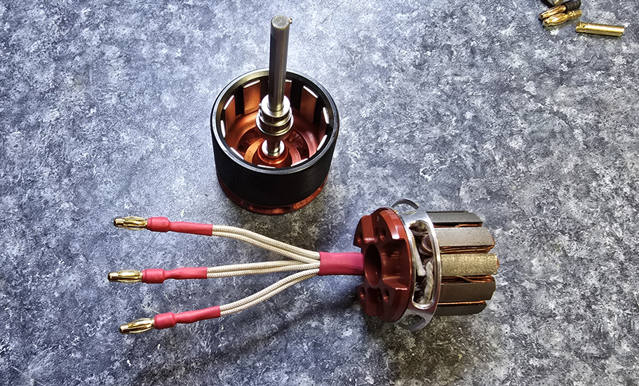

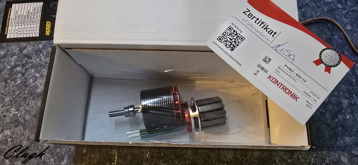

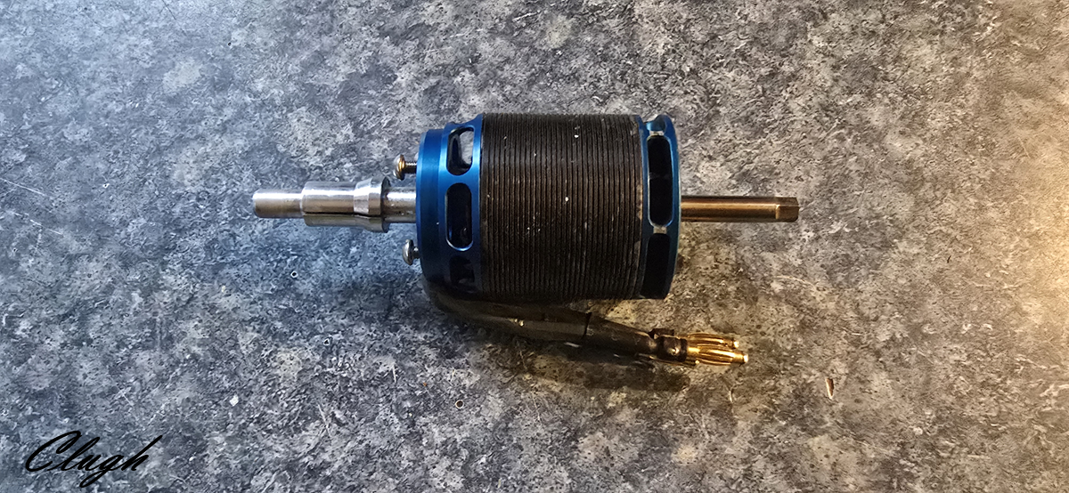

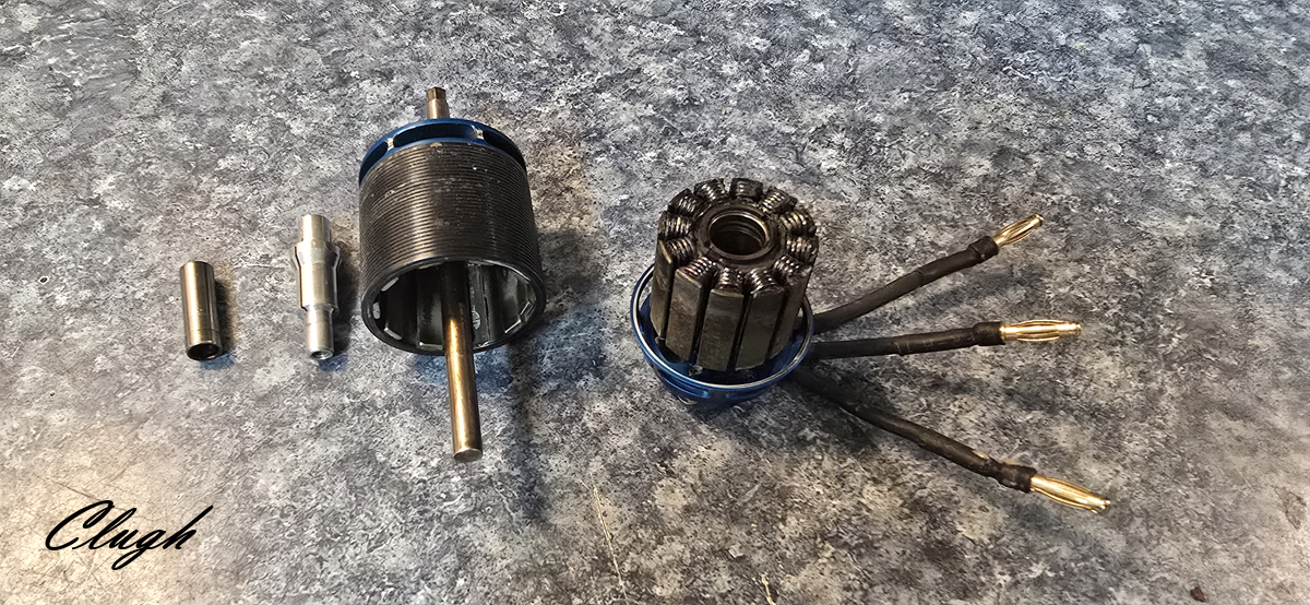

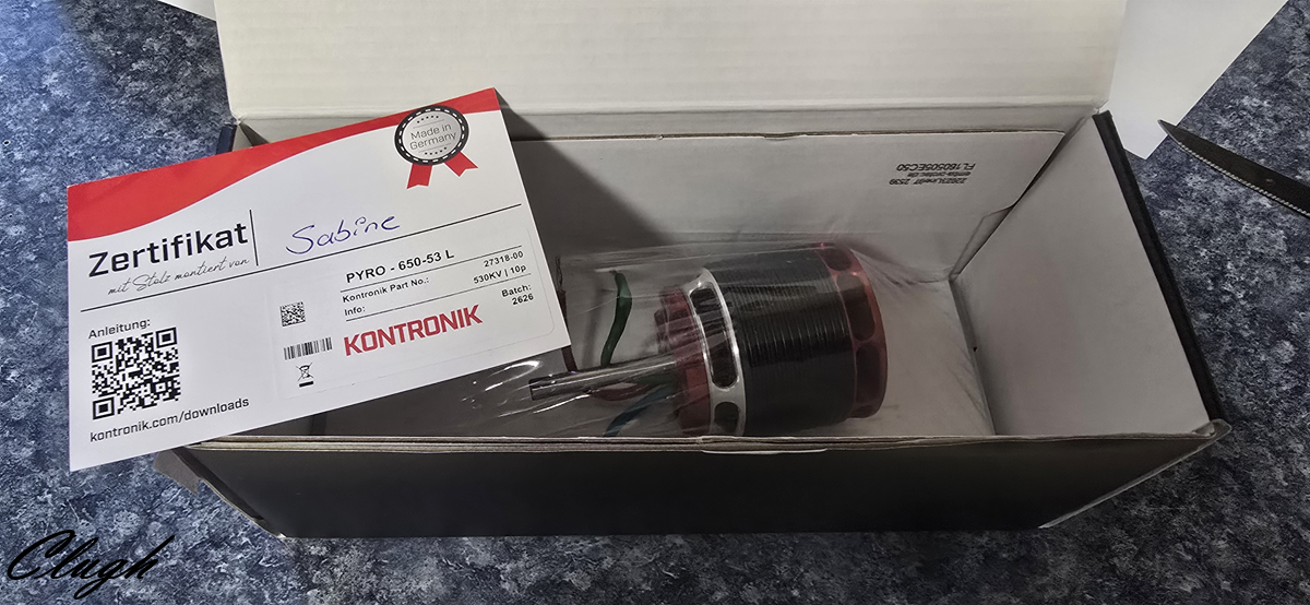

This one was fairly easy to get apart. No SiC production to nigh due to the bad weather, so Ill wind it and a brand new certified 650 for Spencer Key's (helifreaks 🙊) TDR
No old pink antiques here. These are brand new Kontronics QC certified cars for F3A and Heli competition use.
For the TDR :point_up:

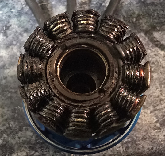

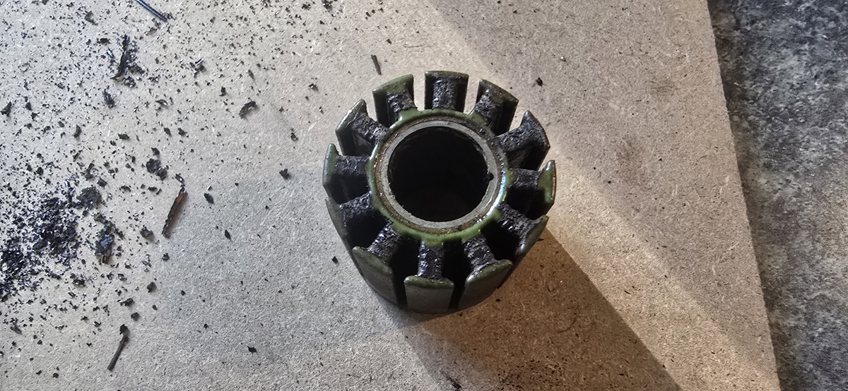

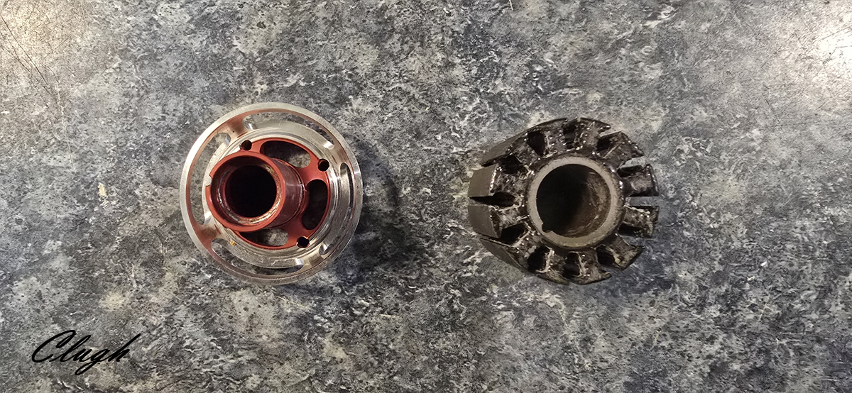

Disa did a good job winding this one. It was clean. Unlike Gotha motors Kontronics also believes in potting the windings. They epoxy the stator and wires in place with construction epoxy. Probably "UHU" which is a pure insulator but better than nothing at all for securing pulsing wires. What we use in a rewind is boron nitride infused epoxy made for motor coils. It has 400% more thermal conductivity than a factory certified Kontronics.

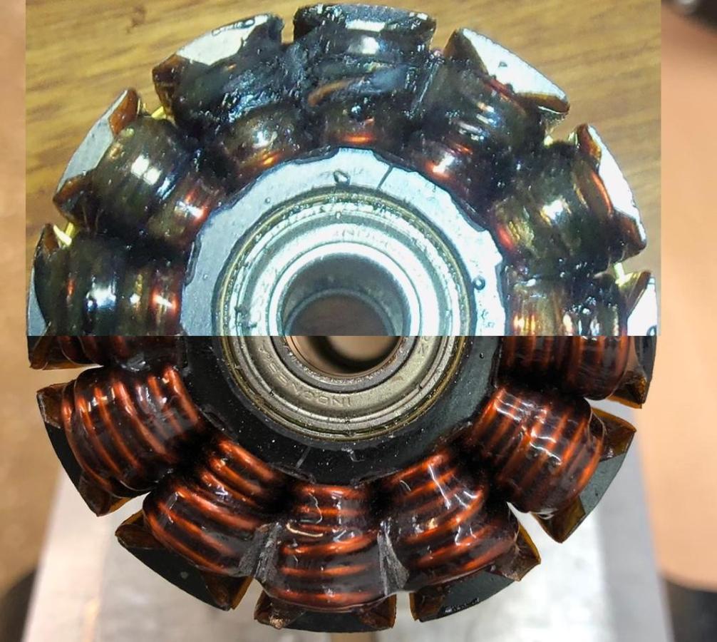

In this photo Gotha motors has shown us what NOT to do with UHU which is always the wrong thing to use as a pure insulator if you want a cooler running machine..
:point_up:

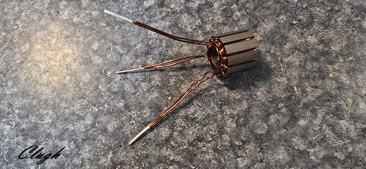

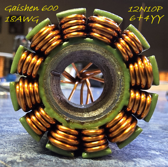

The new Certified Pyro I stripped of UHU encapsulated windings only need the last two turns. It can be a 6+4 or (5+5) with symmetrical coils appears to run a little better empirically.
Now she can breathe.:triumph:Comment

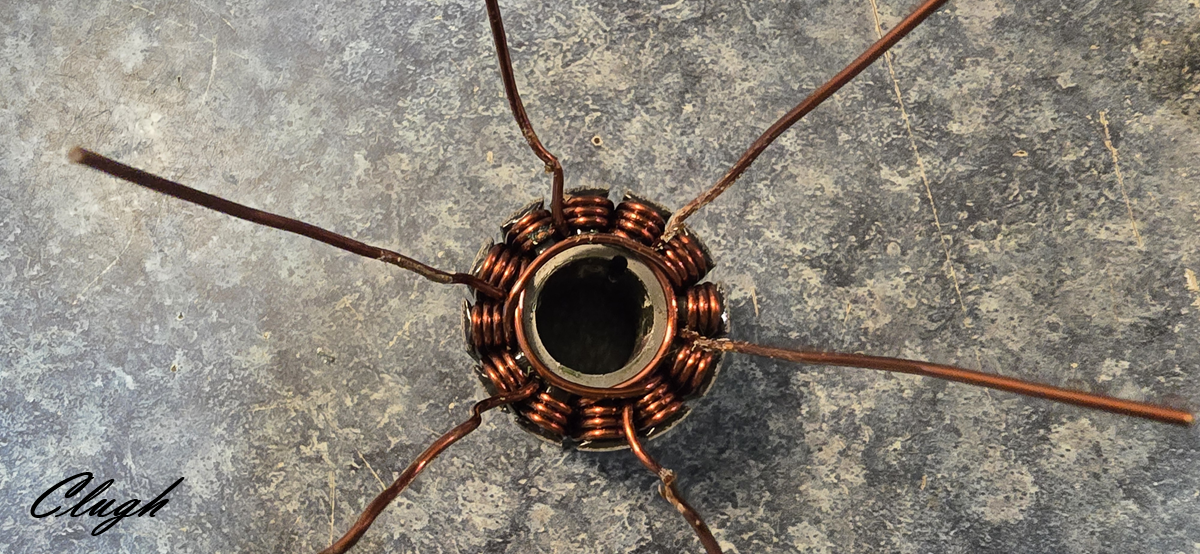

Here are the complete phase coils in a the delta wound machine.
Looks like another Gothan motor impersonation.

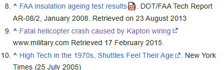

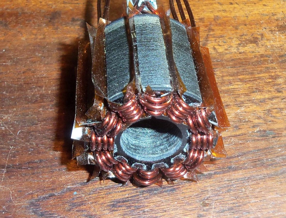

You come back and show axial cooling, but the pink-black-gold variant has had that for years. Countless motors have burned out since then after using UHU to attach the wired Mr. Bean. Now you don't use anything at all, and apparently you now need thick endplates for it to run at all. Here in America, we do it differently. We do not wrap with Nutliners except when absolutely necessary, which almost never happens. They praise Kapton, but don't even use DuPont's Kapton MT+. They act as if Kapton is superior ... In isolation, Kapton remains stable over a wide temperature range of 4 to 673 K (−269 to +400 °C). The thermal conductivity of Kapton at temperatures of 0.5 to 5 Kelvin is quite high for such low temperatures: κ = 4.638 × 10−3 T0.5678 W·m−1· K−1. That's no better. Kapton insulation ages poorly: An FAA study shows its decomposition in hot, humid environments[8] or in the presence of seawater. It proved to be very resistant to mechanical wear, especially abrasion in wiring harnesses caused by aircraft movements. Many aircraft models had to be rewired at great expense due to short circuits due to the faulty insulation – in some cases, the entire Kapton-insulated cabling was completely replaced. The decomposition and chafing of Kapton wires due to vibration and heat has been linked to several fixed-wing and helicopter crashes that killed people. The New York Times reported in 2005, citing a NASA OIG document, that Kapton-insulated cables in the space shuttle "tended to wear out over time, causing short circuits and possibly fires." During the STS-93 mission, electrical short circuits in the Kapton insulation led to the failure of two engine controllers and almost caused a catastrophe. They believe that the problems this creates in the air were solved with the disaster in commercial air traffic years ago, but even in 2005 the insulation for aviation is still inadequate. The cables are not insulated, so they move, thus favoring catastrophic scenarios in the air. There are countless reasons for failures and countless more! Cheap ball bearings that easily fail under high loads in competition. Kapton slot liners that age and decay due to ozone and micro-vibrations. Unsecured cables and last but not least, overloaded motors with 68% of the expected start time according to your own records. In America, we not only secure the cables with a boron nitride coating that increases thermal conductivity by up to 400%. We connect the core to the aluminum frame using a boron nitride epoxy resin. As a result, the frame serves as a true internal heatsink for the core. Gotha Motors does not use these proven methods. Our connection cables are made of a high silver conductor and are additionally coated with boron nitride to prevent short circuits while ensuring effective heat dissipation.

Boron Nitride coil resin from 3M is what we use.

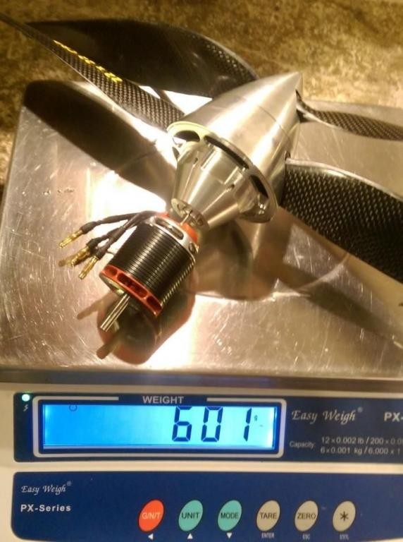

Another 650 headed for Spencer Key's TDR on Helifreaks. I'll be sure to post photos of the heli for you....It runs 3 ceramic hybrid bearings....
Hope u enjoy the "smearing" OKON! its certainly not as good as the 100 degree UHU general construction epoxy you and Christian use in your ISO quality hand wound German motors.
