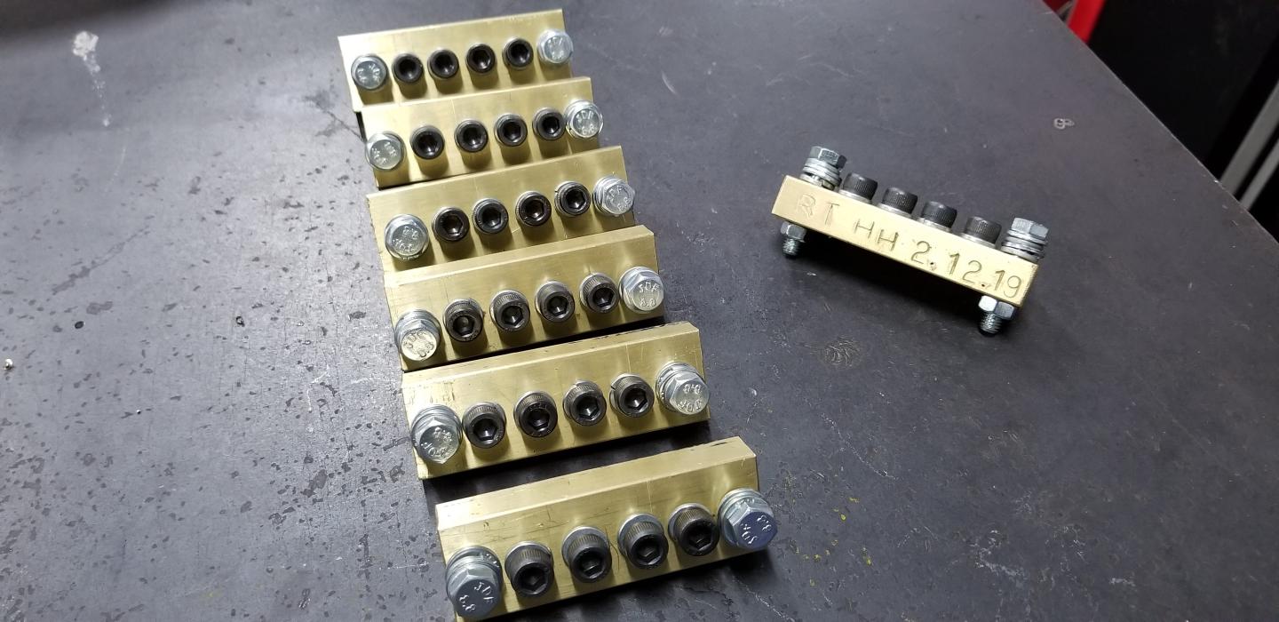

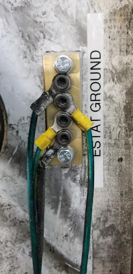

                Wenn Sie möchten, dass die Farbe wirklich an den Rippen und Kanten der Glocke haftet, müssen Sie das ESTAT-Lackierverfahren verwenden.
                • Clugh
                  Current F3A world champion American motor winder.
                  • Sep 2023
                  • 5212
                  • Research Triangle Park North Carolina
                  #4828
                  Hallo Dr., ich sehe keine Serienarbeit oder rosa Magnetdraht von Ihnen. Ihr Thread sieht tot aus.
                  Nach dem Kauf der ESTAT-Pistole müssen Sie lediglich die Glocke erden, und die Farbe haftet überall, sogar in den Ecken.
                  Auf dem obigen Foto sehen Sie die Anlage bei Daimler, die ich betreue. Die Turbinen erzeugen 70.000 Volt bei wenigen Mikroampere, um die Lackpartikel aufzuladen. Die Fahrzeuge sind geerdet. Es entsteht nur sehr wenig Sprühnebel in den Lackierkabinen. Aber ich weiß ja, dass Sie von all dem keine Ahnung haben.

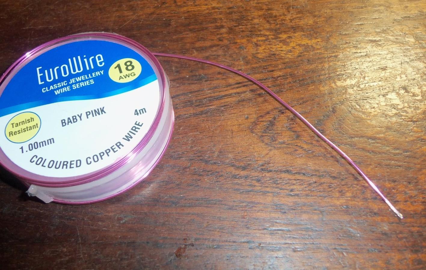

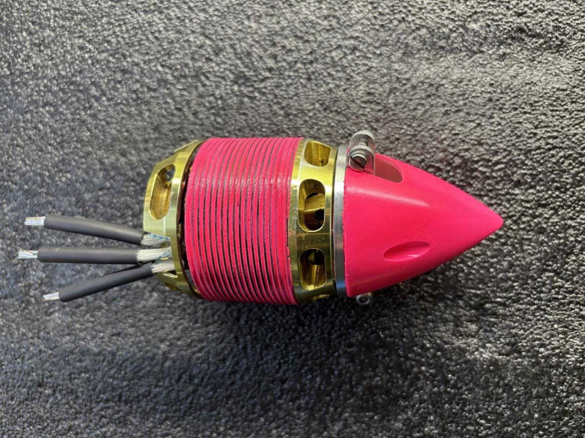

                      The remote response from 5000 miles away. Versus directly here. "A small intermediate result:
                      More than half of the 20 small inner rotors have already been wound.
                      The original pink insulated copper wire has been leaked.
                      It has exactly the right wire gauge to wind one of the small 35 speed motors.
                      It can then be built with 90% pink parts, including the full steel gock. Only the ball bearings are not available with pink cover washers. But maybe I'll have fun and take the cover discs off the bearings for painting, even if that's complete nonsense.
                      I have also found pink insulating hose in the meantime.
                      https://i.ebayimg.com/images/g/QqYAAOSwOixoHWeb/s-l1600.jpg
                      The main thing is that it's fun!

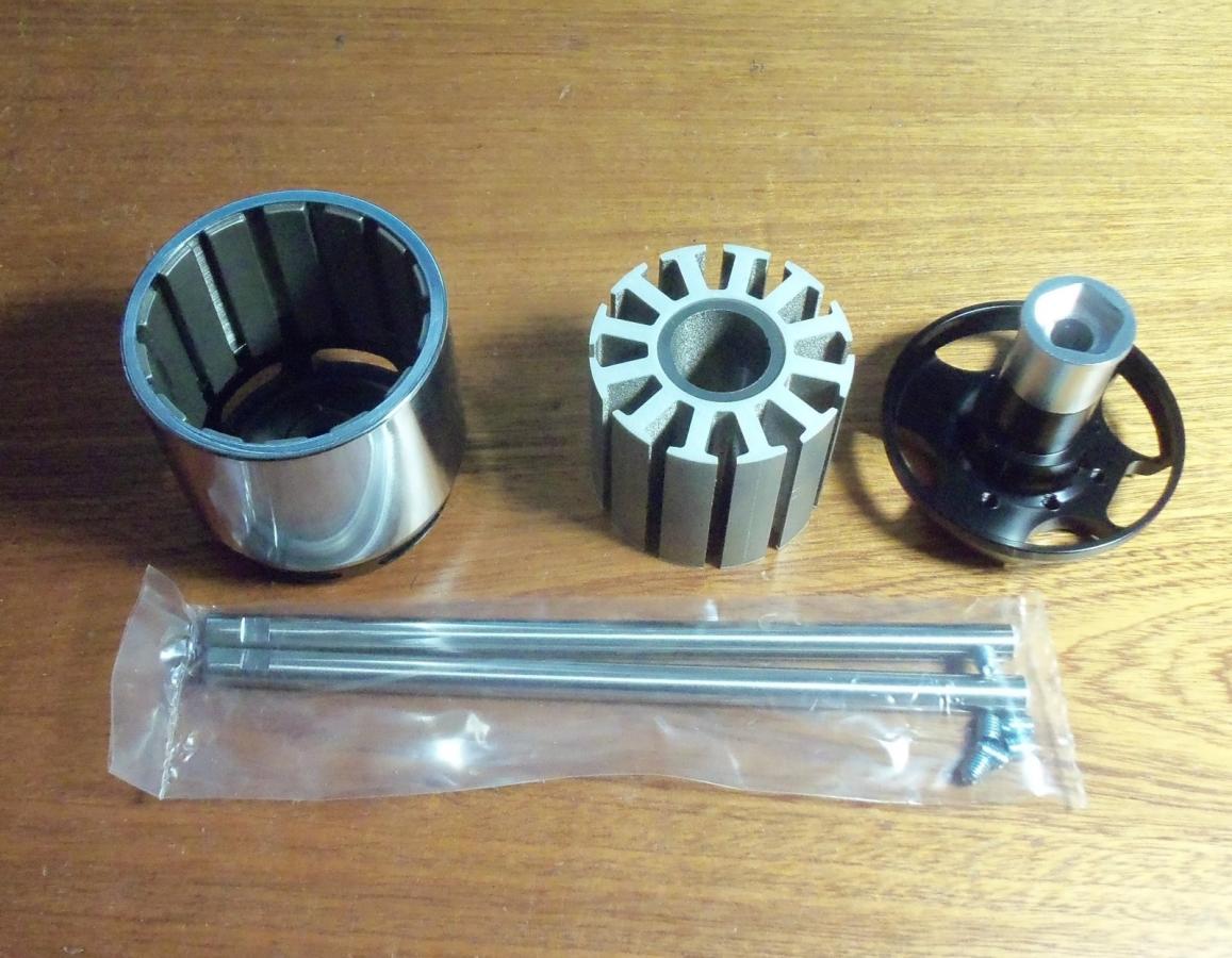

                      Then I received an engine kit from a German (industrial) manufacturer.
                      there should be a thick singlestrand YY winding instead of standard multistrand D winding on it for comparative measurements at the manufacturer.
                      As usual, this story is subject to an NDA, so that a publication of results is not to be expected anyway.
                      But I may show pictures - the "negotiations" are still ongoing.
                      Particularly interesting is the pentagonal bearing seat for a special ceramic bearing, which I have planned for later.
                      In this application - unlike my aircraft engines - it makes sense to use it to electrically isolate the shaft from the package to prevent erosion damage to the ball bearing.
                      Here, an electrical circuit is closed via the mechanism.
                      In the case of the aircraft engine, the propeller is the end of the flow - the circle is not closed and this special advantage of ceramic or hybrid bearings runs completely into the void - or in other words - into the air"
