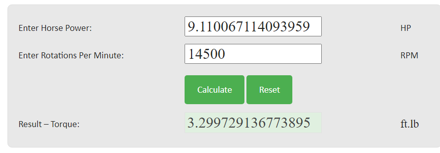

              This is the Ralphs HK 4225 in Thomas test

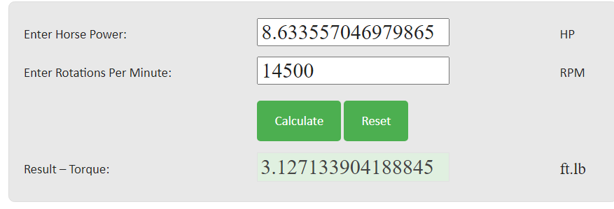

                Click image for larger version  Name:	image.png Views:	0 Size:	18.4 KB ID:	420508
                The Lehner 4125 in Thomas Test

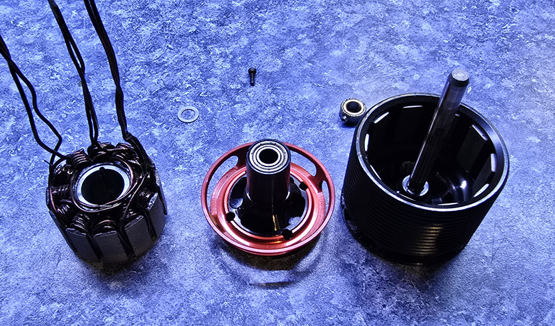

                        So the Pyro black competition 650 65 is a 6+6 Delta. The micrometer says 1.20mm diameter with the insulation. Heat from the soldering iron was enough to break the loctite. 😛
                        Thank you

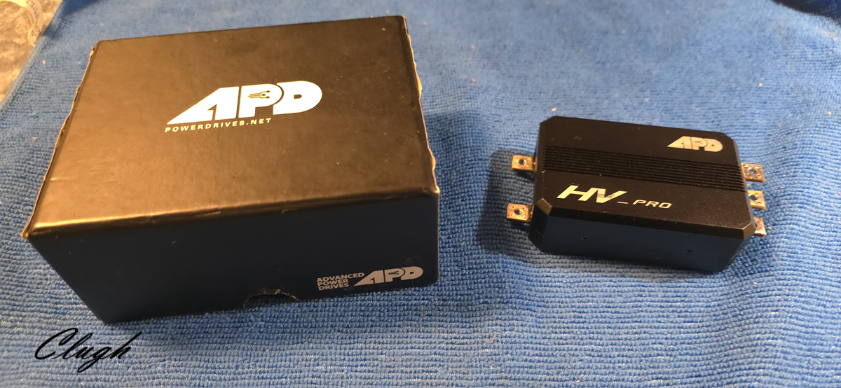

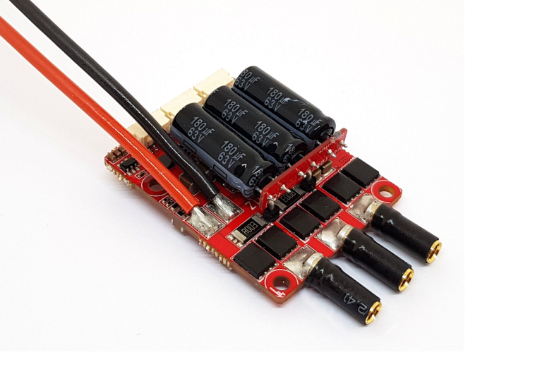

                            The poster doesn't know anything about modern inverters apparently because the APD and KOMAR are both motor agnostic. You cannot set the pwm of the APD or many others manually at all. The recorded EMF has nothing to do with tuning the band width ratio of such an inverter. In all their history. They have never designed a FOC inverter or commissioned one in an industrial setting. The Drs that develop the motors and inverters do not operate or serve rc models in competition at all. It is he most ignorant form of fallacy you are burdened to hear. If racing was a metric they could have shut the hell up in the mid 80s coz its been that long with brushed power and 150 plus miles per hour ago. They can even make it around the damn course in 2025. And old fool typing straightaway records in 2025...'
                            My lady and I laughed so hard and were absolutely astonished by the lie about Jim.....
                            See the agnostic inverter you cannot change PWM with
                            The pro cost 3 times Thomas go cart inverter.

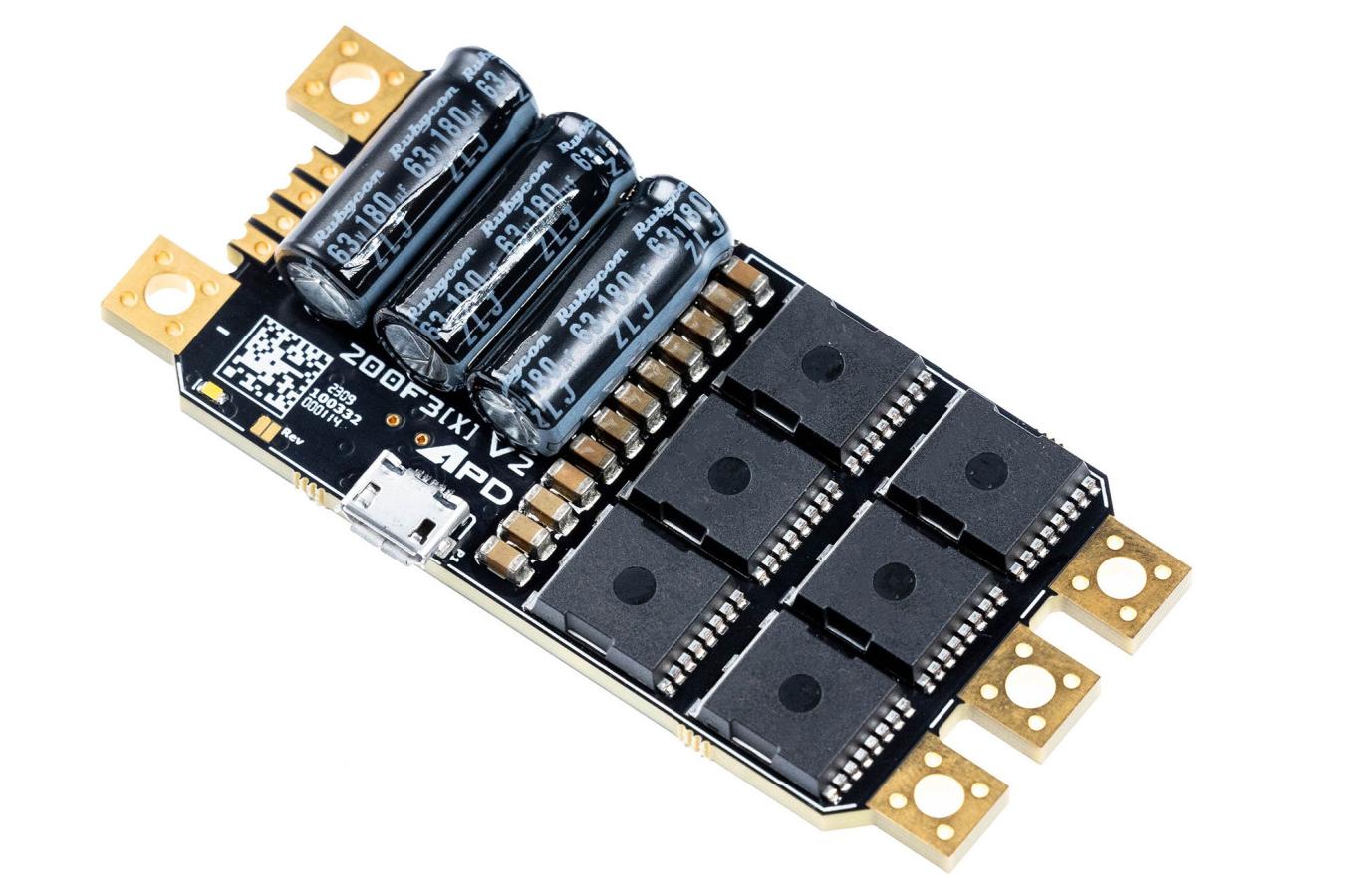

                              Here is the first answer to the fallacy and ignorance. A motor agnostic inverter. You will not set the timing or PWM on this proprietary FW so let the inverter ignorant poster talk about Stefan's Merz sensorless 6 step design from 20 years ago. It is absolutely ignorant nonsense at a keyboard. The poster hasn't built a FOC drive a BLDC inverter or even a brushed one.
                              ​ APD HV Pro ESC
                              The HV Pro Series of ESCs are APD's high performance, small footprint products, offering maximum results for your use case.
                              The APD developed (proprietary) firmware ensures unmatched low-throttle and starting characteristics. Ultra-smooth starting and ramp-up characteristics ensure your drive-train is safe. Features include PWM-frequency dithering to avoid PWM-commutation synchronisation, adaptive motor timing advance and proprietary developed Active Phase-Current De-magnetisation (APCD). APCD, along with Synchronous rectification ensure maximum ESC efficiency is achieved.
                              • Designed and manufactured in Australia using only the highest quality components, ensuring no sacrifice in reliability.
                              • Aerospace-grade ceramic capacitor bank for lowest possible ESR and maximum reliability. No more dried up electrolytic failures
                              • Standard PWM input up to 500HZ
                              • Auto PWM frequency
                              • Auto Timing Advance
                              • On-board 16 MB Flash memory
                              • Data-logging for Voltage, Current, Temp, Input Duty, Output Duty, eRPM, Phase Current
                              • Firmware upgradable through USB port
                              • Up to 400 Amp continuous current*
                              • Up to 600 Amp burst current
                              • Up to 24S capable
                              • True 12-Bit throttle resolution
                              • Feed-Forward compensator
                              • 1,000,000 eRPM
                              • Highest power density

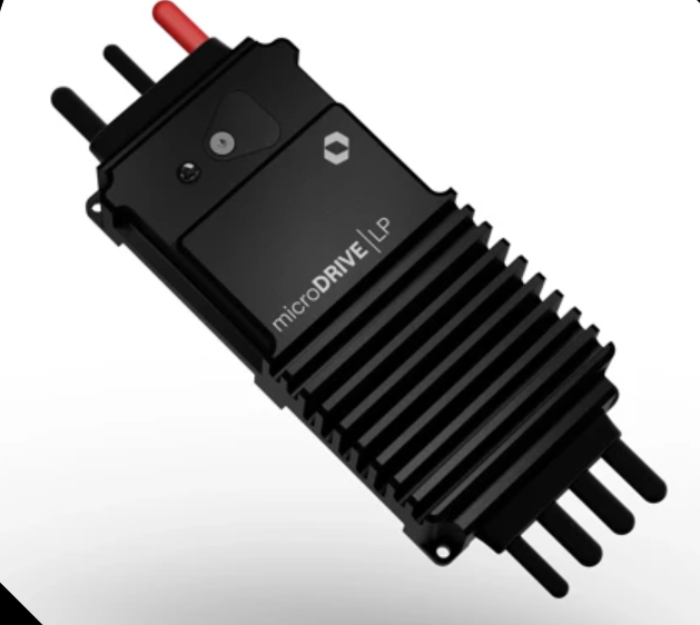

                                      Click image for larger version  Name:	image.png Views:	0 Size:	130.9 KB ID:	420539
                                      Hargrave Technologies' FOCAL algorithm sets a new standard for sensorless motor drive, optimised for the most demanding UAS applications. FOCAL extends the low-speed efficiency of FOC to the high-RPM performance of trapezoidal drive, with no tuning required.
                                      While FOC can see higher peak efficiencies in a perfectly tuned combination, this is rarely true in real-world missions. Diverse flight profiles, environmental conditions and production variations all reduce the practical efficiency of FOC.
                                      The pur·vey·or of fallacy does not know anything about these inverters I'm showing you now or the capabilities. Hargrave has a 60 Volt 200 amp a liquid cooled 120 volt 400 amp burst and air 120 volt cooled 300 amp burst inverter on the way with the absolutely new and proprietary FOCAL commutation algorithm.
