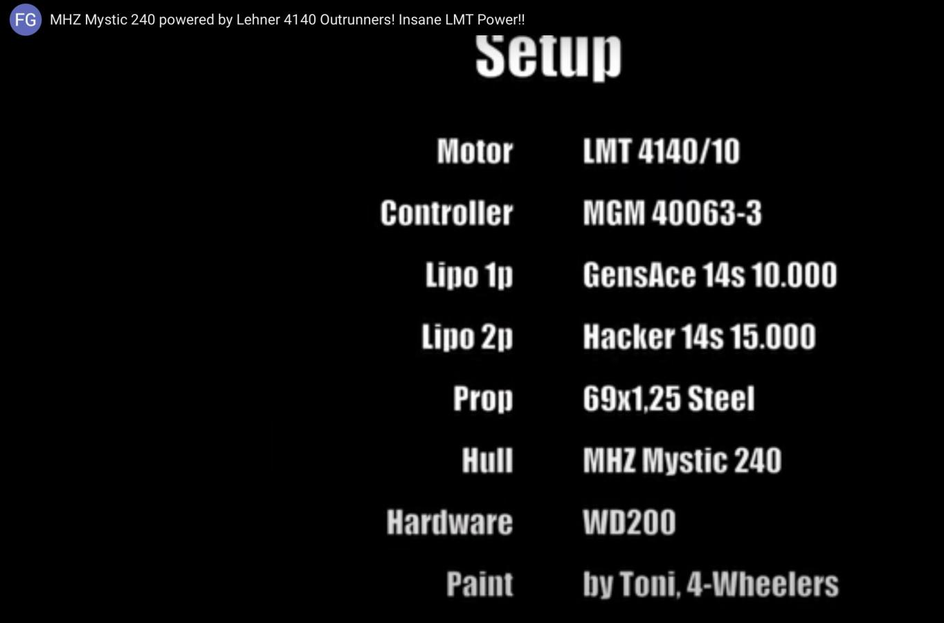

                    Where do you see a syncloss when the Lehner 4140 trial run in the video by Tyler? The Motor is Free Running, No Load. Just turn up freely. You fantasize about it, I asked Tyler whether he experienced a syncloss with the engine when he was stressed. His answer "no". And the JAG S Team drives a Lehner 2 pol inner runner with air gap wrapping that is almost impossible to force in the Syncloss. A Hall probe is enough for me to operate the engine without synclos, regardless of the type. No matter what Mr. Haregtt rhyme here. Mr. Hargett has never participated in a competition for decades, nor is any of his boats. All air numbers that do not work. So no moore conversation , it is lost time with this Hubert Hargett . remember his name and forgett him.

                    • what are you talking its desyncing in Tyler video The ETA is 93.5 whats exclusive about it? Ralphs motor and mine both have a higher power density

                                • Chris since im at AUDIO you know I have a RTA right? you want me to analyze the video for its audible noise and show it to the forum versus a few other machines?
                                  • Hi Clown,Hubert.
                                    yes, let's see your frequency analysis. I will then present your results to the Bundeswehr University and then publish the results here. They will of course also receive Tyler's YouTube video.
                                    In the meantime, you can watch a few videos with Lehner 41XX engines in model racing boats in which much larger engines otherwise provide the same performance. You can remove your little engines after 30 seconds as black lumps of coal. They cannot handle this performance. Your stupid rewound motor with the great winding will not even get that far. Like the Scorpion surfboard drive, its lack of power will immediately cause bursts of laughter from the spectators, the boat will move so slowly with the motor. Like the motors of other motor tuners who rewind series motors, it has too little iron in the coils. Your motor has even less iron, even thinner stator teeth. Magnetic force is generated by the coil and the amount of iron. You can send thousands of amps into the coils, but the force won't be particularly great given the thin and weak magnetic strips. Have fun making the video when you finally have to show what your super motor can really do. We've been waiting impatiently for this video for years. So far, all we've seen are empty bubbles that all the forum readers are laughing at. LOL.​
                                    Furthermore, everyone here understands the syncloss that is caused by the extremely high load and the resulting occurrence of iron saturation, which means that the EMF can no longer be evaluated correctly and so the synchronization of the coil current to the rotor magnetic field can no longer be generated properly. No one is interested in an idle synclos that is completely uninteresting.
                                    Lehner 4140/10 im Powerboat. You will never have.
