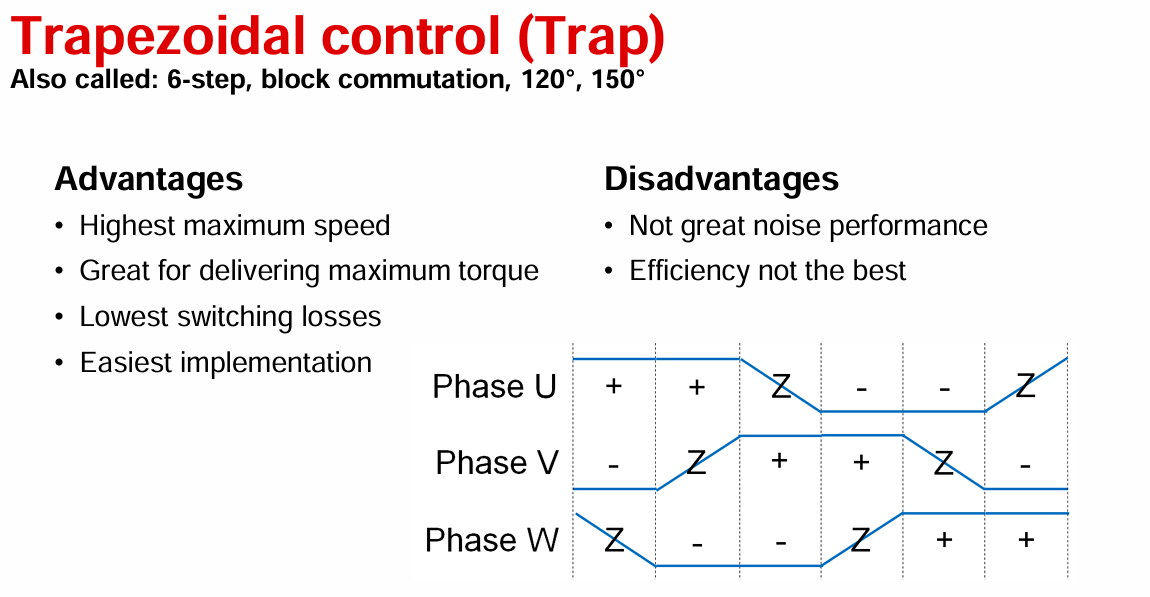

        Click image for larger version  Name:	image.png Views:	0 Size:	96.2 KB ID:	418139​Maximum torque. Highest maximum speed lowest switching losses. Easiest implementation.

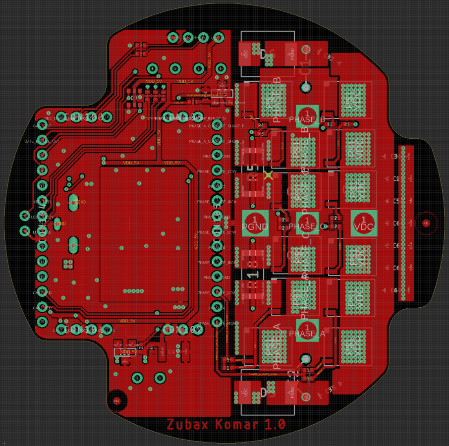

          Click image for larger version  Name:	Komar1.0pcb3.png Views:	3 Size:	252.0 KB ID:	418144 Click image for larger version  Name:	Komar1.0pcb2.png Views:	0 Size:	244.5 KB ID:	418146

            Does It sound best for the basic Tmotor FOC algorithm that cannot touch the ZFPSVC FOC algorithm In a GaNFeT drive I build with a full programming environment for him since my first dc drive was over 25 years ago ? How does it all stack up for his bad behavior against the TRAP drive potential for a speeder application? Lets see.
            Click image for larger version  Name:	image.png Views:	0 Size:	50.6 KB ID:	418149
            And from working directly in the Industry I disagree with the statement about lowest noise. Sinus is the quietest. FOC is not at all quiet starting and stopping an industrial induction motor. It makes all kinds of wonderful high pitched harmonics. It's a very distinct crackle. I sat directly behind large sew euro foc drives for 3 years straight and know without a doubt its a damn lie they quietest in a current flux control algorithm with a soft ramp acceleration and deceleration parameters dialed in.​
            Trap is best for high torque and high speed and if you can find a FOC drive fast enough to turn 100,000 with a ten pole and not have tremendous losses show it to me . Almost all of them switch to six step operation.

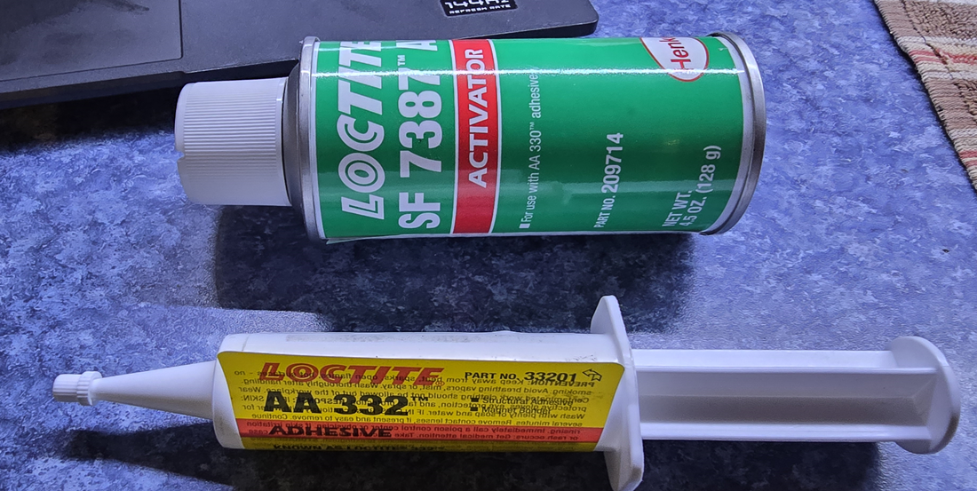

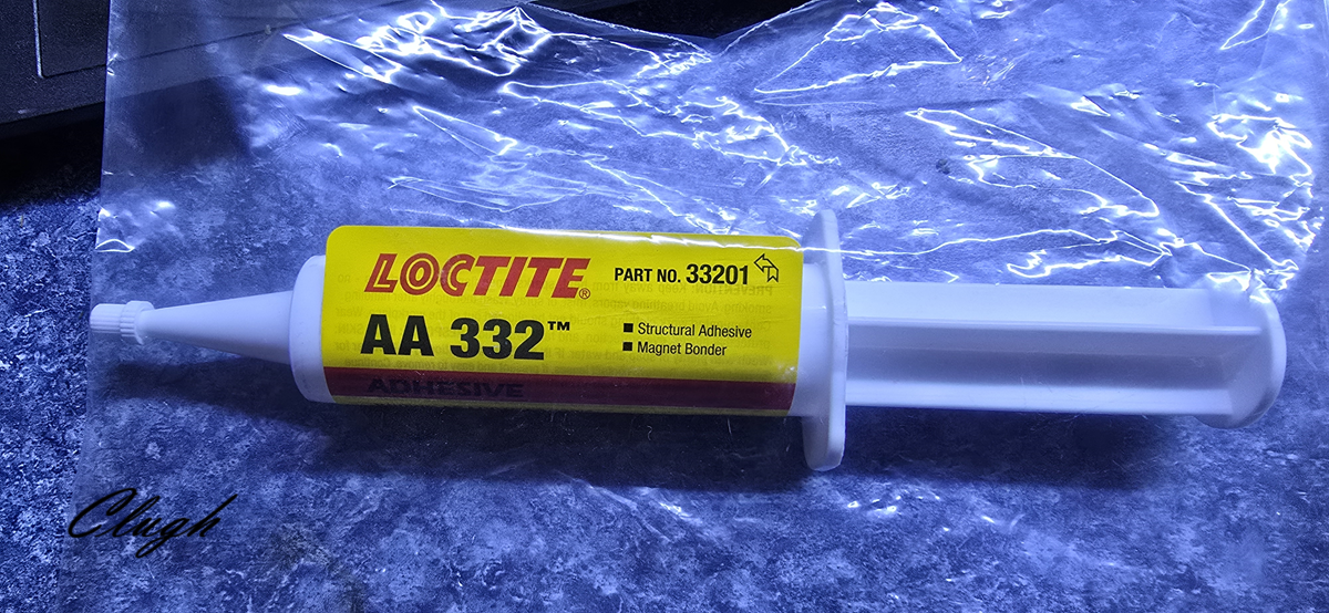

              For everyone else that can receive what I tell them I have received the right glue for the magnets.

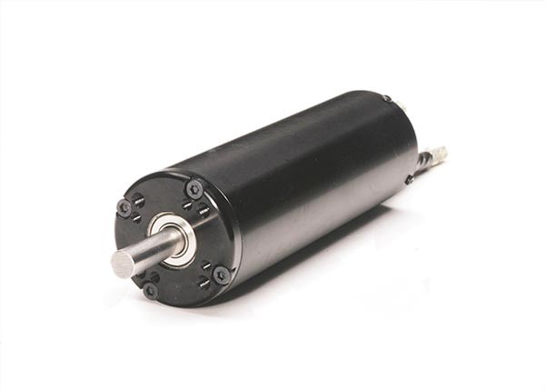

                        If you want that kind of power but higher RPMS for a higher ratio planetary box just look here to America. The 40 mm BLDC drag motors not listed here are 1/4 and half turners. You need a powerful controller to handle the amperage they can absorb without a sweat. DC Resistances to .0001 and lower. They are a little less than 1000 grams and have very high efficiency. The Maxon gearboxes are also lighter for the power they can absorb.
                        Click image for larger versionName:	image.pngViews:	0Size:	150.8 KBID:	418193
                          • 5212
                          #2552
                          1545/0.5D/S/2,700 rpm per volt (kv) 8mm
                          8,500+ watts. Huge motor. Huge Power.
                          Will spin to 65k rpm on 6s unloaded.
                          Will spin to 87k rpm on 8s unloaded. That’s borderline for this motor.
                          Will probably destroy Mamba Max XLX 2 – you’ll need a bigger controller.
                          Sample photo shown – NOT A 1545 –
                          $585.00

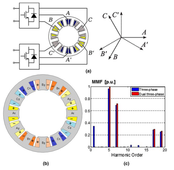

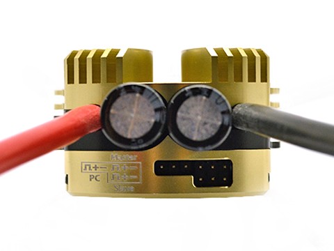

                                For the last time Ralph. Run the 2 Tribunis in the dual inverter configuration at 180 degrees on each stator half and you will inherently protect the rotor magnets. Trust the science. Not the person. The 1st harmonic is what destroys your PM. The 5th is also boosted. With the same exact cut this make more torque and and avoid desynchronization from the pm loosing adequate field. Stop acting silly and listen to what I am telling you. The best drive for your scorpion is the scorpion. Please connect 2 of them in this configuration if you want to rule to social media there. It is a BLDC machine screw all the FOC sinus BS if you want it to run correctly at high speed and make alot of torque for a speed plane.
                                I wont spend 12 more years with it. if you do not understand what the harmonics do i have done my best to explain it. This moves the magnitude vectors 30 degrees they same way a hybrid wind does.
                                You can wind your motors your way. It will still improve the performance young man and remove some of the wires crosstalk too.
                                If you work with scorpion to get into the inverter really then there is a special transistor switching FW that will let you run in a decoupled state even though 1 battery runs it all
                                Other wise you better to split capacity between the inverters and run separate packs to to each one to keep a similar footprint and a decoupled power supply.
                                Get you 2 new Tribunis inverters and leave that old YGE nonsense in the croco museum bruh.

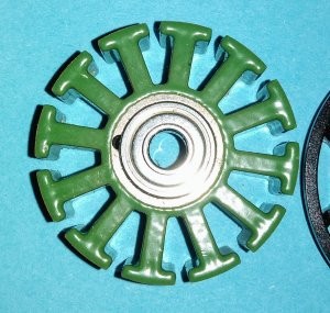

                                  People are literally ignorant to the science. If you are after a sinus system then any harmonics other than a 2 pole are nothing to want and thus those harmonics would be seen as noise and unwanted. But if the system is BLDC then u need some of those same harmonics you'd rid your self of in a sinus system to form the trap or triangle and be optimal for the trap inverter. Naturally you'd remove the sinus signature as much as possible into a flat top it is that simple. Please stop making it so difficult. The other responsible harmonics signal is the Triplen or 3rd on top of a sinus which give you a triangle basically.
                                  And Jesus Christ cut a few strips of 1- 2mm thick G10 or carbon fiber and stick it under the hammers to close the slots and test it.
                                  You know yourself that carbon fiber will shield high frequency radio and micro waves (2.4ghz) because you have to get your RX's Antennae outside it to work. It cant filter the driving wave of a motor at 500 hz because the waveforms are too long to reflect it. The period starts beyond the barrier. Its a natural low pass filter but you need a professional background in audio engineering to understand that as well. I have that too Ralph. Christian has no business calling me a donkey but I want you to see what science has to say about it from a certified audio engineer. An entirely different discipline Ralph. I have over 36 years in it. I was certified there and worked with some of the best in the world before I ever had an electrical engineering degree.

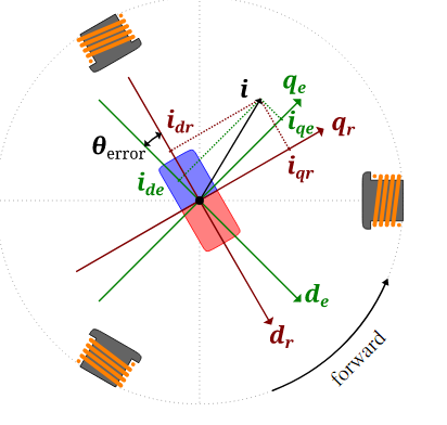

                                        Click image for larger version  Name:	svc.png Views:	0 Size:	36.8 KB ID:	418228
                                        What's to be understood about FOC is it always applies torque at 90 degree to the rotor position so it is the max torque per ampere option. most powerful and very efficient in that regard but the algorithm is complex and real time not look up tables in a registry plus alot of transistor switching losses to create the sinus stepped PWM. Now you want to turn a 10 pole 100.000 rpm you run into process speed complexity problems and muddy PWM pulse trains. He asked me what I know about it after he asked me have I ever built a PWM based direct current dc drive.

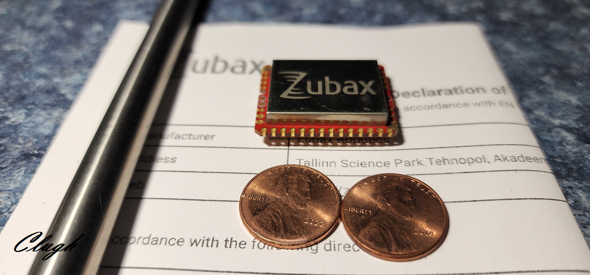

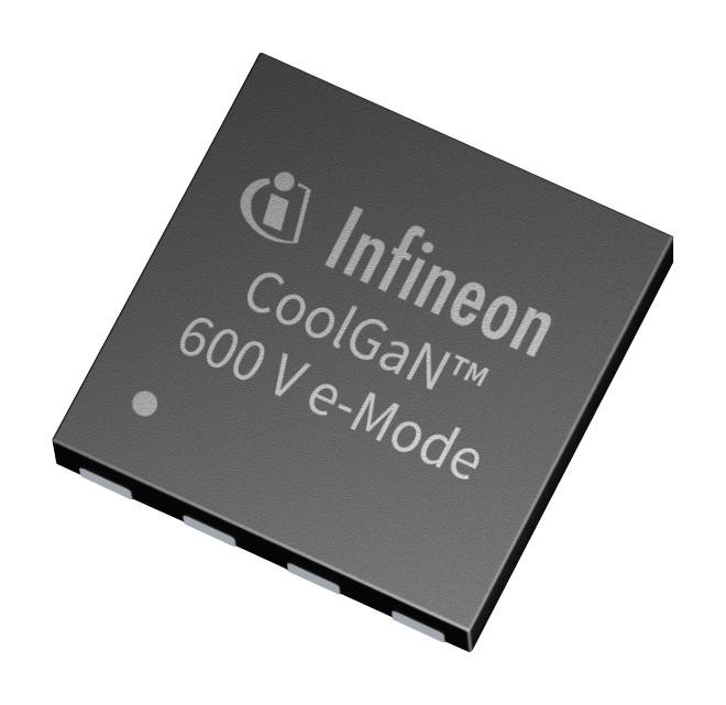

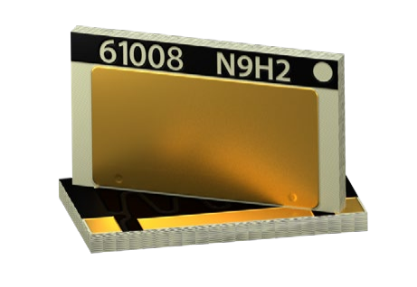

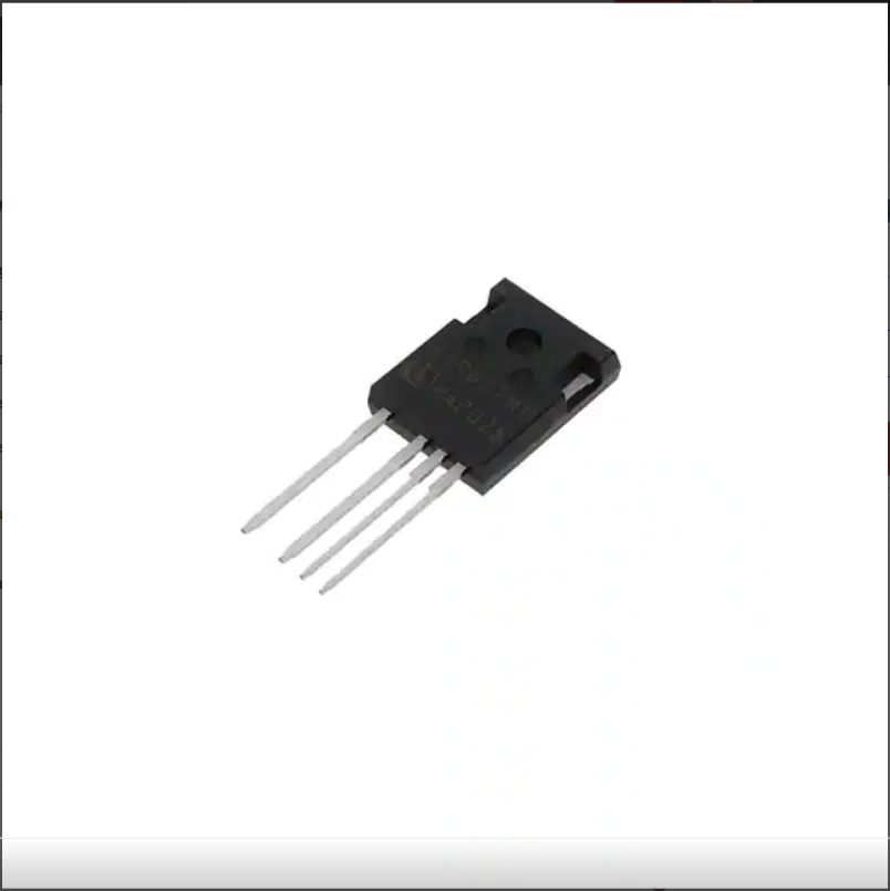

                                        So I showed him mine that ran at 1.5khz pwm and that this is what I know about FOC drives in 2025 , My own GanFet drive I want to build uses one of the most sophisticated forms of FOC space vector commutation you will find and it was developed by my partner in inverter research Pavel who has degrees in electrical engineering and computer science and they blend together. Computer science is another discipline altogether Ralph. So he can understand better than me the programming much faster of the built hardware which I have no issue with. His preloaded IC with FET drivers onboard REALLY helps me bring a device forward quickly. I only pass it on to you guys. What is Donkey about it? i'm trying to show you what is new and help you conceptualize and build a short current path embedded prop learning FOC drive for an airplane. Am I the Donkey? How?
                                        The GanFET and SiCFet devices are in the attachments. Ask Christian what does he know about them and how they can improve my ability to deliver really high current to a motor with my FOC based 3 phase inverter? Similar To Pavels here that's is already proven great. the Fet tech is what is used in formula 1 drives. Ask Chris where I work now and is it possible I know anything about SiC and GaNfet transistors and how they are made made?
                                        Click image for larger version  Name:	b3df4953f29c541948008165642862de60a49bf5.png Views:	0 Size:	652.4 KB ID:	418230
