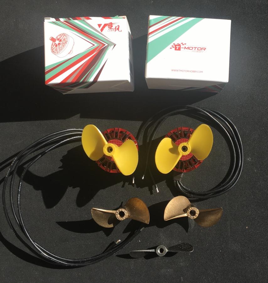

                        Hi Hubert,
                        I'm not sure which engine you mean? please send me a picture by email. I got two T-motors V3115 with 900 kv. I will mount it directly on the transom of a mono boat with the propellers directly as shown in the pictures. The 1250 Octura are being tested for the first time, then we continue with higher gradients. A fun project. When you see how they constantly have to rewind the engines because they have burned out and when you know that there is another way. For me this is intentional. If the customers are so stupid and pay well, you can't help them. They're really happy. At the Munich SAW, not a single drive burned out due to overload. Only a controller that controls a cross-flow rudder pump was not sufficiently insulated against moisture and had to be dried, but now everything is working as usual again.
                        Happy Amps Christian

                                Hi Hubert,
                                yes the propeller has a pitch ratio of Pi.
                                And you're right about the motor. It was designed by one of the developers at ATE System for other applications with the magnet system. With sine, the losses are better distributed between the motor and electronics. During longer operating times, the power loss can be dissipated more easily and requires less effort. Of course, with BLDC power system there is more power for short-term applications.
                                Happy Amps Christian​

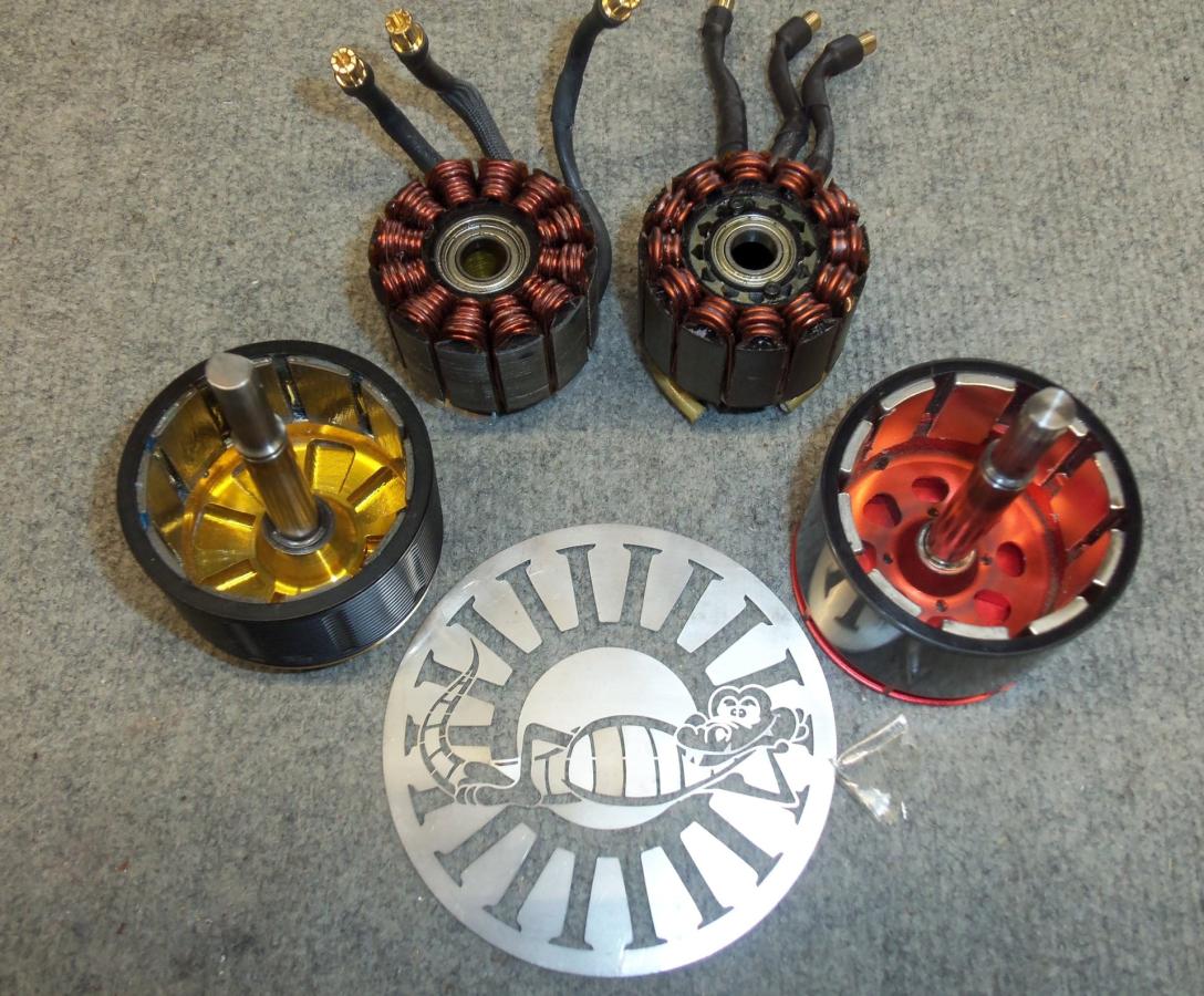

                                      At the end of the season, 2 engines came in again for a check.
                                      The XNova was involved in a crash. Except for one of the (cheap) bearings, it has survived the whole thing well.
                                      The winding still looks great.
                                      Just like the winding on the HK 5025.
                                      But it has another problem: the magnets have lost a lot of power and very unevenly according to the Teslameter.
                                      And it is already the 2nd bell that gives up (under maximum load conditions) with the same symptoms.
                                      The most likely scenarios are 2: a defectively produced magnet batch, which has a lower temperature resistance than assumed and specified.
                                      The unequally affected magnets could also speak for impact currents, possibly in connection with the lower temperature resistance and also the synclostprotection, which simply does not switch off but goes into the highest possible partial load, even if it is actually much too much for the drive.
                                      Unfortunately, there are no evaluable logs from the flights.
                                      It is not due to a fault of the ESC, it was replaced by YGE after the first "number" as a precaution, although no error could be detected on it.
                                      The bell was also replaced, but for one from the same production batch.
                                      But a current bell is already in the pipeline.
                                      Let's see if we can get something out of it....
                                      Maybe someone else has a good idea?
                                      The good side of the matter: At least this helicopter could be landed both times without damage, because the pilot immediately reacted correctly to the perceived loss of power.
                                      At the same time, I was also able to do a small cross test: The power croco winding on the HK stator generates a 5% lower n spec with the XNova bell than with the original.
                                      ~powercroco~
                                      So the damage isnt just from a crash the magnets haver been run into curie... so the esc failure was only around the corner.
                                      The motors are CLEARLY overloaded in operation and run upward of 180C on the bells to zap the magnets...
                                      a hot mess!
                                      with these the windings aren't shot but the magnets are. Sounds like fun.
                                      Yaay!
                                      :partying_face:
                                      Thanks
                                      Hubert​
