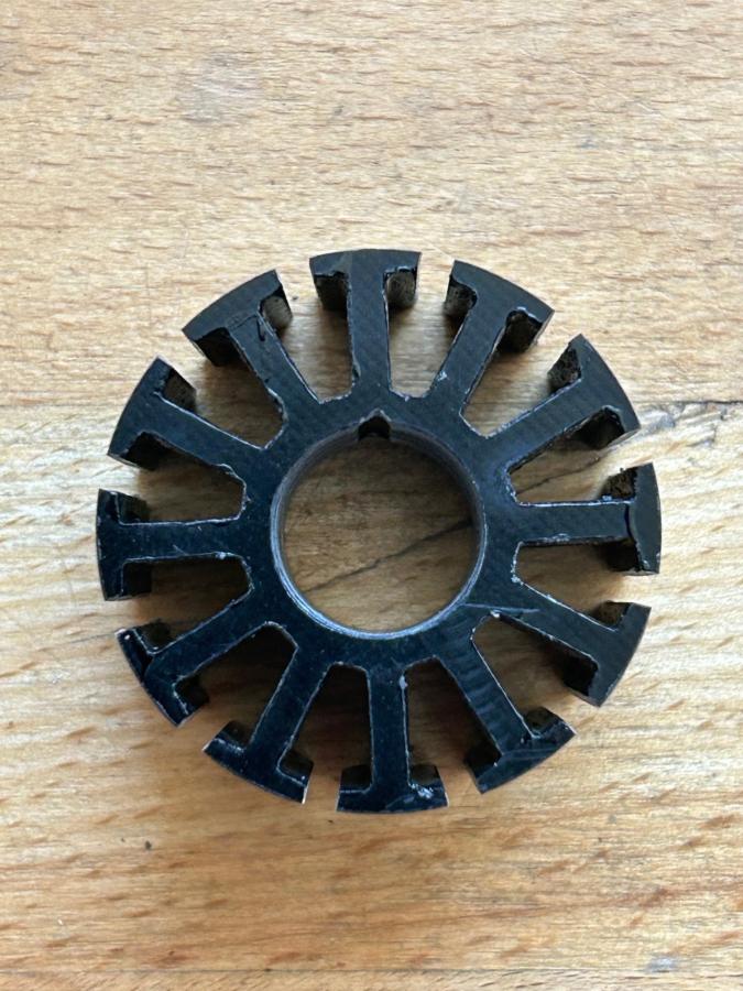

Hi Hubert,
One wonders how someone has only been posting the stators that have been snapped off and rewound for 20 years. People have really seen this enough, especially when nothing new is happening and the planes are becoming slower and slower despite enormous increases in the performance of the battery cells. Conclusion: Powercroco drives are increasingly only being wound suitable for slow flyers. Progress looks different.
Happy Amps ChristianComment

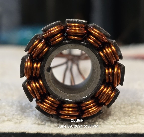

"To complete the Joker test I had the next bigger 6350 with 5320 stator sent to me, which only costs 87€.
Unfortunately, it does not have a higher maximum torque at the same speed, i.e. no higher synclos current compared to the 130g lighter 5060.
However, it offers more winding space, therefore more copper in the slots and thus a lower internal resistance, which makes it more resilient, but unfortunately not as much as the additional weight.
Thus, a tuning winding would not have been of any use, because the syncloss starts too early in relation to the weight, so the construction of the cut and magnet system offers no tuning potential, so it was sold again.
Instead, the next smaller 4250 came with a 3520 stator, which was absolutely convincing, because the synclos current is very high for the motor size.
Therefore, I took the trouble to remove the stator insulation and re-insulate it with very low-viscosity resin.
So there was room for many turns with high load capacity to wind a 4250-7, which is unfortunately not offered.
The 14+14 x 0.85 DD winding has 635U/V at 24° timing and a syncloss of 100A, which allows a Fiala 14x8 to operate on 6s with 11000U at 90A.
With 2kW at only 220g, at least twice the original power at even lower speed, clearly with twice the speed 4kW was already possible.
But even in the original for just 50€, such a 4250 is really a joker!"

UserSince a Fiala 13x7 is enough for me for my Sbach and I wanted to use the maximum 110A of the 65LVT, I optimized the 4250 again.
With a 12+12 x 0.95 DD winding, I was able to increase the filling level by 7%, so it has 740U/V at 24° timing.
As expected, the synclos current increased by the 28:24 turn ratio to 117A, so 110A is now usable.
This means that the Fiala 13x7 is rotated to 6s with 13000U and allows itself 108A, i.e. 2.4 kW, I think now it is exhausted. AppendixesComment
