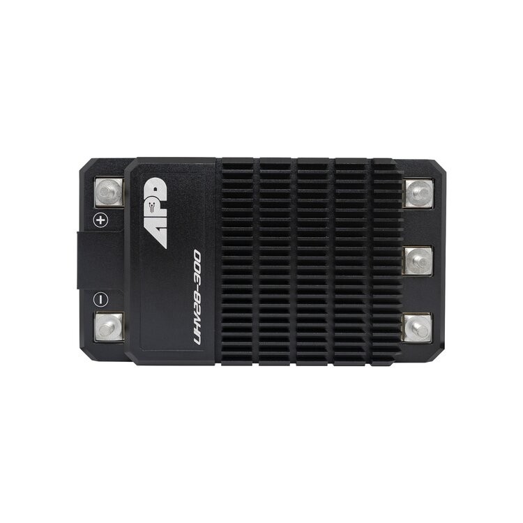

      Click image for larger version  Name:	ffe1838f-5408-4ac2-9624-2b6f8428aed5.jpg?format=750w.jpg Views:	0 Size:	45.5 KB ID:	412884
      120V 45kW
      And what about the F100 class? Where are the big birds ? I don't see any....or any safety protocols for it.
      :scream:

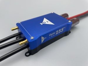

        Here's the most interesting passage about the scorpion power plant and yge inverter used. It fell apart Chris!
        A Fail Fail
        "Since there are unfortunately no 3:1 gearboxes, the adapted HK3536 now had to turn with 44000U, which it did at first. But then he decided to mutate into a magnetic grinding machine after the long bell suddenly started to vibrate despite the 8mm motor shaft.
        Unfortunately, the Opto 255 without housing could not handle this machine and turned the engine test bench including the kitchen into a shot-up village. Especially in the tabletop he left deep and lasting impressions, amazing what the energy from 16s Lipos can do."
        ~Audiosmith~
        The scorpion fell apart and destroyed the drive.
          #1624
          And why talk about not exceeding 250 amperes?
          If you remove the heatsink it cant do that.
          DUH!

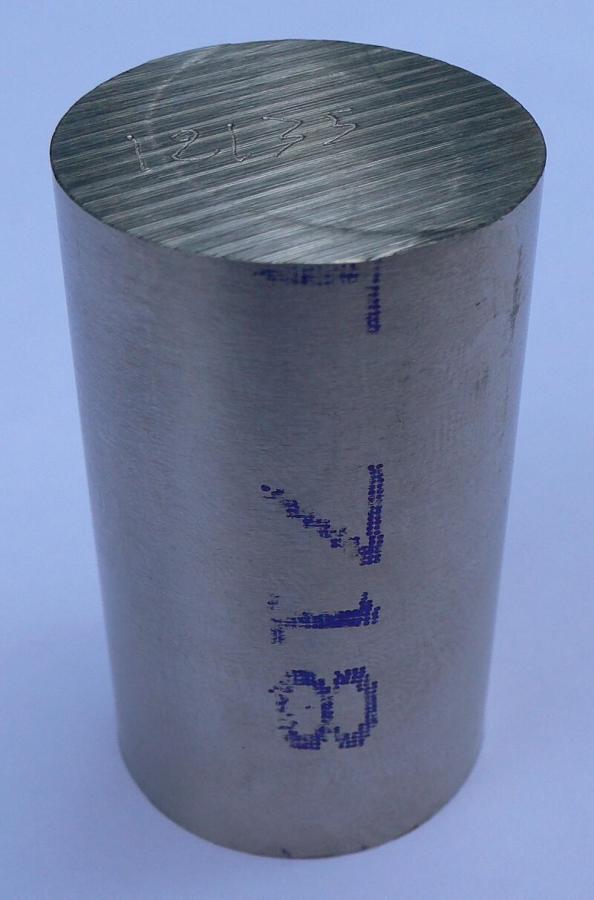

                              Inconel makes a good retention sleeve also
                              Inconel
                              is a nickel-chromium-based superalloy often utilized in extreme environments where components are subjected to high temperature, pressure or mechanical loads. Inconel alloys are oxidation- and corrosion-resistant. When heated, Inconel forms a thick, stable, passivating oxide layer protecting the surface from further attack. Inconel retains strength over a wide temperature range, attractive for high-temperature applications where aluminum and steel would succumb to creep as a result of thermally-induced crystal vacancies. Inconel's high-temperature strength is developed by solid solution strengthening or precipitation hardening, depending on the alloy.[1][2]
                              Inconel alloys are typically used in high temperature applications. Common trade names for various Inconel alloys include:
                              • Alloy 625: Inconel 625, Chronin 625, Altemp 625, Haynes 625, Nickelvac 625 Nicrofer 6020 and UNS designation N06625.[3]
                              • Alloy 600: NA14, BS3076, 2.4816, NiCr15Fe (FR), NiCr15Fe (EU), NiCr15Fe8 (DE) and UNS designation N06600.
                              • Alloy 718: Nicrofer 5219, Superimphy 718, Haynes 718, Pyromet 718, Supermet 718, Udimet 718 and UNS designation N07718.[4]
                              Click image for larger version  Name:	Inconel_718.jpg Views:	0 Size:	46.1 KB ID:	412930

                                    I dont trust 'empirical' charts when they do things like remove the heat sinks from the drive before testing it
                                    The YGE's RCT heat sink on the 255 for instance is YGE's engineered newest cooling tech. Why would you remove it when you need optimal performance?

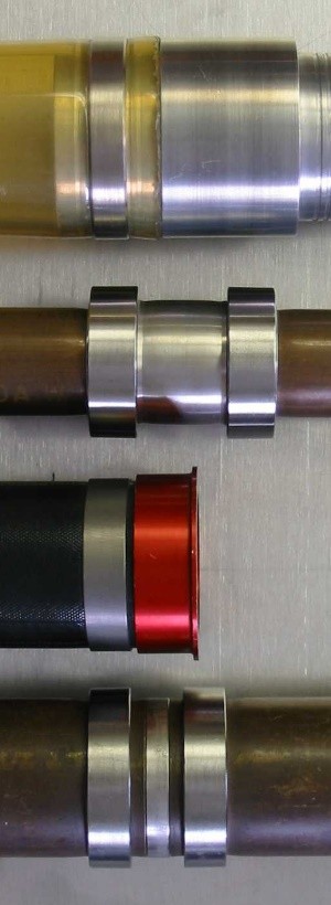

                                      Click image for larger version  Name:	tube_joints.jpg Views:	0 Size:	51.5 KB ID:	412956
