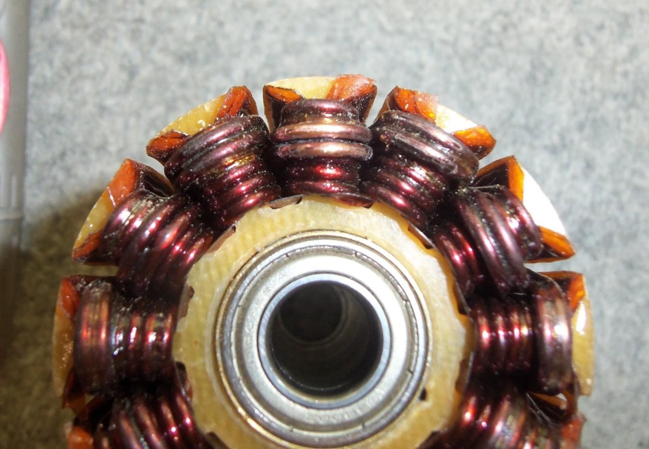

      Titanium shafts and high temp magnets All topped off with low RPM 5 dollar steel bearings and no potting....
      :ok_hand:

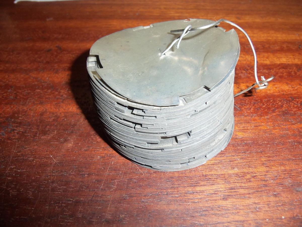

          it works, almost everything has been achieved, croco pages are online, here again something is produced and shown and technologies are taken up that are useful. In the case of engines, soon probably also in model making, actuators with vector strategies will find their way in, Hubert has recognized this correctly, you just have to read and learn to understand his mail. For such actuators, however, motors are needed that can handle many more clocks in high frequencies. Many roads lead to Rome, we have small plates with the technology in the cigarette box format that can do this, but are developed for a company, industry, which do not want to have anything to do with model making, I asked extra.
          A few more pages that show what it's about, https://www.elektroniknet.de/automat...hen.29514.html, read all 3 pages.
          Thomas, this does not rewrite physics, but it is better to deal with the true magnetic conditions and from this a higher efficiency with all the gains is generated.
          PS : Ralph still has sheets from me from Impfy, the 0.07 mm thick, which are eroded, but then have to be annealed before they are glued packed. They are then buttery smooth, but have very low losses at high, highest frequencies.​
          Powercroco
          Powercroco
          User
          Christian Lucas wrote:
          PS : Ralph still has sheets from me from Impfy, the 0.07 mm thick, which are eroded, but then have to be annealed before they are glued packet. They are then buttery smooth, but have very low losses at high, highest frequencies.
          Yes, that's right.
          They are still lying around - you are very welcome to have them back.
          They are much too good for my old-fashioned tinkers anyway.
          Maybe your friend will make a fancy multiphase multilayer parallel slot "clugh" out of it, which he then controls with a multiphase FOC controller.
          Just need your address (PM) again, then they will go out on Monday.
          Appendixes
          ​Ralph ,
          You say you tell the truth so where are the sheets. That Monday was over a year ago. Its funny what you speculate I can build but
          BUT WHERE ARE THE PLATES?
          THEN MAYBE ALOT IS POSSIBLE!

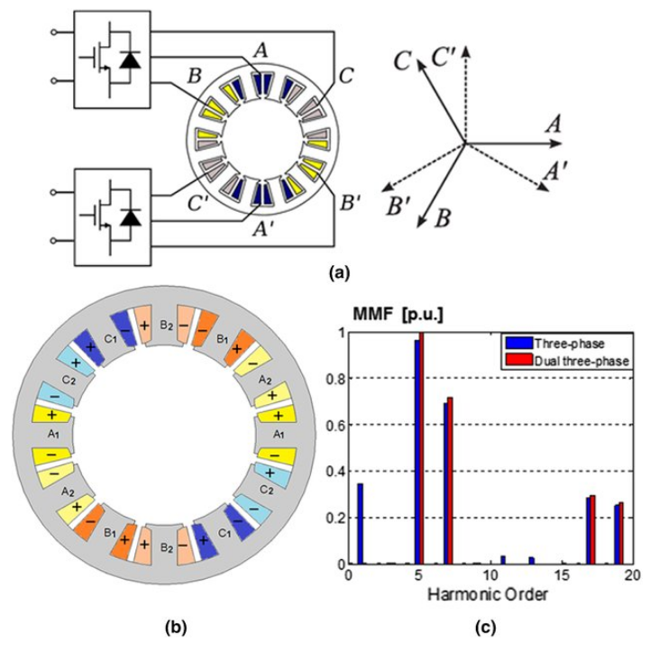

              Christian, ich kann Dual-Inverter betreiben, die bei LRK oder DLRK um 180 Grad versetzt zünden, was die Belastung des Rotors fast vollständig eliminiert. Zwei F3 40 APD wiegen nicht mehr als ein halbes Gramm und können Spitzenwerte von 100 Ampere pro Seite erreichen. Sogar die beiden F3 80 wiegen nicht mehr als ein yge LVT 65. Sie können die Kommutierung noch weiter optimieren, indem Sie die Ein-/Aus-Zustände der Transistoren in jedem Inverter leicht ändern. Ich brauche keinen schicken FOC, obwohl APD das schon hat und 6 Schritte und Big Mouth immer noch süchtig nach YGE-Kinderprodukten ist. Lassen Sie sich von A Boy die Platten schicken, damit er alles sehen kann, während er mit seiner Powerditto-Site voller Ungenauigkeiten da sitzt und versucht, von mir zu lernen. Wenn er etwas wüsste, wüsste er, dass eine Statorhälfte eine Falle erzeugt, aber da er die Theorien nicht wirklich getestet hat, faselt er einfach wie üblich weiter.

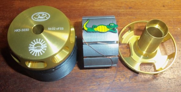

                    User After the isolated magnet defects in 2 motors in operation with the YGE 255, I withdraw my recommendation for the controller together with my motors in maximum load operation.
                    After extensive discussions with Heino, I received the information that when the syncloss protection is activated, the controller regulates back to just below the last valid signal and remains there and does not turn up again in this session even when the load decreases!
                    This means that the motor is - depending on the operating parameters - permanently operated with 95-99% partial load without any real feedback, instead of commutating with solid blocks. This increases the losses in the inference and in the magnet to several times the losses in full block commutation and may lead to the magnetic force losses seen!
                    With the loss of magnetic force, there is a cascade effect, because the n spec continues to rise the more the magnets lose power.
                    Without checking the setup by the user, the engine dies insidiously.
                    Of course, it's the user's fault because he doesn't notice what's happening - but the controller doesn't make it easy for him to recognize the situation either.

                          Hybrid wind
                          All are a solution to your poor rotor performance problem. What is the hold up. It isn't Christians degrees or your remote epithet that will not make it happen.

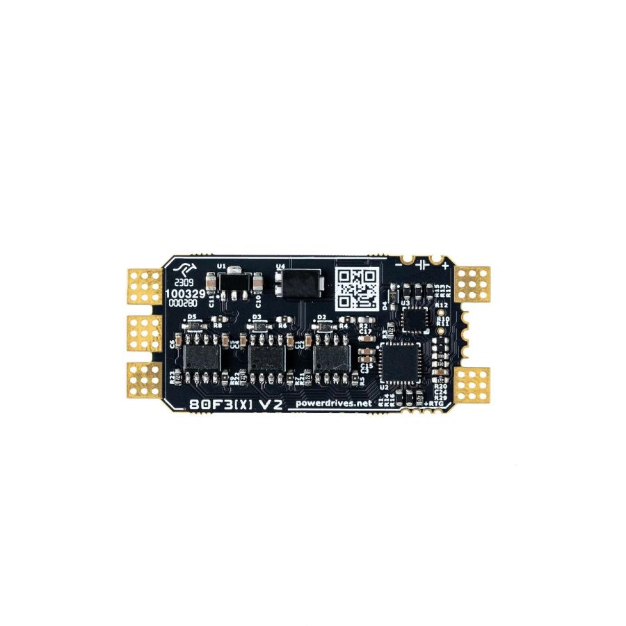

                                For a Speedfire2 for example dual APD F3 80 inverters are 40 grams of inverter which equal 9.4kW @ 8s lipo. The rotor performs better because the subharmonic is cancelled. He knows the pyro and xnova 600's perform better in power to weight. He knows both motors also provide better cooling than a scorpion HK.
                                Click image for larger version  Name:	DSC04755-Edit-Edit-2000.jpg?format=1500w.jpg Views:	0 Size:	48.6 KB ID:	413073

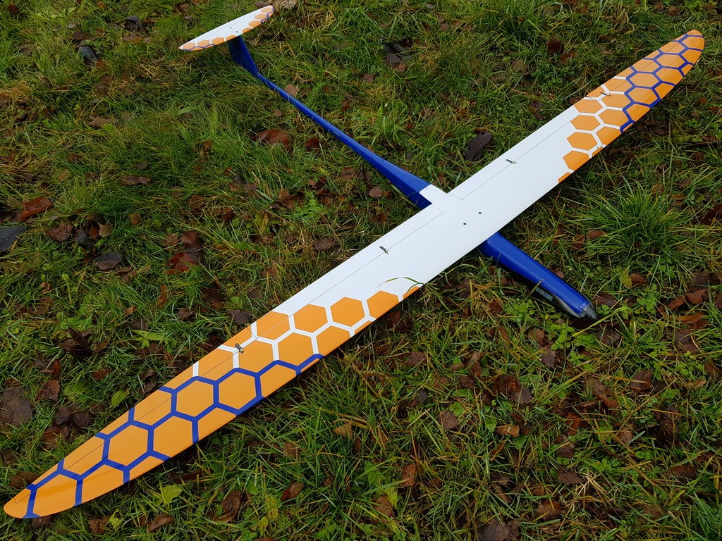

                                          Click image for larger version  Name:	SL-0.jpg Views:	0 Size:	425.0 KB ID:	413107
                                          Hi Christian,
                                          Specifically reinforced for speed my Speedfire2 guise is like this but black where this one is blue. Petr loaded it with KST servos. The reports say the gear drive pushes the possibilities but I didn't see where the direct drive outrunners were wound to produce 12,000 at the prop. Even though there are inverters made to run external rotors at high rpm the iron loss compared to a 2 or 4 pole is high and translates to heat. Running over a kilo in fundamental does that. The required commutation frequency is also higher with the 10 pole machines. In my mind part load operation isn't a point in the speed trap. Torque and power density is so Id strive for a BLDC system for high speed and high power and not a YGE for helis anyway. Otherwise seems like you should wind a slow turner with a lot of turns and stay direct drive with outrunner which keeps the iron loss down. A high speed 3 or 4 layer wind would work with an outrunner too.
                                          What's your opinion Christian? Neu doesn't make alot of fast turn outrunners but they are very clean.
