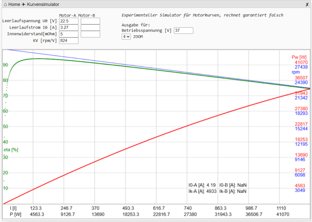

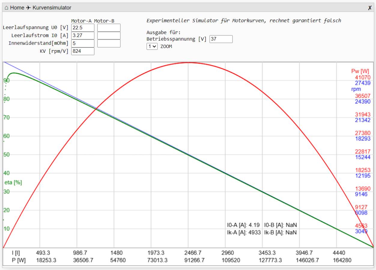

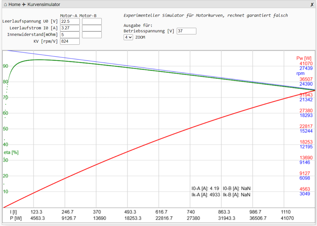

          ​​ξ is 0.96593
          Rm .oo5 ohms
          Kv 824
          Io 3.27 amps @22.5 volts including radial fan load.
          Weight 448.8 grams​​
          Click image for larger version  Name:	image.png Views:	4 Size:	208.3 KB ID:	416919In a performance hydro with 10s lipo @ 9800 mah and a castle 240. Prop wizard selected an ABC 1918 as the most efficient prop for the setup.
          Resultant:
          28,221 rpm
          141 amps
          4,955.78 watts Pin
          4,728.58 watts Pout
          run time 4.15 minutes
          est speed 79.20 mph or 127.46 Km/h
          Eff. 95.42%​ 🙈

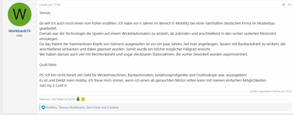

            Click image for larger version  Name:	image.png Views:	0 Size:	202.8 KB ID:	416928​This is fine but I don't know why you two are giving it a thumbs up as if you do not own such diagnostic equipment. If you don't maybe you shouldn't be going around on all the forums running your mouth with data that doesn't match. If you did what the poster did and simply kept ya mouth closed on other peoples projects like POCBOI'S I wouldn't have had to expose that fallacy. Two overly confident winders from Germany cannot simply admit the machine outdoes their hand? The man is calls everyone stupid but his hand wind is as airy as it can be. How stupid is he to create his own trap as it has been posted you don't need max fill for a really good motor. I wind alot of BLDC external rotors with excellent result . I have also seen the results of many experts in the field. I can show you a paper where they tested and said over 14kW the external rotor was more efficient but I wont waste my time since you already know everything but just measuring the before and after weight of a wind does not tell you how much slot fill you have. They are truly ignorant by definition because you cannot help and explain to them that the end turns have weight and are not in the slot. They do not contribute at all to the torque delivery or slot fill calculations only the copper loss.
            The poster name is workbench76 but he admits simultaneously he has nothing on it Ralph.

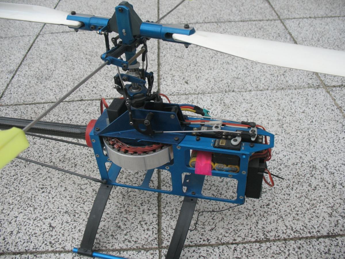

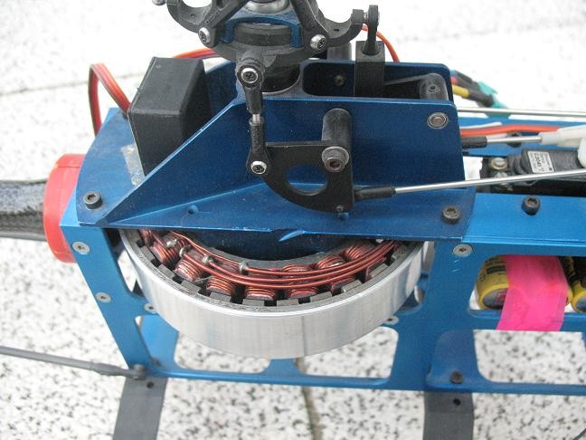

              What gives Ralph? You and Audiosmith have posted numerous times that Christian has never wound an outrunner and is a pure theorist but truthfully he probably had the worlds first outrunner definitely in hobby that ran worth a flip. What you have done to the motor forums a real injustice with all the fallacy because we've calculated your slot fills and efficiencies really well for all the hobbyist.
              Here is the truth.

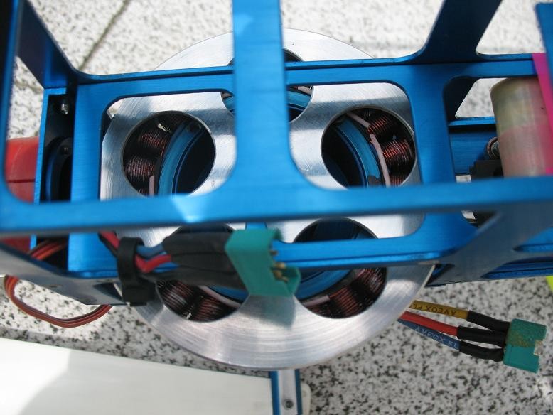

              "Hi,
              It's the first outrunner direct drive in the picture with the blue anodized aluminum parts and the inrunners with air gap winding.
              The helicopter from 1996 for the Berblinger Prize Ulm with 12 hours flight time competition. The inner rotor is the first with air gap winding and the first brushless to win the Pylon World Championship. Here in the picture my competition motivation and the very first outrunner who got the LRK story going for F5B 10 cell class. At that time, it was mainly bust engines that flew folding propellers directly or with gearboxes. The First LRK weighed much less and exceeded the performance data. In 1996-97, Norbert Hübner etc. from the Munich club Freimann/ Fröttmaning flew along, at that time Keller and Plettenberg had connections out of competition. That motivated me to offer the engines to all manufacturers, but they didn't want to get used to them. So I wrote to Ludwig Retzbach if he would like to write an article about it together with me. He then published it in the electric model at the end of 2000. The second was also a pure competition engine that I flew in a helicopter conventionally with a gearbox. Everything else then picked up speed by itself with Torcman, Flyware and a little later Strecker. Only then came engines from Plettenberg, Kontronik etc. Chinese ect. On the market.
              Excellent post Christian. Keep pushing the facts fallacy free.
              Thank you.

                    Click image for larger version  Name:	image.png Views:	0 Size:	213.6 KB ID:	416945
                    Sag es mir, Ralph. Der Name des Verfassers ist workbench76, aber er gibt gleichzeitig zu, dass er nichts dazu weiß, Ralph. Keine Wicklung, kein Oszilloskop, kein Isolationstester usw. Was weiß er also wirklich über das Aufziehen eines Motors, um jemand anderem eine Tür aufzuschieben?
                    Ist das der Grund, warum Sie dem nicht unbedingt notwendigen Beitrag einen Daumen hoch gegeben haben? Niemanden interessiert, was er nicht kauft. Was hat das mit Kupferfüllung zu tun? Früher haben Sie Oszilloskope verwendet, um die BEMF-Erfassung nach Ihren Wicklungen anzuzeigen, bis Sie ein schwarzer Troll gebeten hat, die Oszilloskope auf FFT-Erfassung umzustellen und das gesamte harmonische Rauschen zu messen, das sie erzeugen. So berechnen Sie den Leistungsfaktor. Ziehen Sie und Ihre Daumen-hoch-Freunde diese 10-Jahres-Methode vor, um auf 79 % zu kommen? Ich schätze, Sie können in diesem Zeitraum viele Motoren ohne Garantie verkaufen und reparieren? Sie haben also einen Daumen hoch gegeben, weil die meisten Bastler, wenn sie solche Diagnosetools vermeiden, sich nicht schnell entscheiden können, etwas anderes zu kaufen, weil sie dann die Wahrheit erfahren würden? Wie schade. Dann, Gerd, sprechen Sie über die Gültigkeit der Wicklungen bei Verwendung in einem Hochgeschwindigkeitsflugzeug. Wie ignorant ist das? Sie glauben, das Flugzeug bevorzugt, weil es in der Luft ist, 79 % gegenüber >90 % der anderen. Ihr glaubt, es gibt ein Vor- oder E-Antriebsgerät, das das begünstigt? Warum seid ihr dann nicht die Idiotengruppe? Hört damit auf, Bruder. Oder ihr wollt nicht, dass der Verbraucher wirklich weiß, was der Motor wirklich kann. Und der Moderator und die 20 Verbraucher applaudieren dem. Das ist bemerkenswert und tödlich ignorant.
                    Click image for larger version  Name:	image.png Views:	0 Size:	5.8 KB ID:	416946
                    Du hast ihnen sogar gepostet, dass die Effizienzgleichungen für deine Motoren, wie sie bei Maxon Motors verwendet werden, ungenau sind, aber alles, was Holger getan hat, ist, die Maxon-Gleichung in eine Zelle in Excel einzufügen. Das schwachsinnige Verhalten von Ihnen und Ihren Moderatoren ist äußerst seltsam. In der einen Minute erstellen Sie einen Lehner-Thread, in dem Sie alle möglichen Verifizierungen verlangen, und im nächsten Atemzug ist es Ihnen völlig egal, ob Sie die Unversehrtheit der Kabelisolierung überprüfen like workbench79?

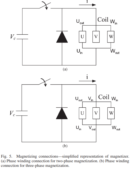

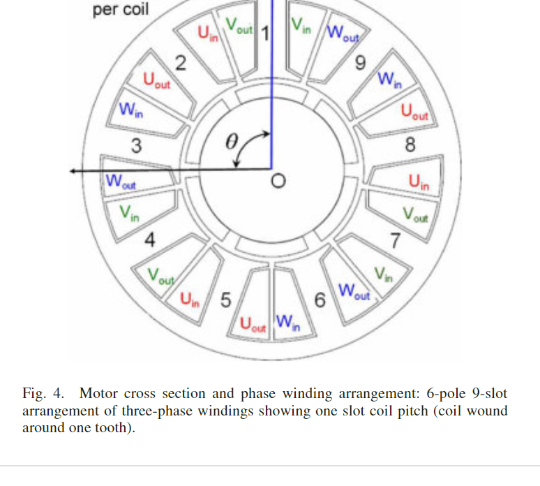

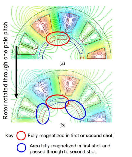

                      Was ich über den Impuls herausgefunden habe, ist, dass dieser davon abhängt, welchen Draht Sie verwenden und von der Koerzitivfeldstärke des PM-Materials. Soweit ich gelesen habe, scheint die 1,5-fache Koerzitivfeldstärke zu funktionieren. Ich würde den Motor wickeln und ihn für alle drei Phasen magnetisieren, beginnend mit einem Schuss bei null Grad, dann den Rotor um eine Polteilung drehen und ihn mit dem zweiten Schuss treffen. Das Slotcar-Papier zeigt Ihnen, wie die Magnetisierung des Stators durch die Keilform des Eisens die Richtung der Magnetisierung durch den PM bestimmt. Wenn Sie wirklich wissen möchten, ob Sie genügend Impulsstrom haben, könnten Sie sich nach den Schüssen die Gegen-EMK auf dem Oszilioskop ansehen und sehen, ob Sie der erzeugten Wellenform Amplitude hinzufügen. Wenn die Amplitude maximal ist, hat der verwendete Impulsstrom den Magneten vollständig gesättigt. Ein Schuss mit höherem Impulsstrom danach wird die Sache nicht verbessern. Ein zu hoher Stromimpuls über einen zu langen Zeitraum wird den Draht durchbrennen und die Magnetisierungseffizienz ruinieren.​
                      The Attached photos are property of:
                      -Min-Fu Hsieh, Senior Member, IEEE, Yao-Min Lien, and David G. Dorrell, Senior Member, IEEE~

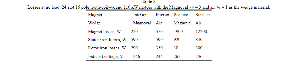

                                  Losses caused by the permanent magnets are proportional to the square of frequency and currents, as explained in [23,24]. The total loss caused by the eddy-current density according to [23] is
                                  Click image for larger version  Name:	image.png Views:	0 Size:	2.0 KB ID:	417162
                                  in where k the harmonic order number, J 0,PM,k is the current density on the surface and δ PM,k the depth of penetration. The depth of penetration in permanent magnet is proportional of the frequency and may be computed as [23]
                                  Click image for larger version  Name:	image.png Views:	0 Size:	2.4 KB ID:	417163
                                  in where ρ PM is resistivity of magnets and ω PM is angular frequency of magnets. From 0 speed to rated speed of 1 p.u. the losses due to permanent magnets are increasing. Reasons for this behavior are: The needed current is high at low speed, the supply voltage (integral of flux linkage) is increasing from 0 to rated voltage as speed increases from 0 to 1 p.u. speed and also the frequency is increasing too. The currents are presented as a function of speed in Fig. 4. The iron losses are also smaller when using this wedge material, as can be seen in Fig. 5
                                  ~Influence of Slot Wedge Material on Permanent Magnet Losses in a Traction Motor with Tooth Coil Windings~
                                  [23] J. Pyrhönen, H. Jussila, Y. Alexandrova, P. Rafajdus and J. Nerg, Harmonic Loss Calculation in Rotor Surface Permanent Magnets – New Analytical Approach, IEEE Trans. on Magnetics, vol. PP. n. 99, 201
                                  [24] K. Atallah, D. Howe, P.H. Mellor, and D.A. Stone, Rotor loss in permanent-magnet brushless AC machines, IEEE Trans. on Industry Applications, Vol. 36, n. 6, pp. 1612-1618, Nov/Dec. 2000.

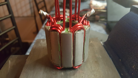

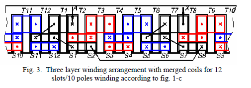

                                          More turns make a better higher Q inductor in the first place.... and the inductor should be matched to the circuit! Wyes to delta hybrids are deltas with embedded load reactors. A capable hand winder can multilayer and shift several serially connected wye motors to a final inner delta. Industry uses as many as 8 hairpin layers and don't have to worry about crosstalk between the wires. Nothing could be worse than winding two parallel strand axially stacked if you want to avoid proximity losses. The winding technology for thick hairpin conductors is already proven and powers E Jags and E range rovers A competent hand winder that understands wire knows that a wyes pigtail carry 300% of the phase currents so quite naturally if you let that current dissipate through the delta circuit where 2 strands now can mitigate the current of each open end wye phase end it calms down. The pigtail is now the entire delta motor and therefore it can mitigate much more current and run much cooler. You've also divided the voltages between the wye motors at that point. So you can run fewer turns for each wye motor if fit is an issue. Real engineers know the zig zag technology is also used in high efficiency power transformers everyday. Of course it makes a better generator/motor. DUH!
                                          Click image for larger version  Name:	3 layer winding.png Views:	3 Size:	17.6 KB ID:	417204
