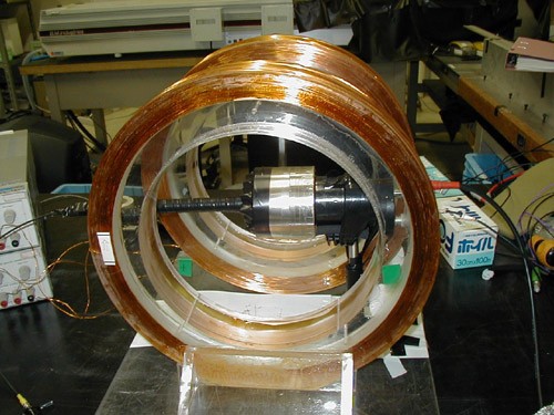

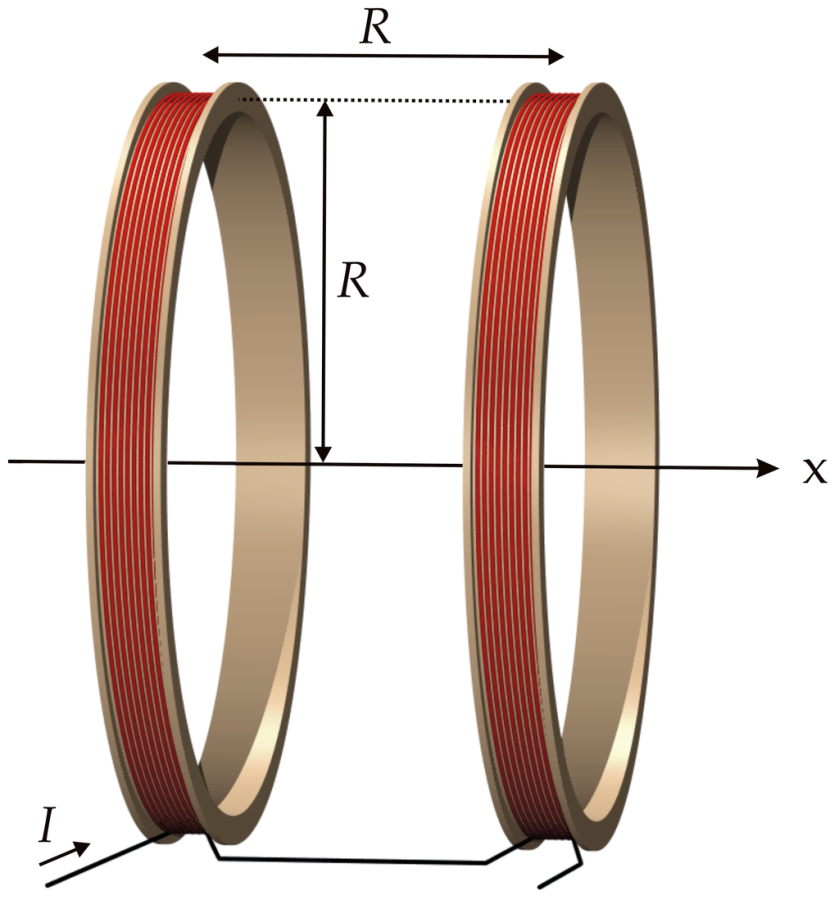

we have Helmholz coils at Magnet Motor and a high power frequenz generator that can handle up to 500 amps. Sinwave , triangle and block , dońt know the right word, you know. We have this from superconductor energy storing coils to feed them, charging the coils. I have tested the different plates materials for the flux wedge between the magnets for fluxcompresion. I Place the parts in a vacuum chamber and messure the heat up with time. Other test was to see how different parts in a motor make some noise start to emitt like a audible speaker. 150000 watt power give a good entertainment system 8 of such in wheel motors can be noise , so much that people run away. So we ad a noice reduction system to make the motors noiceless , realy important for a combat vehicle. I need some time to do all this , but i will tell you my result. With Pyrographit i had also Graphite thin foils with very high Heat Transport ability . So with some friends i make jokes as i let them hold the foil at 10 cm Away and switch on a lichter to heat the other side and in the same moment they feel the heat and let the foil fall down asotinsching by the rapid heat up . Pyrograhphite is much faster. I will also test it.

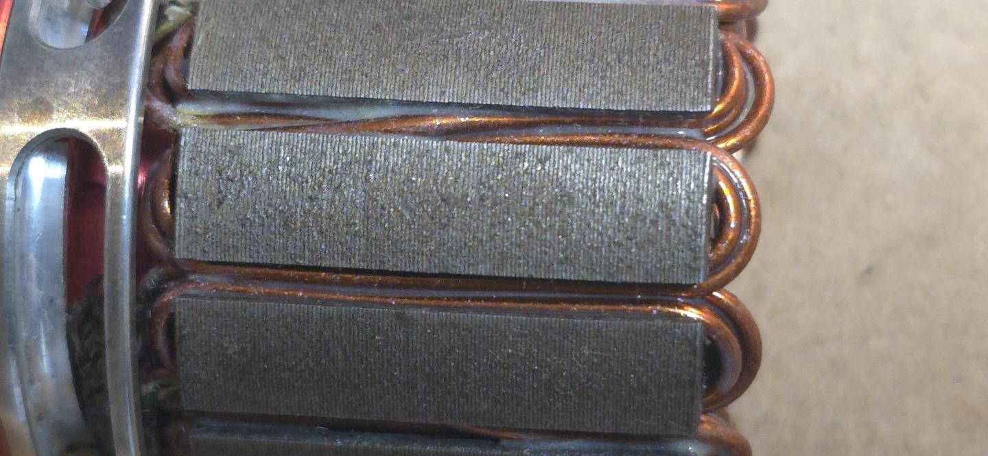

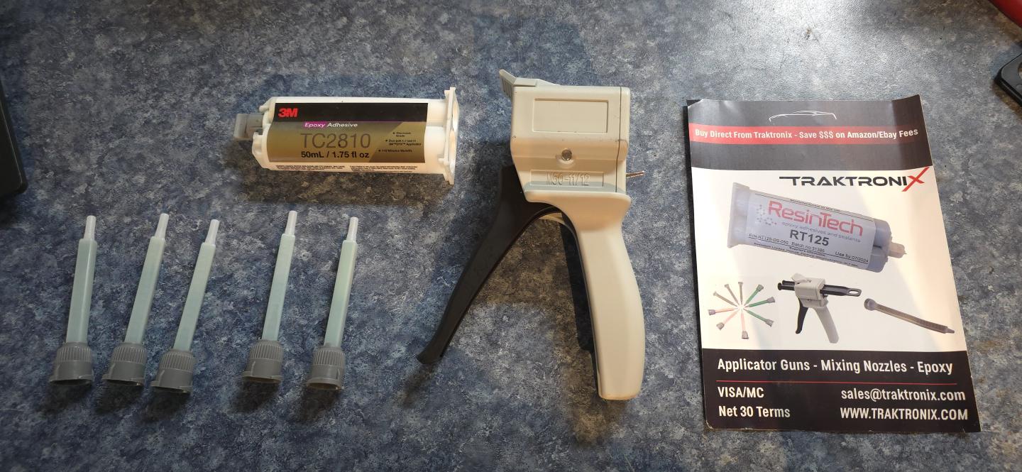

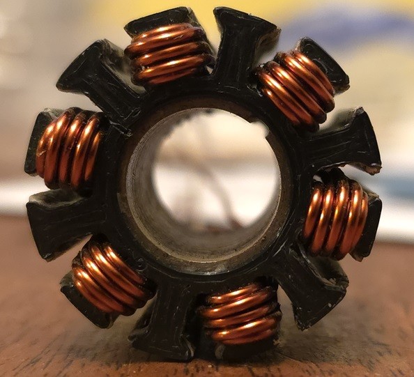

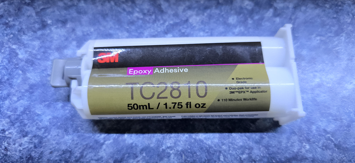

Jonathan's 600 14 poler done. Now ill secure the wires with thermally conductive epoxy made for securing motor coils . Three hybrid bearings are also installed. It is excellent in my opinion but I have a proprietary material that has 4 times the thermal conductivity of the 3M. Digikey is one place you can find such material. It is not fact that it must be vacuum impregnated to bring great improvement. Lord technologies has tested that. VIP would be the ultimate. You can 3DP or turn on a lathe a small VIP chamber and tap it with a vac gauge and a bleeder valve, however I apply it by hand in such a way that it wicks well between the wires and the iron. Have a look 😳. Its not perfect yet but it performs much better than nothing and about 150X better than UHU. It lowers the wires working resistance and allows a more complete thermal circuit to dissipate heat. I can't go back to the old days because they want it now.

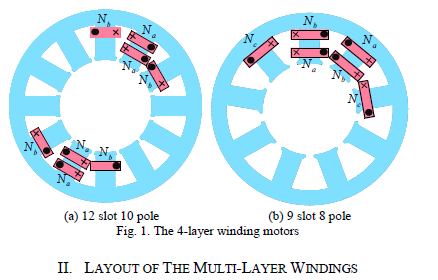

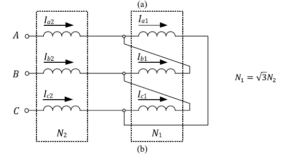

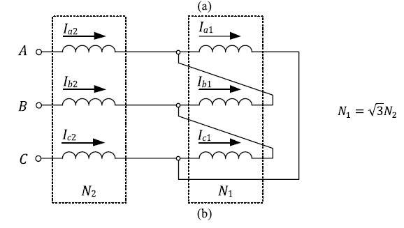

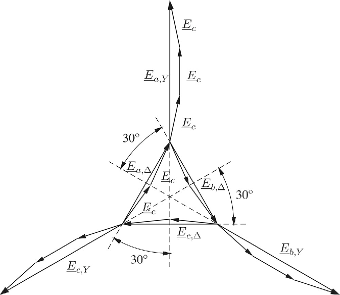

From what I gather what Drs in Munich did with it is connected the machines serially on the backside of the stator and that gives you half turns and much more optimal turns ratios. The uneven coils side move the vectors in intervals of 30 degrees. To me is is like a PAM winding. I'm still studying different windings right? I still have my own sets of questions. It is a lot of vector summation mathematics, but you see the three traps on top the Delta

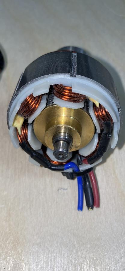

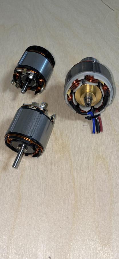

Hi Hubert,

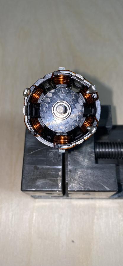

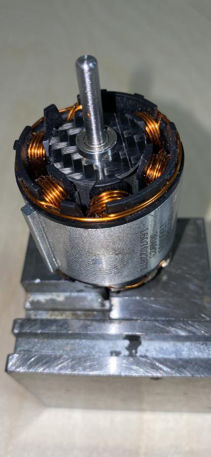

i show here some easy to use 3 phase motors that are from batterie operated hand tool like drill and grinder overhead cutter/grinder . Some are cheap and some can recycled. No use of housing only two carbon plates to hold the bearing all othe is selve carrying. Nothing moore needed. I will run such motors in smaler powerboats , they can rev high .
Happy Amps Christian
Thats cool. What brand drills?Originally posted by Chxpress View PostHi Hubert,

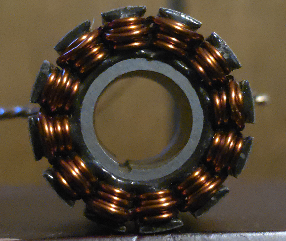

Look.
I have the 7 turns delta single layers wrapped on the other pyro 600. Now the open end coils get 4 turns if I cant fit it.
4turns wye X Sqrt(3) = 6.928 turns delta
See that took only a short while to wind half the motor. And as you can see no proxy war is started by winding a parallel wye-delta hybrid motor. What sense did that make since the proxy war was ongoing for years without it. What it does is stop the speculation and conjecture of those with zero experience.

The motors are Bosch and Workes

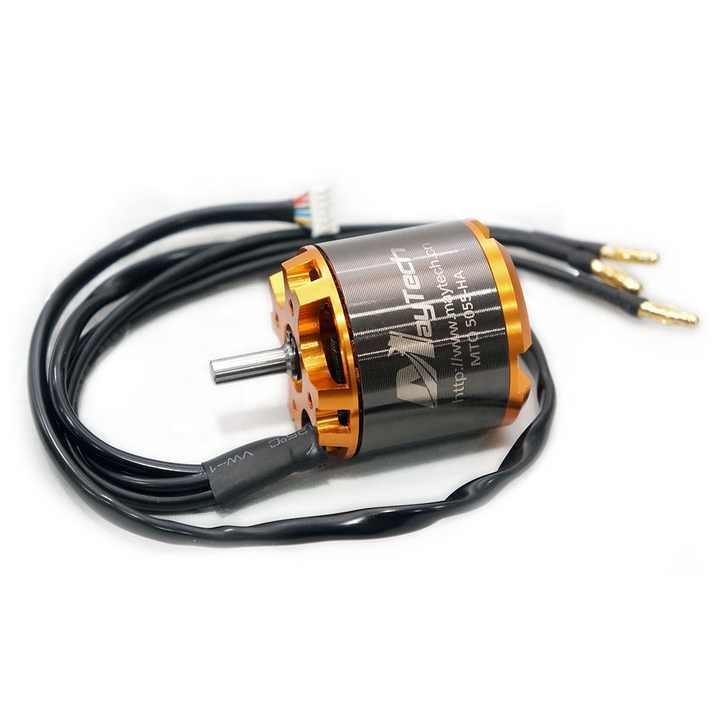

Hey Chris, zeig Erwin diesen Motor der 50er-Serie. Der Hallsensor ist bereits eingebaut, sodass er ihn mit dem Castle oder dem logikbasierten Motorolla-BLDC-Motorsteuerungs-IC betreiben kann, den ich dir bei 34 Volt gezeigt habe.
Maytech 5055 Skateboard Brushless Motor Engine Sensored For Educational Robot Rov Underwater Thruster - Buy 5055 Brushless Outrunner For Hall Sensored Electric Motor For Electric Board E Scooter Boosted Board Skateboard Electric,5055 Motor Rc Motor Outrunner For Hall Sensored Bldc Motors For Electric Hover Board Electric Scooter Skateboard Electric,5055 Motor Electronics For All-terrain Longboard Wheels Electric Scooter Skateboard Electric Bicycle Motor Product on Alibaba.com
