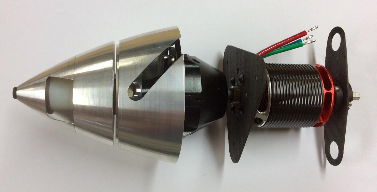

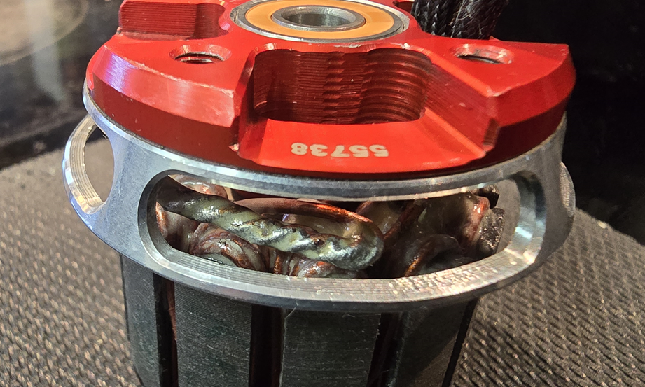

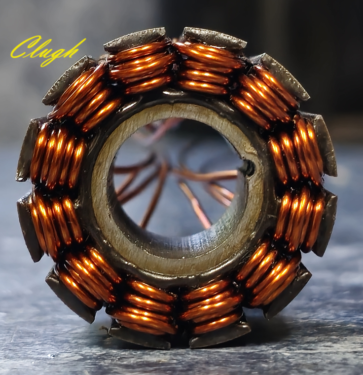

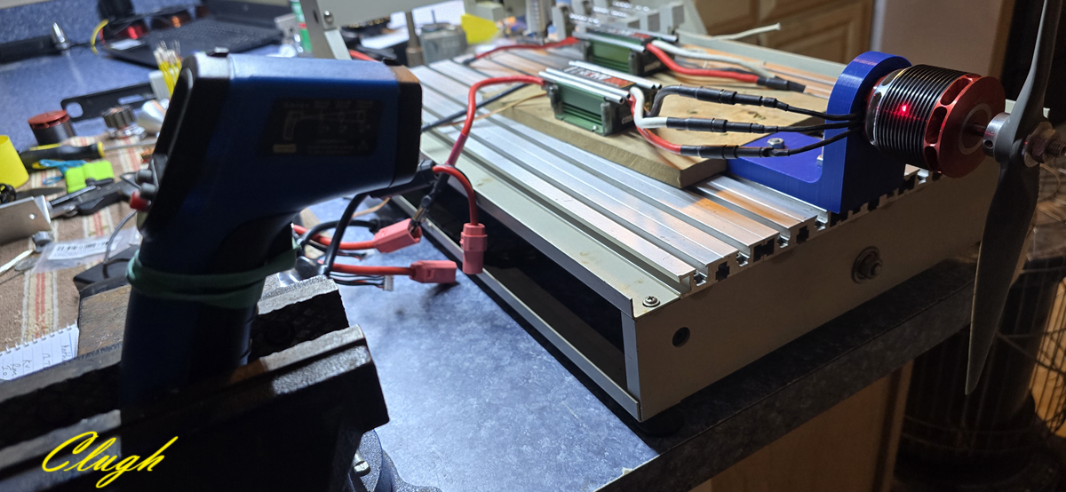

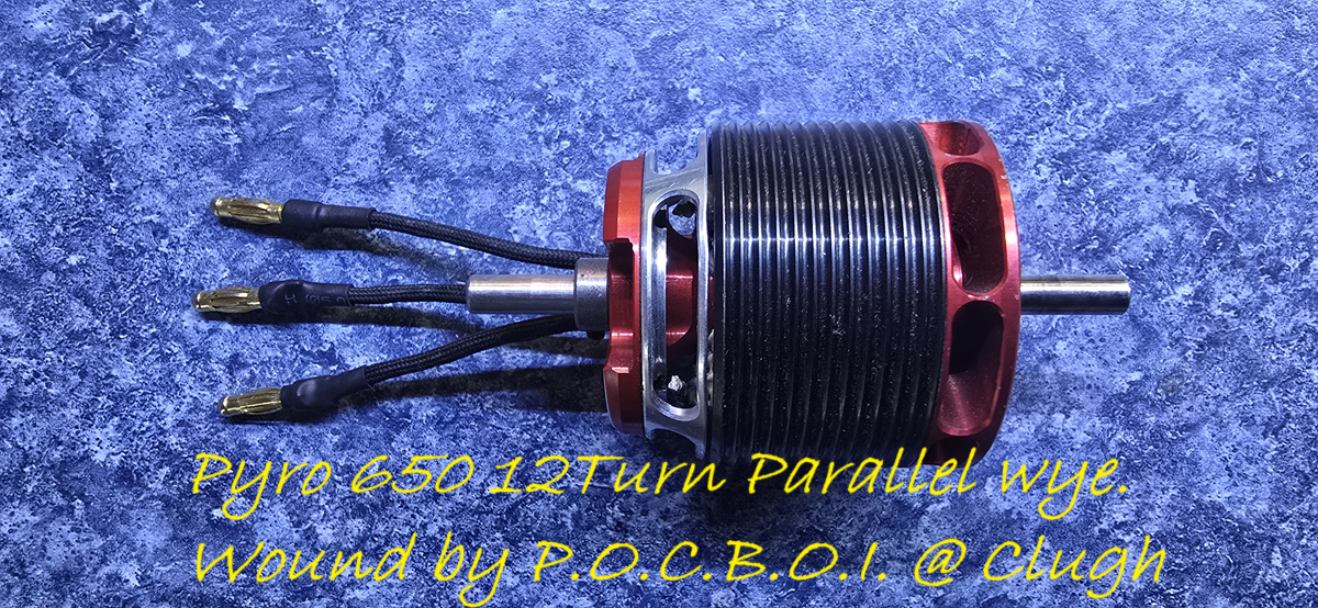

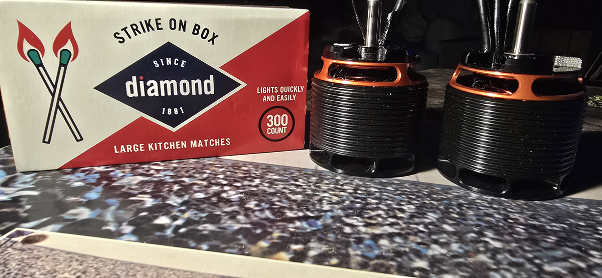

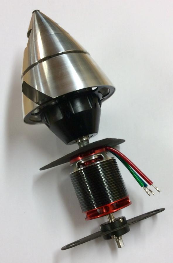

The 12 turn pyro is complete and ready to test. the Kv should be between 850-900 . 880 was the target. It is a parallel wye in 200 C TEMCO 17 AWG magnet wire (1.21 mm diameter measured) . An easy wind. The parallel motor terminals are twisted and fused with Kester silver solder all the way to the connectors There is no insulation under the hood on the pigtails or wires Everything is potted with the TC2810 thermally conductive epoxy from 3M made for bonding motor coils. The 3 ceramic hybrids are installed as is the intermediate hardened steel shaft to tie the 3 bearings together axially.
