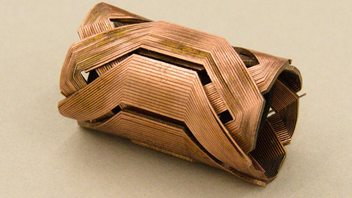

The smallest practical integers observing that 3 slot per pole rule that will give you the most slot space is 6 slot 2 pole. It the cogging of external rotor is too much make it a slot less machine with a lapped rhombic winding scheme. Similar to Hanz in runner.. You use a toroid core but lap the entire winding on the external circumference of the core unless you plan to do an inner/outer rotor pole design
The 2 poles can be radially and axially segmented. Six wide teeth and three big copper braids!!
Lay the Rhombic pattern on the outside a toothless toroidal core for the slot less machine with no cogging.

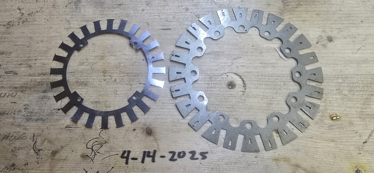

H.H. 4/15/2025
It is not my fault u2 are simple minded and silly the coil span is 180 degrees. for each coil overlapped
You wind the coil conductor around a rhombic mandrel first pull them off and apart into the exaggerated rhombic shape that will allow them to be overlapped. You make the overlap rhombic coil sides to fit over and under like a herringbone or hairpin pattern. You have to lap and size the coils and conductor properly to have symmetry and the 3 coils all observe their 180 degree coil span around the circumference of the core.. You have to be neat because you want a consistent air gap. You can vaccum seal the winding to the core with TC or they wont stay in place. You can even VIP the coil lattice to the core for no holes. or hotspots

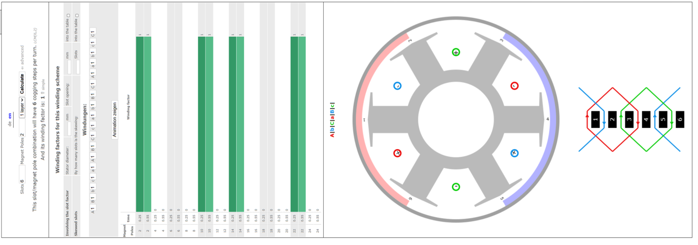

18N14P ABbcaABCcabBCAabcC Kw.90 but specializes the 7th working harmonic. Look at the 5th harmonic pushed down to 13%
You haven't done much winding research at all or you would have seen this. Its an excellent FSCW topology because the sub and space harmonics have been attenuated significantly leaving only the 14th to work mostly alone. The rotor will be a cool runner.

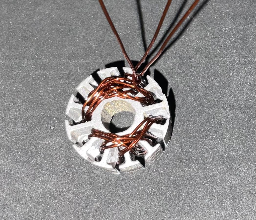

On march first 2025 this is what he said about the 20 pole winding that now has become a very sophisticated proposal ....
"Hi,
thanks for the picture of the 20 poler, I didn't know. Actually, it would be the machine that I am also examining. For testing, however, I would like to wrap the grooves really fully, i.e. until the last turn already ends with the groove opening. And I use the single-layer winding scheme where only one side of the coil is always in a groove. So no mixing of the active conductors in the stator grooves. I also use a nested winding scheme. In this process, all three phases begin to wind the winding in constant rotation. This allows you to wind only one conductor of each phase in the groove base, then increase it to two conductors and then switch to 3 or 4 conductors on the outside. This takes into account that the induction is lowest in the groove base, i.e. the smallest voltage is generated per conductor. The further out, the more efficient the induction becomes there and then it makes sense to let more leaders participate in the action there.
Secondly, the winding head is unravelled in such a way that there are more conductors free of cooling medium that can be flowed around in the winding head. Since the groove is to be filled and not much air can pass through there, the heat loss should be led out axially through the conductors and cooled there. That's why I'm investigating it. Oh yes, and with only coil sides of a phase in a statotnut, the syncloss should also start later, mix by mixing fewer phases.
Picture quickly times executed throwing winding how that will look like."
~Christian Lucas~

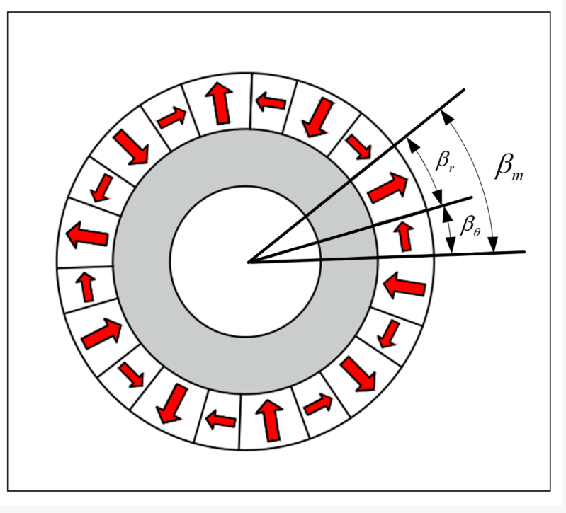

Guess I will have to scale it in cad and calculate the arc lengths myself since the GSM and its two resident editors are so quiet now and the motor Fuhrer refuses to post anything relevant about the Halbach machine. There's been no real explanation about it. I wonder why wasn't it made slotless by the superior? It wouldn't suffer cogging torque or space harmonics.

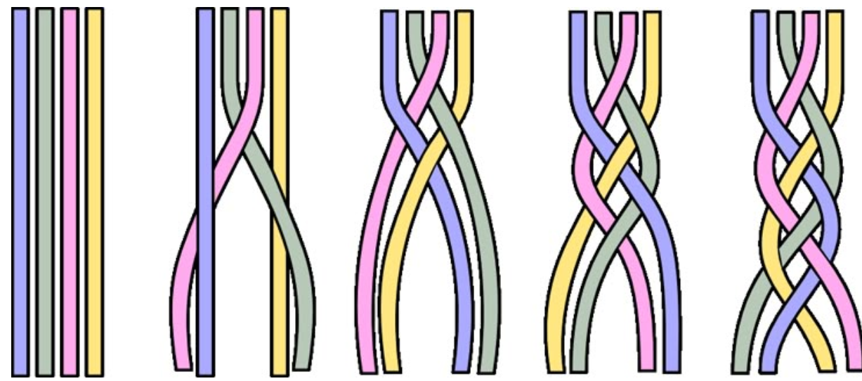

Ich hoffe, eure Freunde in Deutschland verstehen jetzt, was für ein Spaß ihr beide seid. Ich hoffe auch, ihnen gefällt das urkomische, isolierte Chaos, das ihr auf den Kontronics angerichtet habt. Oder die neuesten ungeformten Kracher, bei denen das Kabel hin und her schleift, bis es einen Kurzschluss gibt. So läuft das bei DNF. DZ und Markus Koch kennen die Powercroco-Methode Ich fände es auch toll, wenn Luke Ass sein Rmp melden würde, damit ich euch sagen kann, dass es keine Sinuswelle ist. Wie gesagt, es ist keine lineare Beziehung, denn das höchste Drehmoment lag bei 0,8, nicht bei 1. Es ist keine Pseudosinuswelle. Die tritt bei etwa 0,05 auf, wo das Drehmoment auch niedriger ist. In vielen Fällen erhöht ein Teil der Oberwellen, die die Sinuswelle dämpft, tatsächlich das statische Drehmoment. Wenn er es nicht benennt, kann er euch nicht sagen, als was es am besten funktioniert: als BLAC- oder BLDC-Motor. Für mich ist es fast immer Letzterer, weil es keine bipolare Maschine ist. Er sagte, Flachspulen ließen sich mit einer Spitzzange in der Küche herstellen. Worauf wartet er also noch? Wenn er wie die meisten Afrikaner flechten könnte, könnte er die Flachspule mit mehreren Leitern in einem Flachgeflecht herstellen. Er müsste LITZ kaufen, wo eine Maschine für ihn erledigt, was ich von Hand machen kann.

Running from the answer I see.... In 2 more days it will be 2 months since you promised then the 20 pole and now the answers are a secret with this Halbach too?. My latest hybrid has been running for over 2 months now....Originally posted by Clugh View Post

I also already had the plans for your Halbach from 3 years ago . DID YOU FORGET THOSE EMAILS AND ATTACHMENTS? so ill keep asking about the Rmp. on the open forum.
