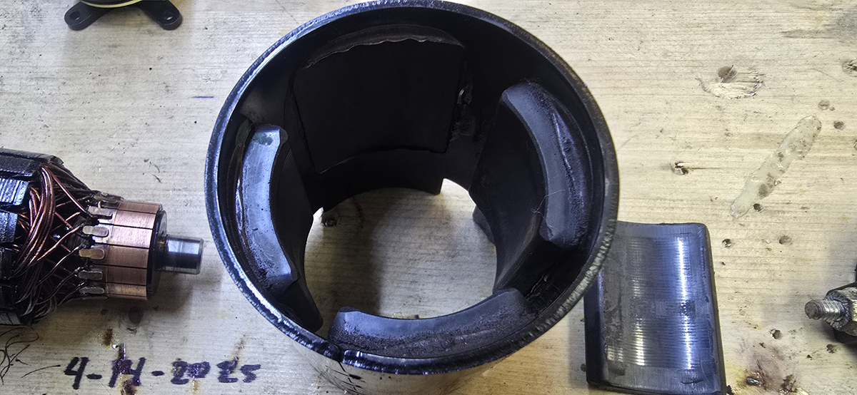

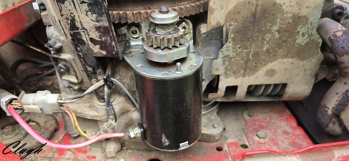

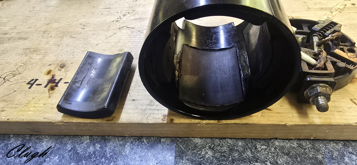

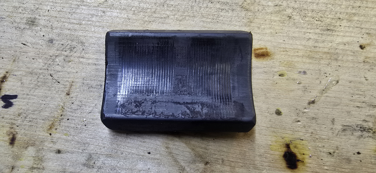

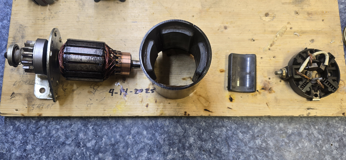

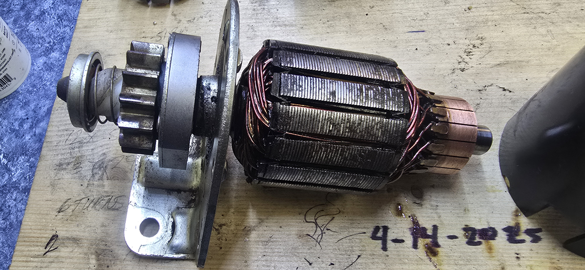

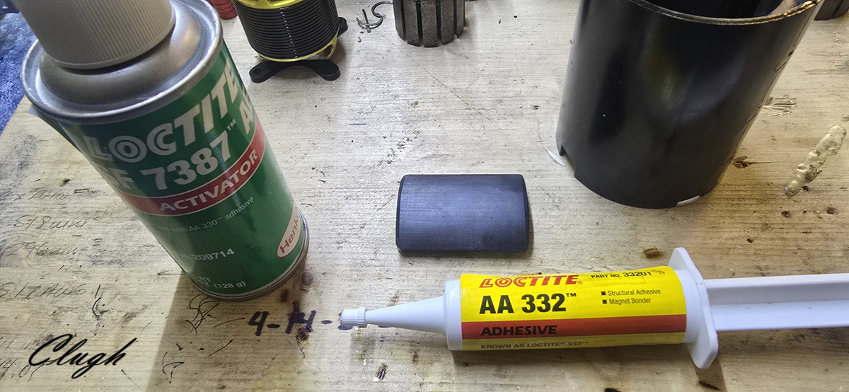

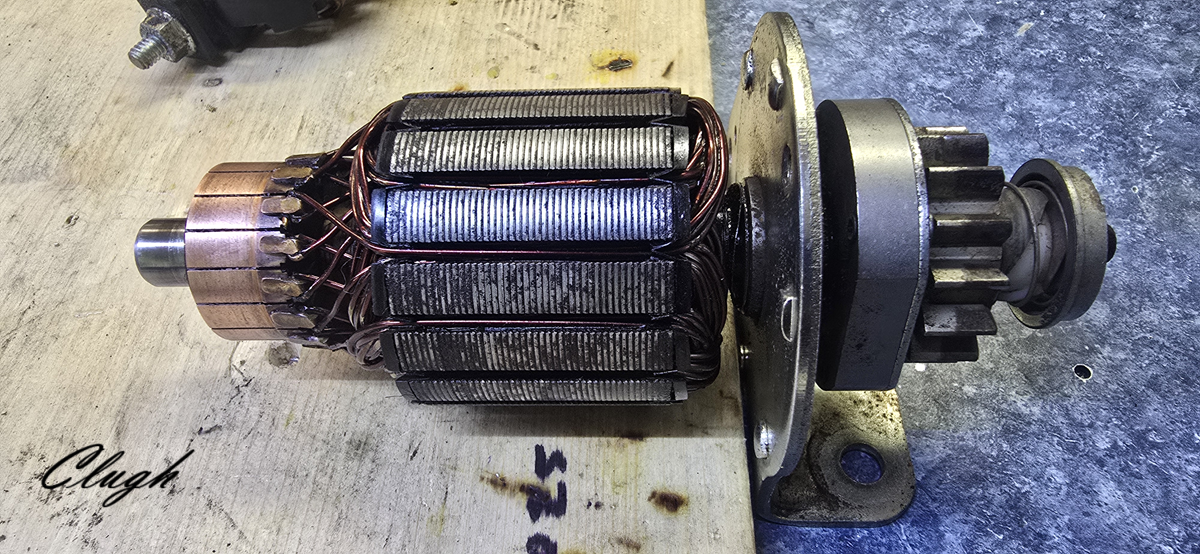

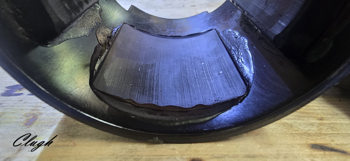

I was trying to knock the grass out and the 17.5 briggs & stratton starter motor struggled so i decided to take a look inside. It appears the corrosion on the armature got so fat it filled the gap and was dragging on the pm. One pm was also no longer glued to the can so I'm sure it was sticking to the armature and dragging as well. You can see the wear marks on the pm. First I removed most of the corrosion from the hammers then washed off all the brush dust etc. Then I sprayed the entire thing with wd 40 to dry the water down in the windings. I also lightly went over the commutator with scotch Brite. The brushes are in good condition, so now all i need to do is glue the pm back together, oil the bushings and reassemble the girl and she should be good.

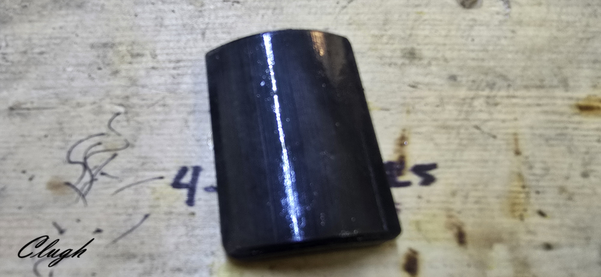

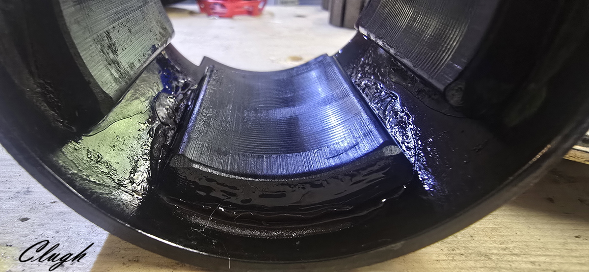

The adhesive they used is still good and flexible so the armature dragging and heat probably broke the bond. You can certainly see where it goes went it without being paper clip #14

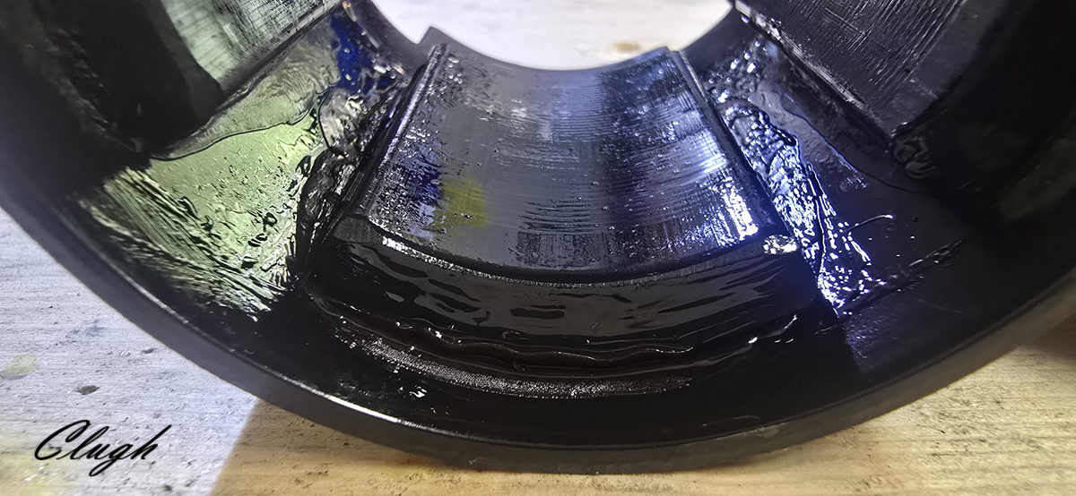

The consistency is like epoxy so I brushed the land where I want the pm to go. I used enough as I would like to see a bead when the pm goes in place to fillet with a brush.Comment
I actually cleaned the pm and land before doing anything. But as you see I sprayed the activator on the backside of the pm and prepare to set it in place. If I'm not mistaken this is set in 3 min. let me check for ya.ll boys.... no matter once the magnet is glued back in place Ill bake the can for bout 30 min at 180F.Comment
Sprayed the bead once it was in place.

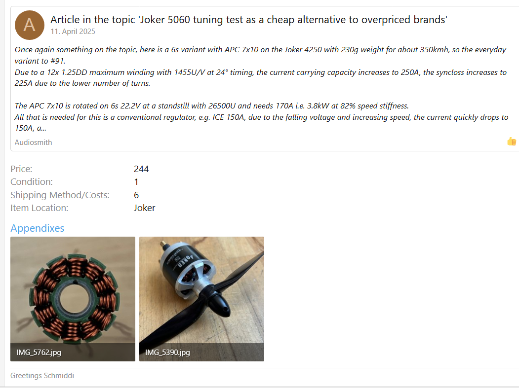

I don't plan to post anything about motors today I just want you to see how they are dragging the poor pilots in Germany for a wind.
PLANET-HOBBY JOKER 4250-6 V3 680 KV BRUSHLESS MOTOR - buy now - at Modellbau Lindinger
The joker 4250 is 64.00 usd. . The German wants 223. dollars and 31 cent to wind the 64 dollar motor.
Would you do it? Just a winding , No bearings, no potting etc on. a 28 mm stator. There's no way I'll do it. for "thin" China Iron.
