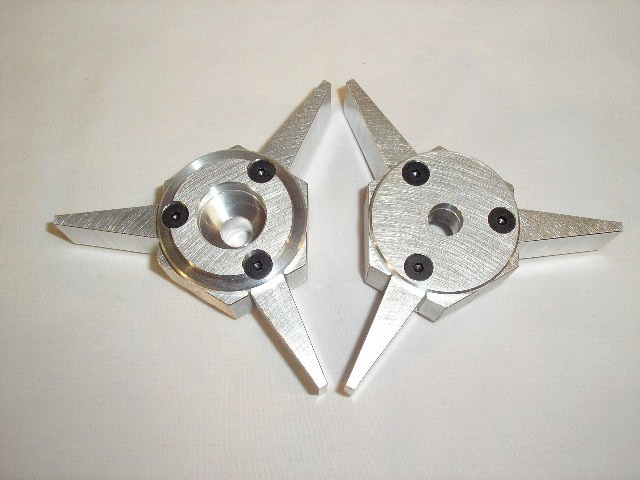

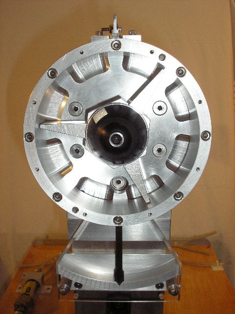

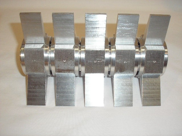

Here is Jimmy's water brake gifted from Ed Kalfus! The Rockwell ME JA .90s full billet blocks do 7.2 hp at 32,000 rpm His Grandson was at Texas A&M for engineering and has all the equipment. I don't know him and have no contacts. All this equipment is still out there somewhere. I hope he knows what he has. PURE GOLD! When I tell you Okon hasn't done anything. He hasn'tComment
He also quantified with his torque Cradle. Do you see that "Dr" ?

If Dr Okon remembers the Scale boat that holds the 2 lap record with a 4035 skorpion. This is my friend's that owns that boat Inertial Dyno. They also tuned and hold the 27cc gas rigger SAW record off of it.. this is what you should build with a longer smaller diameter drum for a fast electric boat. It does a good job of simulating the type of load you see in boat SAW.

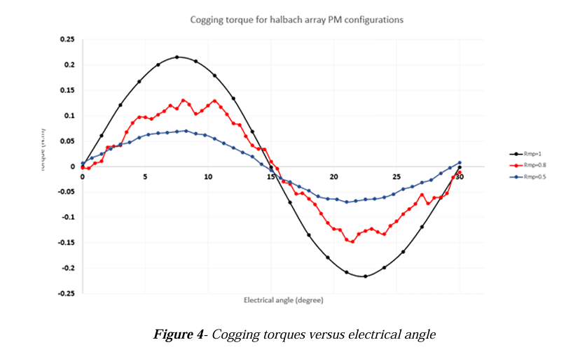

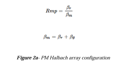

Rmp ist definiert als das Verhältnis des Polbogens für die radialen PM-Komponenten Δr zur Polteilung eines einzelnen Pols Δm, wie folgt.

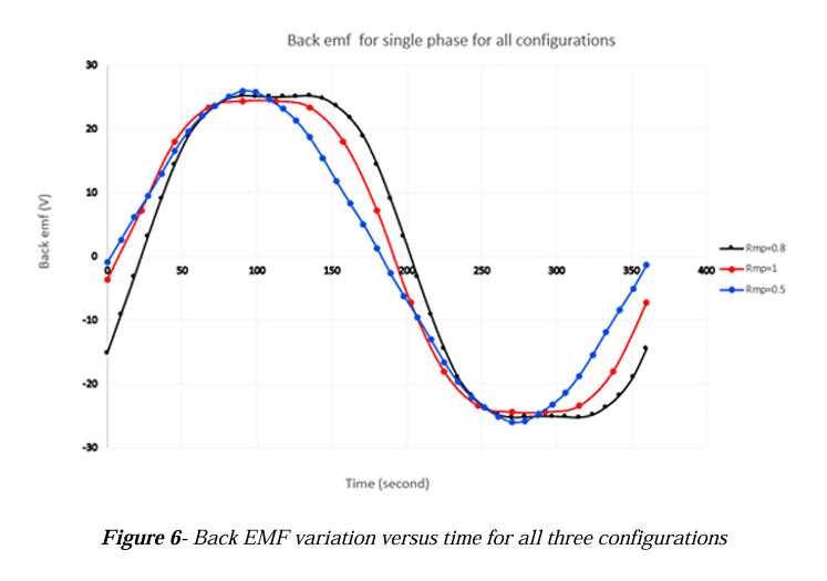

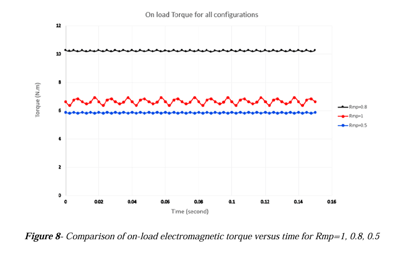

Sehen Sie, was aufgrund des Verhältnisses mit der elektromotorischen Kraft passiert? Sehen Sie, dass das kleinere Verhältnis eher sinusförmig ist und bei einer Sinusanregung weniger Rastmomente aufweist?Aber ist Ihnen auch aufgefallen, dass es das geringste Drehmoment erzeugt.
Das Verhältnis 0,8 erzeugt das meiste, aber die elektromotorische Kraft ist gefangen.

Its still BS against the 4225 it only had slightly more torque at the prop. It was no where near 40% more. Try single digit improvemnt..40 percent more is a damn fantasy. This speaks nothing to the ratio of the main pm versus the radial components. With the Halbach that's how it works. Just because it has a Halbach topology does not mean it is optimized and generates more torque and efficiency. that a well built radial machine. .

You need also to answer Rene!. Max flux density comes when the tooth is as wide as the PM. what you've been screaming for 12 years. So you need to elaborate your ideas more clearly because you contradict yourselfComment
