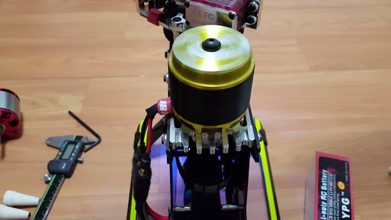

So yes load the 14 pole halbach that wont report its rmp, iq or id and the run less 20 pole with a prop or please just shut up! The theory did not pan out empirical. and it doesn't explain the slotless 2 pole machines torque delivery. No body cares about a know it all egg head with out an iota of data.
well the 14 pole he showed is not a steel flux wedge arrangement as he reported REMOTELY to me that is all pm.
The goal post change as usual. This is why i ask all the right questions first so he cant back track. What's the RMP of his Halbach machine.?If he wont report it i already told what kind words you can deliver coz he is wasting your time avoiding the relevant questions.

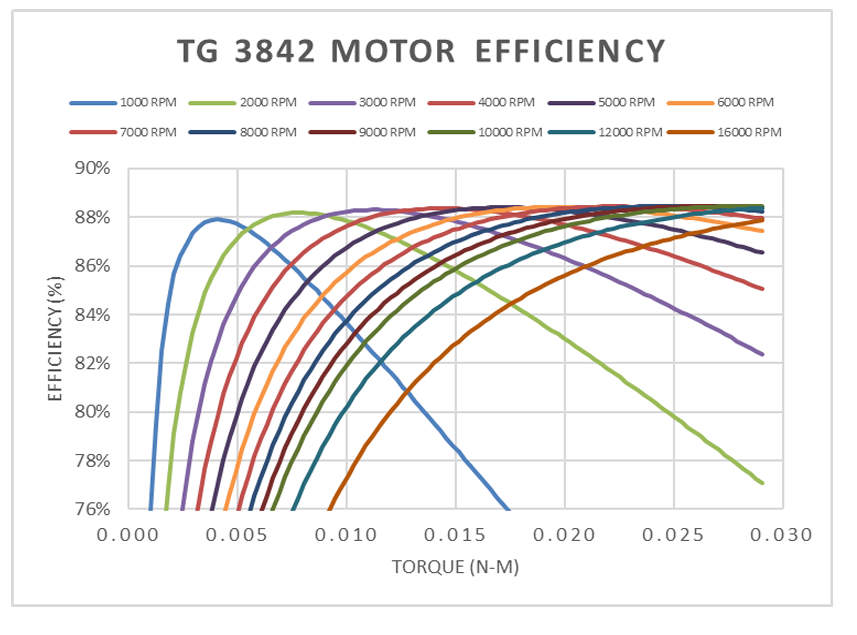

Right do the values come with a voltage and RPM???

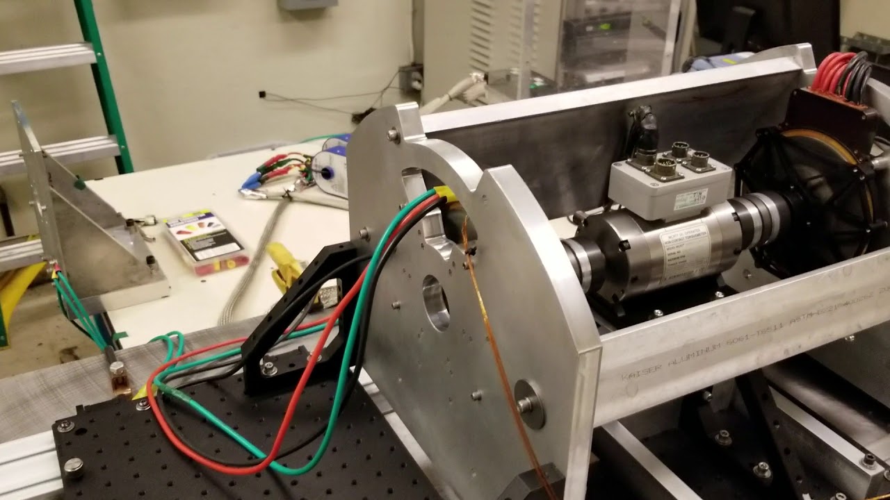

and so then after that this is still just the claimed electrical consumption now you need a mechanical out to determine a real eta. Should be interesting because Lehner 41 reports 93%..

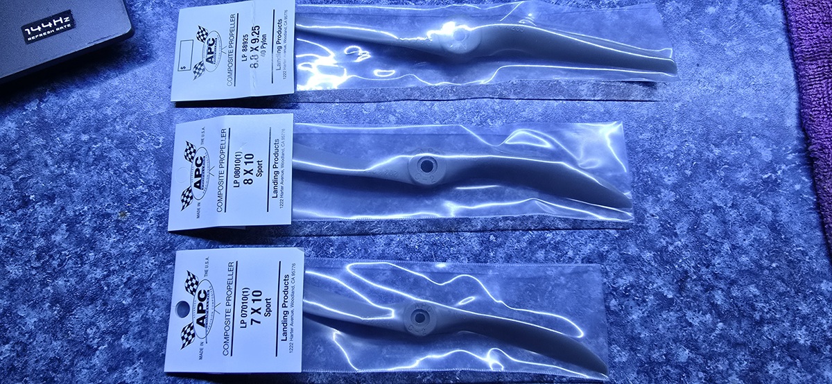

So turn the props. and drop the real data

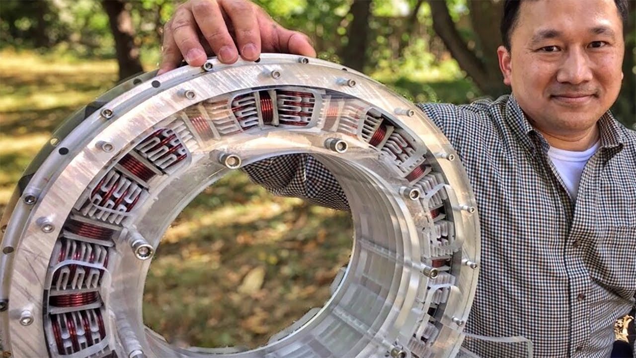

Long ago Ralph I gave your patterns for a rhombic winding. You can glue that rhombic overlapped lapped winding to a iron cylinder and build a slot less outrunner. In fact you could print non magnetic teeth that go around the iron ring to arrange the coils. Those patterns and post may be on rc groups from a ways back. The ring could be an amorphous iron spiral strip core. You dont need iron teeth at all

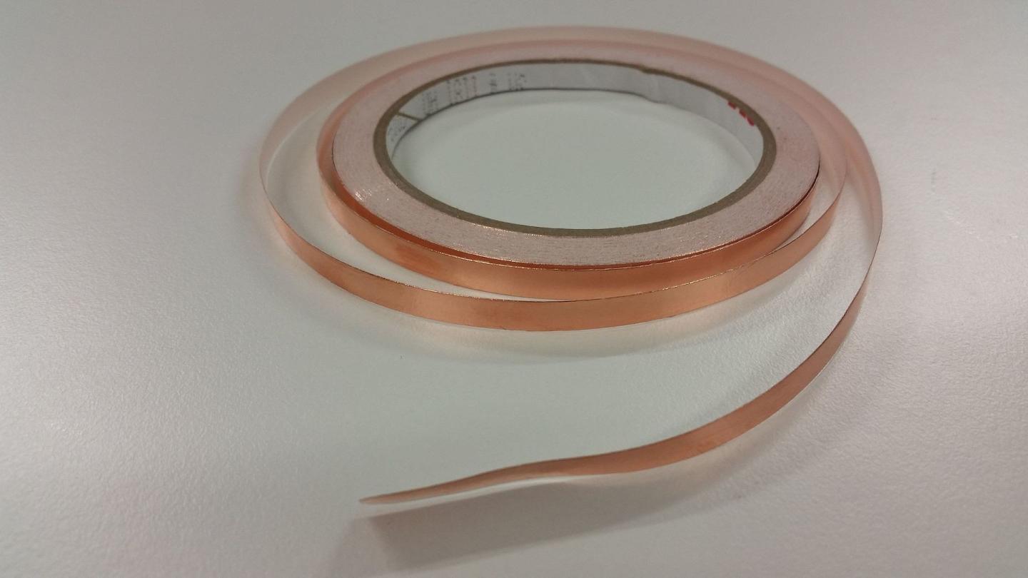

The windings you truly could cut from copper foil tape then insulate each phase layer with epoxy before applying the next overlapping phase.. That would be extremely compact if you take your time and plan it out. with your scalpel. You could lay it on a mylar or kaptan tube. Like for a speakers voice coil..If you insert a flux ring after that it will generate real torque. You print a to scale template on a flat piece of paper and wrap it around the tube.
