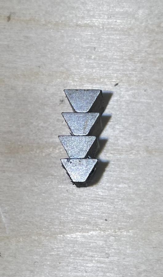

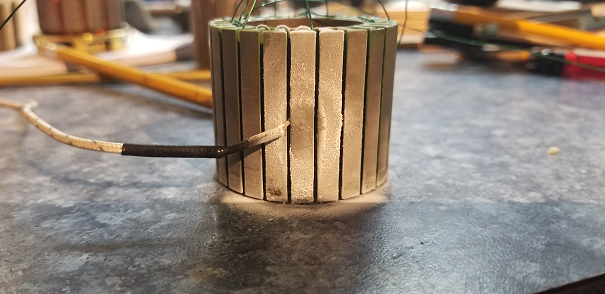

With the Halbach he doesn't need any back iron in his rotor so it can be pure carbon fiber or a light weight and strong high speed material like Inconel. Are these all magnets because it looks like magnets then silicon steel flux wedges in an alternating pattern. Before you slam it you should have him tell you a little more about it. It is innovative and a really cool rotor. Itz very unique. Almost like a synchronized pm assisted reluctance machine. You could also have a laminated rotor cut in a v pole configuration and half the magnet mass. The v pole is a flux focus of sorts.Comment
I he gets a 3d printer that can print support material he can print an inner mandrel to hold his pm in place till the glue set which is fairy fast with the right adhesive. After the glue is dried you submerge the rotor in water and the support material will fall away. Im thinking about trying a carbon fiber sleeve this way. U need to make it slightly undersized then press it on the bell. Its just a prototype so he can refine his hand made manufacturing process and save quite a bit of weight in a discrete uniform process. The fact its hand made itz even more cool though. Don't hate.... he can build a cf bell and spoked endplate in TiAL for excellent axial cooling
A better question would have been to ask him how he processed the pm. THATS really cool and opens up alot of better doors for a pmdc machine...

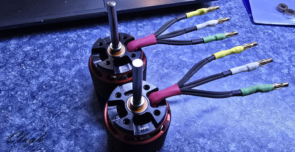

PYRO 650 – 65 (für 7S / 8S Setup)
PYRO 700 – 52 (für 10S)
PYRO 700 – 45 (für 12S)
Größere Motoren machen bei diesem leichten Hubschrauber keinen Sinn und es besteht die Gefahr, dass der Freilauf an seine Grenzen kommt.
Deshalb empfehlen wir als Maximalmotorisierung den Pyro 700-Competition.
Sie sehen also, es ist egal, was Sie dazu zu sagen haben, die Entscheidung wurde für die meisten Helikopterpiloten bereits von Jan getroffen, und insbesondere mein Pilot möchte, dass ich es mit einem P600 zum Laufen bringe, also müssen Sie sich in Bayern um Ihre eigenen Angelegenheiten kümmern, Baba …
Du kannst den ganzen Tag hassen, Liebling. Das ist es, was da drin passiert... Du kannst mit Albert darüber reden. Für den Piloten hier bedeutet es nichts.

But first lets talk about the p650 in Alberts heli than can peak well over 5 Kw and only weighs 315 grams. Do you know realize with the additional weight saving from 480 gram LMT 41 my pilot could add another standard Futaba servo to control proportionately 2.5 ounces of my cryogenic cooling solution and its fully enclosed pressurized delivery that would take him well into the negative Celsius ranges and still weigh 100 grams less??? Albert Fruth has never met Hubert from America. Do you have any idea what that kind of cooling would do to extend its performance? Do you also know the windings and other things need to be secured with the right adhesive to avoid cryogenic shok and let go or shatter?
Albert can solicit my winding services any time....if he likes the 480 gram cots boat motor .
When I tell you I can deliver 75 ml and the remote control system and pressurized chamber for 77 grams. Ill let you type hype. But I can do it today and still weigh 100 grams less. This you see wasn't even a percent of the volume and duration of cooling I can bring out of 75 ml. It can reach much lower into the negative ranges of extreme cooling. The chopper wouldn't know it was even there compared to the 41 .
Albert Fruth can come see me for a power system commission where The person knows a sinus from a trap and which works best. He can also come here for a GaNfet based inverter that can learn his rotor load and optimize itself in a wind tunnel.
Learn to be honest and you might gain SOMEONES respect. You can also view you negative character in the response to nothing negative in questioning. You're just a little turd wurst that cannot help it.
The rest you just responded to remotely. No one has written or sent you a thing accept for here... so dont lie to the hobbyist.Now the most important question Its the same thing as the 20 pole. Does it run???

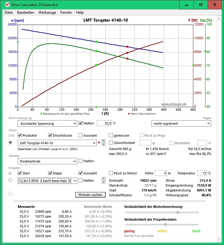

Then what are the recorded constants. No matter what's created those questions will always apply. After that is answered the forum can really get excited about it. Still photos are on thing but it must run and make good data to be truly considered an improvement.
Then put them into Holle's calculator.
To see if its really the bomb....
It looks to have promise although most Halbach arrays ive seen don't bring back the elevated performance you always hear about. Its a100% magnet coverage so it contradicts some of what you said earlier about the 20 pole.
