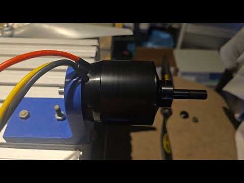

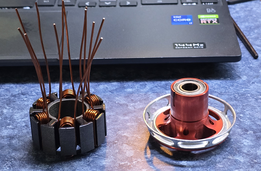

  • Click image for larger version  Name:	20250314_075658.png Views:	3 Size:	584.1 KB ID:	421788 Click image for larger version  Name:	Y-D to Conventional DL comparison. (1).png Views:	0 Size:	34.9 KB ID:	421789
    I already have a Scorpion HK 5020 here to wind conventionally.....

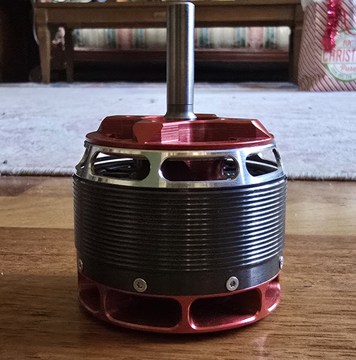

    • Click image for larger version  Name:	20250312_134614.png Views:	0 Size:	644.8 KB ID:	421817

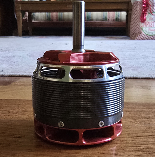

      • Click image for larger version  Name:	20250315_040412.png Views:	3 Size:	411.3 KB ID:	421856

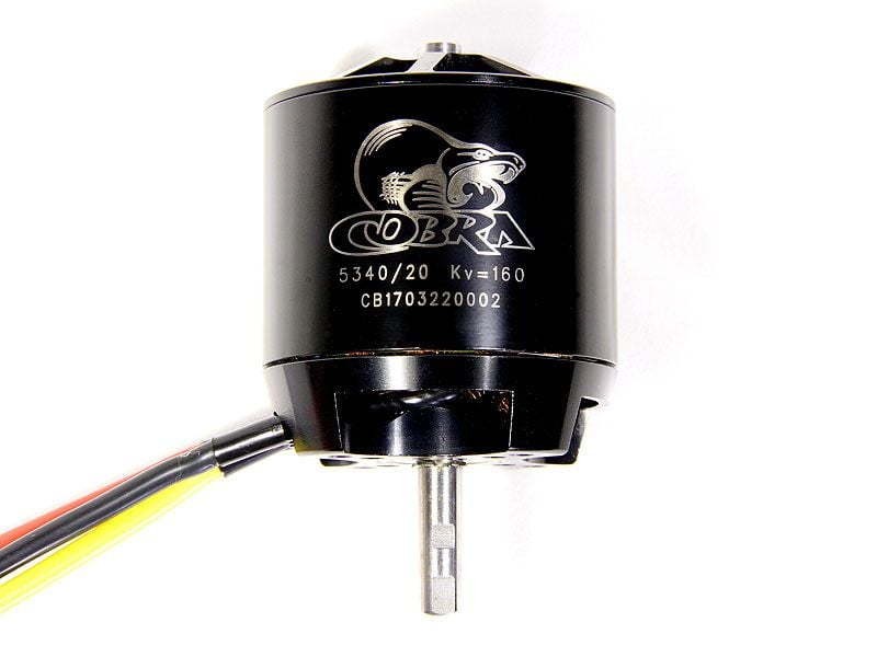

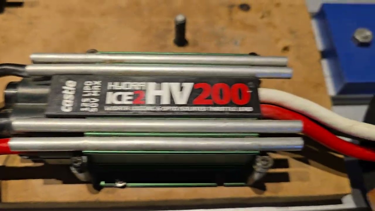

        Threw this up on the test stand just to see what she would deliver at 34 milliohms. So a DD would be 320 Kv . The Eta jumped 2% with a doubling of voltage. I can load it with a 22 x 20 CRP at 8s and 5342 idle speed and see what it pulls. I have the castle amperage limit set at 275 for now.
        Here are the constants:
        Cobra 5340 20T delta (160Kv)
        Kv 161 on the castle inverter @ 10 degrees timing.
        Rm 34 milliohms
        Io .83 @ 33.4 volts (5,342) rpm
        Eta Max 92%

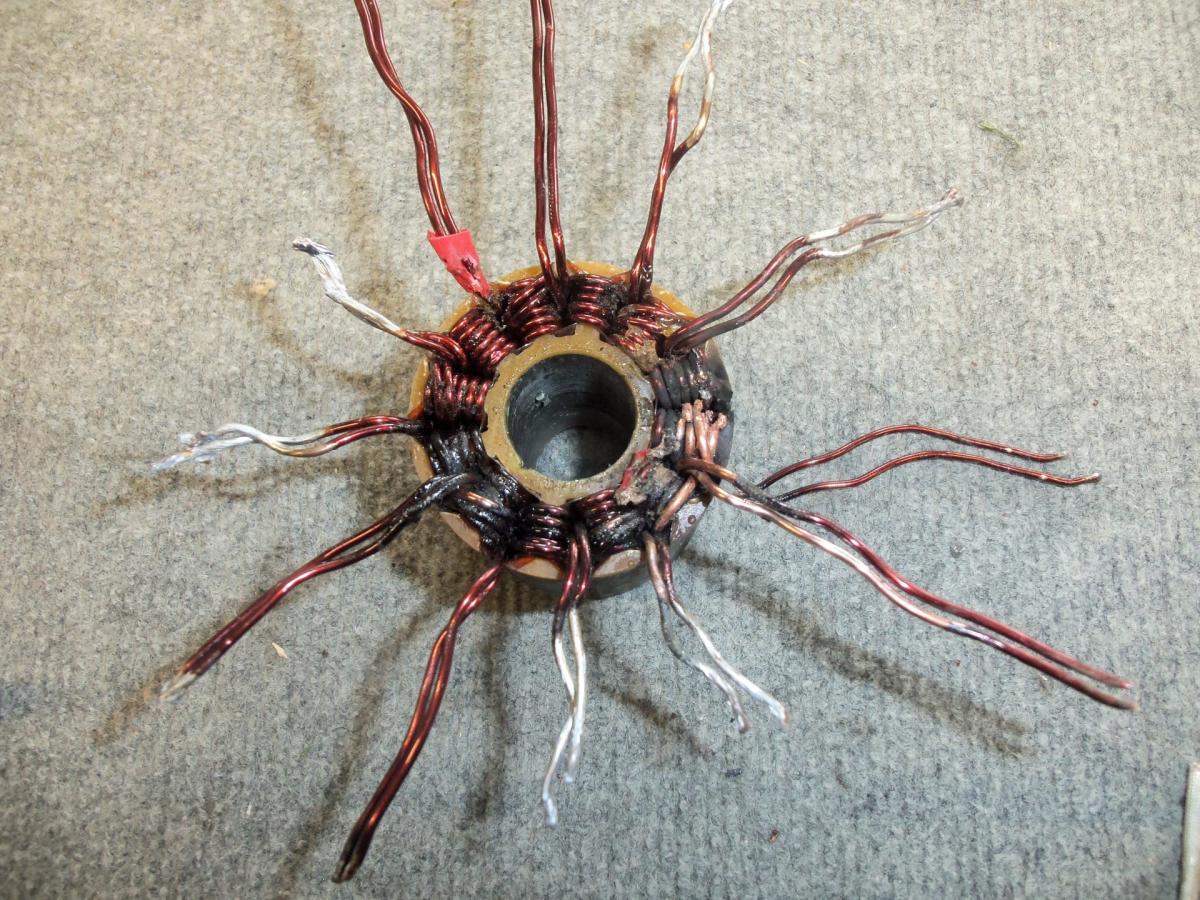

        • Click image for larger version  Name:	20250315_121830.png Views:	5 Size:	1.45 MB ID:	421869

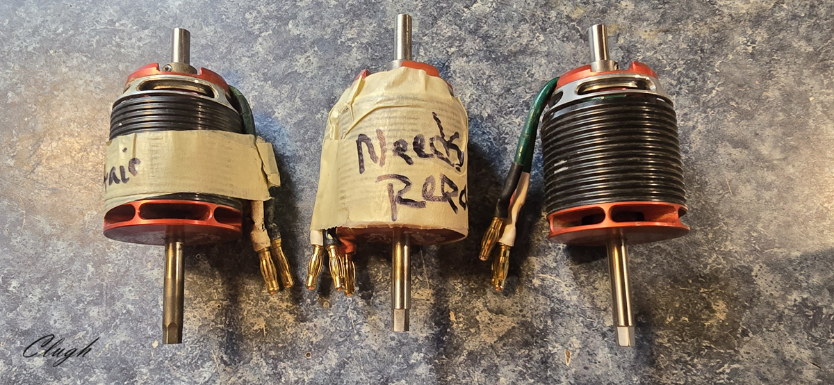

          I got him locked in boys . 3 power Dekker pyros came in for a refresh.......new F3A pilot... Ill do these after the two black comps for the choppers are ready.
          Don't hate.....

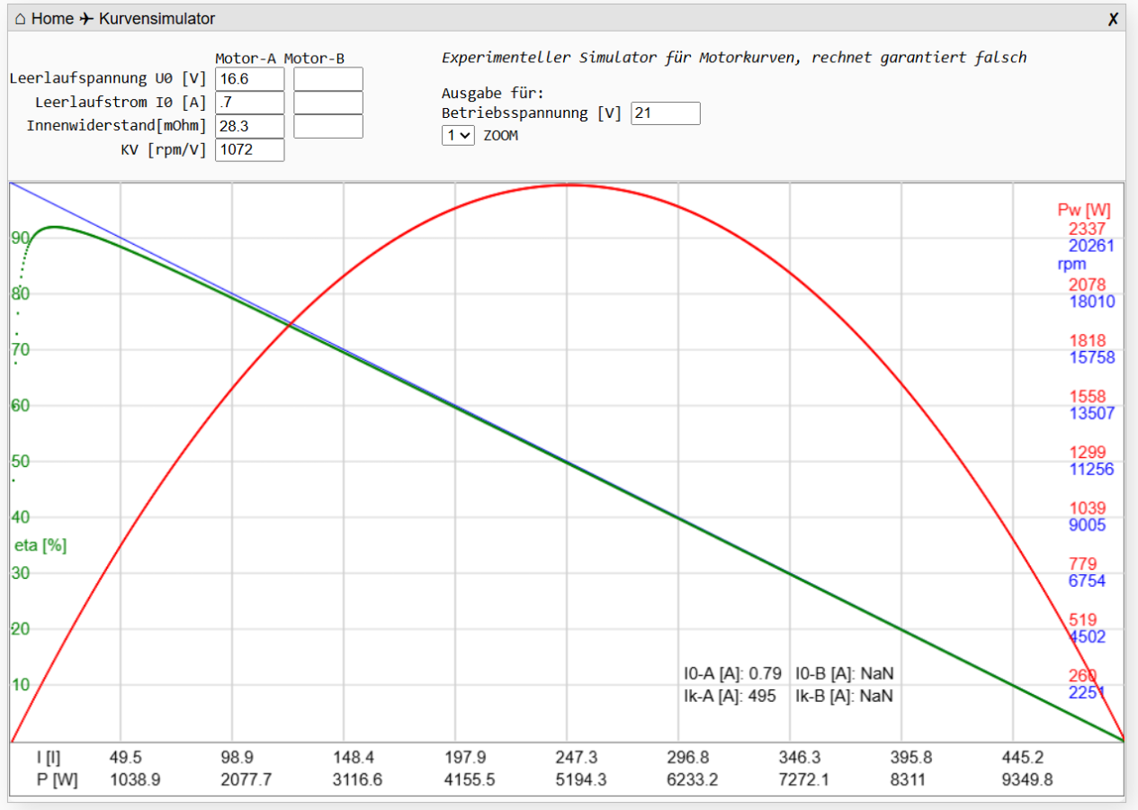

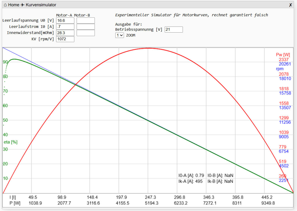

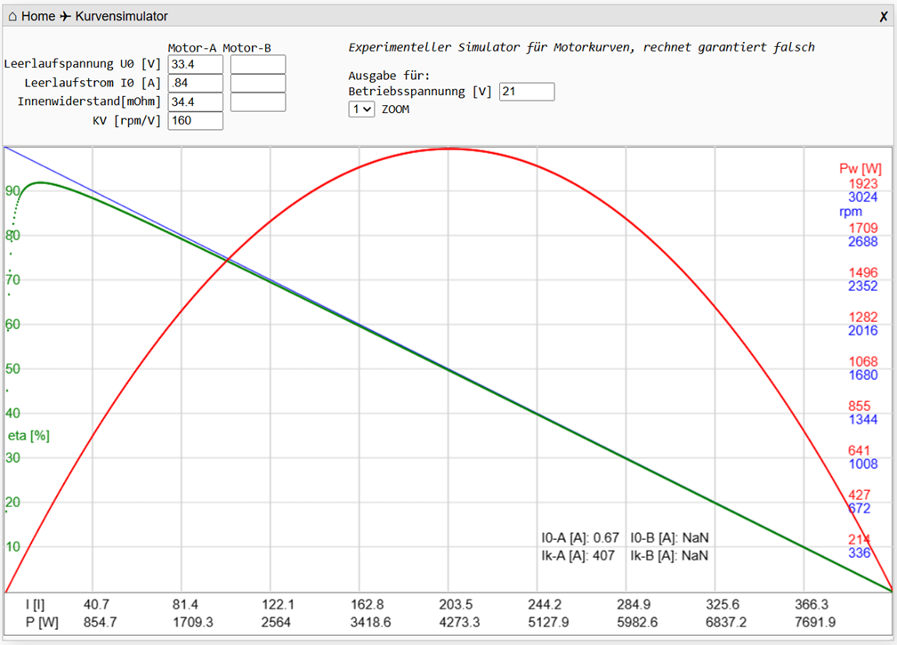

            Put the 4530 and all the other proposals into Holle's calculator from here.... You know where it is. You should use it to inform the forum of your true genius.
            Motorkurven www.lambertus.info

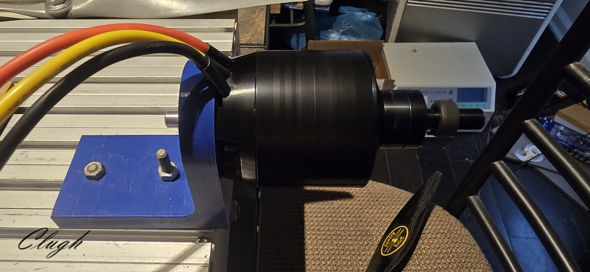

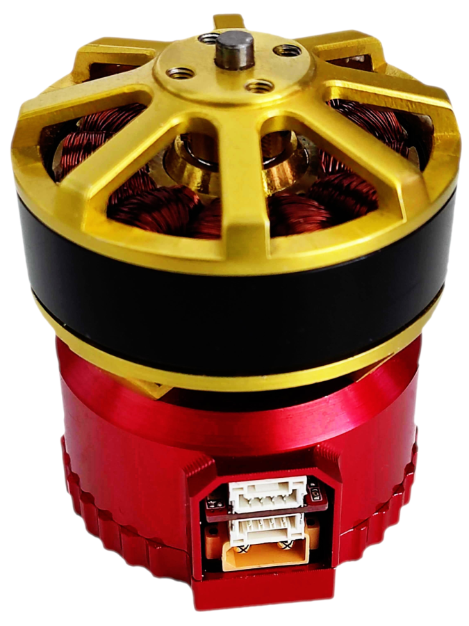

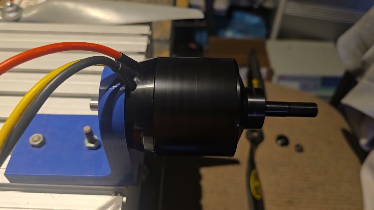

            • Click image for larger version  Name:	20250315_124238.png Views:	4 Size:	1.02 MB ID:	421887
              The big girl has alot of potential. Its mechanically one of the smoothest I've heard so far but the auto pwm castle doesn't select a high pwm because I can hear it. The sound is very similar to what you hear when as a VFD crackles when it starts and stops an IM . They say 16khz for used ears but a human with good ears should be able to pick up to 20khz. I estimate it must be between 8khz and 16Khz. because i can hear it. Its isn't a nasty sound at all but I can hear the switching. The motor Itself runs like a fine clock and is very easy to control. You can start it at a crawl. All motors do not come with that characteristic.. Its very responsive to the throttle.
              Ill have to print a reducer to fit the rear prop because the from prop bore is 8 mm and I wont drill and ream it out. Its a shame for me to be irritated about it because the ability for 3dp to deliver it now was supposed to be a bonus. We get spoiled and take for granted quickly the technology after 1 day, but I just wanted to mount the prop and get on with it.

                      About the engines.....
                      I should have posted that this Cobra 5340 would take a 10+10 DD for 320Kv . Its well built with 3 large bearings. The 8mm shaft should be more than enough support if it is built right. The rotor bell is balanced from the factory. The body has an incredible amount of room for different winding configurations, tall heads, etc. Its 14 poles so the price is excellent compares to 1 off bodies in time an effort. I could just work with the core. You see it has incredible axial cooling. If i can turn a very high pitch around 16,000 rpm on 16s maybe it could compete it can fit a 64mm spinner. It doesn't have to be a folder because Talega can stop the prop on horizontal in you are into fast "gliders" with no landing gear.
                      I know my way very well around the machine shop but not just as an operator and programmer of CNC and Manual equipment. When you truly learn the trade from the formal side you about learn about shop cost and management. There is no point to subcontract this or build these things myself outside of contracting it with a company like Cobra. by just buying it. Itz a simple decision simple because the price is right and the quality and room is there for optimization . if there was a market like speed planes I only need to optimze a 100 of them to capture the market. if they are good I wont see them for a long time or ever again. Thats the money grab for a market like that and you move on. You wont make 100,000 because you have to at least buy the 100 motors and upgraded stacks and wire. Alpha iron is a great soilid core idea because i can get it cheap. I do not think I can cut it with an edm because it int conductive which is an excellent property for a motor core if that's indeed the case. It has a fully ferritic matrix and definitely has the Mu of silicon steel. The fact that it is non conductive with very low coercivity is a major plus. If I can re anneal it in hydrogen it becomes incredible. Go look at the matrix of CoFe and you may begin to understand the similarities.
                      I like the Cobra alot . Smooth running. Ill have to add video so the boys can hear it.

                        • Motorkurven www.lambertus.info
                          Set the standard..... we need a reference Scorpion machine for direct comparisons to what we are doing here in the USA
                          In the videos the io is recorded idiot.
                          The exact plot for the 1000 watt test wind. and this recorded data set remember this was wound with 22 awg...28 milliohms
                          So you see Dr Okon doesn't know what the hell he is talking about. This little test wire at 1000 wats is as efficient as him and his spaghetti mono stranding.

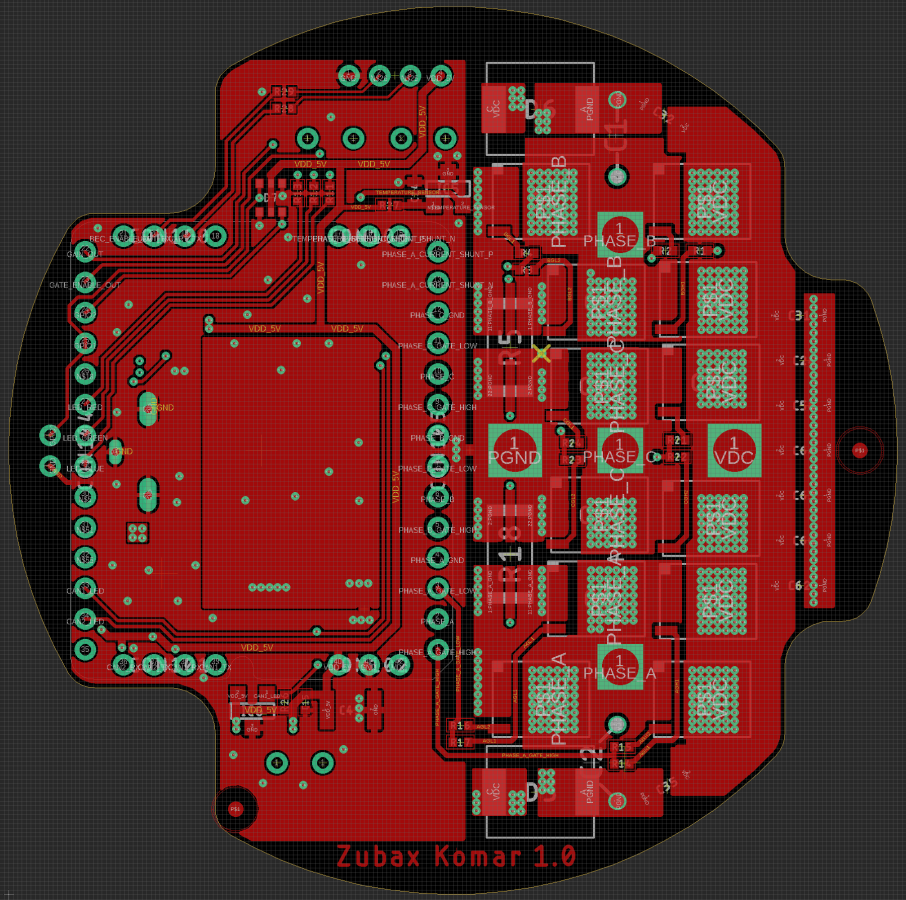

                              • State-of-the-art PMSM/BLDC motor control solution for aerospace applications and robotics - Télega - Zubax Robotics
