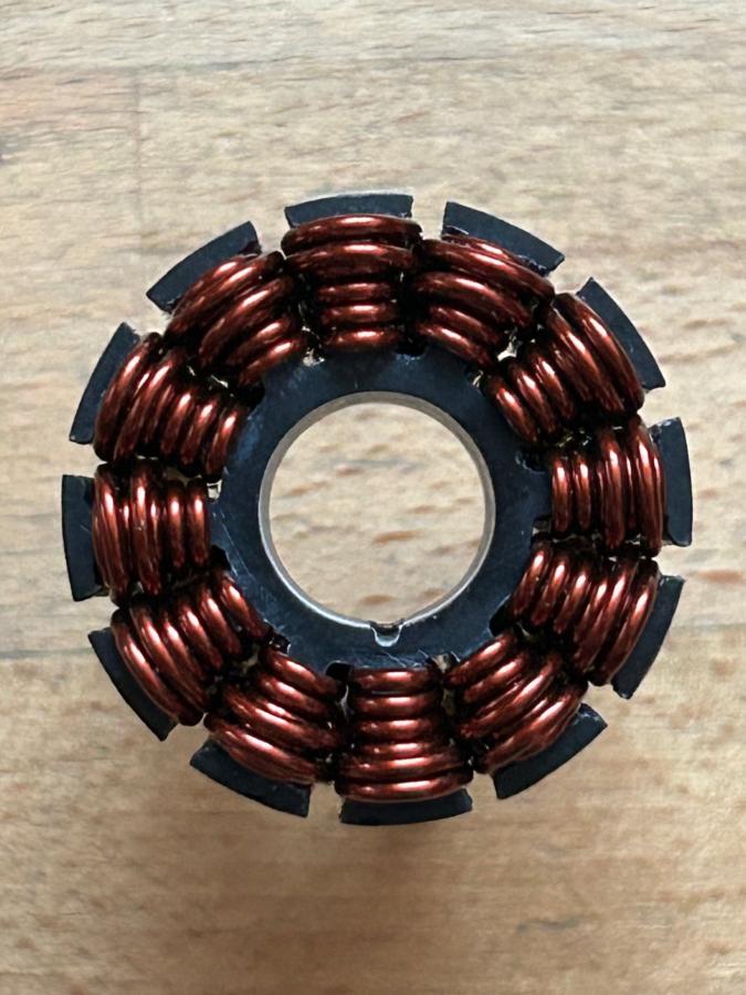

                    Click image for larger version  Name:	image.png Views:	0 Size:	6.7 KB ID:	421477
                    Hi Ralph,
                    I also don't see it this way. He did not start that.....
                    Hubert​

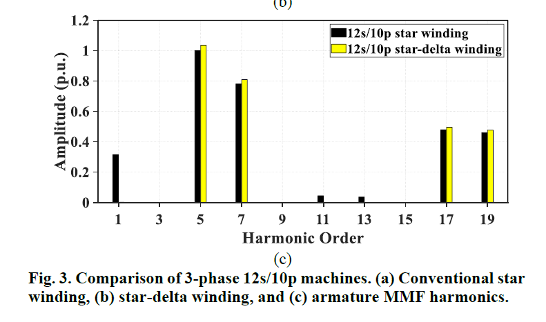

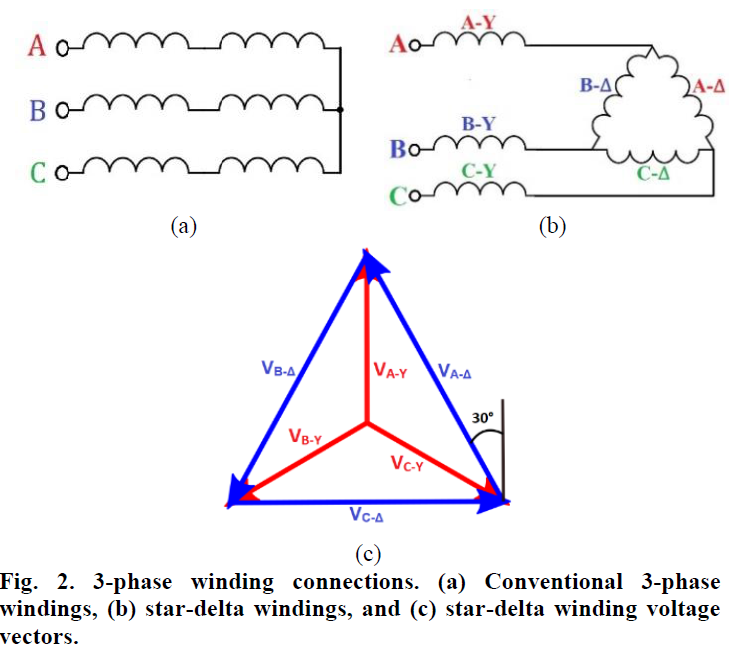

                            Click image for larger version  Name:	fetch?id=421471.png Views:	0 Size:	706.6 KB ID:	421495
                            A. Star-Delta Connected Windings
                            The inherent phase shift between the star and delta coil currents can be used to eliminate the unwanted first subspace harmonic. To exploit this property, the ends of the star windings are connected to the junctions of the delta windings and the difference between a conventional star winding and the star-delta winding can be seen in Fig. 2(a) and Fig. 2(b). The voltage phasors for the star and delta winding sets can be seen in Fig. 2(c), demonstrating the 30 elec. deg. phase shift that exists between the two windings.
                            It has been demonstrated in literature that this phase shift can be applied to a 12s/10p FSCW machine to eliminate the 1st subspace harmonic while increasing the amplitude of the working (5th) harmonic by 3.5% [11]. In this paper both IPM and SPM machines are investigated, but emphasis on the IPM machine is used in the equation derivations as the influence of rotor saliency on star-delta coil mutual inductance is more significant. The example IPM star-delta machine, as well as the harmonic spectra of the winding MMF, can be seen in Fig. 3 with machine specifications given in TABLE I. The combination of eliminated 1st subspace harmonic and increase of 3.5% in the amplitude of the 5th leads to a reduction in rotor losses and improved torque performance. However, the added complexity of the winding arrangement requires reconsideration of the inductances if the machines is to be controlled in the dq-frame.​
                            "The dq-transformation [19] is fundamental to many modern control methodologies including field-oriented control [20] and sensorless control [21, 22]. Although star-delta winding structures possess many advantages such as reduced harmonics and losses, it is difficult to get the dq-axis parameters such as Ld and Lq needed for these control schemes. This will be the main focus of this paper."
                            [19] R. H. Park, "Two-reaction theory of synchronous machines generalized method of analysis-part i," Transactions of the American Institute of Electrical Engineers, vol. 48, no. 3, pp. 716-727, July 1929.
                            [20] R. Gabriel, W. Leonhard, and C. J. Nordby, "Field-oriented control of a standard ac motor using microprocessors," IEEE Trans. Ind Appl, vol. IA-16, no. 2, pp. 186-192, Mar. 1980.
                            [21] R. Wu and G. R. Slemon, "A permanent magnet motor drive without a shaft sensor," IEEE Trans. Ind Appl, vol. 27, no. 5, pp. 1005-1011, Jan. 1991.
                            [22] Z. Chen, M. Tomita, S. Doki, and S. Okuma, "An extended electromotive force model for sensorless control of interior permanent-magnet synchronous motors," IEEE Trans. Ind. Electron., vol. 50, no. 2, pp. 288-295, Apr. 2003.​
                            When I tell you THEY don't know anything but the basics about FOC communication I'm being honest. The boys don't even measure their inductances so they pay things like this absolutely zero mind .... alot of times forums and their members are just full of technical nonsense.
                            Talking about FOC inverters and don't even know how to set one up properly for max torque delivery from the get go....
                            All the nonsense makes me laugh to be quite honest. Because what I'm bringing you is the reality from the best in the field of Electrical Engineering.

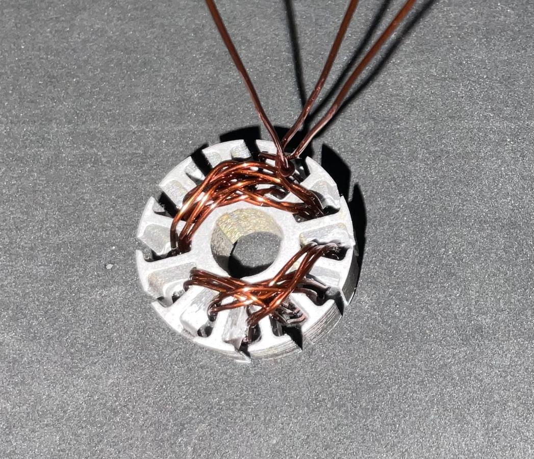

                                Click image for larger version  Name:	image.png Views:	0 Size:	62.2 KB ID:	421501+1​
                                How could I take any person seriously as a drive and motor design authority to help the forums but they never once talked about the saliency ratios of these machines?
                                The star to delta winding improves the saliency ratios of IPM machines and SPM machines. You have to ask the motorFuhrer for e-traction why would you go back to a distributed winding as old as the late Alois Hiedler with 20 poles when it is already known in industry the significant advantages and torque performance a fractionally slotted concentrated wind has over a traditional integer-slot distributed winding. The only real disadvantage the concentrated wind has is the large space harmonics in the armature windings that lead to increased torque ripple rotor loss and PM eddy current loss. The PM loss at heavy load is of particular interest to a speed plane pilot who operates in these high loading areas where the increased eddy current loss creates excessive heating in the magnets and they become damaged with irreversible demagnetization. Up until that point you will lose efficiency, pullout torque, and lower desynchronization amperage point. To mitigate it and increase the torque output at the same time with simply a concentrated winding amendment is outstanding.
                                They should be thankful for the tangible offering in a hobby machine. That's equally outstanding and why both individuals point out to one another in Germany that they attend class here in the USA on our forum. They couldn't get a tangible offering on their own forum in 5 years for whatever reasons. But we are not segregated here. So they come in and learn. It's funny because part of what they fell out about is sharing information with US meaning you Americans & ME!!!
                                So make sure you're aligned correctly! And that you are clear I was never alone or talking to myself anytime anywhere on a forum. They always been there. One says no one knows me and the other claimed they didn't know if I wind motors but they both say my name repeatedly on a forum IM NOT on once a week 7,882 Km away.
                                Every speed pilot that reads them knows me. They need to keep it real with themselves. I show them ALOT!
                                What we wanna know is does the 20 pole run in either sector of Germany? Dresden or Bayern!
                                Where is the data????
                                :see_no_evil:

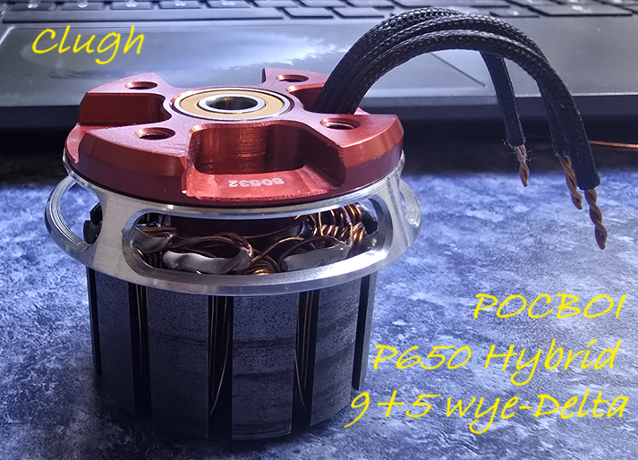

                                          If all you care about is YOUR own application why were you in here running your mouth?
                                          Why change? a wye and delta combo. - HeliFreak
                                          So I'm not trying to hear that noise :hear_no_evil:
                                          Now that the hybrid is on your doorstep looking for a challenge from your wye wye you say shows no improvement. Your superior asses cannot cash the checks your mouths write.
                                          Run the motor bruh! I want to see it like I showed you the hybrid.
                                          Idle current?
                                          Kv?
                                          Io ?
                                          Rm?
