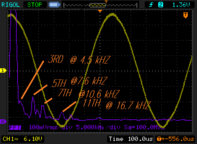

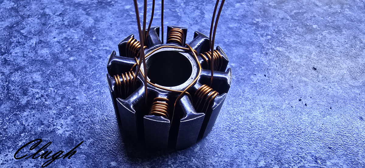

      • `BipolarClick image for larger version  Name:	image.png Views:	0 Size:	246.6 KB ID:	420755​Now I need to be quiet because I'm saying too much and do not know what I'm talking about. And then of course Ralph (powercroco) aka BOHO1 has told his friends he is not on this site in the first place and has been here since the very 1st day I signed up.
        • The "Teacher" Hubert is curious about the 41's stator surface compared to his pupils HK5 4035 @ 7.2-8.2kW ..... Click image for larger version  Name:	stir.gif Views:	0 Size:	1.3 KB ID:	420758

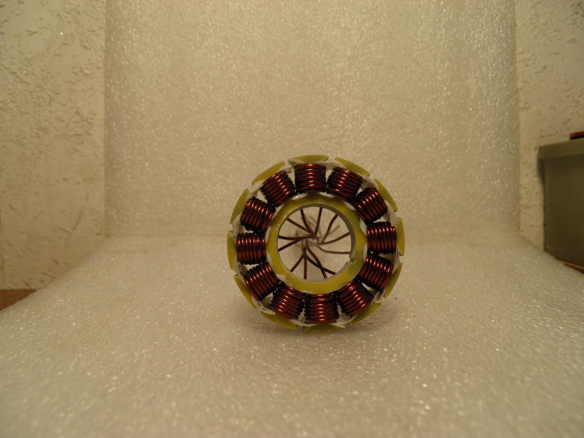

          • Nice coils Ralph
            Alot of turns make a nice inductor. I see no one wants to calculate the new 4035..

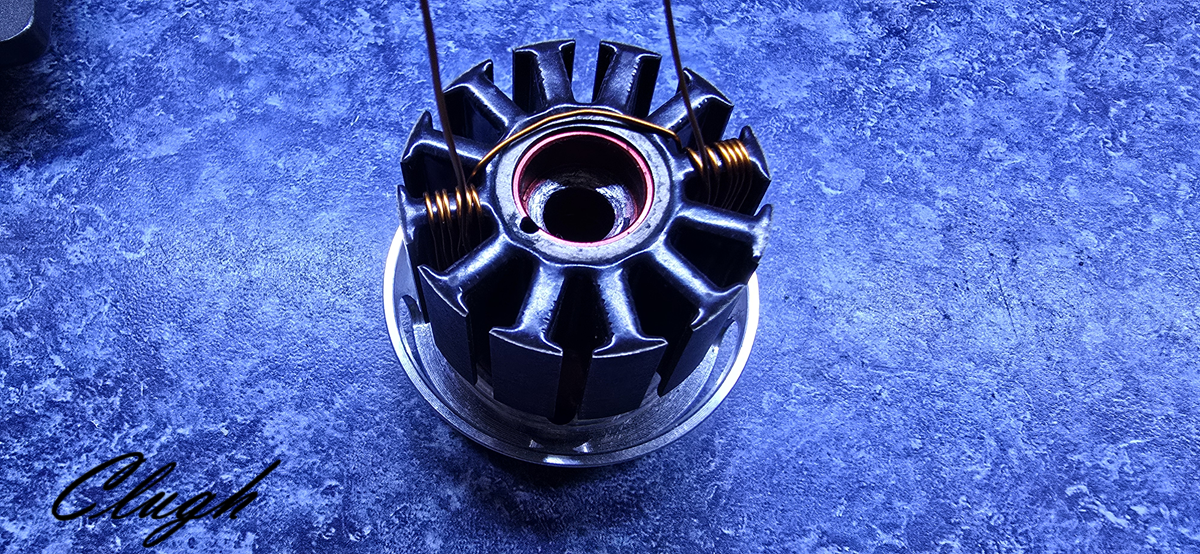

            Hi Christian is there a complete 12n20P winding and it running in a video ? what inverter did you use and at what voltage. What is the Kv. How much copper is in the slot?Do I believe it is better unless I see some data from it other than the voltage it generates compared to another set of coils wound differently? You ask me alot of irrelevant question of but when did this 20 pole hit the market and win world championships? Do you have any data lo gs of it running a load?
            Is there any FFT capture verifying it is indeed harmonically clean on the outrunner format? Does the pocket scope not have that abiility?
            Do i get more fallacy for these question and you unwilling to produce a BEMF FFT harmonic capture of the 20 pole or 10 pole wundermotor? Can I see it run? What I would need is a complete wind running with fft capture and constants recorded here. Until then I cant even feed anything into a calculator for modeling so it means zero to me. I'm sure test already confirmed a million years ago. The winding certainly isn't new and a tool like DrDaoud Ouamara​'s Anfractus can show you every possible wind that will generate torque on specific geometry. It uses matrices to find them, Right an exact with mathematics. The Dr holds a PHD in electrical engineering. 😁
            Lets see it run child prodigy and record some constants from it. So we can make some relevant calculations about its performance as compared to something else. One of my hybrids perhaps. Through all fallacy I will continue to ask for the relevant information pertaining to the subject matter!!! When you leave some relevant running data about it then you can make a valid comparison to something that i have done here.
            I have a high end scrap box with some specialized equipment and power system configurations.....if you all would like to start comparing numbers again.

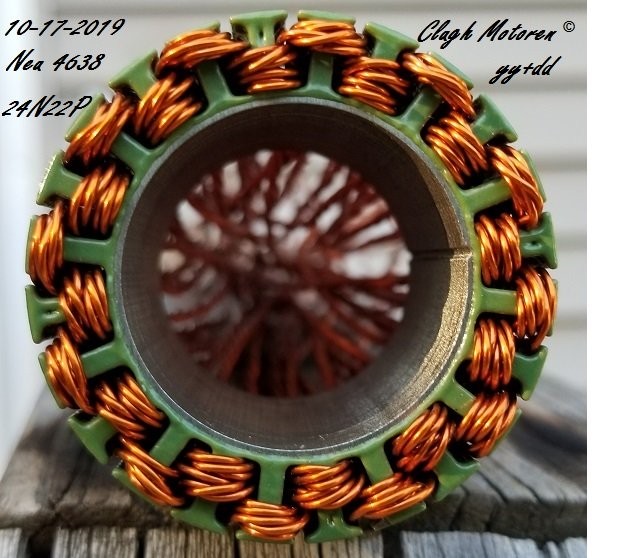

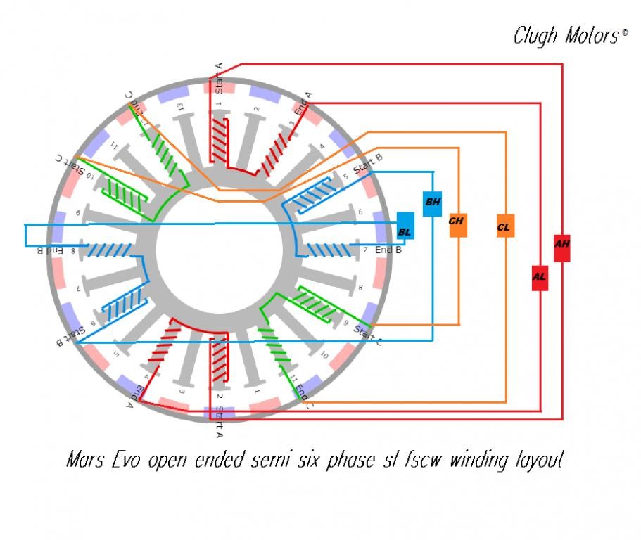

                    • Click image for larger version  Name:	Assymetric winding scheme for 24N22P.png Views:	0 Size:	84.9 KB ID:	420794
                      Asymmetrical 22N22P open end winding You need a 6 channel bridge to run her. Very clean harmonically excellent traction.
                      Pavel tells me if I build the bridges Talega can control it very well.The original work Is based on space vector control and that's what Talega is. Some of the most sophisticated in the world.
                      Click image for larger version  Name:	cascaded full bridge for semi 12 phase.png Views:	0 Size:	32.1 KB ID:	420795

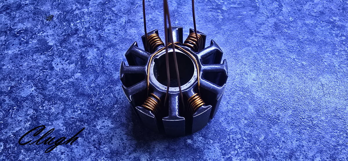

                      • You can wind a 4 layer12N10P and dual invert it the same way. You Strap the open ended coils across a high side and low side 3 phase inverter that's why I call it semi six phase. It makes more power because at least 4 phases are active at any time versus just two It also protect the rotor.

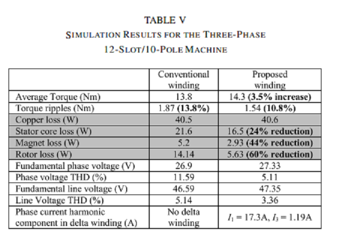

                        • The winds ratio is delta turns = wye turns(√3)
                          Do a 4 turn wye outer and a 7 turn delta inner and you test it against a 11 turn wye or what ever wye brings you the same Kv and see what you get in constants.
                          Then test the fallacy and epithet for its effectiveness as an alternative motor winding or drive scheme. The very topic of this thread .

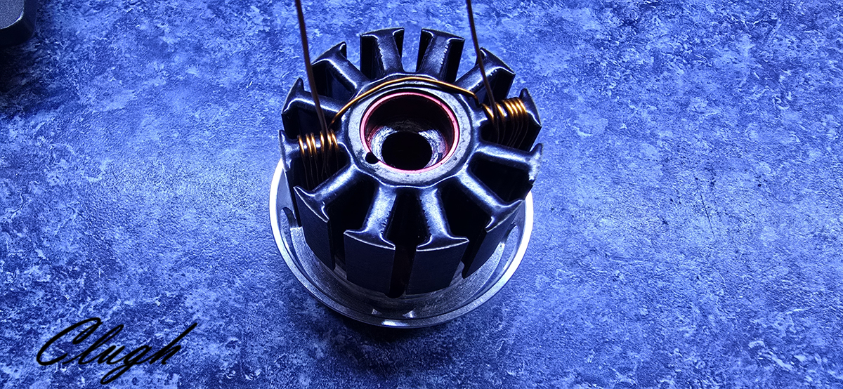

                          • Test winds take no time. 1 delta phase of the sl 7 turn delta is complete in 3 min. Ill test it on a pyro. Why does it take experts 4 years with still no results?
                            • Danke
                              • Delta is done. Now the 4 turn outer wye.

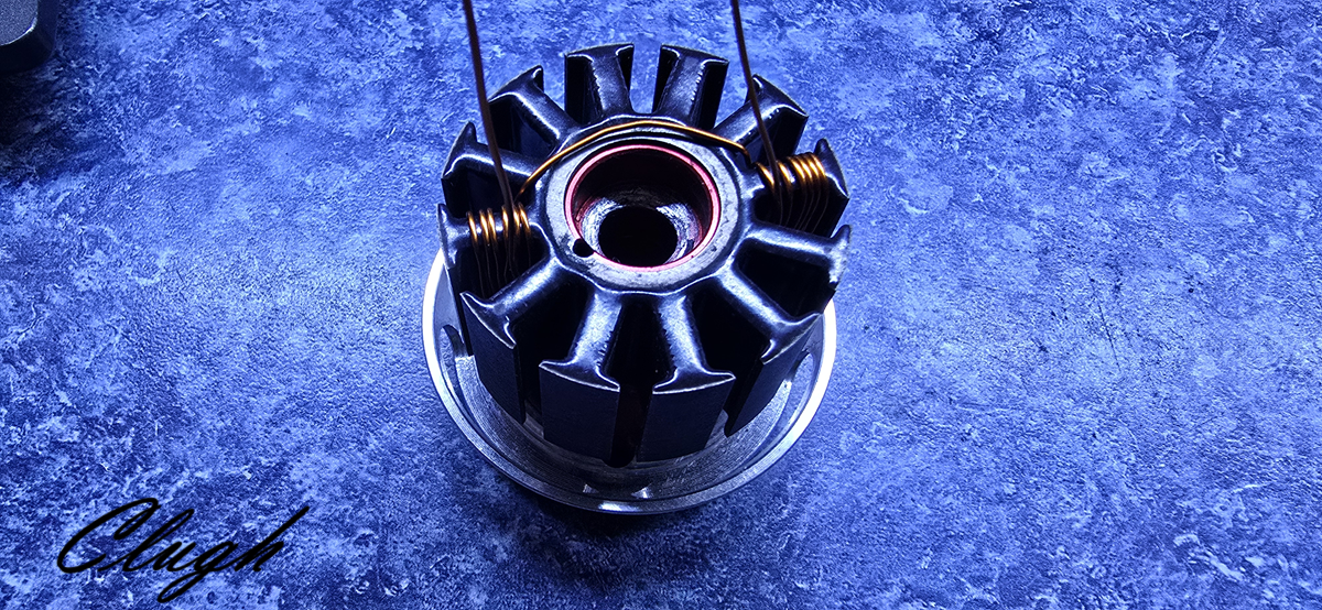

                                  • Long live the junk box!
                                    In my opinion, this combination has never been shown in public before.
                                    A stator wound for 12N4P and a 20P bell to go with it.
                                    Together 12N20P 4535. So not on a 4225 basis as suspected above.
                                    The magnets are 7.2mm wide, so they most likely come from the HK 4035 V1.
                                    Because of the magnets, the bell from the production of Stefan Vielsack, the stator carrier from Stefan Baier and the black painted scorpion stator package with the black insulating discs and white paper inlets, I think that the stuff should be from about 2011-2013.
                                    As suspected, the CL had already been kicked out of the PCF.
                                    So he probably had this idea himself in his thread and not just assimilated it.
                                    Winding seems to be a 5x1.0.
                                    If this is to run again, it will probably have to be renewed, but then with the current Kapton slot inserts.
                                    Let's see if and when I can and want to pull myself together.
                                    In the same (scrap) box you found btw. also some 24N 42 stator packages from Skorpion.
                                    ~powercrco~​
