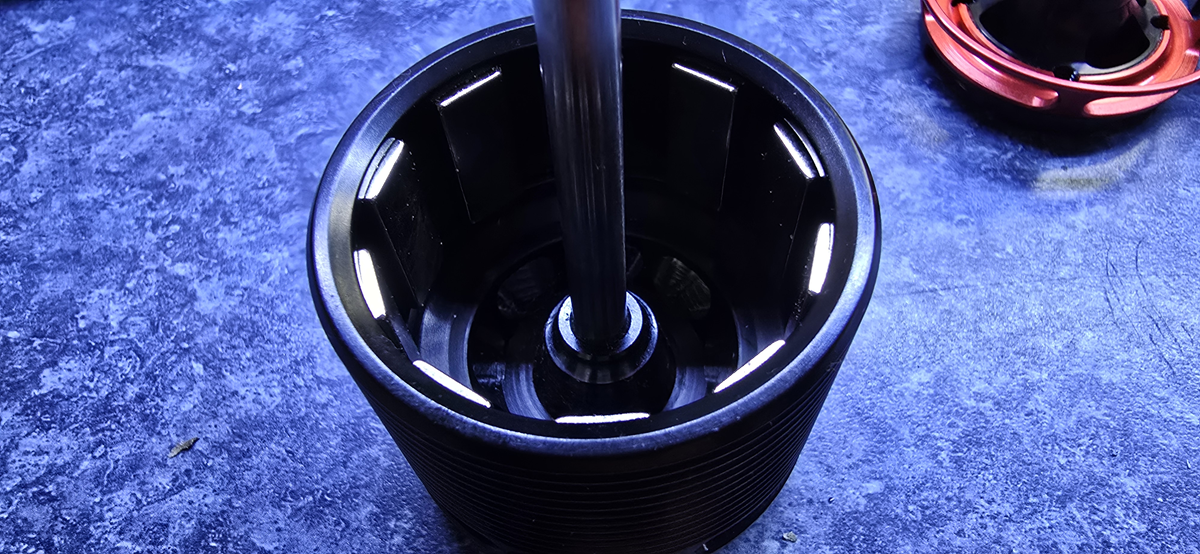

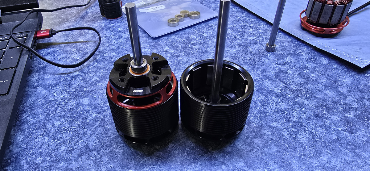

              • The shafts are in. The motor on the right is newer with the corrosion resistive plating on the pm

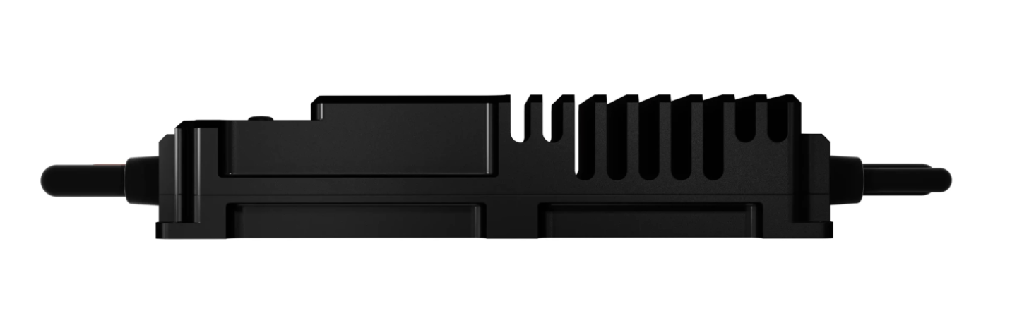

                • Click image for larger version  Name:	image.png Views:	0 Size:	251.8 KB ID:	420610

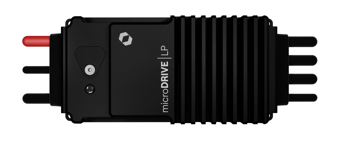

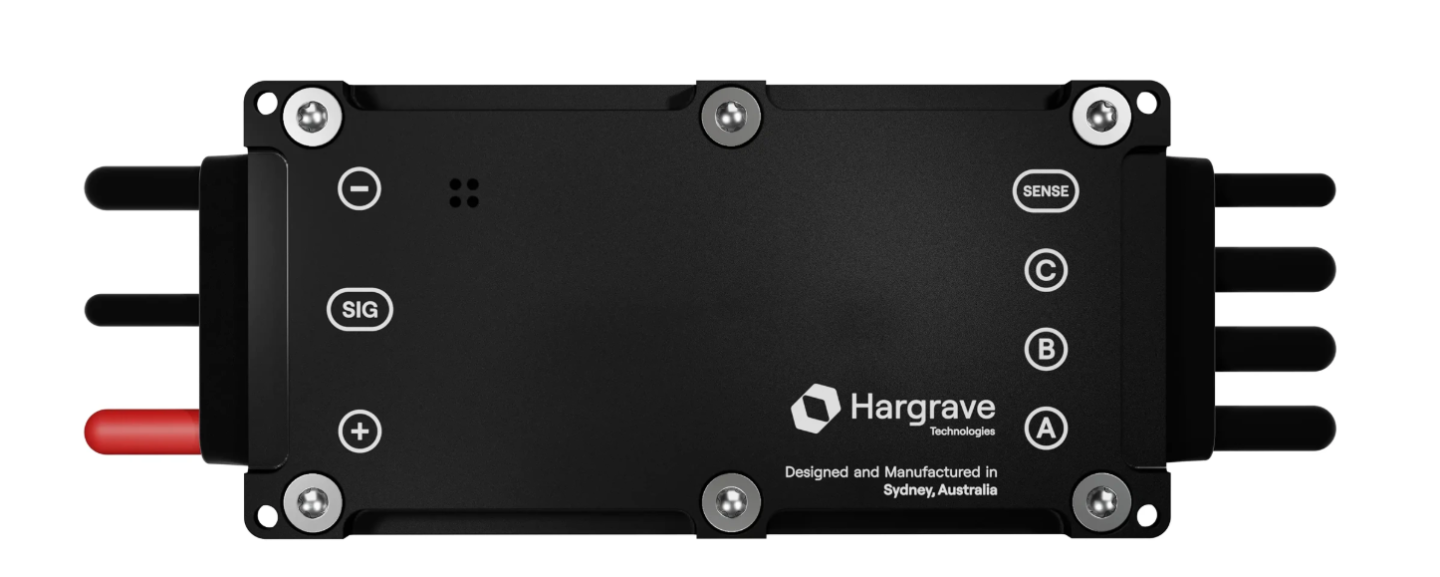

                  BTW if you see 5% of you bus voltage in ripple in a log add capacitance. The 14S Microdrive LP from Hargrave has a pwm range of 4khz to 64khz In The commutation schemes are FOCAL and Trapezoidal. To give you an idea of the computing power needed for each style. Trapezoidal commutation it can do half a million e revolutions. In the dithered FOCAL it limited to 200,000 e revolution. That almost double the processing speed FOCAL eats.
                  This is a very nice inverter. When the 120V 400 amp version drops that will be special. I know it wont be cheap. It has propeller parking so you can use non folders and not break them on a hot liner landing..
                  I've included the manual for downloading. Its a very informative manual with lots of useful calculations within its pages. It is a very good technical read for those that are interested. I suggest reading it if It were me but that's on you.
                  ​Thanks for your time and patience

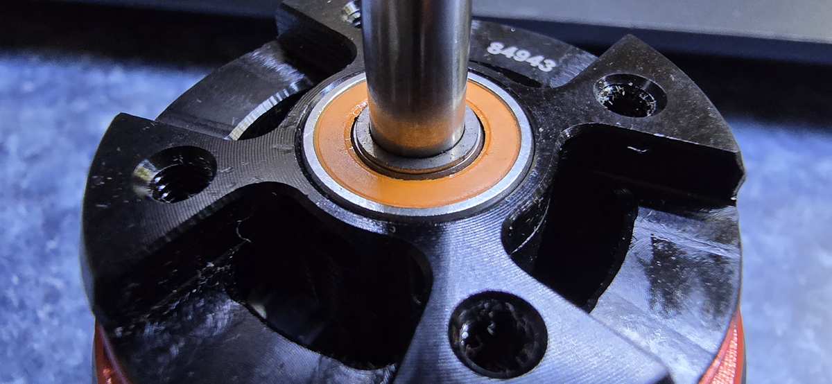

                            We do things a little differently here besides just wrap the wire and a photo doesn't show you all the small detail's unless it is intentional. You can see here in the close up photo, in a fine selection of German materials that the shims they use are inexact stampings that are larger in od than the bearing inner races. The ceramic hybrids use a non contact seal. That only means that it is not touching the inner race. So besides obviously being unbalanced these large od shims drag on the non contact seals and rob precious rpm and drive up idle currents. What I do here in the USA is replace them with precision 6mm id shims (on the left in the photo) that have an od that is slightly less than the bearings inner race od's. This ensures everything thing is axially supported on the inner races only with no additional drag. The shims are 500 microns thick so you can stack them if you need to . It's really none of a competitive winders business these small tricks I'm showing but the competitive "Leaders" are camped here & sucking up everything I show US boys anyway. .

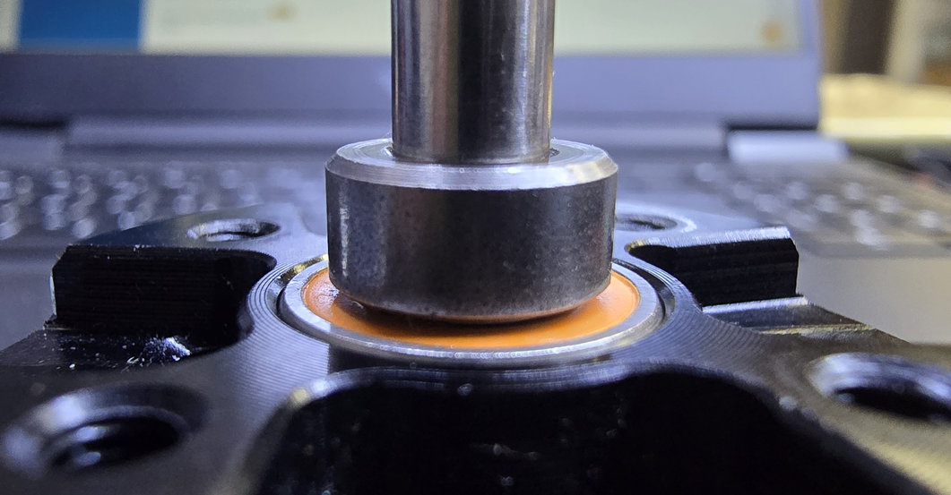

                              I use three ABEC 7 orange seal ceramic hybrids from a for each motor on a full rebuild for pilots which includes a thermally coupled winding. For gearboxes I use a long hardened center shim that ties all three of the bearings together axially. For 45 additional dollars the bearings can get Ultra hard dry lubrication . It will extend the life and load capability significantly but, it isn't a must, just an additional option for the most advanced azz wipe! 😂
                              Sometimes a photo is worth a 1000 words. You can also test it for yourself then you will see that it works!

                              • Its not pictured in this close up of the comp pyro 650 rotor with clean plated pm, but I use a precision shim here on the shaft boss, where it rides on the single end bearing.

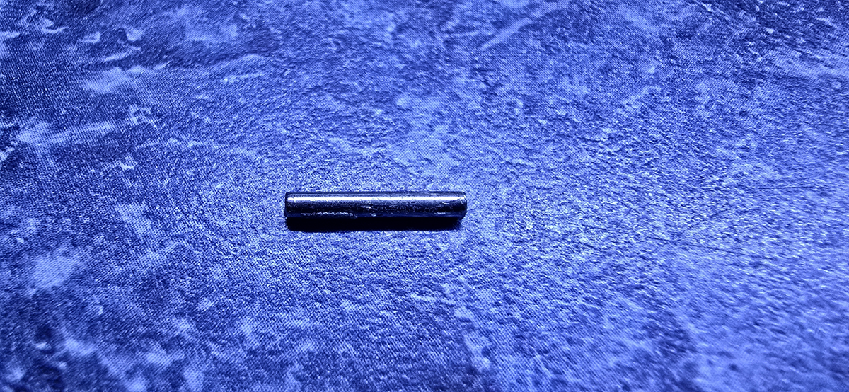

                                  The stators are ready for AWG!. The wire came off clean. The newest motors use a dowel pin to lock the stator. I replace all of them with a 2mm cap head machine screw. I'm a master manipulator in this case...😁I purposely use embedded Thumbnails that will make a jealous sucker sign up and sign in just to see...That's how you track an op and his movements....
                                  Thanks for your subscription!

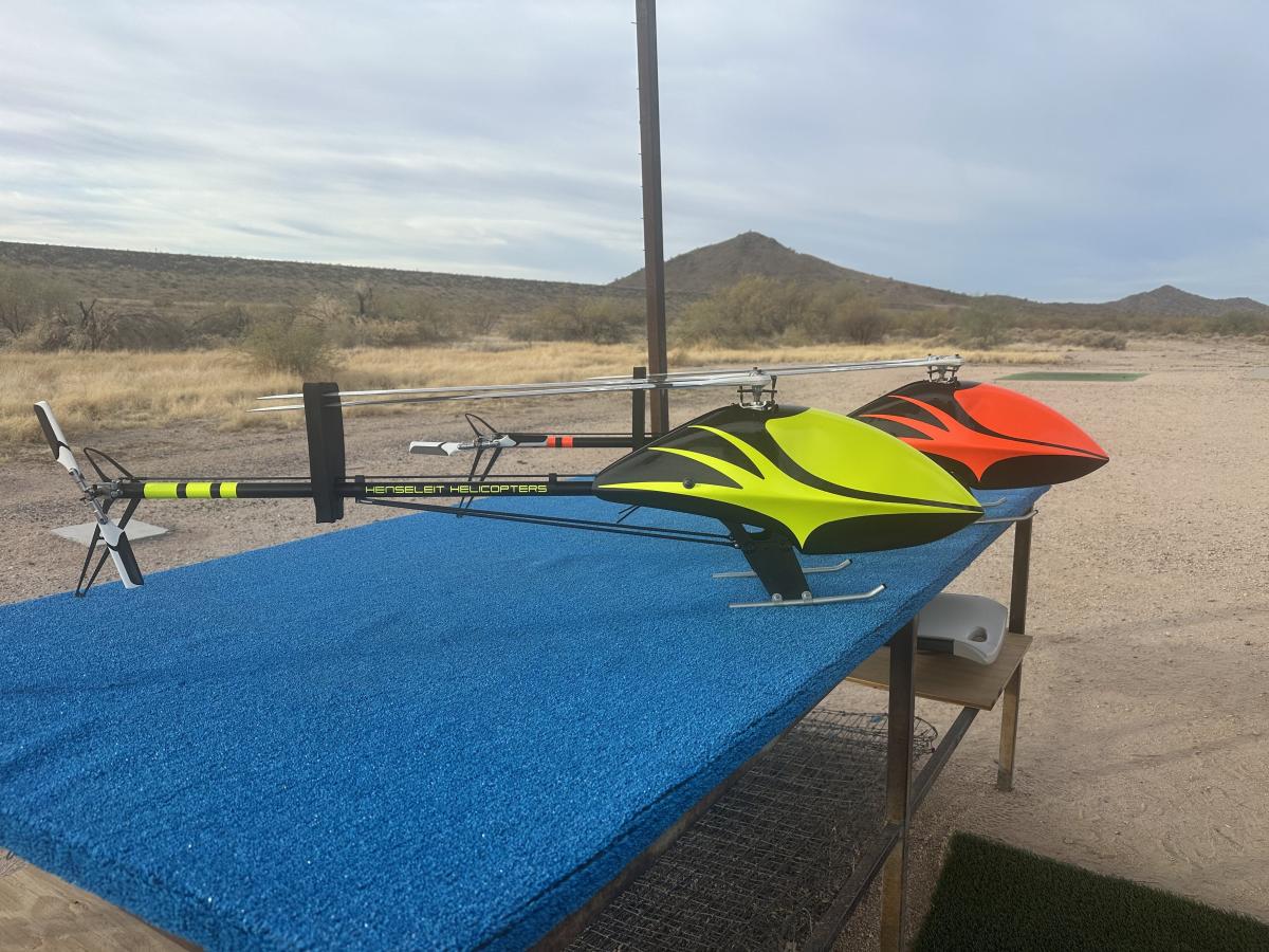

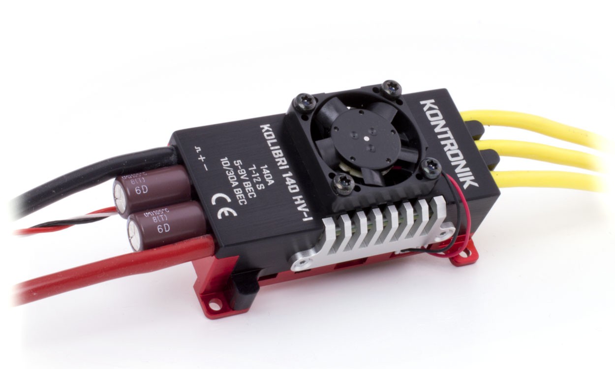

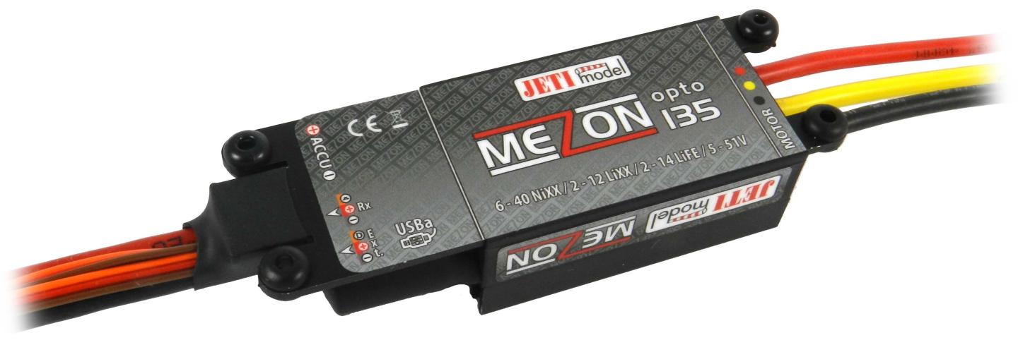

                                  • The Henseleit TDR Pilot has 2 and is using a 140 Kontronic Kolibri in each one. But I suggested in the future he take a look at the 135 Jeti Mezon because the on resistance of just a 120 is so low. I have to test one of these no doubt! I can not ignore the reported on resistance in the ecalc database. It is significantly lower than the Kolibri and many others...
                                    We are rewinding these to hopefully exceed Pyro P650-78's Competition specifications
                                    Thanks for your time and patience.

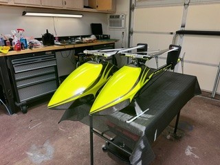

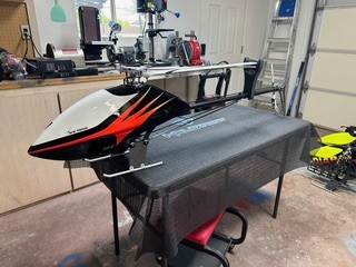

                                    • Here a few pictures of the Henseleit TDR's
