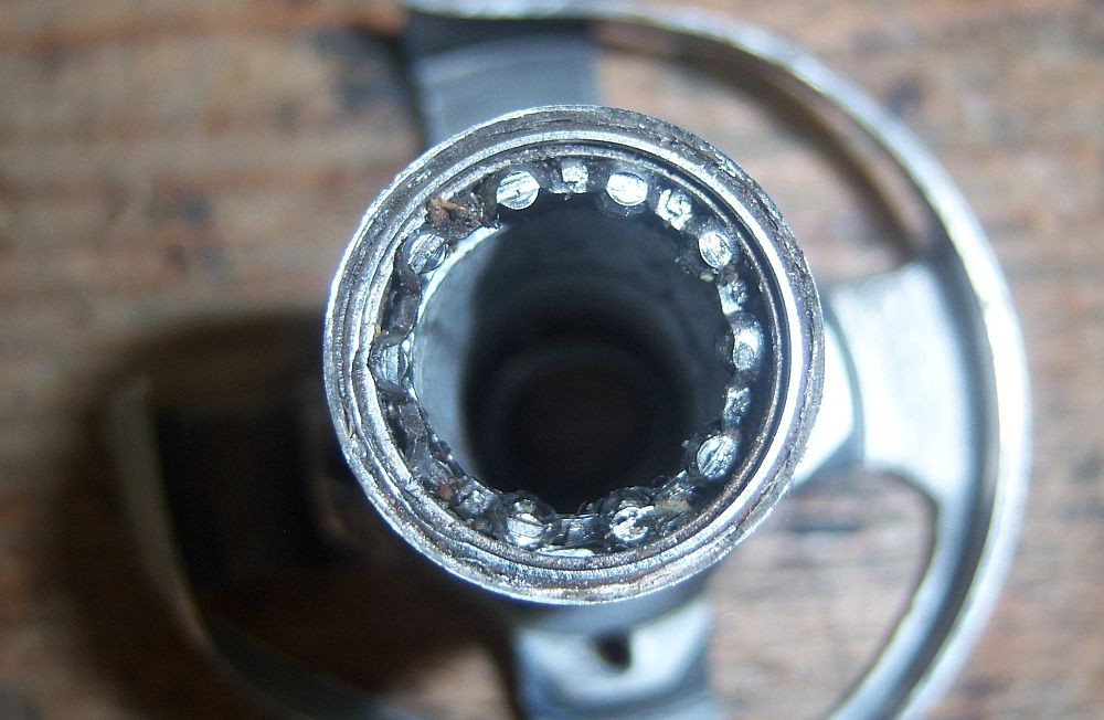

          Click image for larger version  Name:	lager-jpg.12732166.jpg Views:	3 Size:	124.0 KB ID:	405784
          Sieht das für dich aus wie Keramik oder SiC, du Idiot? Du bist langsam. Du solltest wirklich aufhören, vor deinen Freunden dein Gesicht wahren zu wollen. Du machst dich lächerlich. Danke für das Posten des Fotos, das bestätigt, dass du keine Ahnung hast, wovon du redest. Das ist auch kein normaler Betrieb. Einfach nur dummer Scheiß von dir. Ich weiß nicht, warum Christian dachte, er könne mit so einer Inkompetenz arbeiten. Verdammt, du bist wirklich maßlos eingeschränkt.​
          Siehst du Deutschland, er weiß wirklich nichts

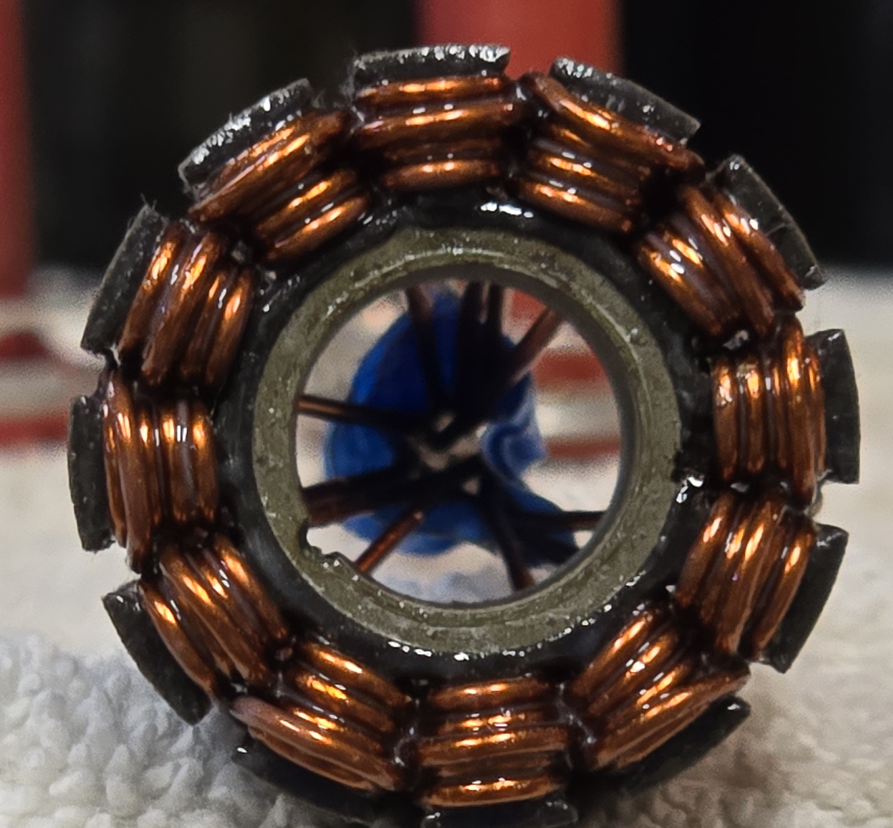

                Click image for larger version  Name:	Pyro600TC.jpg Views:	0 Size:	87.0 KB ID:	405822
                Number 2
                Here is another pyro 600 5+5 YY motor winding complete with the thermally conductive epoxy made specifically for this type of thing liberally applied. It has the thermal conductivity of Kapton for sure, But like I said we have something better already😉 However the 120C Endfest construction epoxy, the amateur in Germany that knows nothing about a bearing or material uses, cannot touch this! This has suitable temperature stability. When it went on it was opaque white, but when I thinned it with hot air from the heat gun it leveled out like this. I don't think anyone complains because they still got a pretty coil you can see. The specification of the material has already been posted. Please review the previous post for that. When I say liberal I put a fair amount on the endturns and brushed the slot openings with an obvious coat mainly to keep the cables that were not locked in under the outside transitional wire on each coil set and then even on the transitional wire and the one beneath it. We also have literally space age materials to alleviate the air gap itself as a thermal resistor, cool it, and improve the magnetic circuit, further increasing torque and efficiency!!
                Thank you Americans and Germans with a brain and I told you that the guy doesn't know anything about a camp. The Eastside MOUTH will be relaxed for a while because it has no answers!! When he and his Aryan buddies slipped, the topic changed on German social media

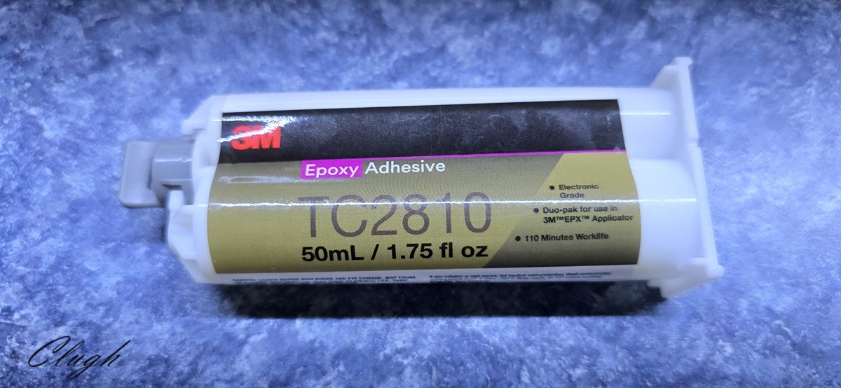

                      BTW team XEROX! To aid in curing I bake the windings with the epoxy for about an hour at 176 degrees Fahrenheit .

                              Powercroco Powercroco
                              UserNo, not this time.
                              It is only intended to show that particularly "good" bearings are of no use in our application.
                              A saucy super bearing would have broken just as much. It doesn't matter what gives up - rings or balls or, as in the picture, both.
                              These miniature hammers are not designed for axial "hammer blows".
                              A bearing according to normal industry standards is mMn. always sufficient for our purposes.
                              And after a hard landing, it is simply changed, after every season anyway.
