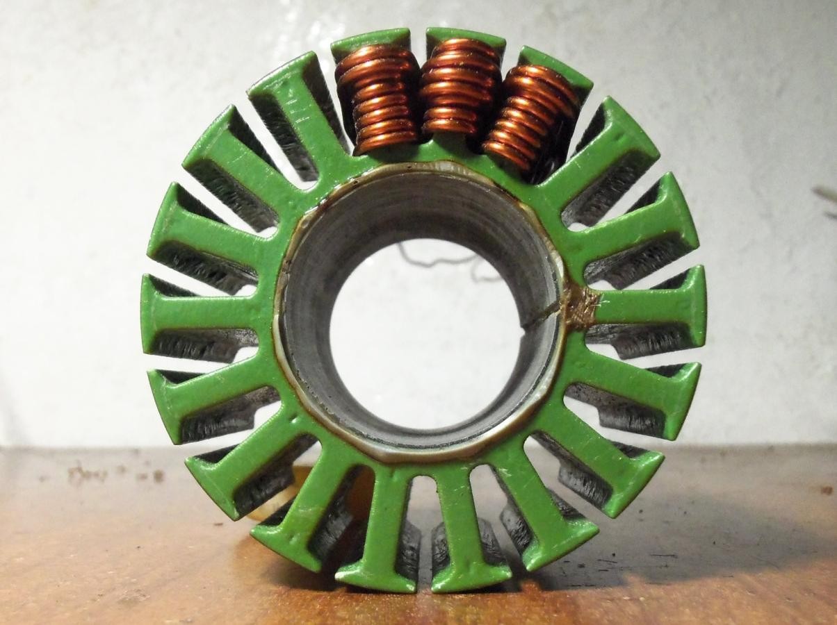

            So, the winding work is finished.
            The result in sth looks like this 65mm 18N16P from 2007. Just with 10 reps
            on the right the scheme for the 18N 16P / 20P wiring in DD.
            the wires coming together from the same slot are almost screaming for it.
            I hope the mechanics didn't get too much and are running again. Electrically I have no concerns about that.
