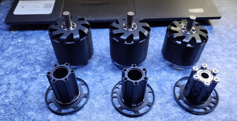

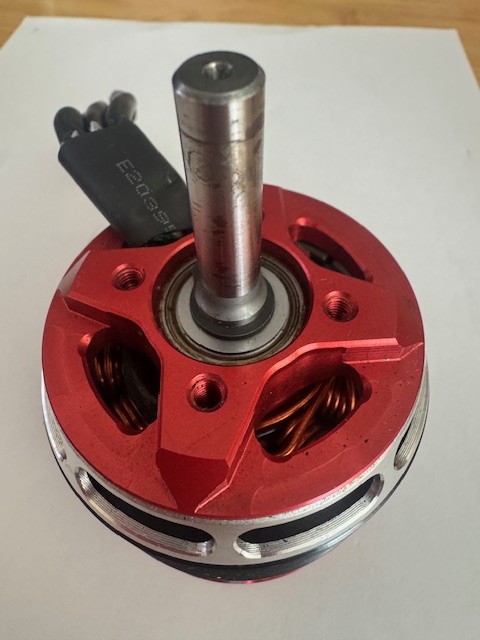

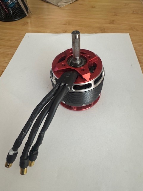

BTW I i just caught a used P800 in a swap meet for a good price. I plan to wind it a big wire hybrid. I also have two 4025's hkIII and a never used in a model DD 4035 HKIII Kit built SL in 15AWG someone can fly. I can slide some slot wedges in it and it should be a really good motor.
I'll spin it All up so the boys can have a look at a log and we can run it through Holle's calculator. This is how you generate real interest not vague proprietary observations...
Have fun with the iron and copper scrapbox. You have a nice one to play with. Yes you are buzy winding for a profit and I get that. But it's your craft . If the discussion leads to a higher quality of work or understanding itz much more valuable than Deadpool money.
You should wind the hk5 4035. The pilots will like 8.8kW fir 482 grams all day. Too bad they stopped making kits.

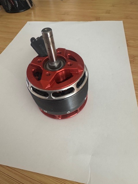

It's been reported to me by at least one heli pilot that a smaller pyro had much more balls than a larger combove motor in his vehicle . He is considering the switch and thinks the combove has gone into demag. If I recieve it we will see.
Umm sounds to me if you buy the big boy combove, still over 600.00 USD maybe more now, a P1000 equivalent is not what you will get.....

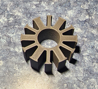

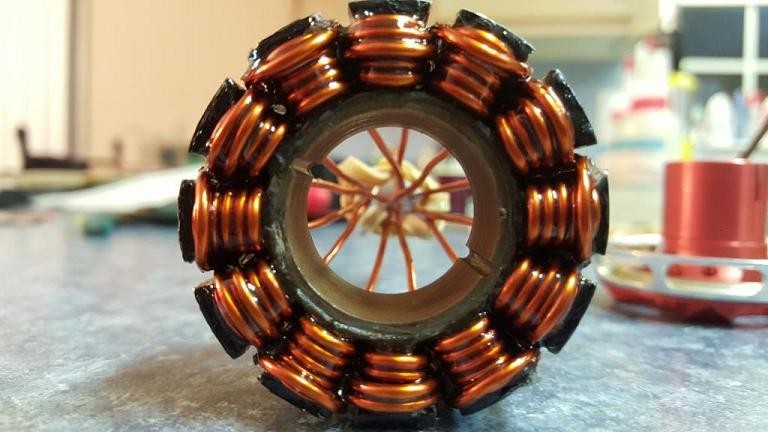

The other thing you fail to realize about the wide teeth leaving room for wire is it is a single layer machine, so you make the adjacent pole thin which leaves plenty of room for the coil on tooth. The 41 Lehner's are single layers. He understands what im getting at about its odd quadrature axis but he wont report itz inductance. He wont report anything relevant you might make real calculations from.

I would love to show you some waveforms from the 12N10P hybrid. But I need some from that 12 slot 20 pole... We need something for something. I cant let you have it for nothing.

You have the scribes so you can wind it you see it runs and the Io for a 1072Kv at 20 degrees timing dd. I'm not going to build a 20 pole rotor at this time to try it because there are so many other options of improvement for 12N10 and 14P. If the 20 pole can work with a lapped winding. You can glue the rhombic winding to the outside of a toroidal iron core and just go slot less.

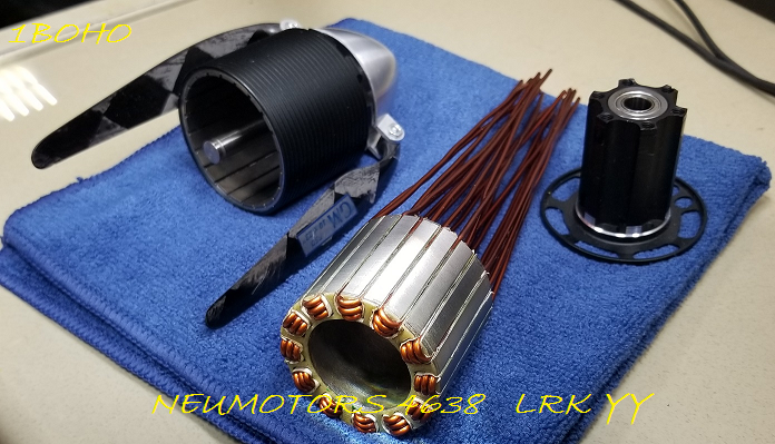

I do plan to wind some light Neu out runners as they have a very clean signal and are 1 to 1 hp to torque. The 46 series and 65 series are more than enough for speed flight. They are already hi pole hi torque slow runners. An uneven .98 turns ratio on a 22 pole eliminates the low order harmonics. I dual invert these with APD and be ready for whatever.
