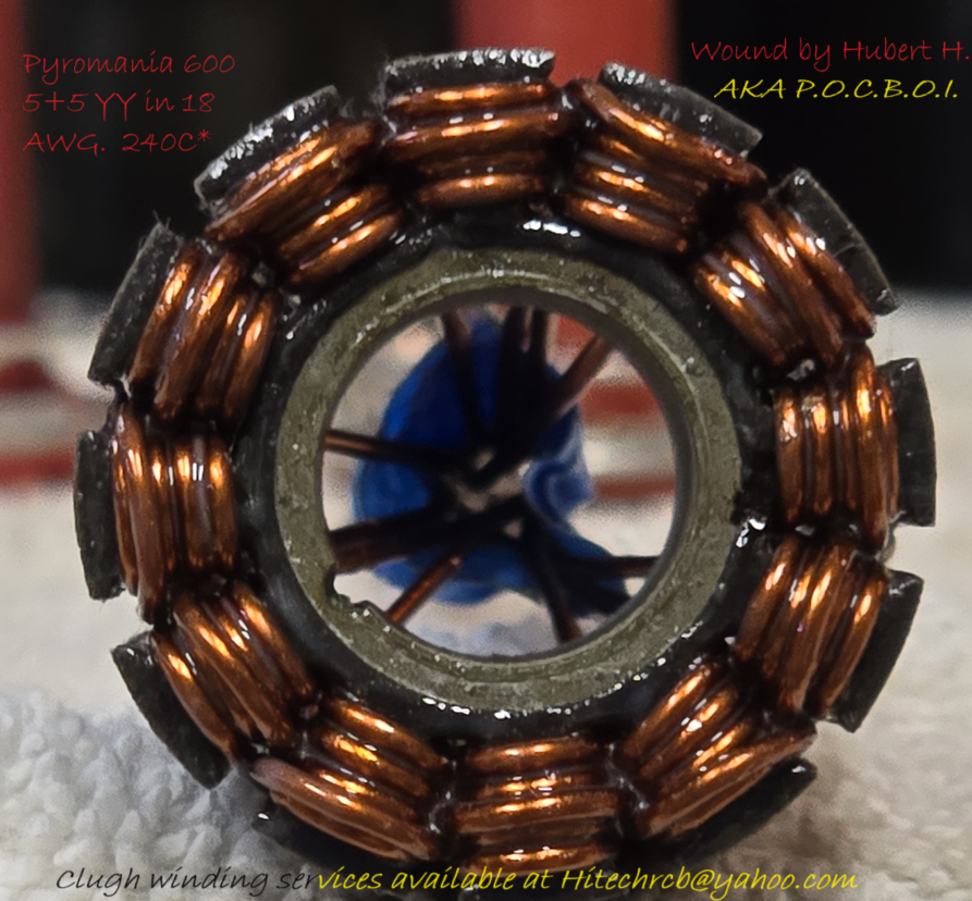

His delusion of his friends in Germany cant be swayed by clear plain writing on a wall but here without the delusion of the motoFuher you should be able to see quite clearly the difference between the two branded motors without much more explanation.
So you go post this there then sit here on our forum wait to see what I have to say..? You are strange.... 😂
Its simple. Your flagship runs at 69% eta so the real joke is you need every percentage point you can get sir. And you are staying far away from the tyto thrust stand at Scorpion Power Systems LTD.
Thanks for the ignorant remote post I knew was coming. Hopefully that will help them forget how much a 100 gram lighter p850 sinks a PC/HK 5035 with the type 4 bell and what ever bearings you choose to team with the used flea market inverter. It wont make up the 150% more power density the P850 has.
You are correct that small addition of efficiency from applicably suited ball bearings will not help you to have a better Powercroco motor . For significant improvement you need a better foundation than a PC/HK and YGE 320 altogether.

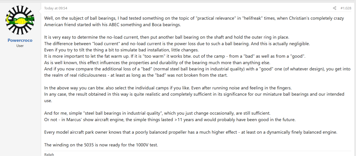

Man muss sich auch langsam anstrengen, um nicht zu merken, dass seine Freunde das auch lesen, sonst wäre sein Beitrag für sie völlig aus dem Kontext gerissen. Seine Freunde, die seinen albernen Beitrag gutheißen, sind genauso ahnungslos wie er. Sie haben gesehen, wie er über Nadel- und Ringlager für die Motoren nachdachte, haben sich dann aber sofort umgedreht und gesagt, sie bräuchten nur das Standard-Stahllager. Und sie loben es??? Sie leiden an Amnesie von seinem vorherigen Beitrag, genau wie er. Nicht einmal Amerikaner sind so seltsam.
A P850 is still much lighter and more powerful motor than a HK/PC 5035 so its certainly time to focus on the small things like bearings for a Powercroco.
I want the hobbyist here to have better understanding so with him its essential i post something.
Its so sad that the individual thinks a ball bearing is just about frictional losses and then goes out on a limb on hobby forum with his friends to have them believe also that would be the only thing relevant. It doesn't make any sense if deflection and bell strikes were previously brought to there attention. That certainly facilitates quite a bit more than the difference of a watt. If the air gap suffers eccentricity from lack of mechanical stiffness as his own FEM showed him then that also will be seen as losses and so will any additional unwanted vibration. The other sad thing is that he got the 1 watt number from bicycle figures from the WWW. Not electric motor data at 30,000 rpm. If you looked at the Tekin bearing test you'd realize that just an amp Idle current difference @ voltage would be considerably more than 1 watt you see in a bicycle wheel bearings study....😄 II hope you didn't plan to follow up with that chart from it as the rpm is less than 100 and the radial forces are much more in all terrain applications esp..
Lets have another look at what he says about a bearings "watt" of gain mathematically at 65 volts.
At and idle current of 2 amperes the wattage loss is 130 watts at 65 volts. At 2.5 amps idle current you'd lose 162.5 watts. At just a 1/2 amp Idle current gain you add 32.5 watts of loss.
This idea of a watt is certainly ignorant on Powercrocos part. If you understand even the basics of electronics u should be able to understand this.
Then there is also the addition of rpm which enough can always add to an increase in the speed of the vehicle. Its already been shown that you can lose that half amp or even more in idle current which would have a significant effect on efficiency.
Hopefully they can do math and understand ohms law which would indicate clearly that the right ball bearing in these hobby motors certainly have more effect than a watt at the applicable voltage levels of speed flight.
There is no logic or truth in his post on the subject matter.Comment

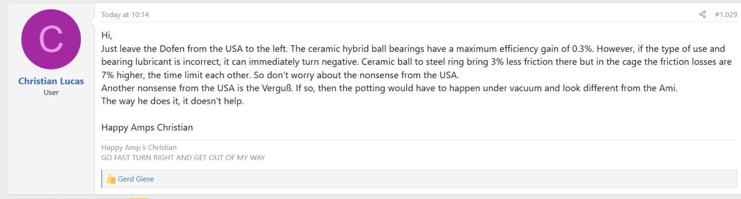

The Halbach boy is back . But why hasn't he told you about his private email to me where he is telling me "Hi hubert I'm getting the ceramic hybrids for my 4125 lehner ?
Also that already does not sport NMB!!!
Why is he talking and hadn't shown you the halbach or 20 pole run?
What a joker of additional hate out of Bayern.
As usual the fallacy changes nothing about the mathematics involved in the calculations of potential improvement.
A what new about the many faces of Christian Lucas that are now giving powercroco post thumbs up after calling him dumb for the lasxt 20 years..
Is the same old Laurel and Hardy show on crocoworld.
Ask him again why he was looking at double row angular contatct bearings and needle bearing.
I love you idiotic logic. If your steel bearings arent broken why are you replacing them?
OOPS got ya again
I post Christian emails about buying ceramic hybrids for his 4125 so i guess he was after .3% that againg is incorrectly calculated just like i showed you. If the Io was reduced simply half an amp at voltage with a new bearing.
I really don't have to argue the F3A and Heli pilots apparently do not want your engines..
And Ralph you are the clown that selected ABEC 9 "cubic zirconia" bearings. So we know You know nothing about bearings truthfully.Comment

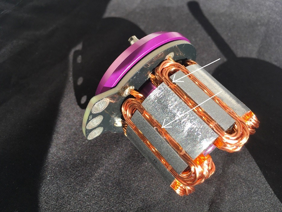

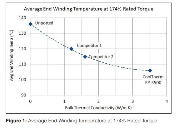

Auch beim Guss irrt er sich: Er muss nicht vakuumimprägniert sein, um einen positiven Effekt zu erzielen. Er hat einen reinen Isolator an seinem Motor mit Löchern – was will er damit sagen? Ich habe andere E-Mails, in denen er die Arbeit lobt. Er sagt nichts, wenn er seinen eigenen Hype nicht einhalten kann, wie zum Beispiel beim 4,5 kg schweren Avant, den wir leichter haben. Jan empfiehlt ihn nicht, und Albert fliegt wirklich XNOVAS!!!
Er ist ein Clown, genau wie du, Ralph. Ihr seid aus demselben schmutzigen Stoff geschnitzt.
Die Tests begannen am 15. Januar 2016 und wurden täglich (außer an Wochenenden) durchgeführt, bis alle Motoren ausgefallen waren. Erhebliche Verbesserungen der Motorleistung wurden durch eine Senkung der durchschnittlichen Wicklungstemperatur bei Verwendung eines Vergussmaterials mit hoher Wärmeleitfähigkeit beobachtet. Es wurde ein Zusammenhang zwischen der durchschnittlichen Wicklungskopftemperatur und der Verwendung eines wärmeleitfähigen Materials beobachtet, insbesondere bei höheren Leistungen. Der unvergossene Motor lief konstant 25 °C wärmer als die Konkurrenzmotoren. Der mit CoolTherm EP-3500 vergossene Motor lief bis zu 20 °C kühler als die Konkurrenzmotoren und 40 bis 45 °C kühler als der unvergossene Motor.
Vielleicht bekommt ihr Idioten eines Tages solche Daten in die Hände, die euch zeigen, dass ihr keine Ahnung habt, wovon ihr redet, und er auch nicht. Er verwendet nichts anderes als einen reinen Isolator, und dieser ist auch nicht vakuumimprägniert.Comment
