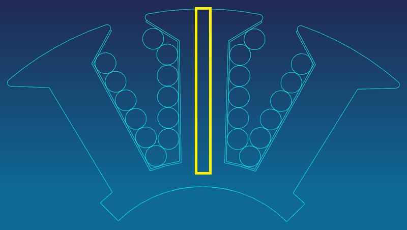

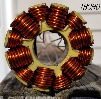

    #141
    Click image for larger version  Name:	dg stator (2).png Views:	0 Size:	105.9 KB ID:	390621
    5 Years going on 6 for real Borat.....πŸ™ˆπŸ™‰πŸ™Š
    You know where the "flussperren" external rotor ideas came from.. The universities work filtered through Christian, Pem, and I. They linked us to the initial theories and I brough forth the cut from that and it will work because what it would do is keep a consistent slot opening wile making the salient arms highlt resistive pushing the current to the wound iron. The revision involves adding the missing iron to the width of the center tooth in the "E" cores. Manufacture of this stator is not cost effective in a hobbyking world but Dr Gerling said go for it and Christian Lucas can attest to this reality as a cc. My professional ties at Daimler were a hangup. Currently that is not the case but in the future I may plan to go back to Daimler or VOLVO because they are serious about the E development and I want to be part of that. We've materials not highly considered in model motor or other handheld actuators. The manufacture of such specialized things takes time. We also have a single layer port of the Hybrid and you already know that. .

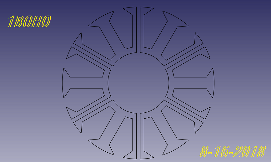

    Click image for larger version  Name:	HKIII stator mod.png Views:	0 Size:	116.2 KB ID:	390622
    Since your copy of my original machine simply inverts this feature I think you should review Drs. DG and GD work in the back iron then you might understand without FEMM why it was done this way in my concept and in manufacturing this may make the easiest way as the Barriere des Flussmittels can be glued in first then the link broken between the "e"
    cores This goes beyond simple turns on a dirty lathe....Since your at FEMM you should review if for the sake of team Xerox....πŸ˜€
    These real cuts and the novel windings will be my intro into 2024
    So please enjoy the daily winders news revisited. Because motors and inverters suitable for > 603 km/h are attainable without sucking crocoamps!πŸ™ˆ
    The real 1BOHO
    State-of-the-art PMSM/BLDC motor control solution for aerospace applications and robotics - TΓ©lega - Zubax Robotics​

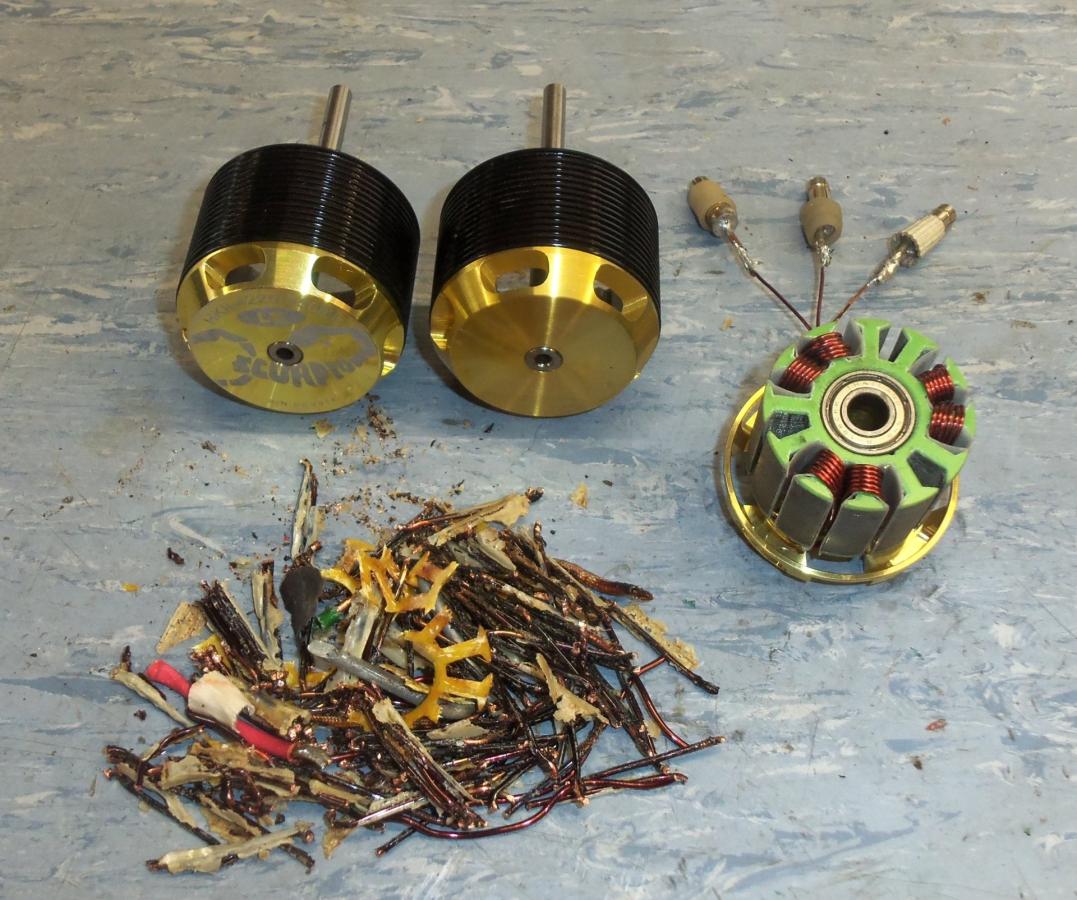

      "The 5025 for the transmission is now ready for testing.
      The "cooked" 4225 has also been completely dismantled in the meantime.
      Even the insulated discs just crumbled. The fact that the paper was completely muddled was to be expected anyway.
      With new insulated discs and an "n-spec determination winding" and a brand new bell for speed comparison, it is also waiting for its test run.'​
      ~Borat~
      I definitely believe this about amperage but the problem with full disclosure is at this point with the APD he's flown faster than Kai with a YGE so what's reality and the situation with the now hidden flight and inverter data logs?
      Do you know more amps dont mean anything if its phantom power. Christians 41 pulled more amperage than you and it amounted to not a single rpm more at the prop. Do you ever calculate what's real in power and torque since the motor is not even 90% efficient and has a Kw of 93% ? The torque versus hp squareness is not there. There are a few motors that rate at alot less power and weight but pull much more torque per unit of hp. Man the MHZ 7455 boast of 20kW at barely above 5 nm of torque. Bruh that's nothing for its size and mass... Why not wind for more voltage with lower rpms and less amperage for more torque then use larger diameter at the same pitches to create more thrust. If you all use the same setups why do you expect huge differences in performance from one to the next? Its really makes no sense. A 2 meter plane should be able to handle the torque of a larger prop. The only person that benefit from them buying the same stuff over and over again is you. It also seems that many of these winds are scorched from excessive heat. So where is the >400 going exactly. Alot of repair threads mean that the motors are truly at their limits of operation. If you need to check the performance with a new rotor you also have concerns that the rotors PM's have hit the currie limits and possibly contracted irreversible damage . How could this be a stellar report that brings thumbs up from the consumers of it? A weaker rotor would most certainly drive up load amperages and cause possible timing issue for the inverter as the field becomes weaker under increasing loads and temperatures.

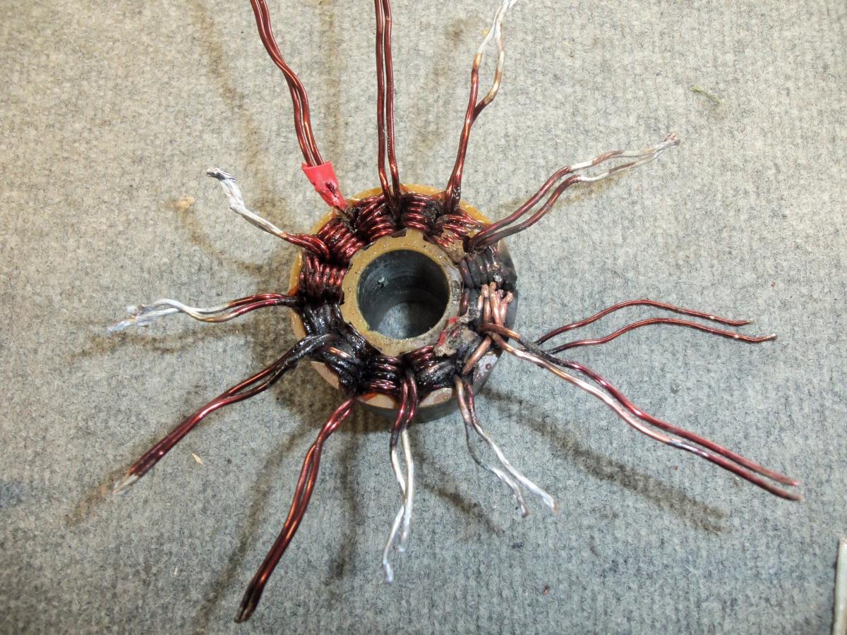

      Click image for larger version  Name:	100_2353.jpg Views:	4 Size:	150.4 KB ID:	390627
      Click image for larger version  Name:	100_2198 (1).jpg Views:	3 Size:	220.6 KB ID:	390628
      The AC ​Crosstalk of axially stacked bifilars will do this since it stresses the higher wire from the duo in the slot with an unfair share of current density every time then the parallelism is carried all the way pout to UVW. That is not ideal. What a pity an Amateur understanding that the wires average the same current in the slot cant concede it is truly un common in the field for a motor having a mass of over 2000 grams running at 50 volts to have idle currents in the double digit range.
      Click image for larger version  Name:	okon wind (1).png Views:	0 Size:	299.3 KB ID:	390629
      U cant see the minimal bearing the DC has on the overall AC functionality and losses? I've told you before Borat that the DC is more relevant at really slow speeds or stall where the AC losses are non existent or much more minimal in the first place but this is only 12000 rpm you want 17,000 .
      Idle speed currents represent the AC while DC represents the stall current. It is the ratio of these losses where ETA comes from.
      You are hard headed because you have two strands but cant seem to understand that one gets over worked while the other is underworked and that really negates the two doubling the ampacity of the one Ralph. Can you see here the AC loss for 8 large parallel strands is 10 times its DC ?
      A better wind will lower the load amperages and temperatures thus the core, rotor, and copper will perform better. The motor with 8 strands can have the same DC but still will have less "punch" because of all the AC resistance.

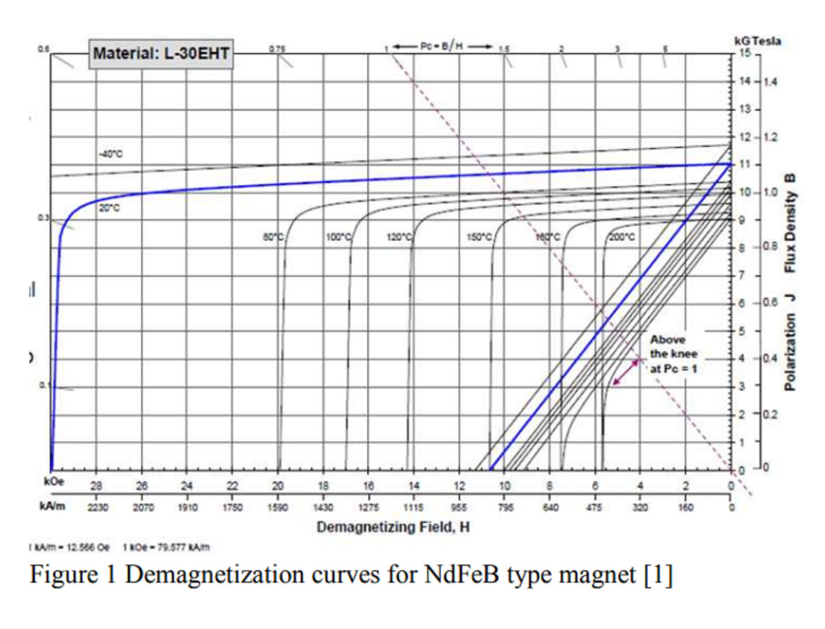

                      Click image for larger version  Name:	100_2353.jpg Views:	0 Size:	150.4 KB ID:	390722
                      What is interesting about the damaged rotor Borat is it answers very clearly the desynchronization of the motor with inverter under heavy load. it isnt LRK. As suspected it loses sufficient field for commutation and if it did commutate at those temperatures that caused the damage YOU say typically seen in your engines after a few seasons one would have very little pull out torque. You say it isn't saturated but what's happening there then if there is more to give of your utilized iron and rotor? The magnets YOU & SCORPION SPECIFIED are stable to 180C. If that's the case how did they suffer the sustained damage unless they exceeded that? The temperatures had to be extremely elevated or the specifications or the pm is not truthful. "Scorpion and Powercroco are cheating." πŸ™ˆπŸ™‰πŸ™Š and why didn't you see if you could zap the original rotor versus require a new one???
                      All you need is a high voltage charging source for a high voltage high capacity electrolytic cap and the stator with one serial coil wound cw/ccw 180 across the stator. You zap the PM by discharging the cap across the coil at each zero degree location per pole pair.. If you don't do this how do you know if the damage was reversable or not? If you know that you can predict minimally from the truthful magnet curie specification where the temps of the pm's went. You cant argue they were high if they could not return to full operation after cooling down. That is your creation there and that has to be your empirical truth about it now right?
                      This has been examined for most of the available pm but you can re do it for your own examinations.. Like you said you cant trust such data unless you examine it for yourself. I guess the world should trust you then but anyway. The power reports from unilog are exasperated with all the clearly present thermal overload. Because Its definitely exceeding 100C.
                      Click image for larger version  Name:	figure 1.png Views:	0 Size:	582.5 KB ID:	390721

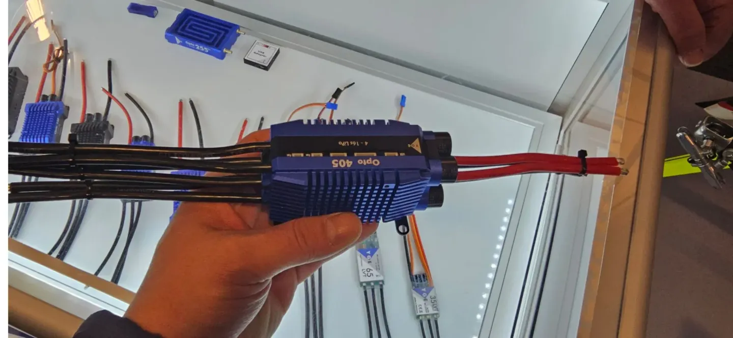

                              "AFAIK some years ago YGE had built some special 320UHV ESC good for 18S.
                              The UHV all are good for 17S but some also have been specified for 18S.
                              The advantage:
                              The Amps for the same power are lower than with 16S.
                              Also they have been much less expensive as the APD with their 1000 USD+.
                              I personally never owned one of them. I prefered the way to reduce the inner resistance of the 320 by additional massive copper bars on the main leads.So the 400UHV have been build.
                              About these I know, that there have been made only 5.
                              Stanleys 643 and Tims 523 and all results of Christian Hidde have been reached with these much cheaper YGE types.​?
                              U mean you definitively dont know?
                              But you do know Christian Hidde runs Thomas Pyro 1000 not a power Croco 5050 U know Thomas the person whos T motor results made u mad. Look at the work squawkers
                              ", because Ralph brought it up,
                              I can fully confirm all this.
                              Click image for larger version  Name:	IMG_2170.jpg Views:	0 Size:	70.2 KB ID:	390803
                              Here is the latest version of the Pyro1000 drive, from 18s back to 16s because of Opto255 with 16s3500 Fullymax biaxial.
                              The usable power was increased to 19kW, which allowed the speed to be increased, and the weight was reduced to 4.2kg, increasing the all-important power-to-weight ratio to 4.5kW/kg.
                              The wing loading is thus 95 g/dmΒ², which does not yet lead to excessive braking effects, as was the case with the XXS surface at 108.
                              This should make it possible to fly 650kmh horizontally without a "bubble".
                              We'll see."
                              VG Schmiddi
                              OPTO 255 mot a 320 they dont even make tem any more... LOL! yes APD cost more it has half the resistance and a million more features Your inverter is cheap and a pyro has more iron under the copper. You never showed DZHAMEL Audiosmith motors have you.? U let him believe your the outlier in Germany? Ha thats funny..
                              Buss bars on an already manufactured board is something like Turnigy does which is alot cheaper than 600 for the same exact processor . U dont know a thing about inverter "AFAIK"
                              That is what we call a band aid on a poor high current bridge design with only 4 layers of copper vs 8
                              The YGE has the same slow processor as a turnigy combined with d2pak fets so please gthoh LOL! You cant get around the antiquated hardware and considerably higher resistance with the made in Germany Stamp
                              notice u wont post the resistance because you know how poor it is. Post the 400 yge RESISTANCE ID LOVE TO SEE THAT EMBARASSMENT that added buss bars not more d2pak fets in parallel because it cant switch them above 16khz with their high gate charge compared to modern fet technology.

                                Click image for larger version  Name:	YGE405.webp Views:	0 Size:	57.4 KB ID:	390812
                                Woo wee it weighs over 600 grams Im sure...3x's APD at a lil over 200. . Select distributors can still get APD no issue. Just not RC hobbyist that hide the logs.
                                Still waiting for the resistance numbers Ralph. Its already less power if it is only does 14S It is not a YGE 320....which is what you claimed was better and neither is this...
                                Looks like 205x2 the RCT cooling system weighs alot so i hope the cooling improvement can carry itself. For this weight dual F3 200's can sink 700-800 amperes with a reduced sub harmonic and weighs 70 grams no issue with privacy on you tube LOL so u can actually see the pull with a amp clamp on the scope.

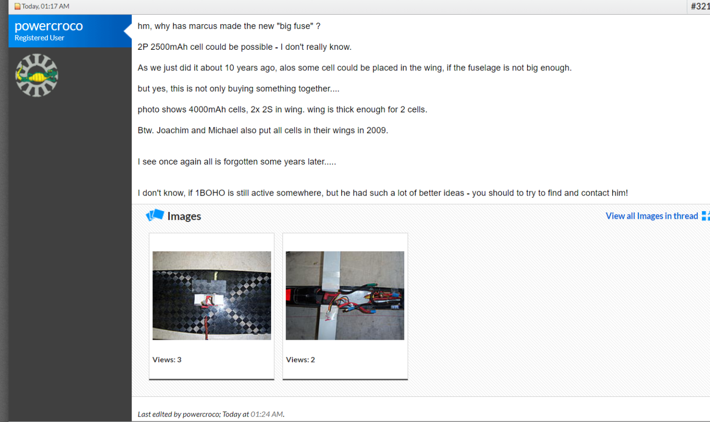

                                    "I don't know, if 1BOHO is still active somewhere, but he had such a lot of better ideas - you should to try to find and contact him!"
                                    ~Powercroco / Borat / Boho1~
                                    Sure you know where I am Borat right here so why you lying to the man that spends money with you? When you're right here active in my thread on this forum....as BOHO1 . Hes already told me he plans to share the 603 log from APD...πŸ˜€
                                    U mad at him? This mean you wont repair your motor he purchased from you when it fails?
                                    You tried to edit it out at 1:27 but I got ya.... dont worry I'll link them.....thanks....πŸ˜‰
