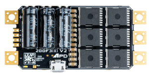

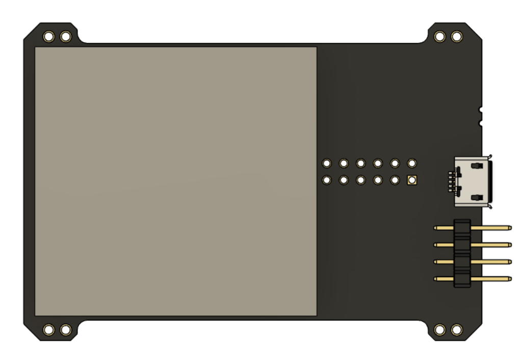

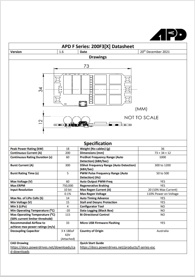

      ​Gerben The multiple world champion flies the APD because you see it has synchronous rectification can burst over 350 amperes on YouTube and weighs 36 grams!
      He will also tell you that he still loves castle and also still flies it as it is a little stronger in his opinion has an extremely low on resistance and as you can see in test bench review is a top performer over Kosmic and YGE at a high percentage to full throttle where full power occurs. Even you should know the throttle demands of a speed plane and helicopter are totally different.
      Click image for larger version  Name:	f2001.png Views:	0 Size:	555.6 KB ID:	390137 Click image for larger version  Name:	f200.png Views:	0 Size:	127.2 KB ID:	390138
      18kW @ 36 grams!

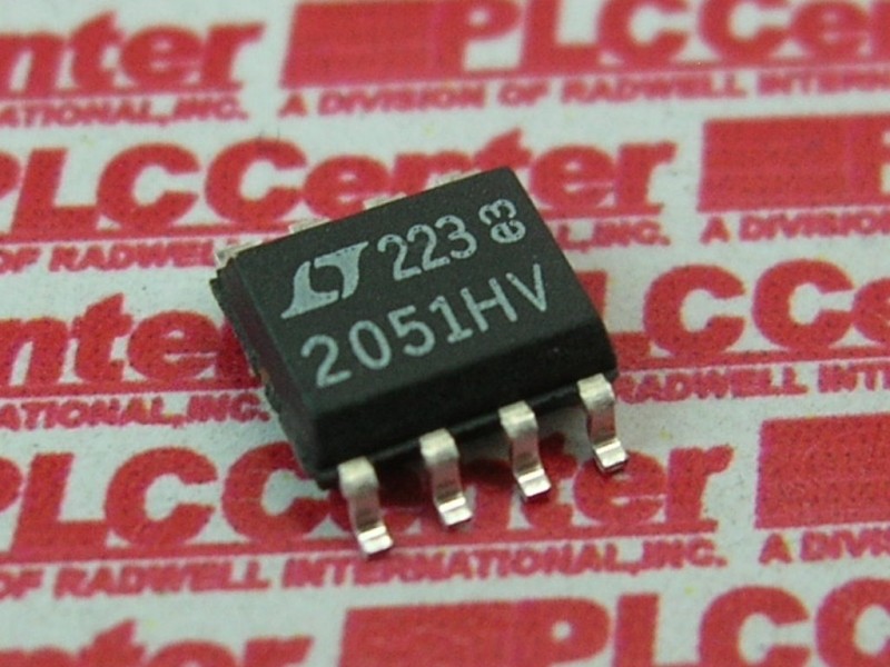

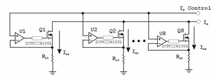

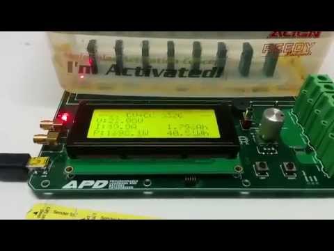

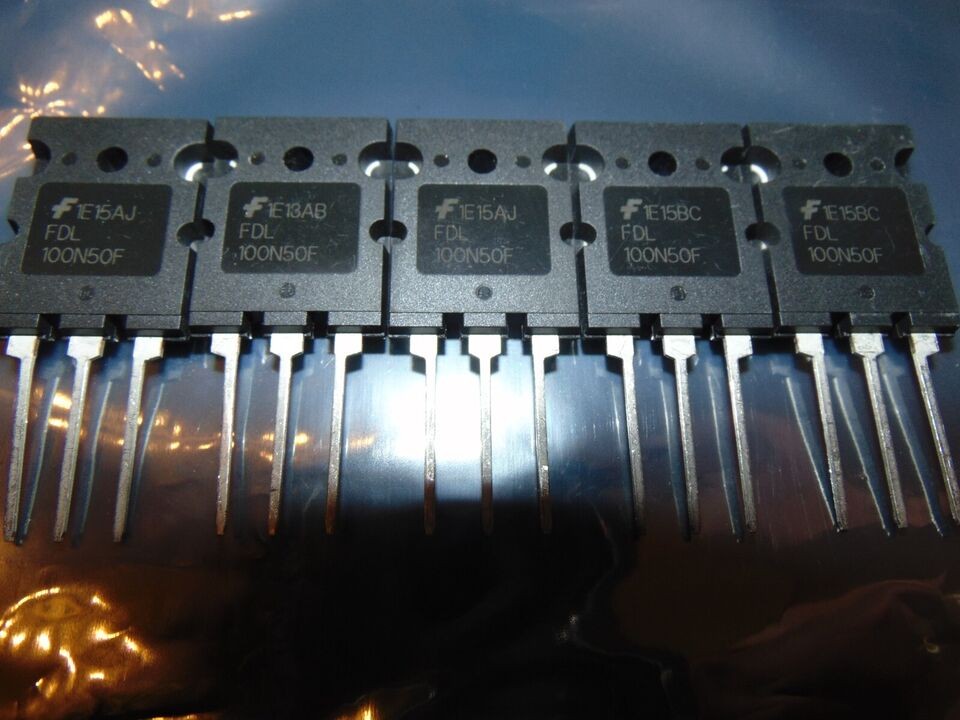

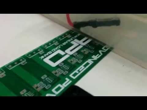

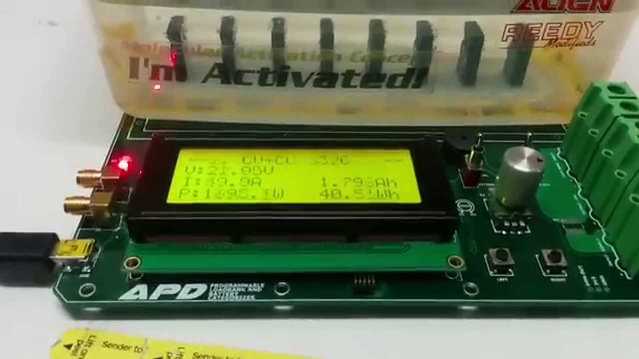

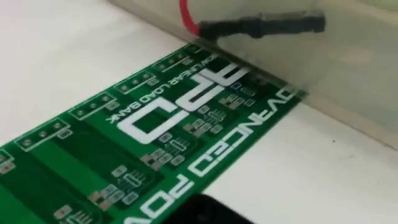

        Click image for larger version  Name:	load bank schematic.png Views:	0 Size:	69.4 KB ID:	390162
        Here is an example of a linear load bank using FETS In the miller plateau region which is a state where the FET is neither fully on or off it is used as a variable resistor. Tonys prototype uses a power fet thats 100 amps at 500 Volts. Fully submerged in water maintaining a case temp of 100C One can dissipate around 1kw. His board is allotted for 8 in parallel it can do 8kW submerged. The configuration is simple. The gate is fed in a hysteresis configuration with an op amp. The inverted input if fed by the voltage seen across the current shunt resistor and the non inverted input is fed by a reference voltage for the desired state of the FET(Load resistance) . Do you want to build one for an HK dyno...
        • Clugh
          Current F3A world champion American motor winder.
          • Sep 2023
          • 5217
          • Research Triangle Park North Carolina
          #124
          Here's what Tony used to build his.

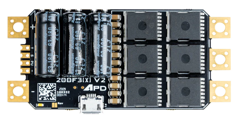

            Boho1Boho1
            Today, 07:55 AM
            Hi Borat
            I know you are here so let me show you more about DC and the internal resistance with your YGE's The YGE used 4 layers of copper in its traces the APD uses 8 layers Borat....👀
            The APD HV Pro 16s internal resistance is .00018 ohms have you ever compared that to the YGE 320? By ohms law post on rcgroups how does the YGE really deliver more power from the battery to the motor then?
            See how crazy your post must be.....🙈🙉🙊
            The resistances are easily viewable in eCalc
            heres another example that cannot be denied by hobbyist on German social media.
            A yge sapphire 125 has an iR of .0020 the APD F3 120 iR is literally half of that at .0011 the YGE is 124 grams the APD is 20 grams!
            so clearly it can sink double the current and weighs 6 times less.......

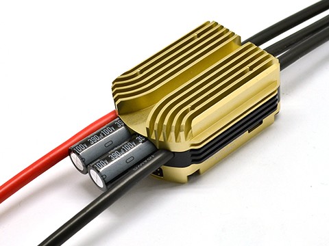

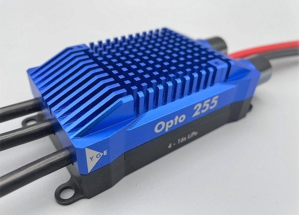

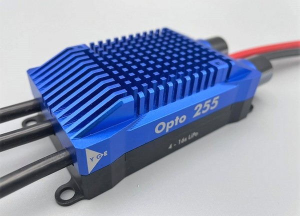

                Click image for larger version  Name:	yge-255hvt-opto.jpg Views:	5 Size:	53.8 KB ID:	390187
                A true delivery of information would tell people the YGE320 is no longer available and the 255 opto is its predecessor. It has revised hardware . Its now 32bit with better fets than a 320. Its has the RCT cooling concept which does the same thing as wrongly charged to the APD . Its automatically current limited to 400 amps peak and is going to cut back based on voltage sag and temperature so if the supply is not there the inverter is going to protect itself and back off. Thats exactly what they are supposed to do so if you want more power u have to deliver more cooling or a better power supply (battery) . The batteries your friend uses are certainly not the best . If stronger (with higher resistance) and dumber ( with slower processing and obsolete hardware) is better YGE discontinued it for what they feel is better. They also can do more than 16khz PWM now and that's direct from them to me in a direct email. This is proof perfect that even they YGE knows a 320 is antiquated. The 400 ampere peak 255 opto still weighs 140 or so grams more than the 400 continuous 600 burst current 16s APD!

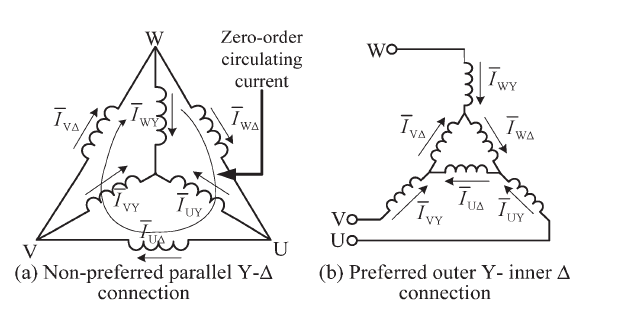

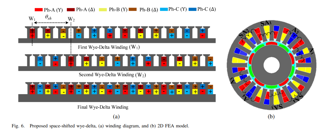

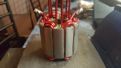

                    Click image for larger version  Name:	20160413_013641 (1).png Views:	0 Size:	224.2 KB ID:	390193

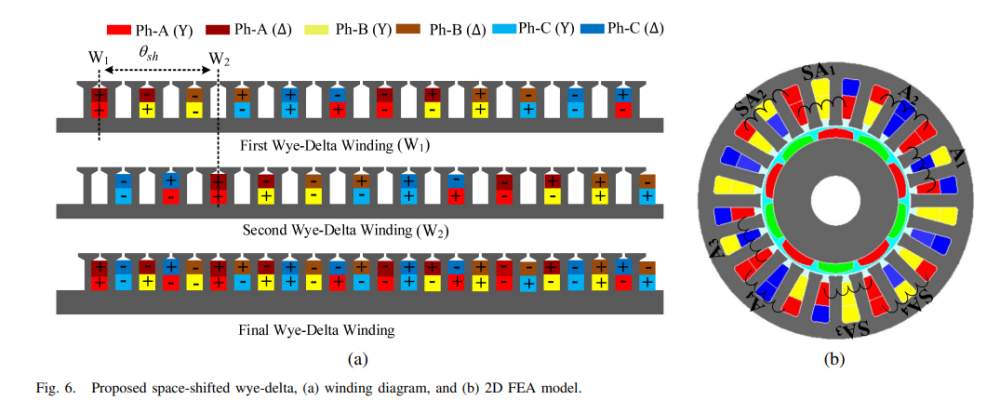

                    BTW
                    A 50 series with 1.828 mm 13 AWG would be Childs play for the real 1 boho at 52 years of age. Is a 12T on a 50 series all u can do? Or do u need a handicap winders' parking permit? 😃 The YGE 320 cannot deliver in dual 3 phase (DTP) 700 amperes to the high idle knocker @ 72 grams or turn it to 200,000 rpm for $420.00 usd can it? There is no PID tuning with one either. No low pass filter capability or digital communication protocols like proshot or dshot with the yge. Slower telemetry and very limited in all but the most basic options. It has no beta flight FC or blheli32 capabilities at all. Its funny scorpion doesnt endorse someone that actually uses their products which I see as better than the YGE for the application of speed flight. Its a six step drive.. It has alot more features in its configuration software and can drive a 32khz pwm. It can sink what the 255 opto can and its 100 grams less in weight.

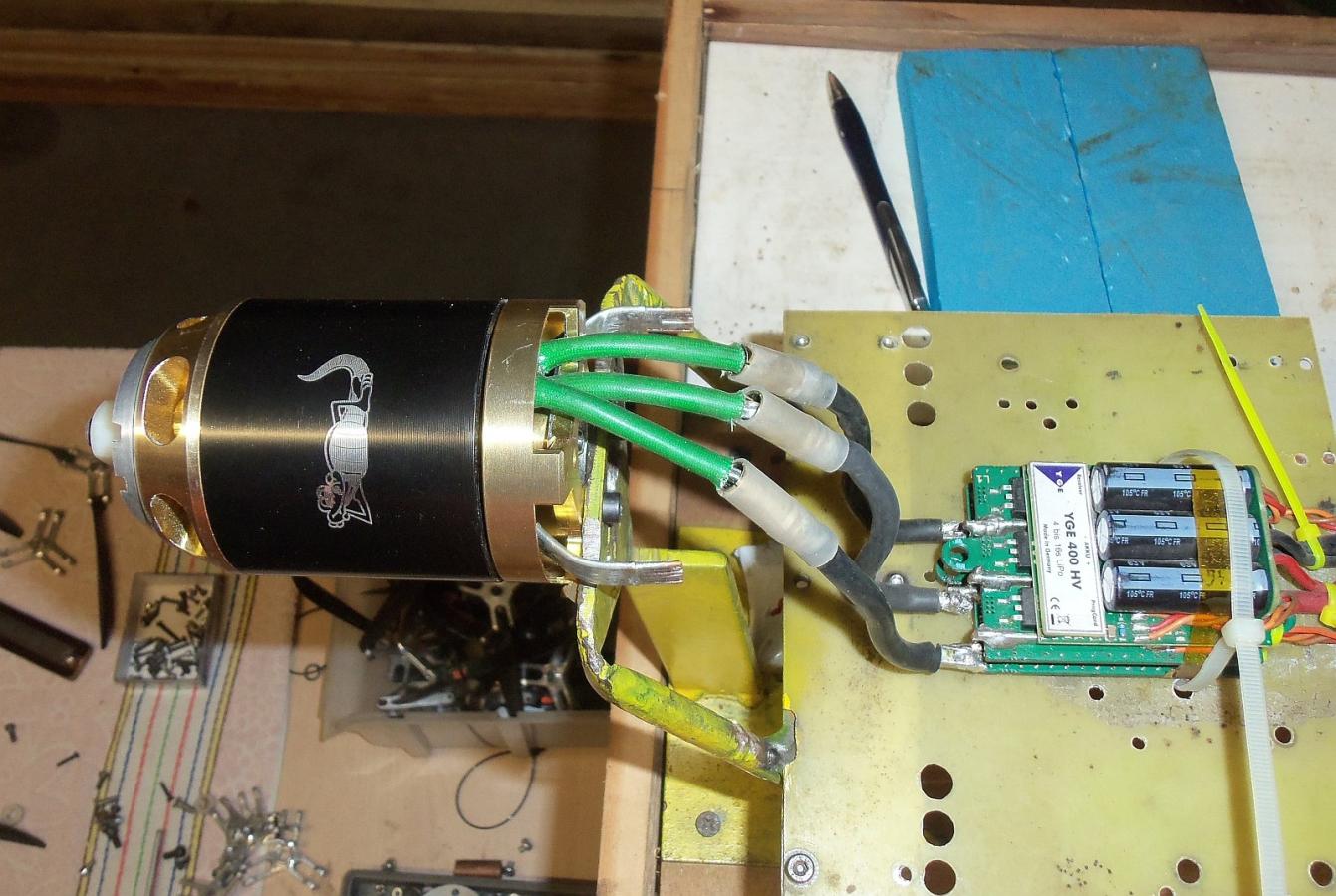

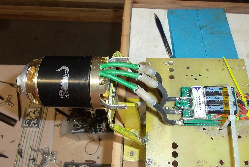

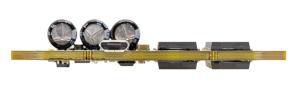

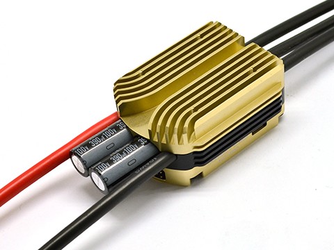

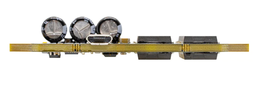

                        Click image for larger version  Name:	100_1266.jpg Views:	0 Size:	153.9 KB ID:	390233
                        Hi Borat,
                        Here's your YGE 400 so here it has no APD limiter so where's the logs of the 500 amperes with the prop?
                        U see it still uses d2PAK 3 pin fets it cant run many with its driver so measure the iR and know what you truly have a heavier good part load inverter with heli lineage and the highest resistance when you run mostly high throttle percentages and WOT in a speed trap. It runs hotter than everybody there... Kosmic, Castle, APD....🙈🙉🙊. If 605 is there this should extract it right? U see to fortify the traces of a 4 layer PCB they added bus bars!!
                        Hand DZHAMEL one.
                        But when you say dumber and stronger than APD I want everyone to see you only got the first part right.
Name:	8 layerPCB.png

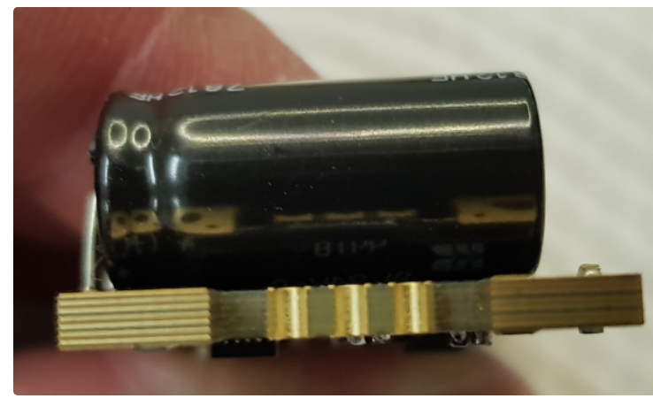

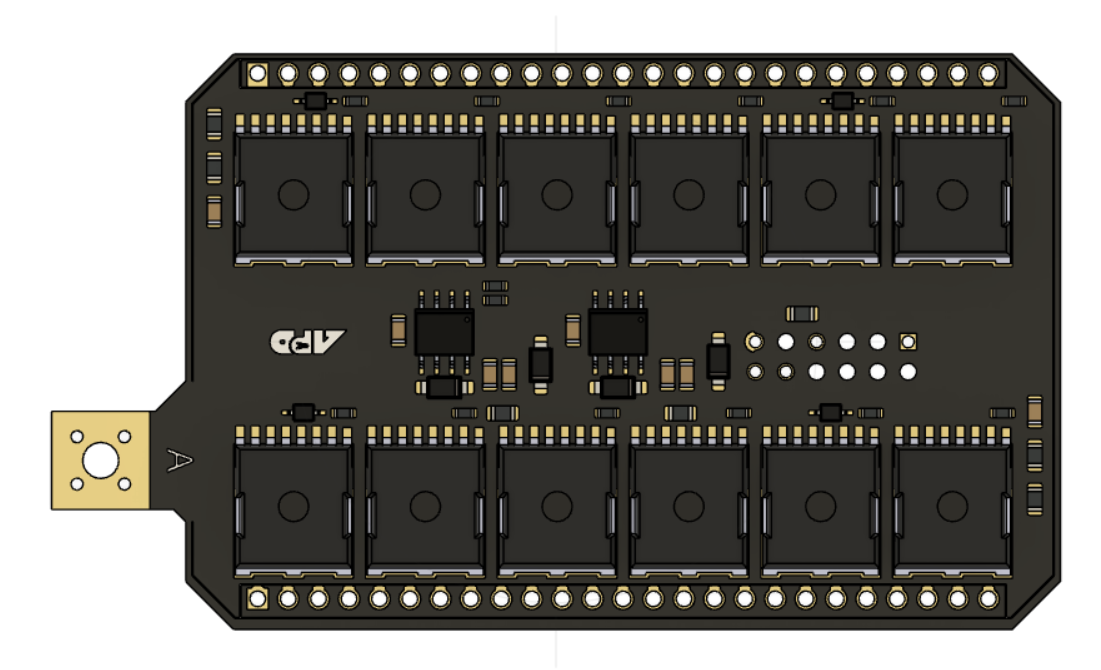

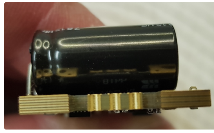

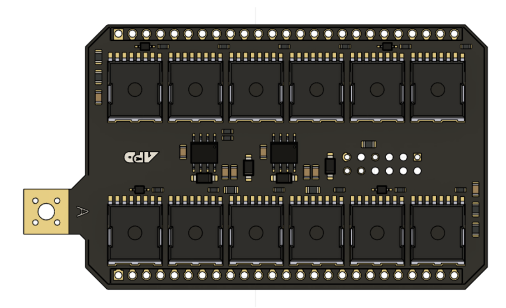

                          Click image for larger version  Name:	APD power stage..png Views:	0 Size:	215.1 KB ID:	390237
                          This is just the A phase power stage. They utilize almost all the board copper into the bridge. Its one for each phase and another pcb that carries nothing but a large array of MLCC's which are much faster and a great compliment to the bulk balanced electrolytics they provide. Then finally the last PCB carries all the logic MCU on board ps etc. DZHAMEL is a consumer with obviously no measure of the inverters iR or manufactures specifications so you go ahead and listen to him. You be the disadvantaged and misinformed. I beta tested the PROTOTYPE @ Daimler . If you knew FET technology then you'd know why a faster gate charge is advantageous to paralleling fets and being able to switch them fast enough. This is why the YGE PWM is limited. With just a change in the FETS of a 255 OPTO with the same number of fets they could run a higher pwm. .Since they increased the PWM capability I assume that's what they did. They could have easily just stayed at 16 khz and added more fets in parallel for a lower iR. They have a good synchronous rectification AFW so they still manage cool running at partial load and did not find the higher iR a concern untill they added buss bars to carry more amperage 🙈🙉🙊. Just based on the slow commutation algorithm and processing clock it will never be the ideal highspeed inverter. The capabilities of the plainly listed hardware onboard doesn't care about a hobby pilots opinion. None of the inverters are the problem. Its always the hobbyist that makes all his own purchasing decisions about the equipment he uses and their applicative setups to reach their goal. They choose the motor, inverter, plane, props, and the batteries they use. Its always on them if they don't reach their goal . DZHAMEL subscribes to you and your F3S friends for advice. So who's fault is it what he flies, what's in it, and how he uses it? I want you to know my opinion on this....The subsequent editorial on the inverter from you and him on RC groups and German social media is real trash... Im sure your post will help him establish a productive and cooperative relationship of support with the boys down under.
                          Click image for larger version  Name:	20211230_184059.jpg Views:	0 Size:	107.0 KB ID:	390242

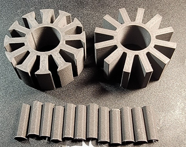

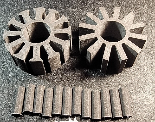

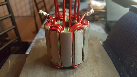

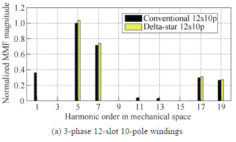

                                Its the same old theme as post # 130 Ralph. A saturated knocker ....So you can go ahead and wind a longer heavier stack since a conventional wye wind wont utilize more iron esp. as the parallel stranding and elevated idle currents burn what is there. 🙈🙉🙊
                                You could always print carbonyl composite slot wedges to improve the cos phi relationship and lower load amperages. Click image for larger version
                                A novel gimmick.

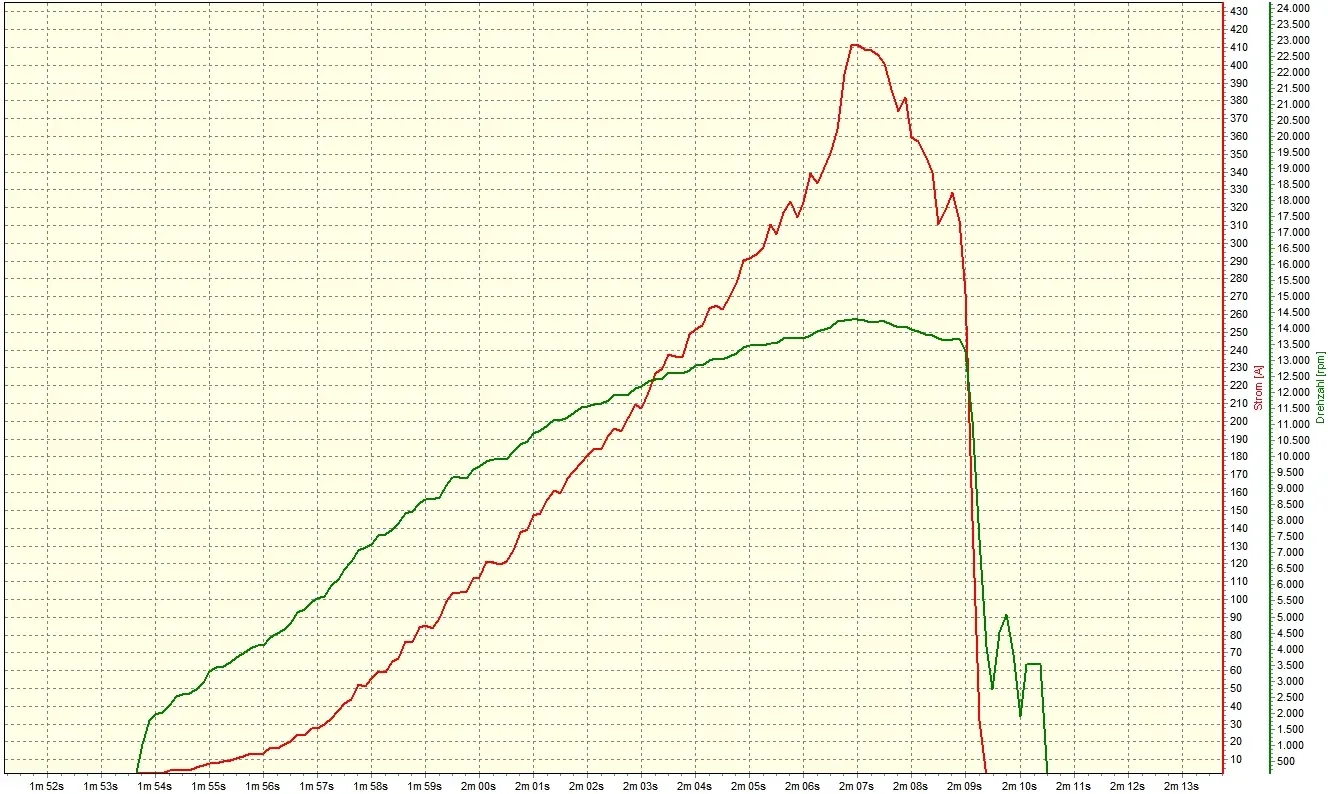

                                  Click image for larger version  Name:	HK5040-YGE400.webp Views:	0 Size:	151.5 KB ID:	390249
                                  And so then here is a truthful log of your 5040 he purchased with DZHAMEL's APD with OLD FW free of protections and >410 amperes. They are "cheating" you say. See you special fo sho Powercroco! Will you tell your friends on German social media the motor is spent around 400 amperes that's why baby girl is throttling back the phase current with the latest FW?

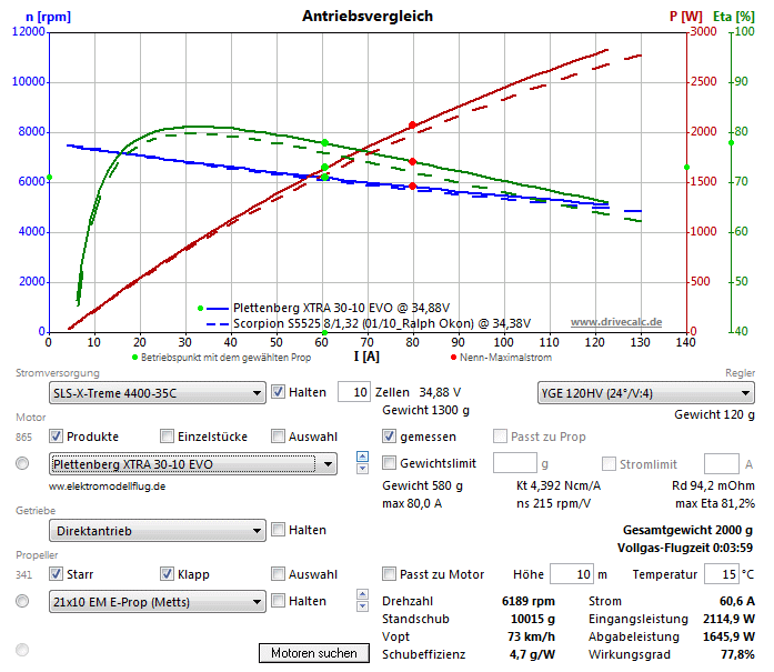

                                          This is why the readers should care less about him or putins puppet. They knock every product but their own then when they are wrong the post become "..." edits or it falls to the bottom These charlatans don't want you to see the APD likely did it utilizing less current than a YGE . Do you see how the latest logs of 603 with APD wont come out now 👀
                                          Its amazing BORAT how people on forums support a false information amateur that lies straight to their face with full contempt to sell his low Eta scorpion rewinds and the highest resistance inverter in class. They buy into it but all the proof that clearly show other wise they ignore like this performance plot or faster pilots with different equipment mainly motor.... its a cultish following on weak minded forums and germen social media.
                                          This plot is not "damn hard to understand" and Its tragic someone thinks they are special enough from such a plot and because they learned how to wrap copper around iron to open their mouth to critique something they cannot build and have zero know how on the subject matter. You should learn to be quiet and learn more about hardware functionality and CONTEPORARY motor winds b4 u slam a great product you know zero about..... 🙈🙉🙊 I know you see here that your rewind makes less TORQUE and ETA ? Where is the improvement of lower DC resistance in this picture over the Plattenburg? The powercroco scorpion took its rightful seat on the podium here. Can you see that or do you ignore it Borat?
                                          Click image for larger version  Name:	xtra-v1 (1).gif Views:	0 Size:	37.3 KB ID:	390615
                                          ​I guess a guru cant wind it so they tell the forums mis information instead.
                                          Click image for larger version  Name:	Hybrid wind..png Views:	0 Size:	175.8 KB ID:	390614

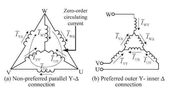

                                          It will eliminate the fundamental which is where the majority of rotor losses occur but you are still playing around with the conventional noisy winds on 10 poles when the difference has been presented for over 6 years now. German social media hasnt produced even 1.
                                          Click image for larger version  Name:	Y-D to Conventional DL comparison. (1).png Views:	0 Size:	34.9 KB ID:	390617
                                          Click image for larger version  Name:	series vs parallel y-d.png Views:	4 Size:	41.0 KB ID:	390616
